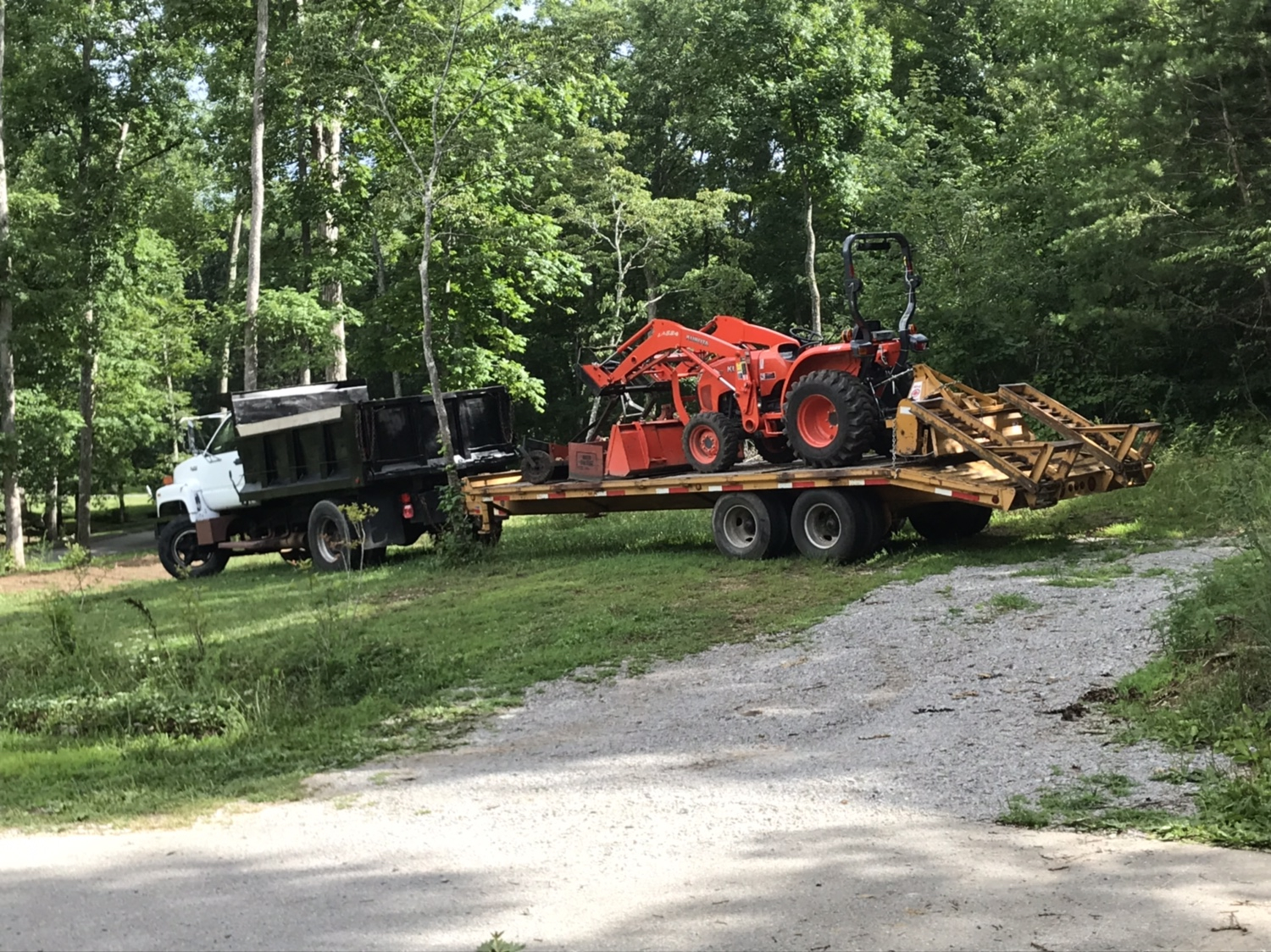

No 14k 20 foot trailer unless possibly aluminum is 2,000 pounds.
That's funny, this one weighs in at 1990 lbs, 18' with 2' dovetail and 2 7k axles with brakes on both axles.
/ Need advice on trailer purchase #57
I wonder if it's amazing engineering or if it's under-engineered. My 7K 16 foot trailer weighs about 1700 lbs. Hard to imagine doubling the capacity with less than 300 additional pounds.
/ Need advice on trailer purchase #58
That looks like a trailer built for half the capacity, that just happens to have double 8-lug 7k axles underneath it. Interesting.
/ Need advice on trailer purchase #59
What registration/manufacturer documentation do you have proving that 1990 lb. trailer it is legally rated for 14K?
/ Need advice on trailer purchase #60
I don't know I would have to look through the paperwork tonight, but I'm not trying to prove anything, my post stated that it was an 18' +2' dovetail equipment trailer that has 2-7k axles with brakes on both axles that weighs in at 1990 pounds, there were a blue million of them made in these parts back in the 90's and mid 2000's and while I have never had 12k on it , it has hauled any and everything under the sun probably up to about 7 or 8k and to this day it hasn't warped or bent, I bought it from a local trailer manufacturer brand new in 2006 but I will look tonight to see what any of the paperwork says.
