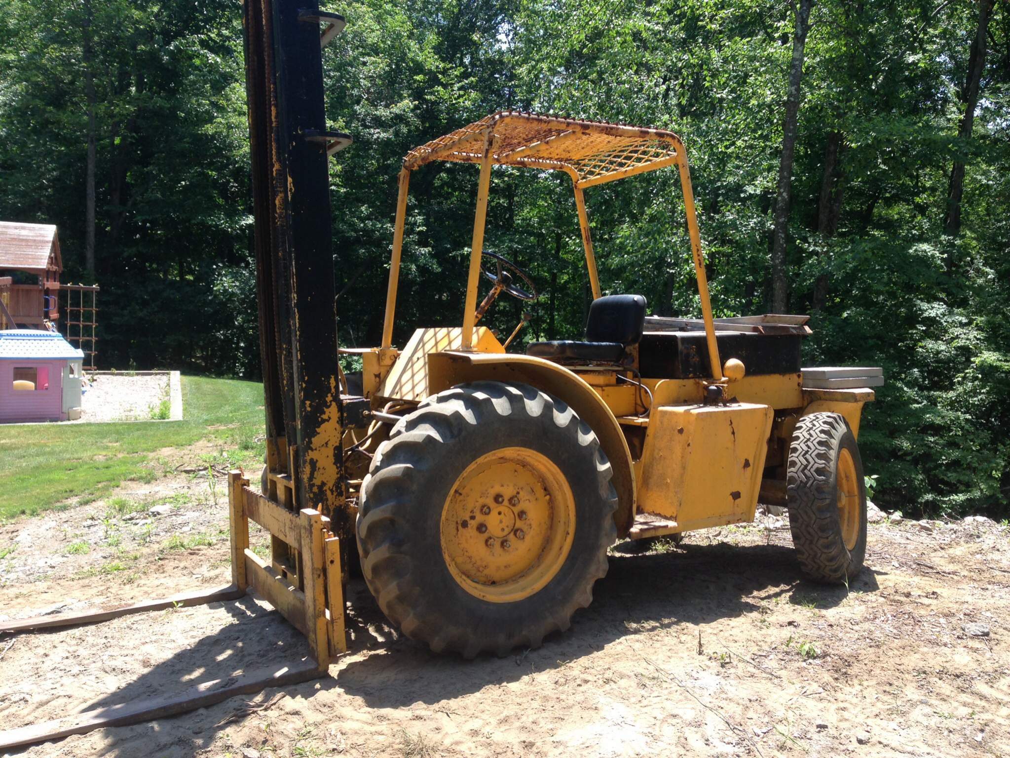

/ Name That Tractor Game! #1,536

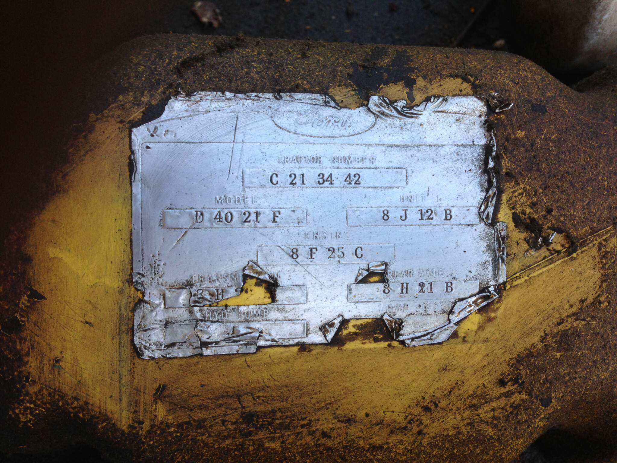

Good eye with the steering wheel but it's a backwards ford tractor. Behind the mast the axel has a plate covering where the pto shaft would be and you can see where the three point arms would mount in the castings. But I'm trying to figure out what model ford it is image.jpg
/ Name That Tractor Game! #1,537
The model code D40 21 F is a 4000 Utility, gas engine, no PTO, 4-speed power reverser transmission with torque converter. The unit number looks like a date code for Day Shift on September 12, 1968.
