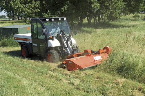

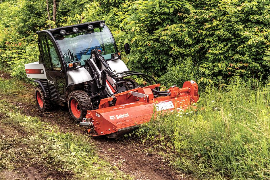

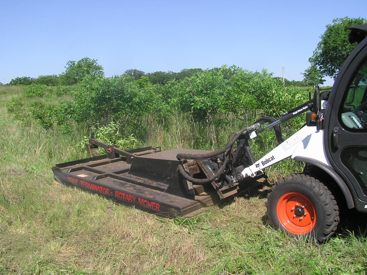

How would I run something like this on a compact tractor? Or are you suggesting I get a skid loader?
I was suggesting a Toolcat.
We use a 7' brush hog:
Or a 6' finish mower:
The cab keeps me cool and out of the dust (y)
   / My Thoughts On Modern Day Tractors
#87
Check out the link in @Xfaxman's signature... incredible machine. I wish I had seen that before buying my Kioti... I may have went that route.

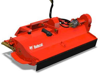

So to make sure I understand you, you are suggesting this as a machine to run a flail on?
   / My Thoughts On Modern Day Tractors #89
No, I was saying that this machine is often overlooked by those looking for right "tractor" to perform a list of tasks. My main use is brush hogging, second would be maintenance of wooded trails. I never knew these existed when I was tractor shopping but would appear to be better suited to my main uses, perhaps much better than the "best tractor for the job" that I wound up buying. The Telehandler seems to tick a lot of boxes in your list of requirements.
