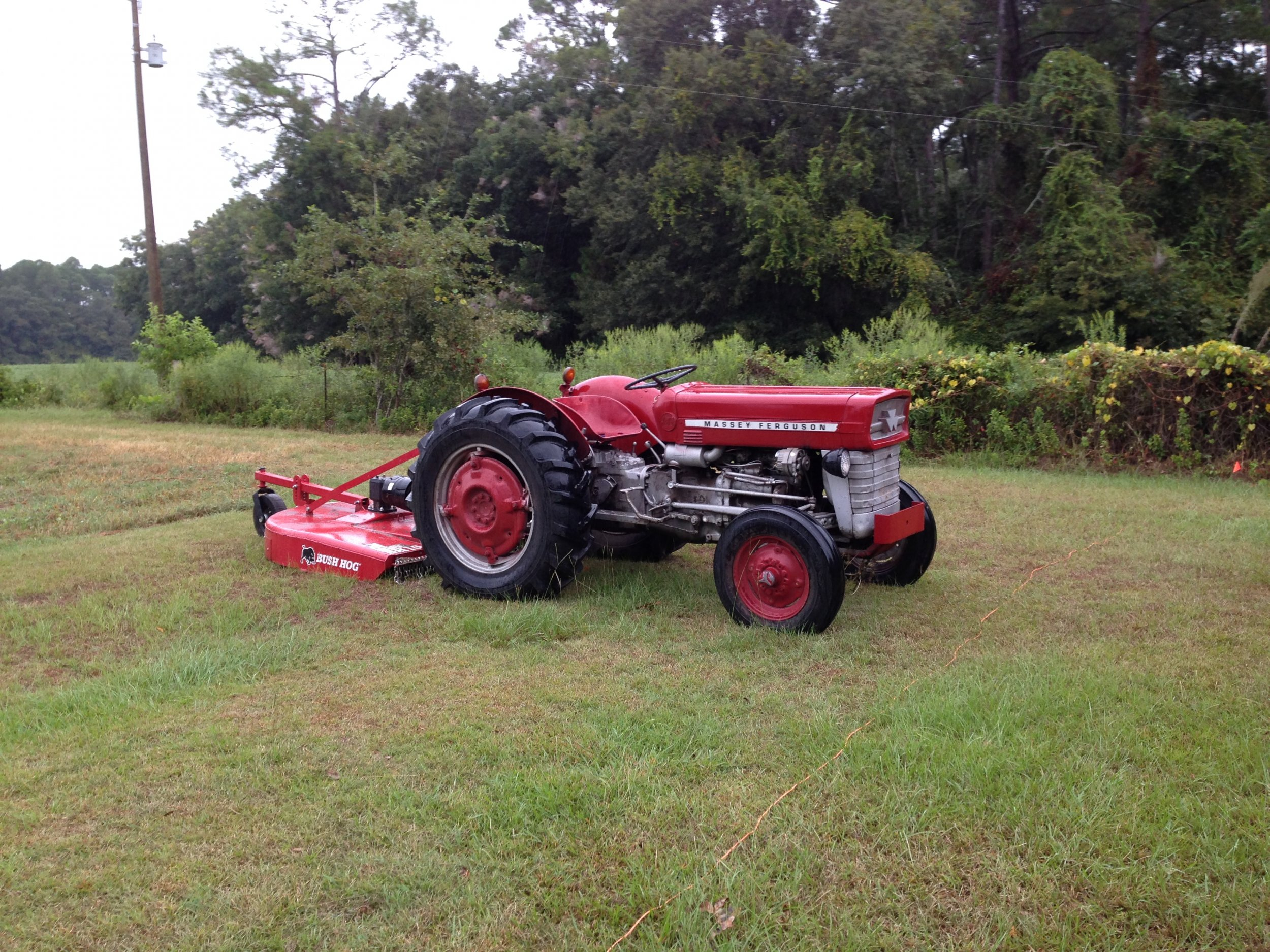

But then you would be stuck with a gear drive transmission and no place to get it worked on around here if there was a problem.
True about mechanics and local parts. My 2018 Kubota went to the dealership for a service this week so I put a new battery in the old MF 135 and dragged some brush. Old school was fun for about an hour. Then the stiff two stage clutch straight down clutch and the getting gassed by the under rear axle diesel exhaust began to wear on me. Tough 40-ish HP brute though. I’m ready for my HST to come home.

   / My Thoughts On Modern Day Tractors #68
That's a good size tractor. The tires on the rear are pretty beefy. Is that tractor the same size as the current 4 series models?
