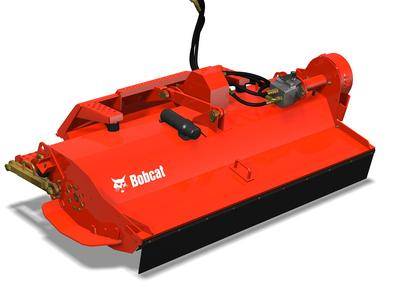

Rotary cutters don't do well on my property. I need a flail for the kind of vegetation and terrain that I have.
Out front mowers are the best in my experience: toolcat flail - Image Search
Toolcat costs more, but you get what you pay for, a cab and no DEF or regens.
And it will lift over 3000 pounds according to my crane scale.
