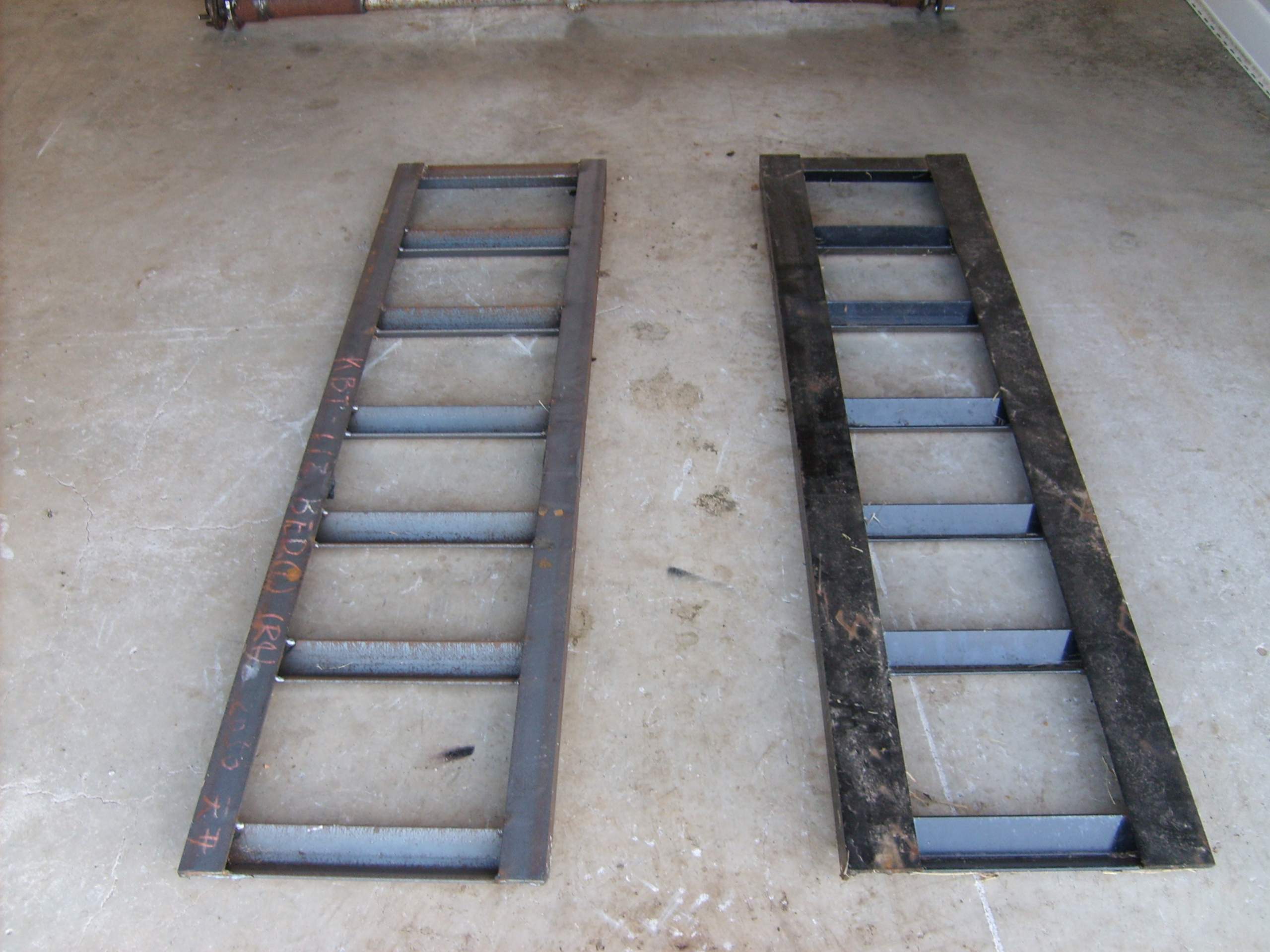

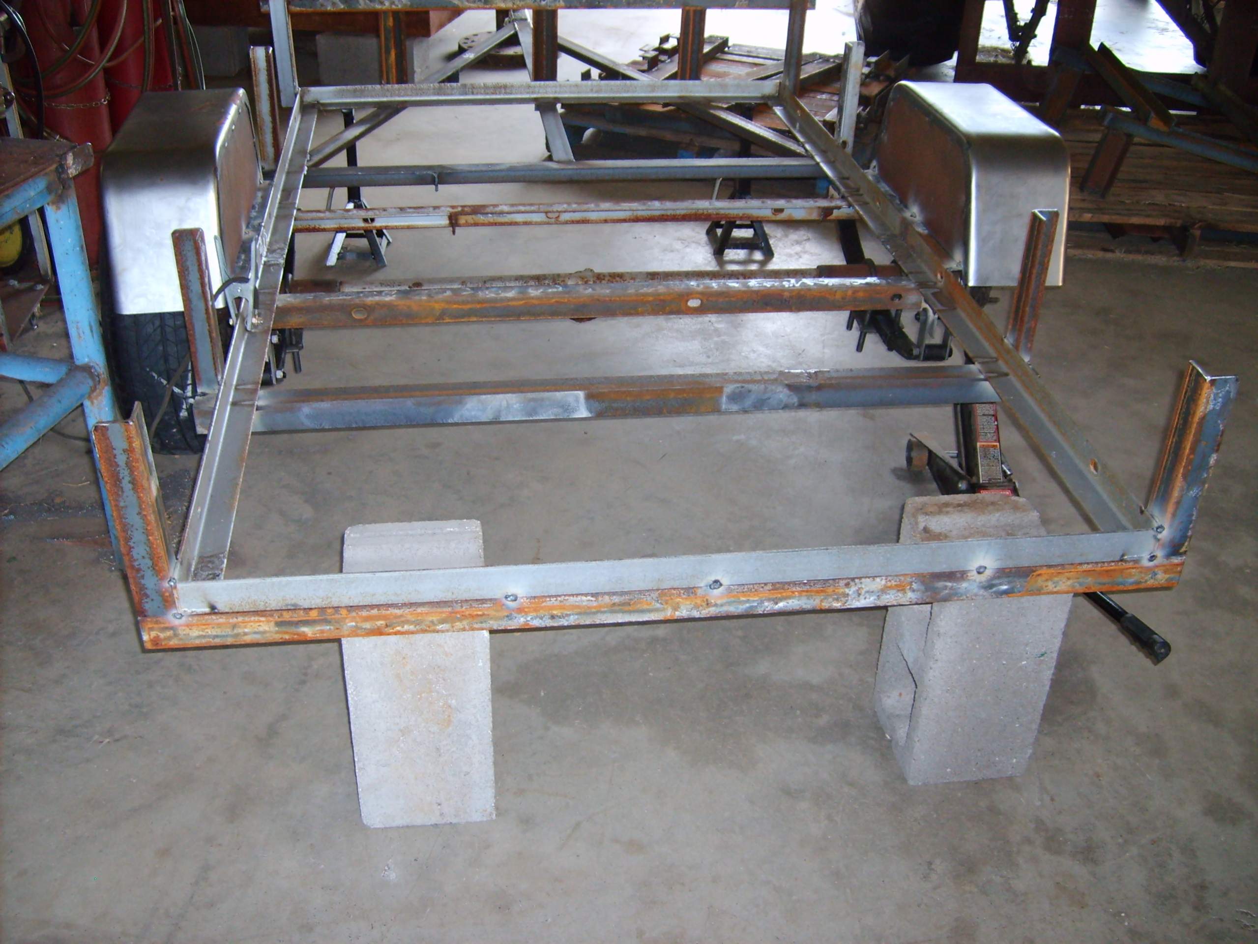

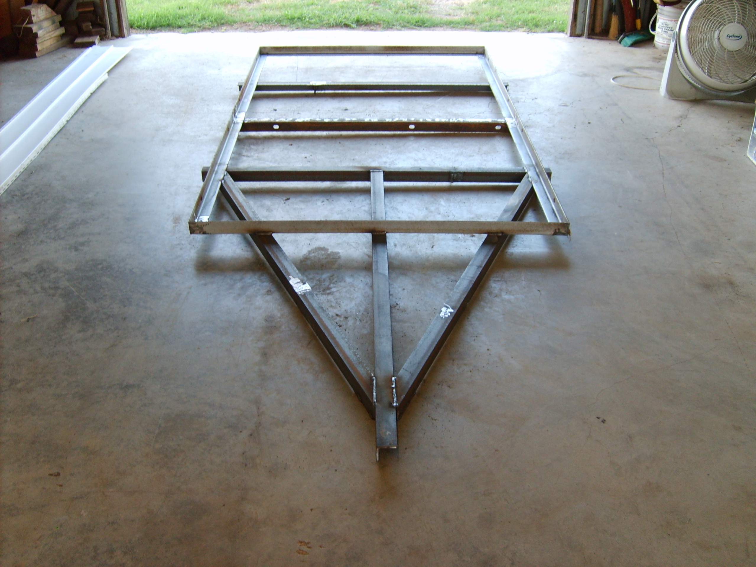

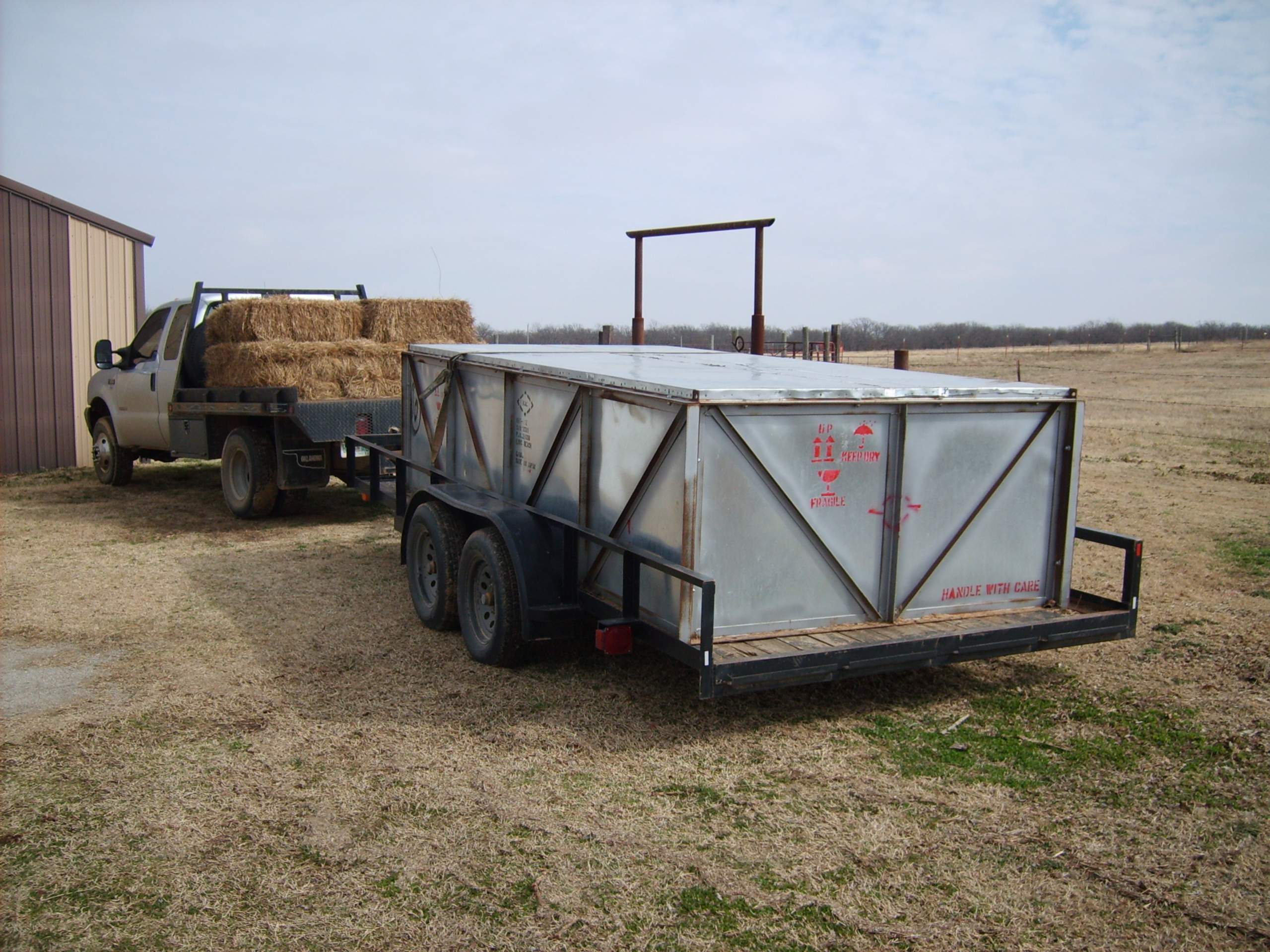

I know what you mean, Rob. The pics below show !ONE! of my ongoing projects that started as a machine crate and is turning into a small trailer, ramp, etc., etc.:D
There you go Jay, nice work!
That's pretty much exactly what I do. I use what I have and if it works the way it is, I use those dimensions. After all, it's strictly for my my use so no one will ever know the difference ... except you guys of course.:D
