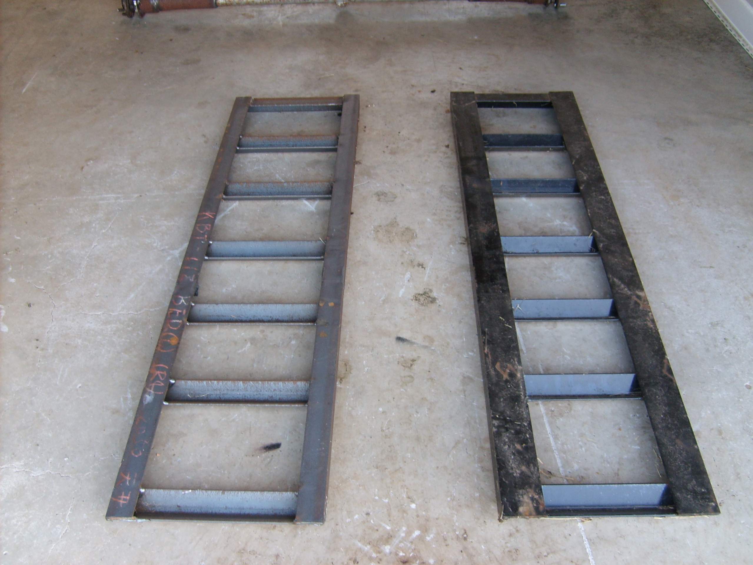

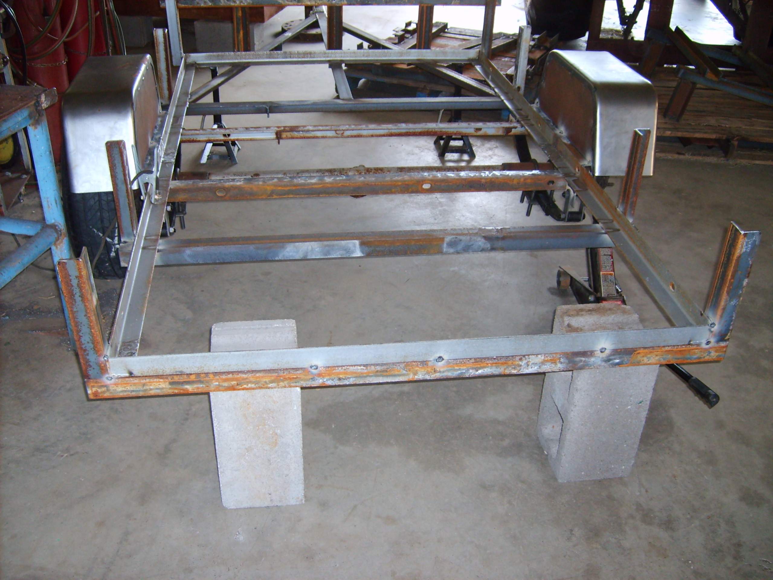

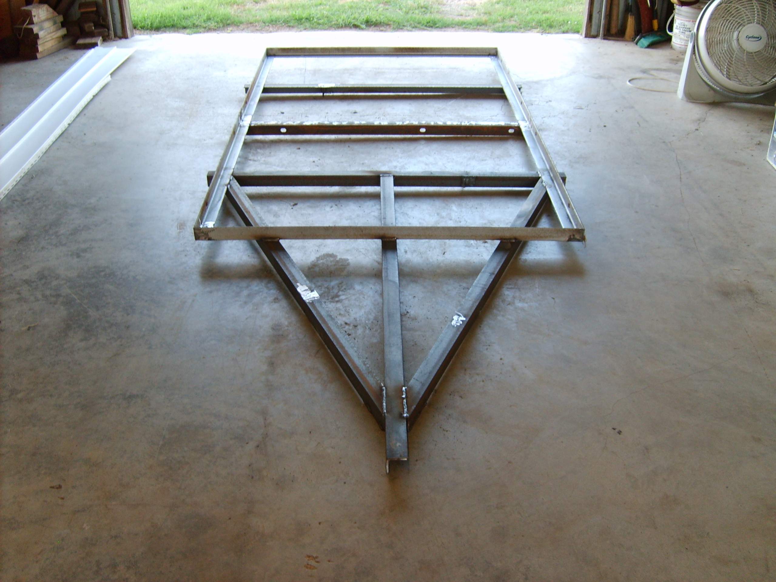

I know what you mean, Rob. The pics below show !ONE! of my ongoing projects that started as a machine crate and is turning into a small trailer, ramp, etc., etc.:D
