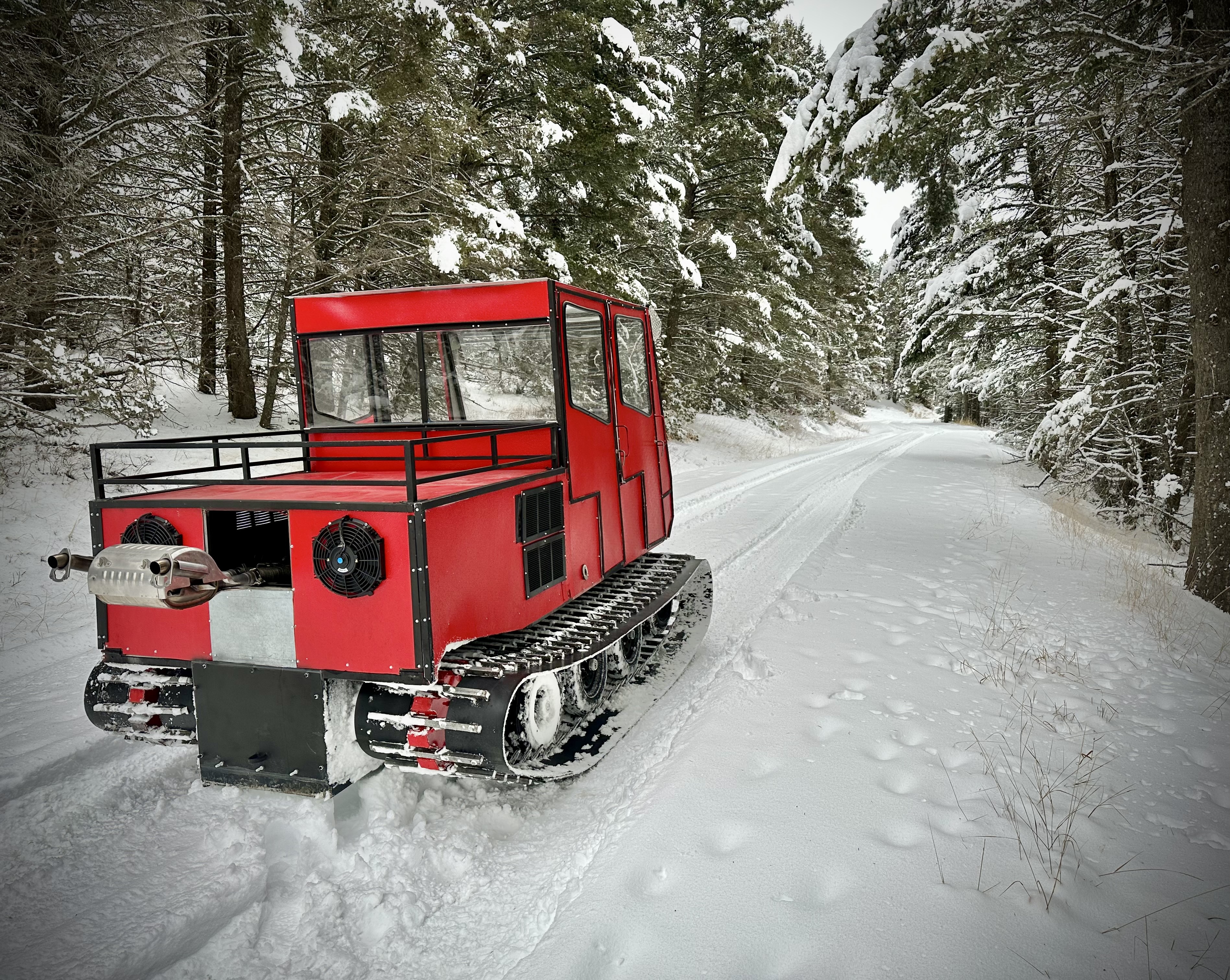

A quick update - recently, I did take off the teeth from the front sprockets and removed a link from the new #50 roller chains to effectively loosen the tension on the tracks. I took it out for a short spin (so as to not mess up the grass too much due to only 3" of snow) and the reduced track noise sounded promising. More evaluation/adjustment is needed. Today, I made brackets and mounted a pair of small rear side mirrors so I can view the tracks so I don't run over things. A rear-view cam & monitor may also be worth installing.

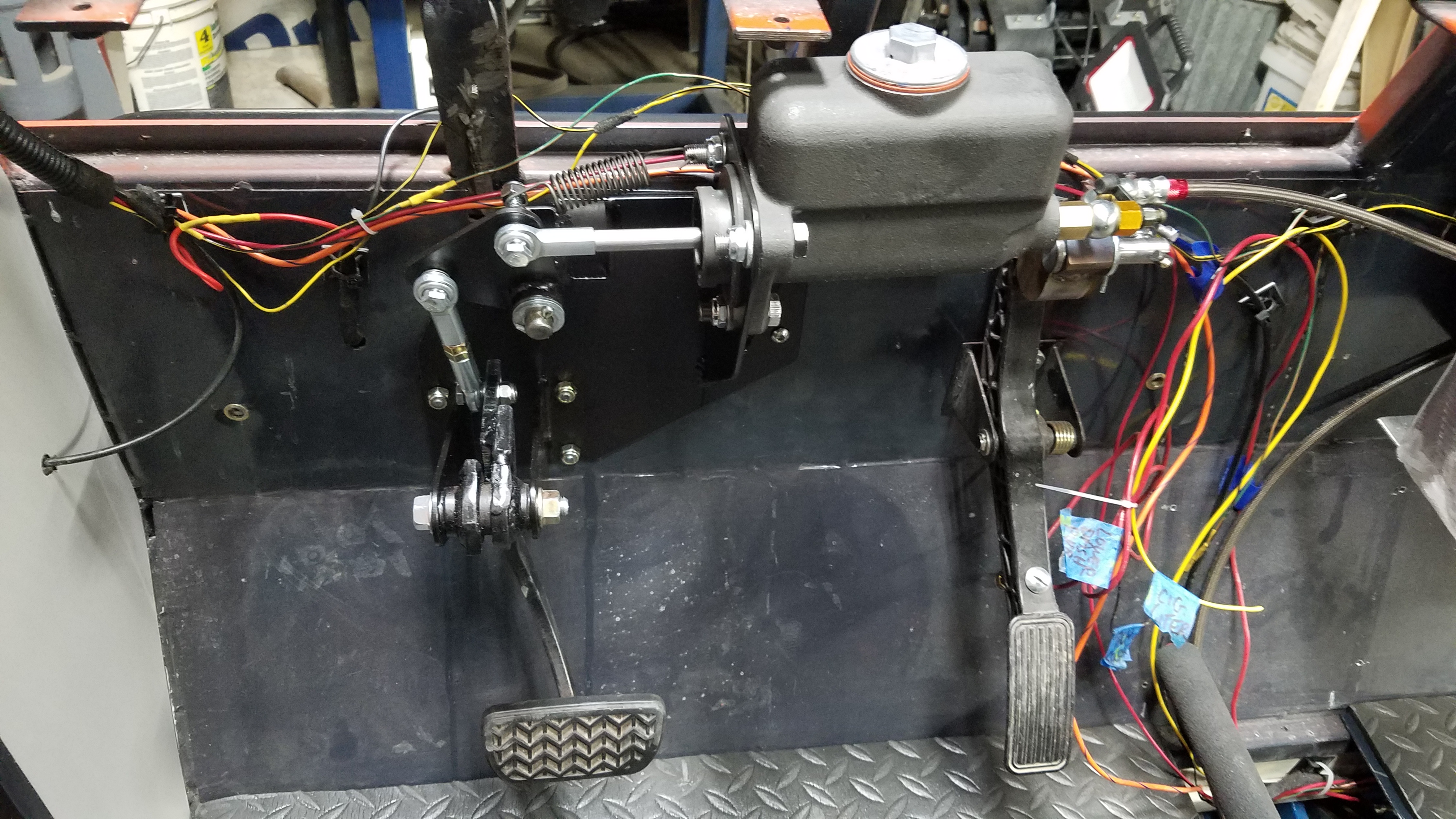

BTW, how are you applying pressure to the steering brake calipers? Auto master cylinders?
   / My Senior design project - a "Swamp Thing" tracked vehicle clone #657
Yeah blacktop and grass I won’t go near. Gravel and snow, sure.
I’m using four (two per side) UTV calipers from a Razor 1000 basically. Each has their own cylinder, so lever pushes two at a time. If the air is purged well, it’s very light lever pressure to pull and create turn.
