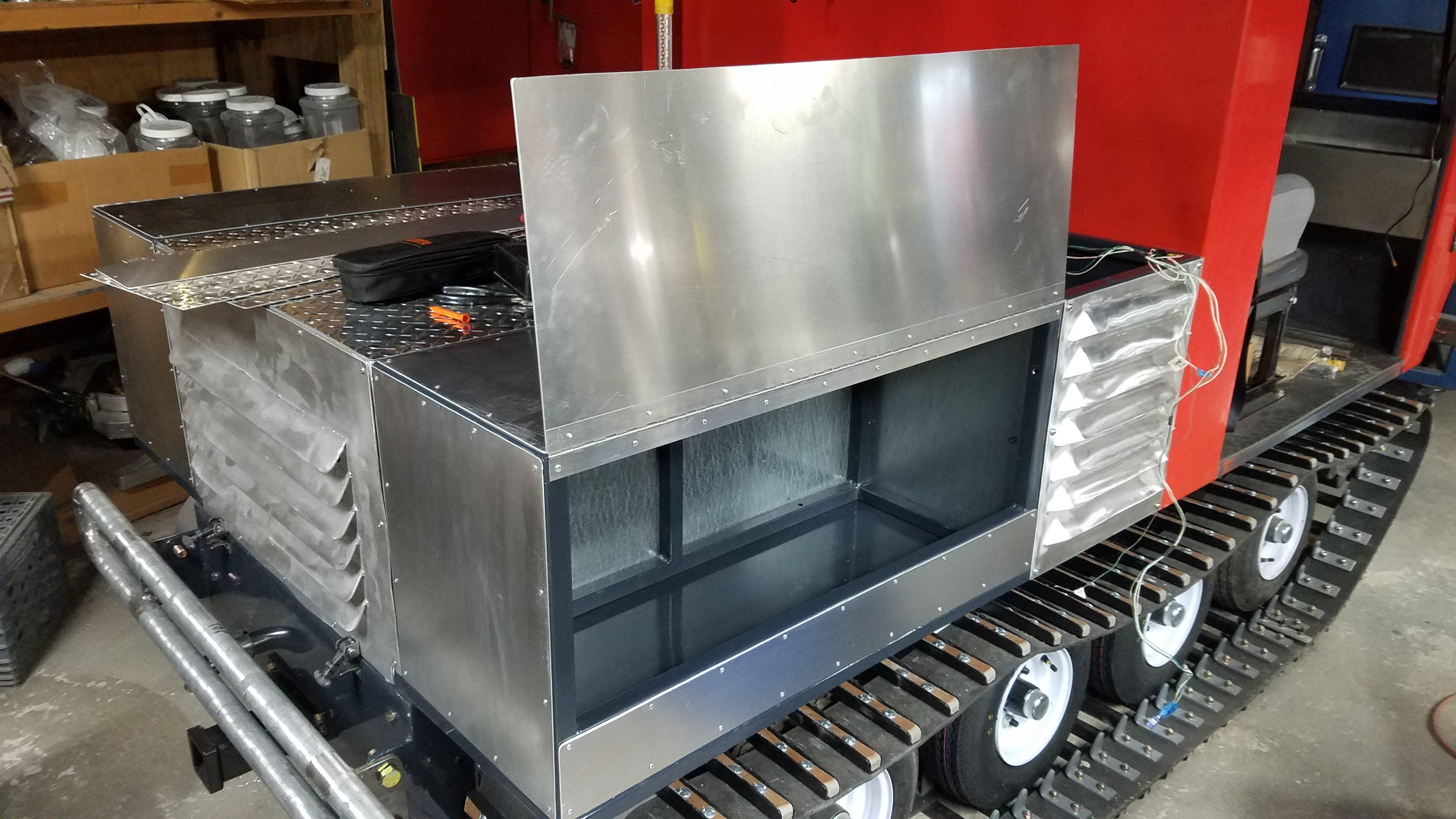

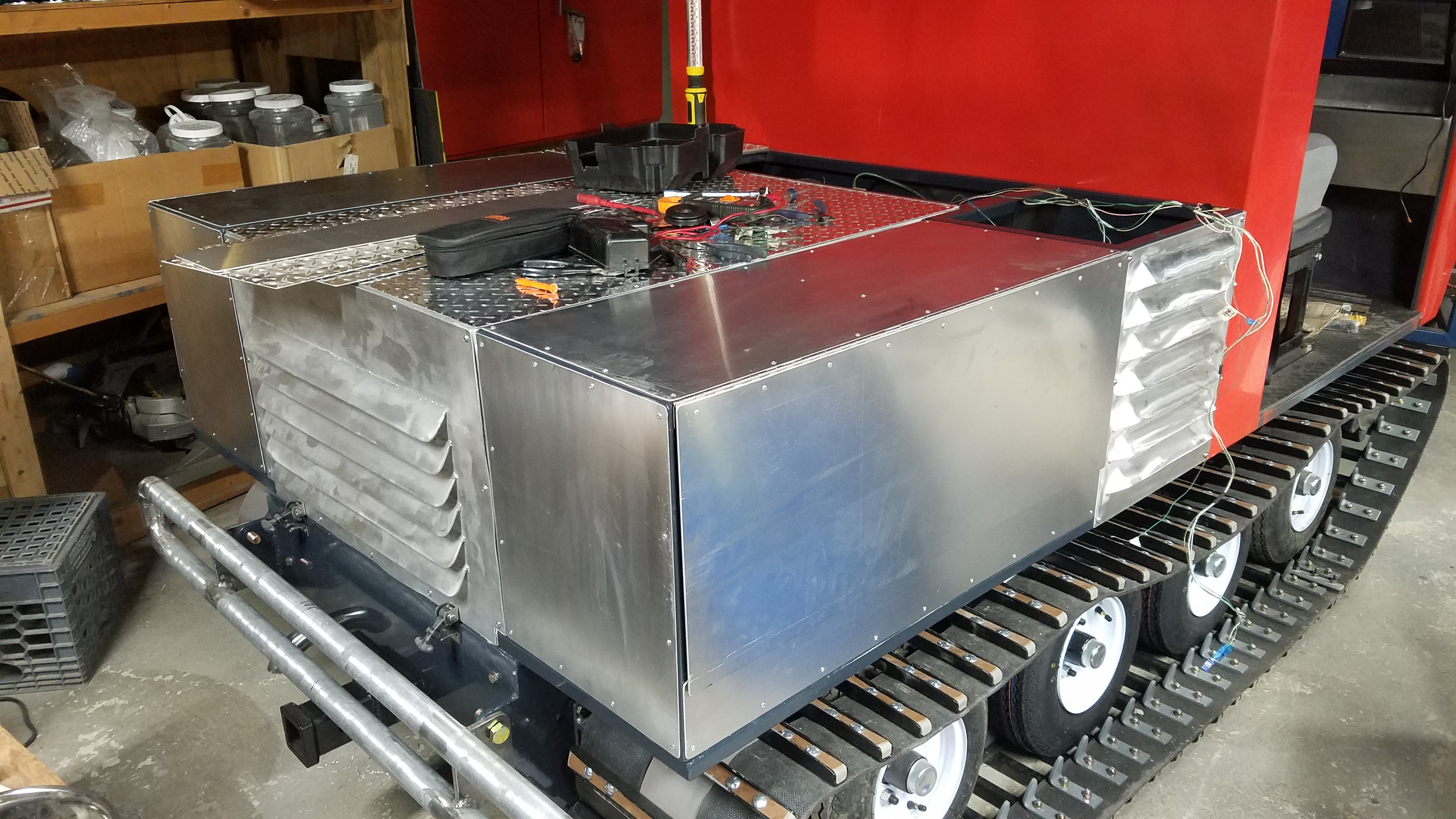

I've been working on the storage/tool boxes at the rear. I still need to add the magnetic catches, gaskets and pulls. I was thinking of adding an engine turned finish to the sides - think it would look sweet?
View attachment 644947 View attachment 644948
I like how you took the sharp corners off the box sheets. That is something I'd do.

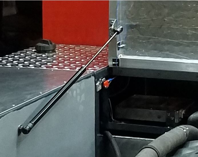

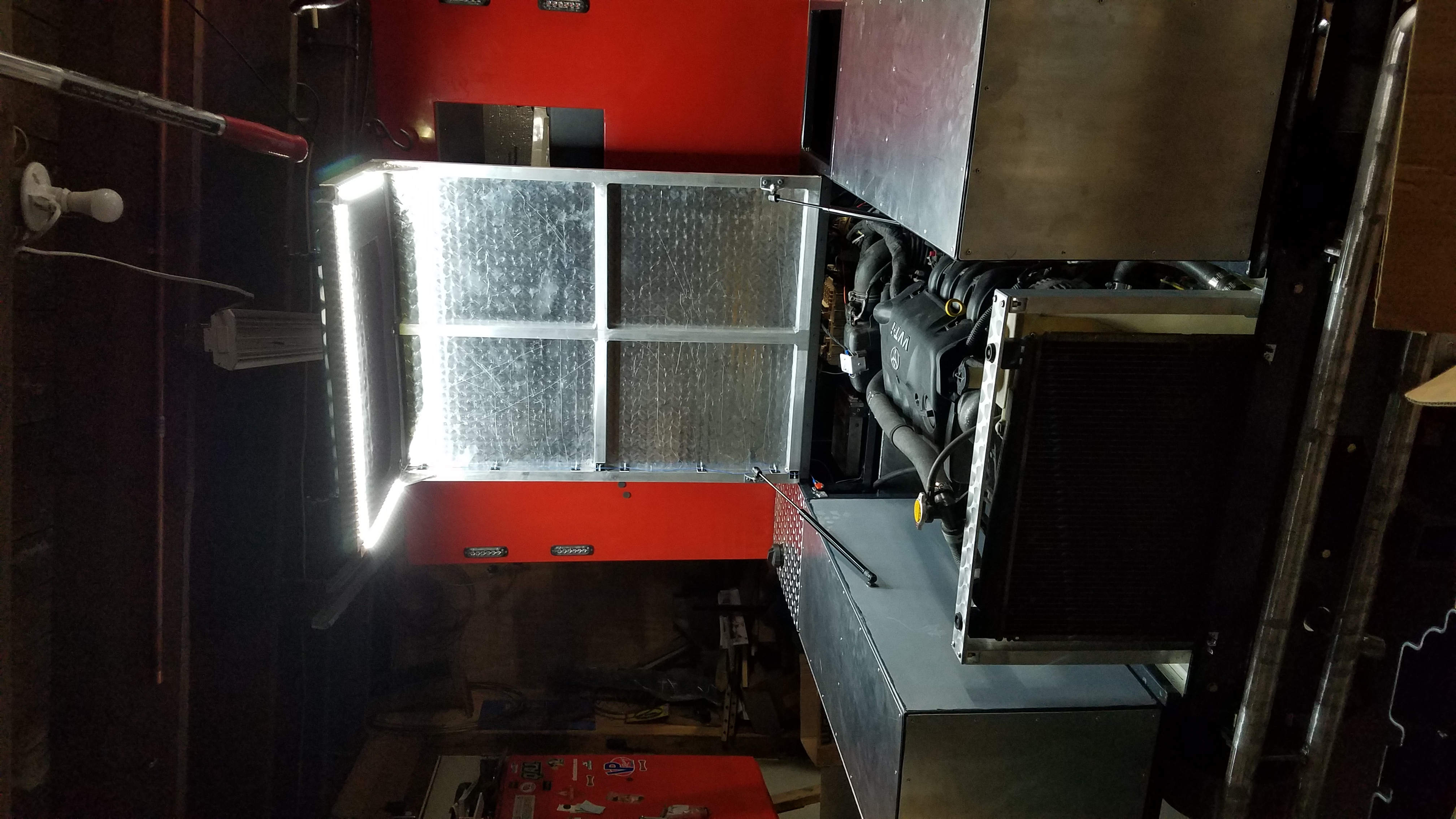

I finished the engine bay hood with the installation of two gas-assist struts and led maintenance lighting. Note the red micro-switch under the left strut to turn on the lights when the hood is lifted. :thumbsup:
   / My Senior design project - a "Swamp Thing" tracked vehicle clone #314
Noted, very clever :thumbsup::

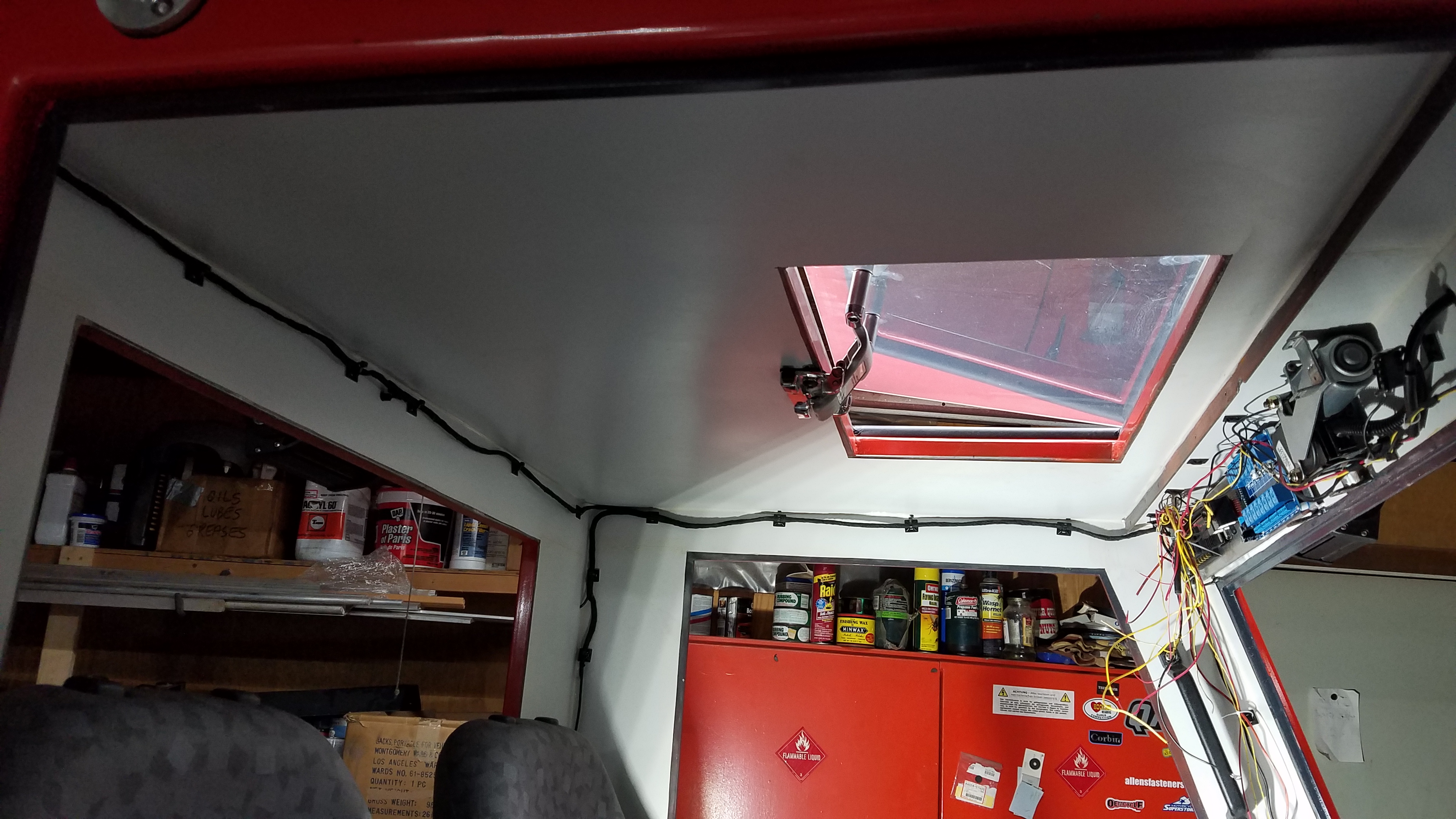

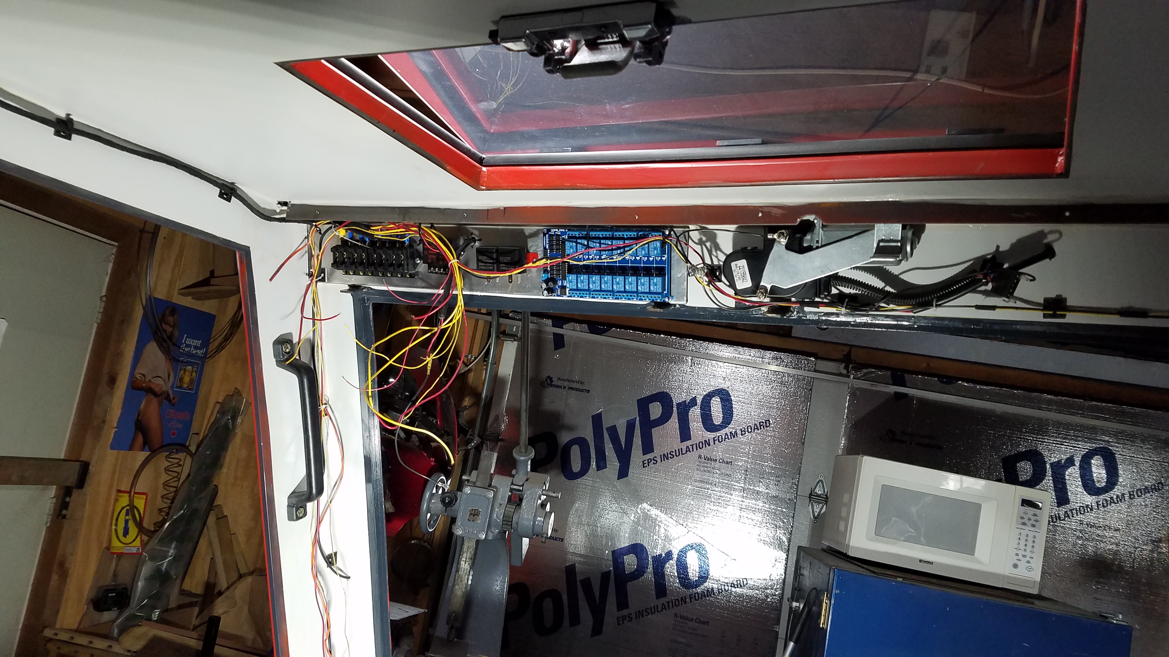

I spent the last couple of days wiring the light system in the cab. If the weather starts to break, I'll be taking it out for its maiden voyage. :licking:
Your gas springs are on upside down. Trivial fix though. There is a bit of oil inside to lubricate things. It sits in a puddle at the bottom being useless if the rod is up. If the rod is down it sits on the seal/bushing where its needed.
Not sure if they would be level most of the time, but they can use any help they can get.

Thanks for the knowledge. This is the first time I've used them except on my cars. I will reverse them. :thumbsup:

Your gas springs are on upside down. Trivial fix though. There is a bit of oil inside to lubricate things. It sits in a puddle at the bottom being useless if the rod is up. If the rod is down it sits on the seal/bushing where its needed..
Thanks, this is good to know!
