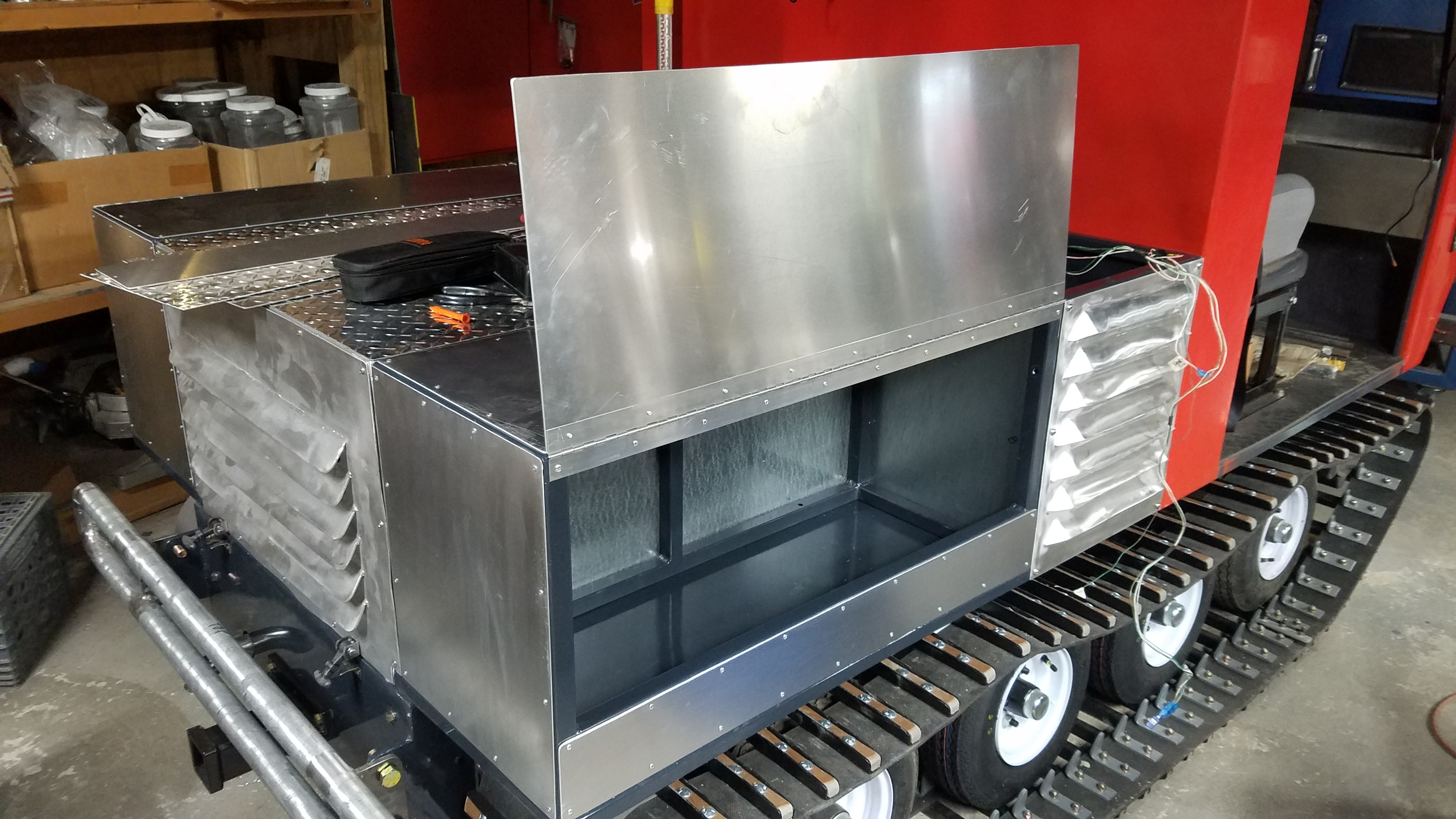

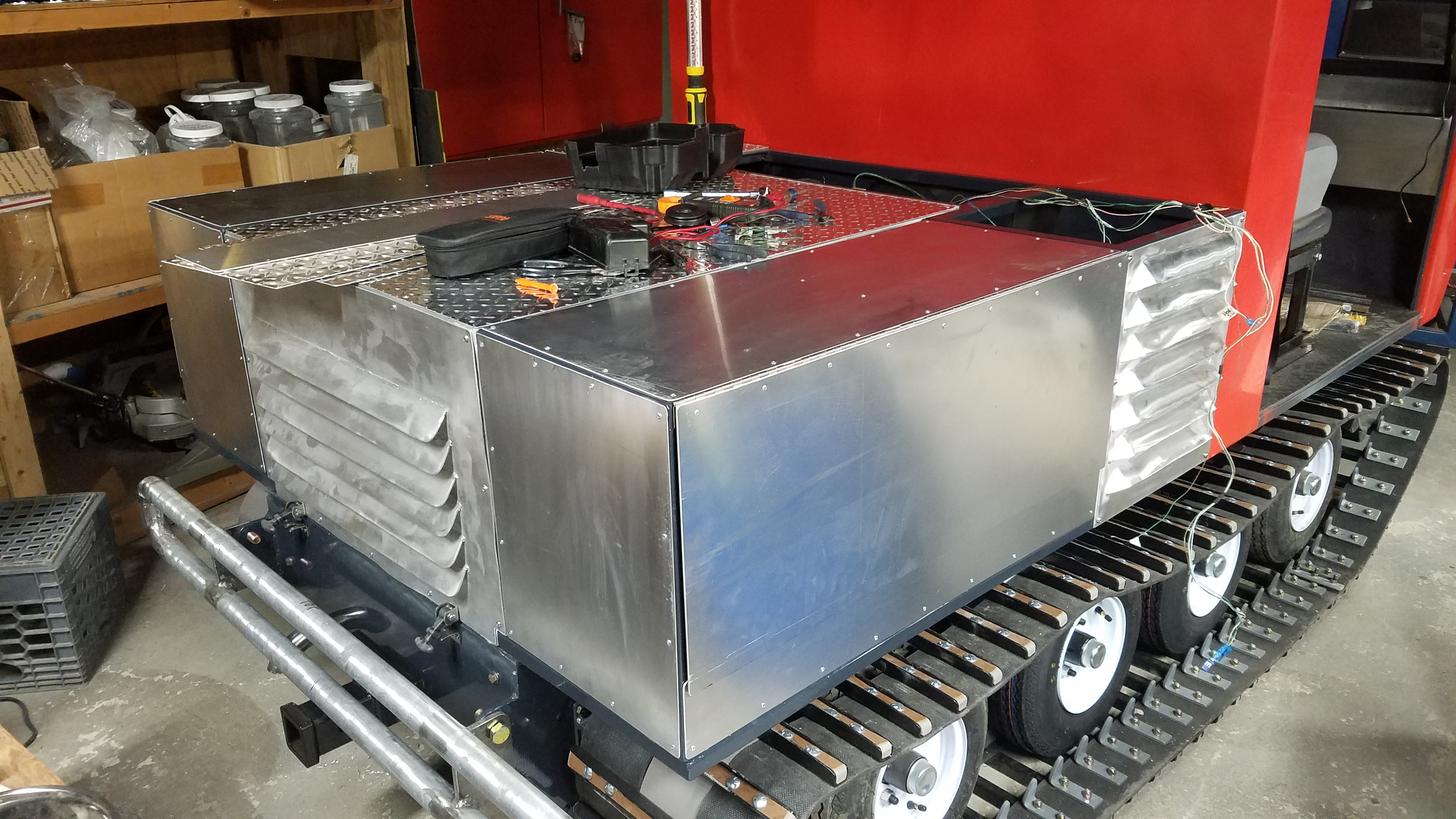

I've been working on the storage/tool boxes at the rear. I still need to add the magnetic catches, gaskets and pulls. I was thinking of adding an engine turned finish to the sides - think it would look sweet?

Gee, you are taking t his build to the nth degree but I admire the workmanship.
Keep on going.
I wish I was as dedicated as U are.
