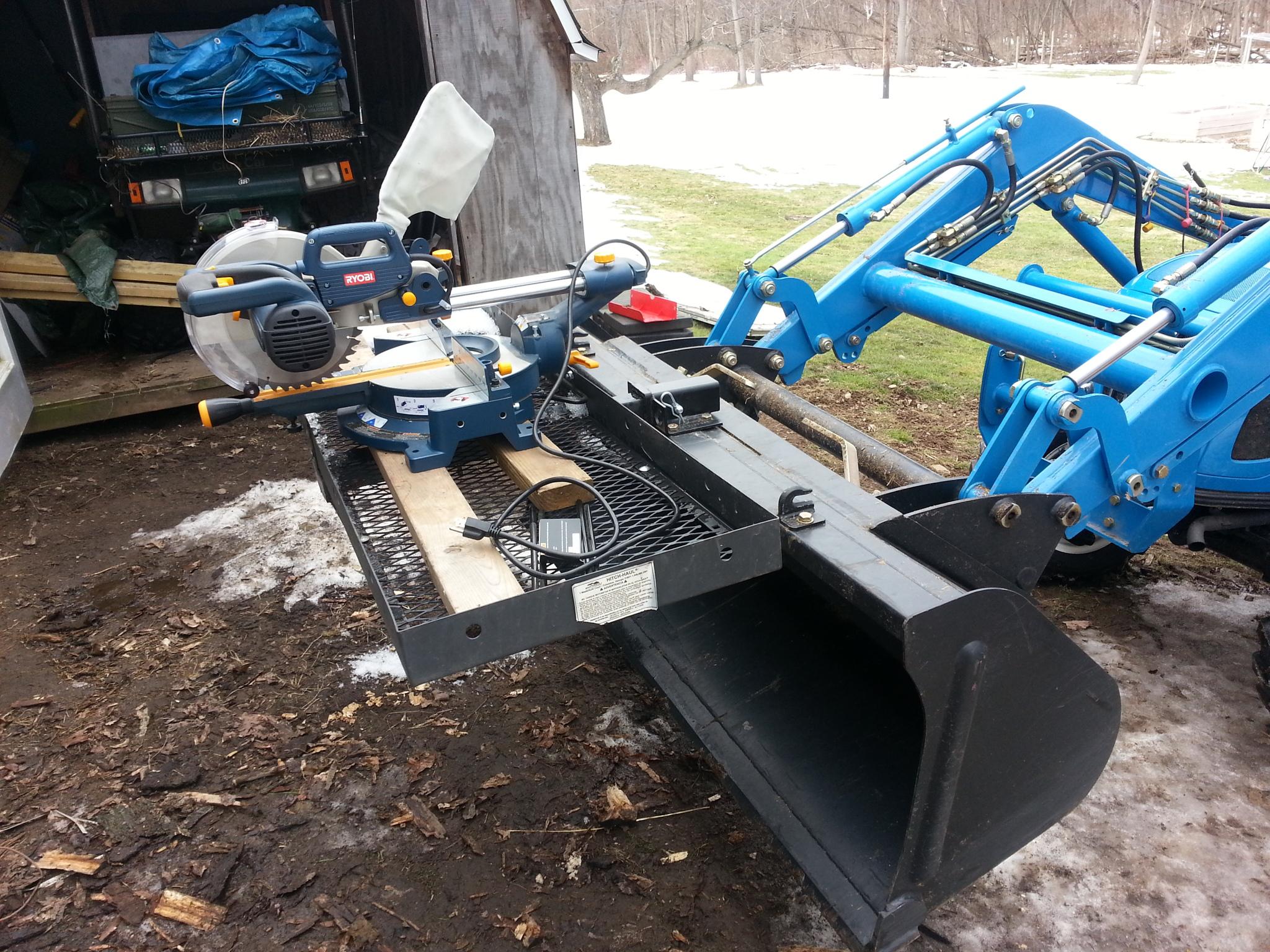

I have had several people ask me why I put the receiver hitch on the bucket, and what I might use it for.
Found use #1 today!!
Your picture just made me think of something specific to the LS tractor. Do you know if there is enough room under the hood to install a higher amperage alternator? Because with that and an inverter you can run your saw right from the tractor.

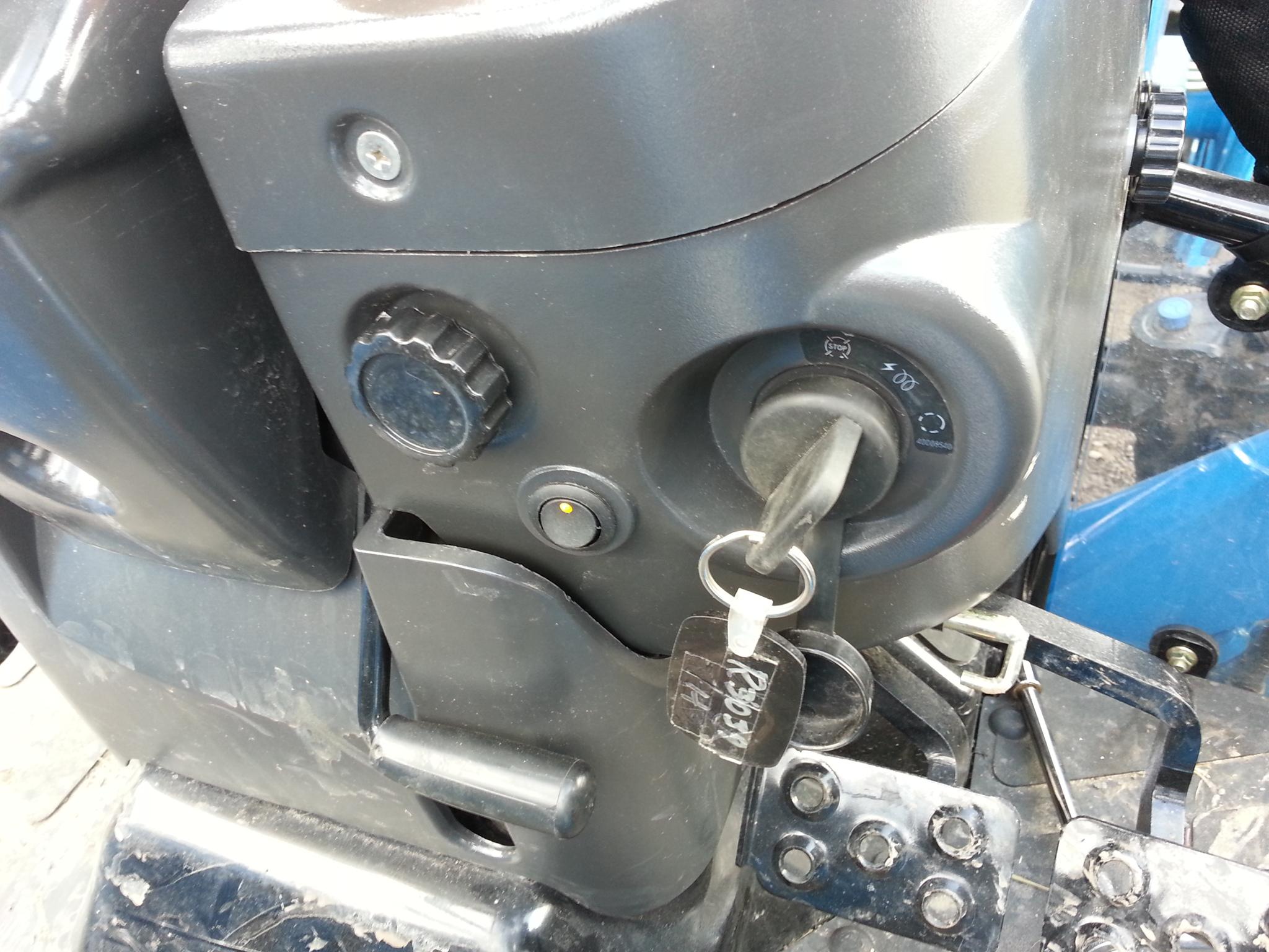

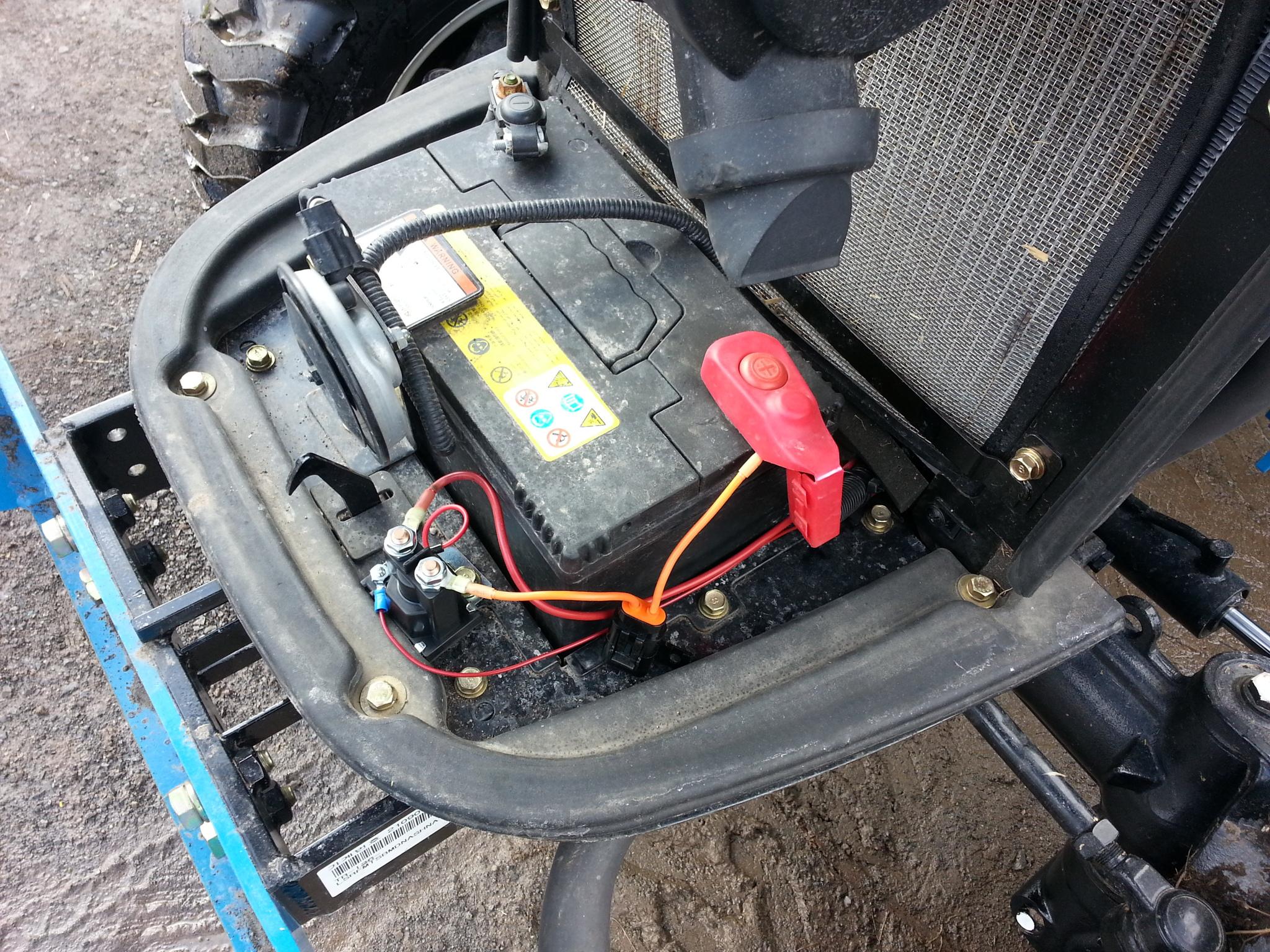

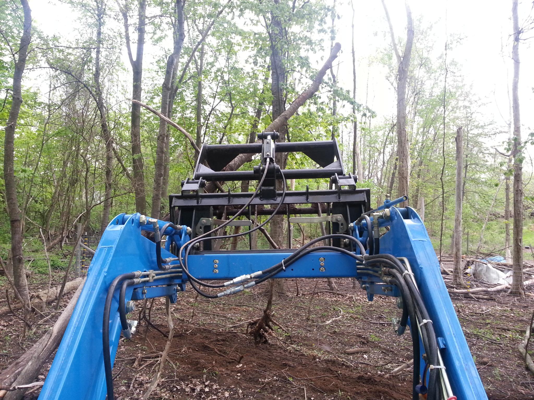

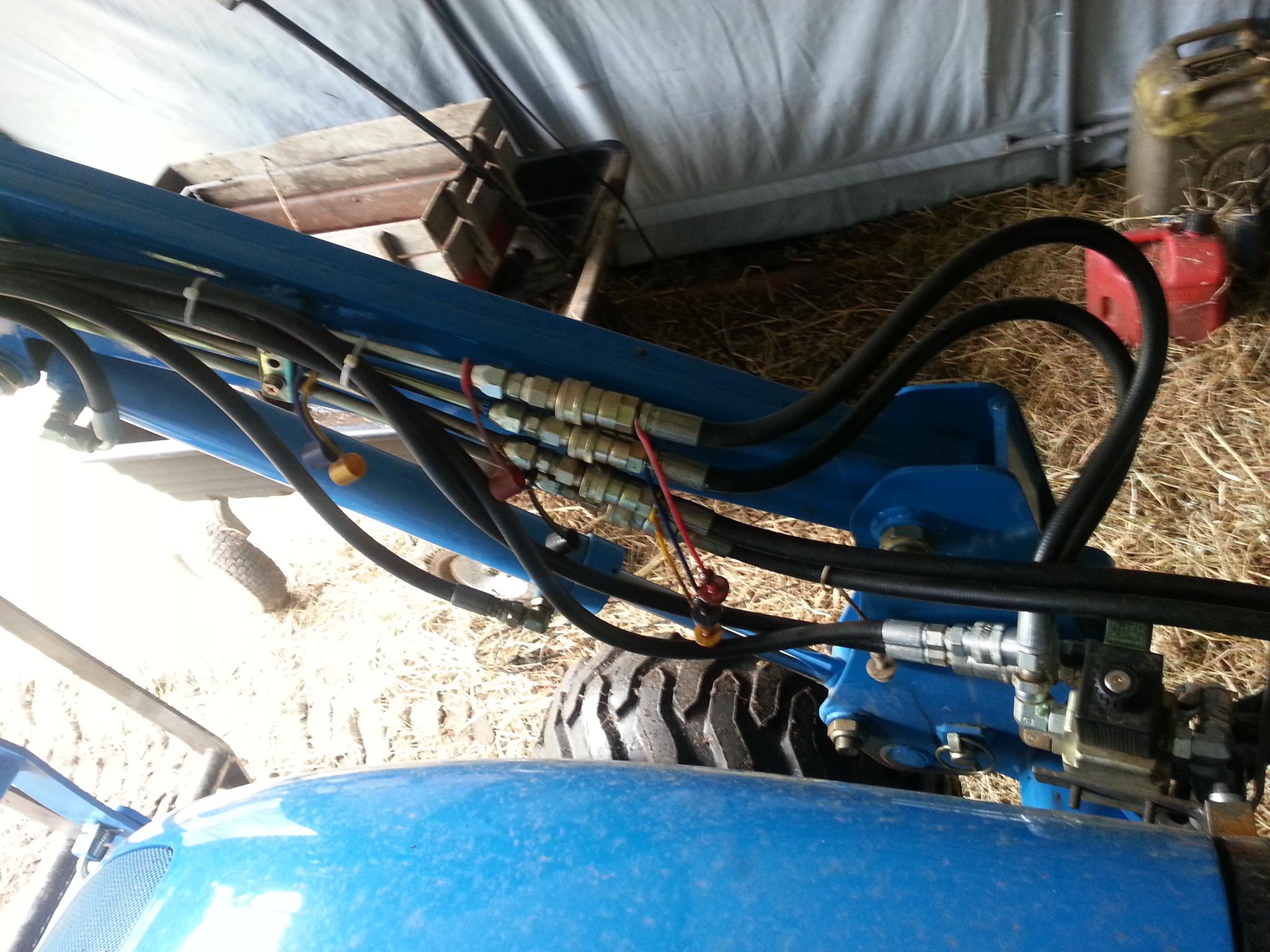

So I have added the diverter valve for my Grapple....
I had my dealership cut the factory hoses and add new ends to both sides. I also had hoses made up to reach the front. Added quick disconnects for the hoses headed to the front, and have a button temporarily zip tied to the joystick.
In hindsight, I would have not been so impatient and would have made sure I had my hoses the right length. I hae some that I feel are a little long....
In my opinion, the diverter valve is best mounted to the loader, like on the inside of the right upright/mast. That way it comes off with the loader, and makes for a cleaner install overall. But, yours is fine and very functional, just be careful of those hoses for the 3rd function that they dont get snagged.
/ My R3039 Mods
#47
There wasnt a good place to mount the valve on the loader arm, without breaking into the steel lines...
The hoses by the valve are quite protected. Its up near the grapple I need to figure out what to do with yet.
Ah Ha!!!, Portable work bench, did not think of that. Now I will. Thanks

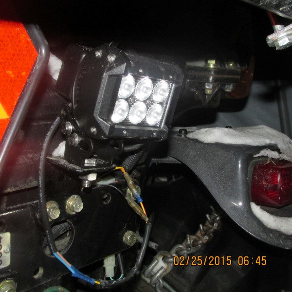

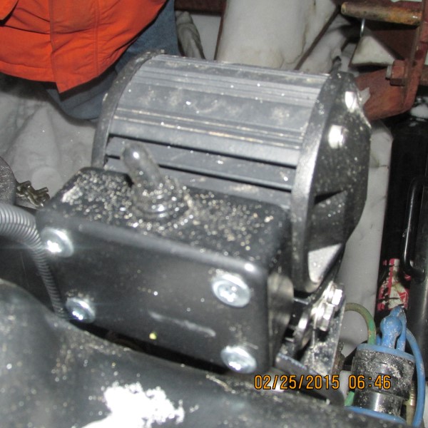

Its been a while since I added anything here... and honestly, i don think i have done any upgrades really anyway.
But, last week, I needed to replace my rear work light. I had put the ROPS up one day over the summer to pour fuel in, and I didnt pin it up; and forgot. Knocked it down, and the plate holding the Orange light smashed out the rear work light. It seems when it comes down at a high rate of speed, there was a clearance issue!
Anyway, I had bought a box of 10 LED lights to use, just hadnt got around to putting any on yet.
Because the rear light had a built in switch, I had to fab something up for the new light. A simple plastic project box, toggle switch, and waterproof toggle switch cover were all I used. I used some self tapping sheet metal screws to attach the box to the back. They snugged up nicely between the heat sink fins.
As you all probably know by now, the light output on this light is amazing compared to stock!
I now have a plan for installing more to the ROPS, so stay tuned!
BTW, link for the project box used:
Hammond 1591LSBK ABS Project Box Black: Electrical Boxes: Amazon.com: Industrial & Scientific
/ My R3039 Mods
#56
I should mention that yeah, I know the wiring isnt tidy and neat.... but it was about 1°F outside when I mounted it!! I will clean it up when Elsa releases her curse....
