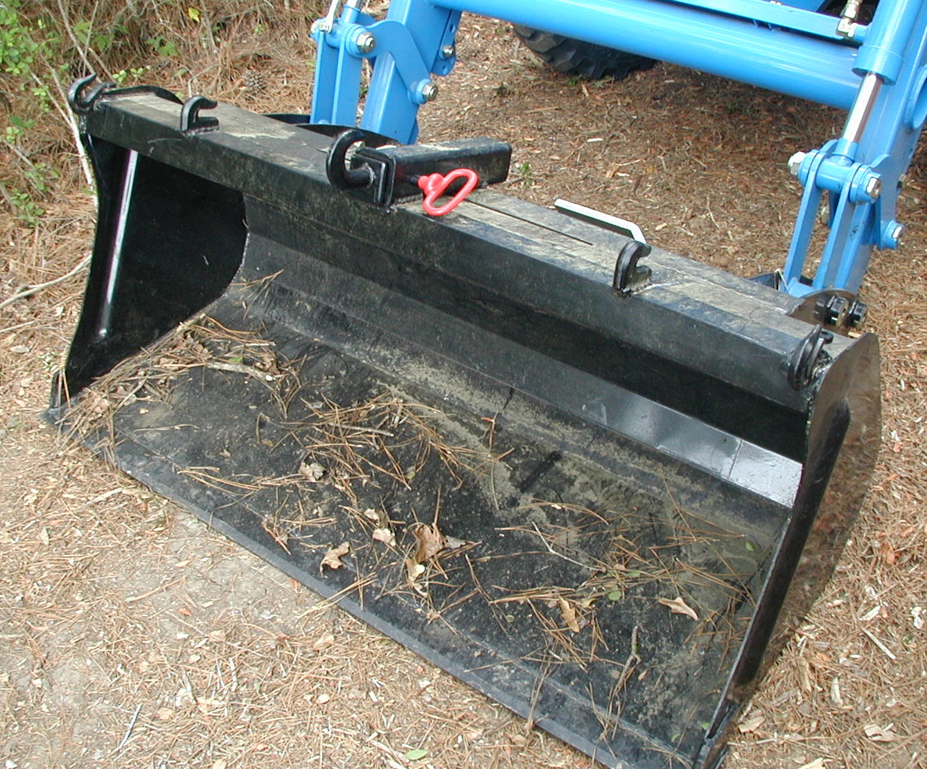

For the hooks, and the front 2 bolts on the hitch, I used 1/2" x 3" Grade 8. The rear 2 bolts on the hitch, I used 2 of the bolts that came with Kens hooks.
Be warned when you drill... that the weld is centered front to back in the bottom of the tube. I learned the hard way!
My original plan, was to drill/tap the top hole, thread the bolt into it from the bottom up, creating a stud for the hook plate, then drop plate on, and put nut over it. I opted against it, because the nuts were too tall, and would have interfered with the chain and hook.
I know Ken urges against clamping the tube like this, but the LS tubes look pretty thick, and I couldnt see any other way of doing it that I would have been happy with.
Like my buddy says... if the hooks start to get loose, you know you lifted something too heavy!! LOL
If you are worrying about crushing the tubing, why not put a piece of wide flatbar 4" (wide enough to span the width of the hooks mounting bolts)x 1/4" thick the width of the FEL tubing underneath like a giant double washer that catches both bolts . If it extends to both edges, it would quadruple the strength of the bolted joint. For the receiver hitch maybe use 2 separate bars for each side.

The major issue with making your own tube, is most square tubing has the weld to contend with. When making receiver hitches, you have to remove the weld for the hitch to slide into it.
In regards to the strength of the bucket tube, I am not that concerned, I do not think its going to be an issue honestly. I really think that if it were going to 'crush in' the bottom.... It would 'pull out' the top if it were just welded on. (if that makes sense!)

The HF 12" receiver tube is the one in this pic:
Also got the hook you see in it (and the pin as well) from HF. Plus you can find their 20% off coupons almost everywhere you look. This one is good till the end of the month:

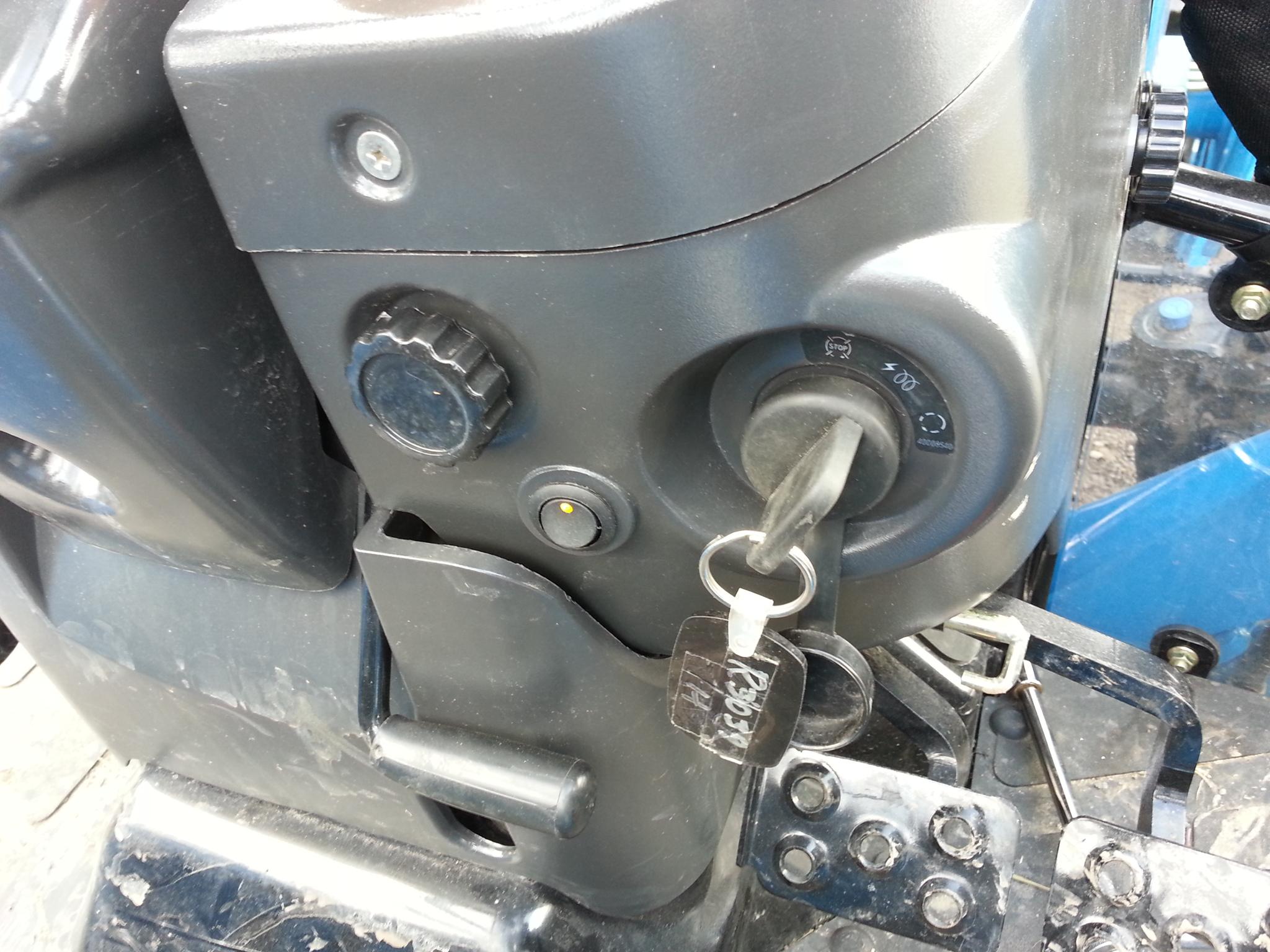

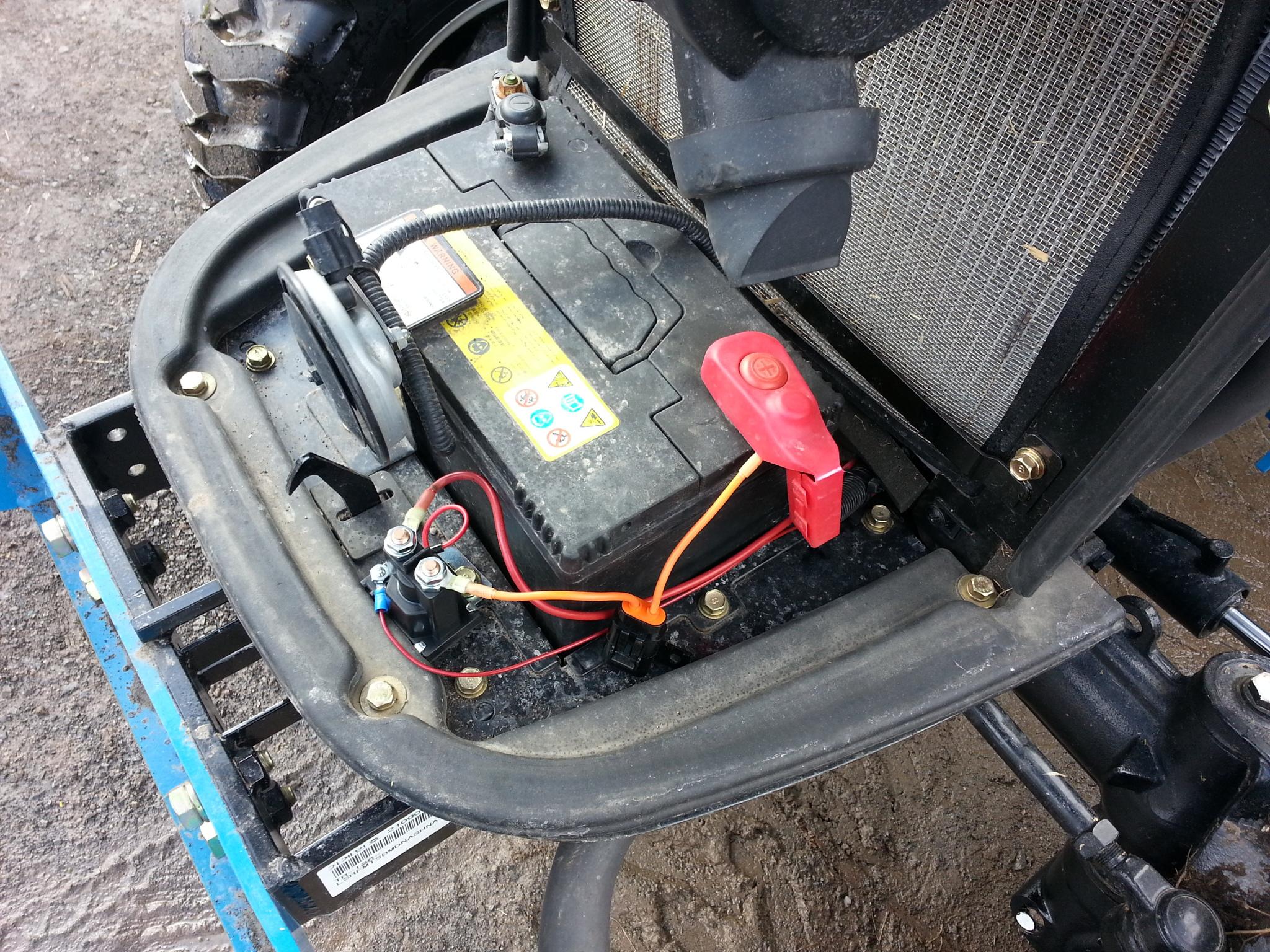

Finished up the wiring for the light.
Here is a shot of the solenoid and fuse I used at the battery. This is triggered from the key, and feeds a 6 fuse fusebox I put under the dash ziptie mounted to the factory fusebox. (forgot to get a pic of that...)
And here is the switch mounted in the dash.
