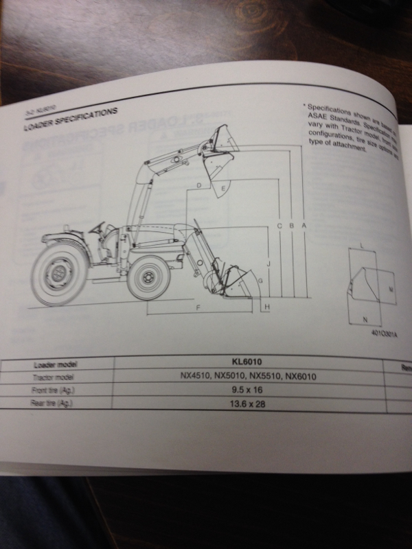

Your front wheels seem really small. Did you change them?
