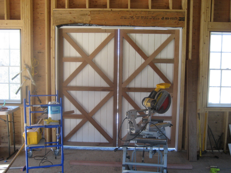

some more pics - I think I've actually figured out how to get the thumbnails to work.
Built the barn doors out of azek and mahogany, with stainless strap hinges. 3 down, one left on the first floor
The deck is mahogany, 12 ft wide, 66 linear feet, L shaped. I like to work outside in the summer, but still be able to roll my tools into the barn.
Doors are 8' x 8'. So of course I'm now thinking of buying an 8'2 tractor... :rolleyes:

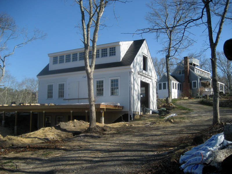

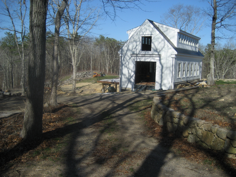

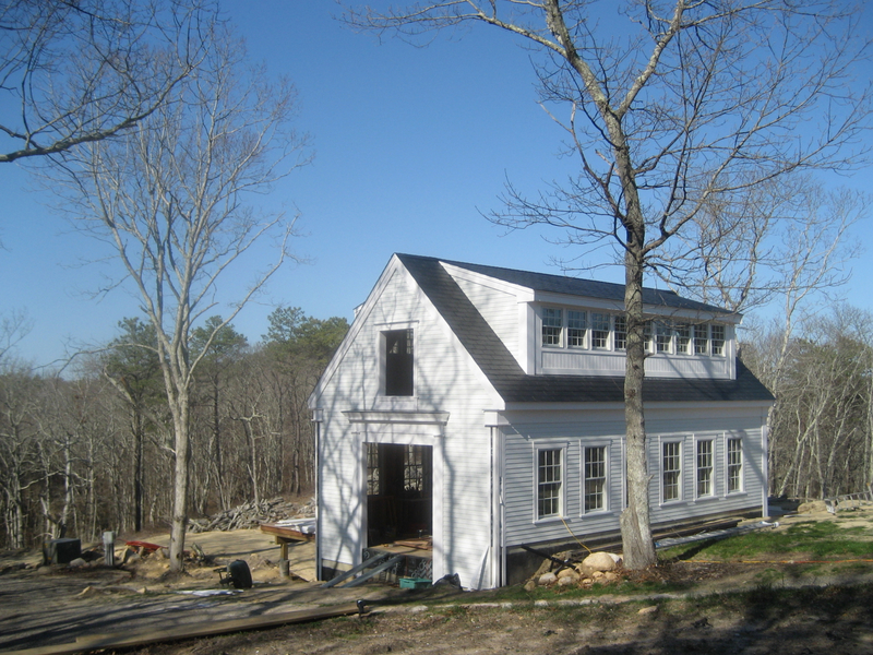

Here are a few more from different perspectives. Like I said, I framed it for parking on 2 floors, but wasn't comfortable with the lintel a full 8' would give me below, so that door is only around 7'4 or so high.
The back shows how I'm doing the corner boards. Still haven't finished trimming out the back door, but it'll be a pilaster and cap like the driveway side.
As you can see, I've got a LOT of landscaping to do, unless I can convince people I'm going for an "on the beach" look. You can see lots of our quality subsoil lying sandily around. Can I just say drainage isn't much of an issue?

I'll take some pics for the framing details, but basically I used engineered wood I-joists 1' on center, with blocking every 2' or so. Steel beam down the center on 4 lally columns. Deck is 3/4 advantech, 2 layers, laid perpendicular.
All that was spec'd and signed off by a local engineer. Only $500 for the engineering of the building, which I thought was ridiculously cheap. A fair amount of engineering went into the foundation, it's on cantilevered footings. I told him "General Rommel will be pleased" when he handed me the foundation drawings, it was like the Atlantic Wall in Normandy. The upstairs is also engineered - split structural ridge of LVL

Made the corner boards myself out of azek and azek knockoff (Mainly rhino XO, it's cheaper.) The actual "corner" of the columns is Azek - the make a 5/4x5 or so premade corner. I'm big on proportionate masses, so that was way too small for me.
So I put an azek cleat up to butt the hardiplank up to. Then I padded the corner - you can see on the ones that aren't done yet, only 2 are finished. Put a 1x12 piece of azek (rhino actually) on each side of the corner, than put the azek premade corner over that. Balanced it on the other side of the pilaster with a piece of 5/4 to the same rip, overlayed to form a J channel over the hardiplank.
Hopefully that'll make sense if you look at the pics. I wanted some strong greek revival allusions
