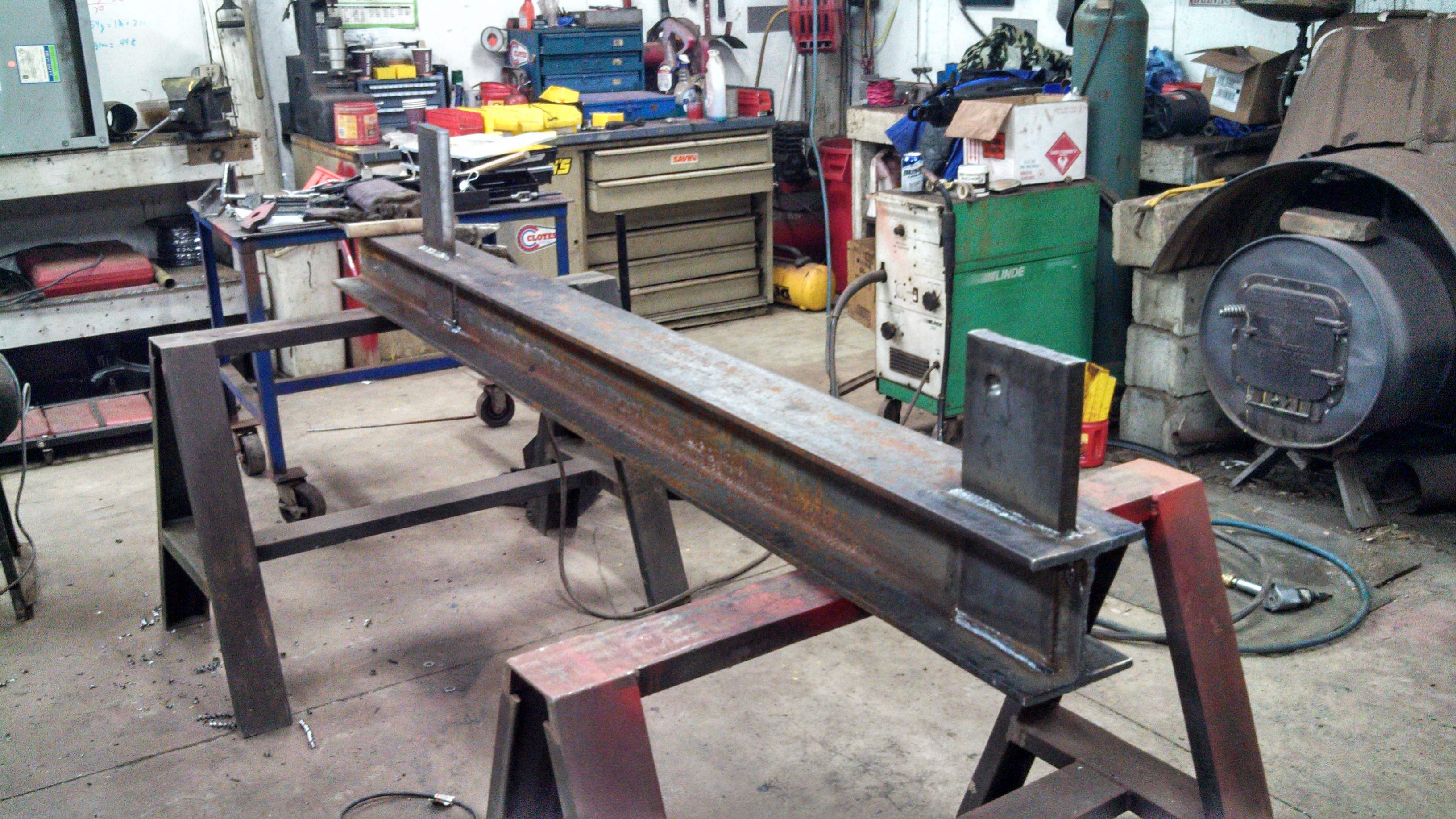

Some of todays updates:
Got the axle drug in and some framework scabbed up:
IMG_20140318_102814_852.jpgIMG_20140318_110547_066.jpgIMG_20140318_110556_560.jpgIMG_20140318_110616_318.jpg

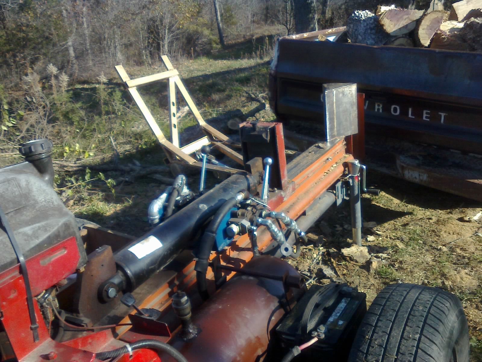

I'm trying to figure out where you are going to stand when putting log on and then operating the valve control? I don't think you need that much oil capacity. I have same cylinder and 16gpm pump with 8-9 gal reservoir and no problems with heat or low oil and that's with a log lift.
/ My LOGSPLITTER Build
#34
There is pleanty of room to stand right there. May be hard to see that in the pic.
As to the oil...
I am running a 22gpm pump and forcing it through small 1/2" ports at the cylinder. So that will add heat. And looking at most higher end splitters, their oil capacity is roughly the same as high pump flow.
So keep in mind that even though it looks big, all of that oil is cycled every minute.
Plus it is just what I had and was easier than fabbing a tank from scratch, or buying something different.

I stood on a chair so I could get an overhead shot to better show the room to work. The pipes and framework for the "table" only stand out from the beam 8". So plenty of room. I stood there and "pretended" to be splitting wood before I located the valve and the table. The locations of them now were most ergonomic for me.

I like the engine with part of mower since I did virtually the same thing with rear engine Snapper. It's hard to tell in my pics as well. The engine is sitting on the rear of beam and the running gear is a 49?? chevy rear with closed style driveshaft which doubles as the tongue.
