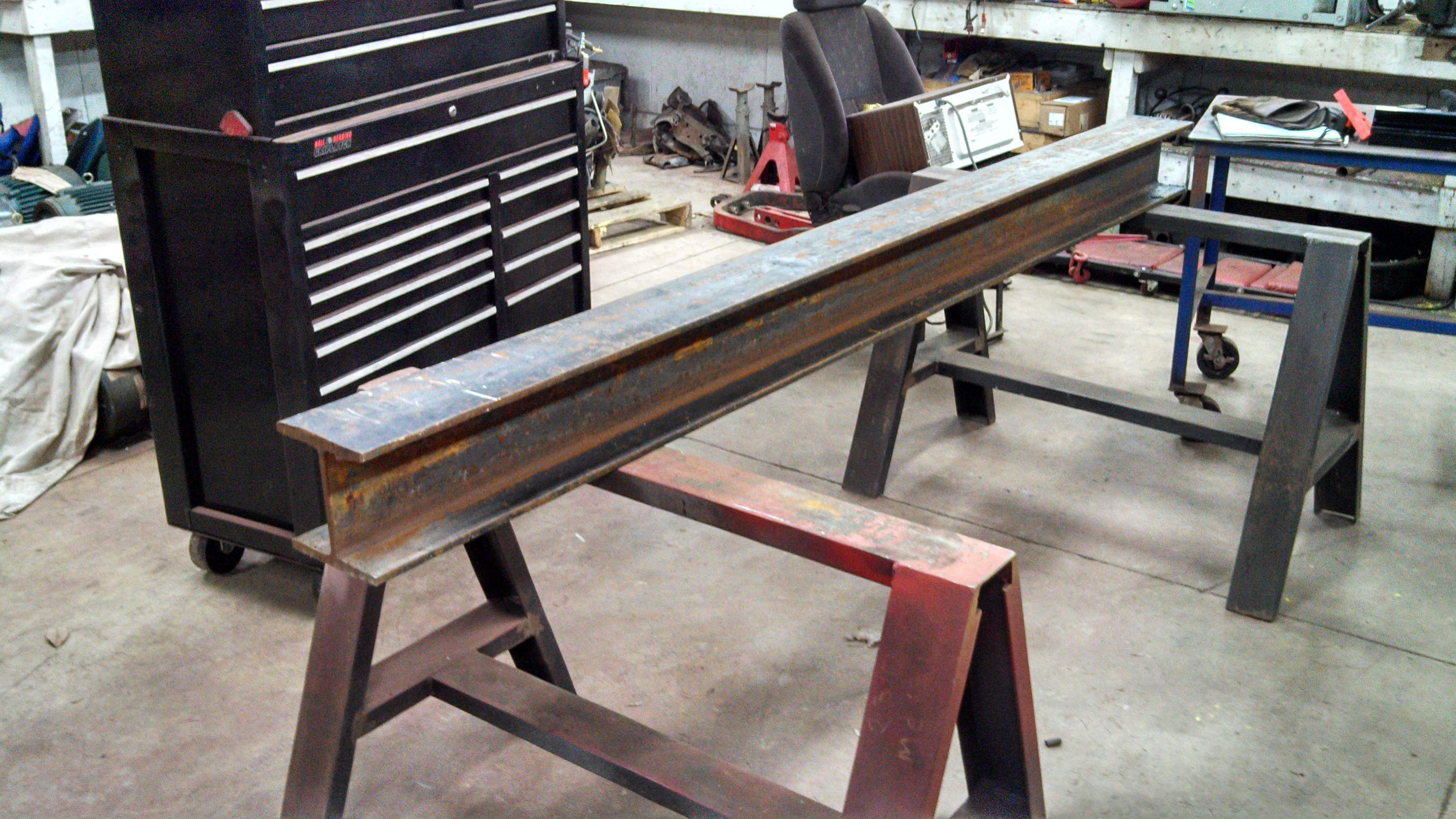

Over the past few months I have started a few threads and asked lots of questions about building my splitter.
Well, I am underway now. Cylinder, valve, pump, filter, and suction strainer should be delivered today. I already have steel, beam, tank, motor, and an axle to use. Will get hoses made once I get things assembled and figure exactally what I need.
This will likely take me a few weeks, but will keep things updated as I go.

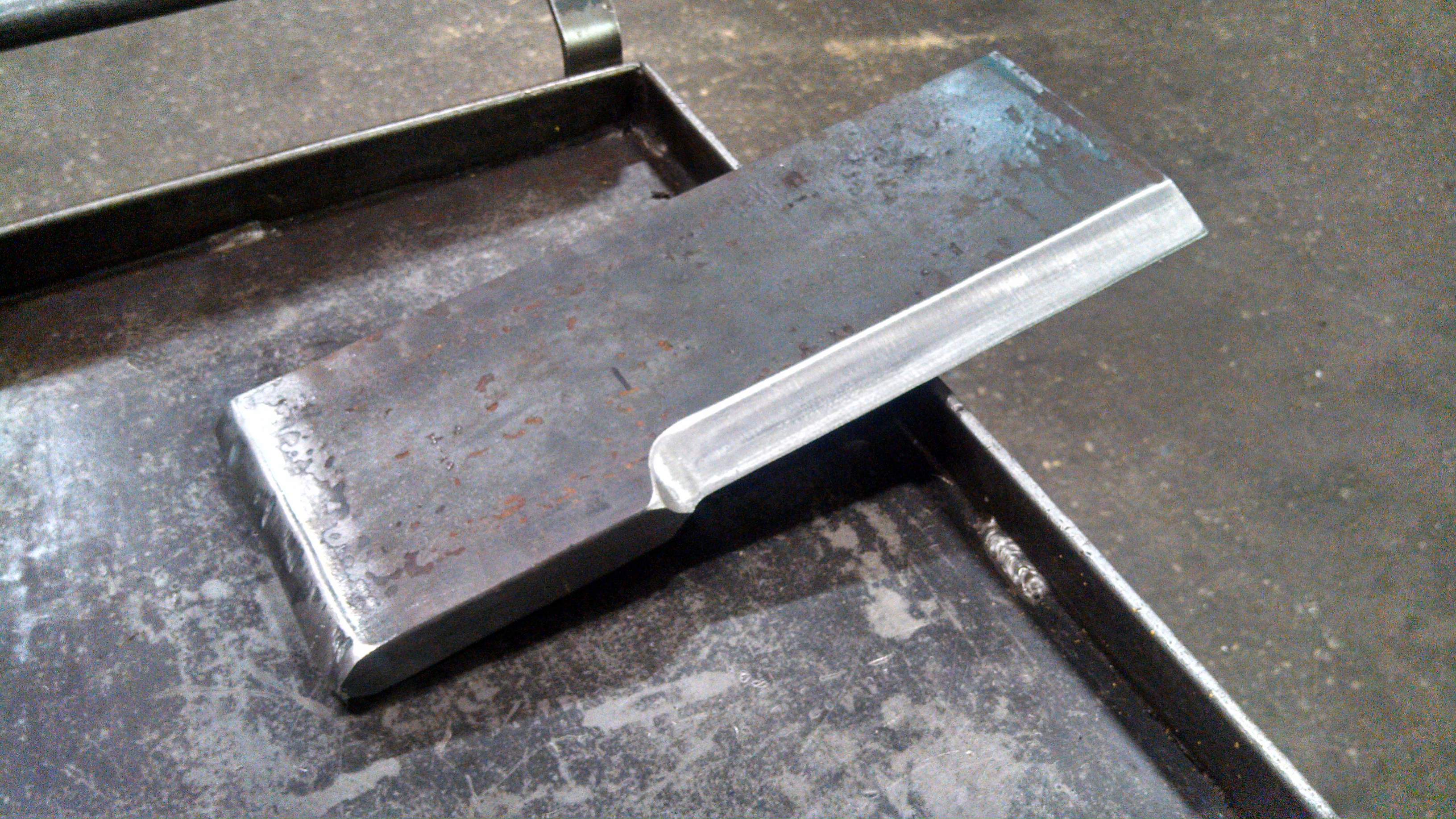

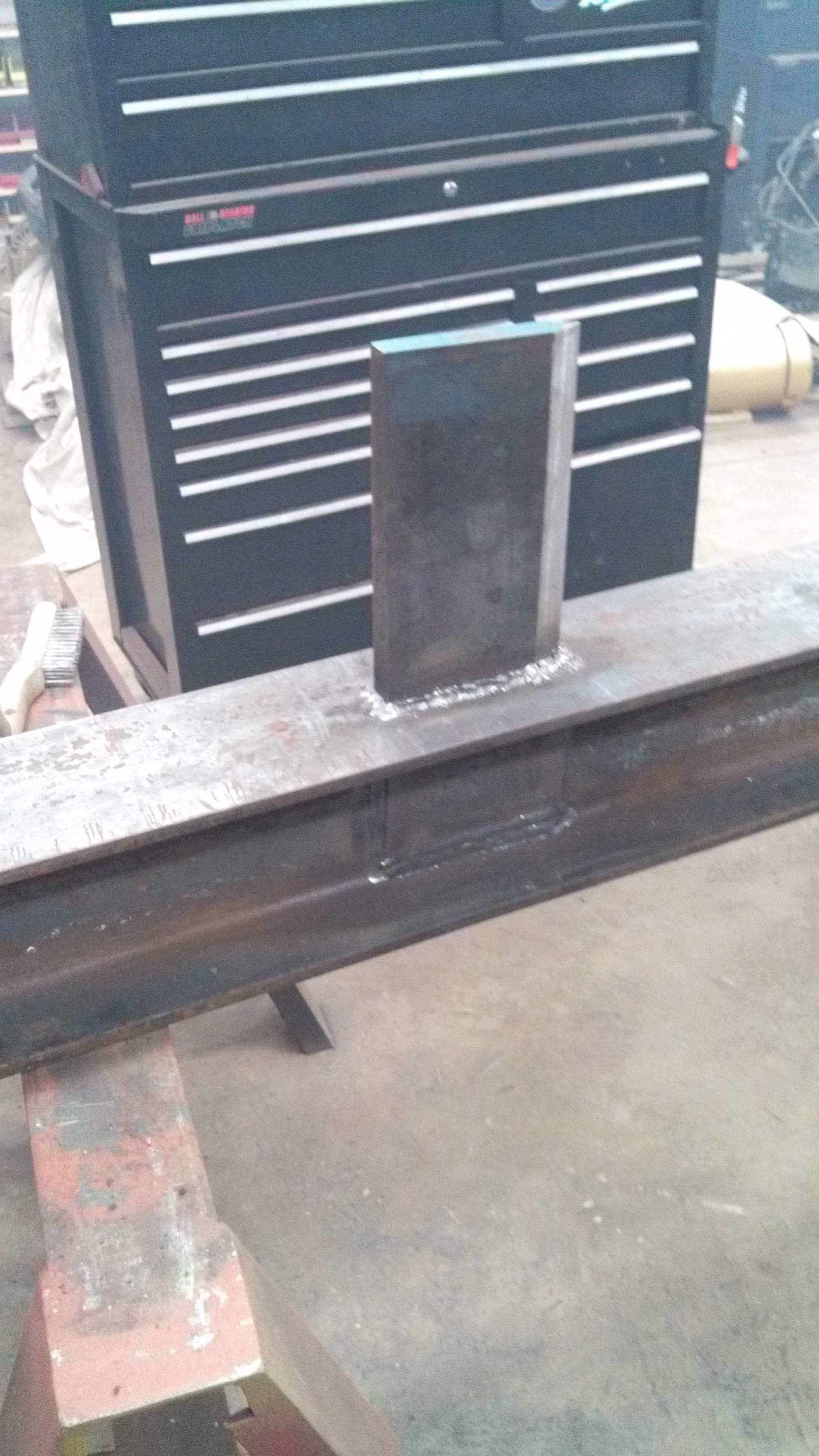

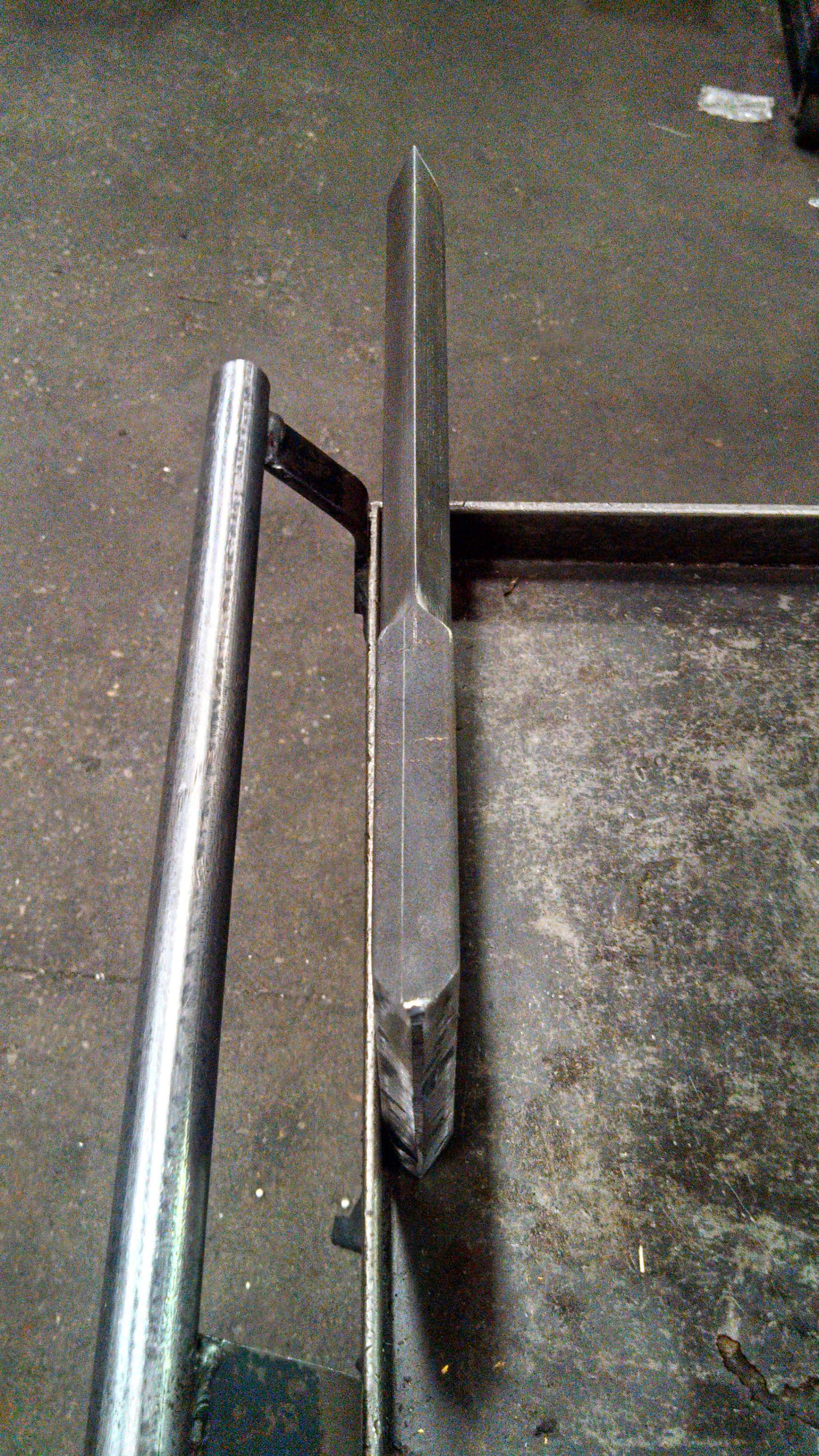

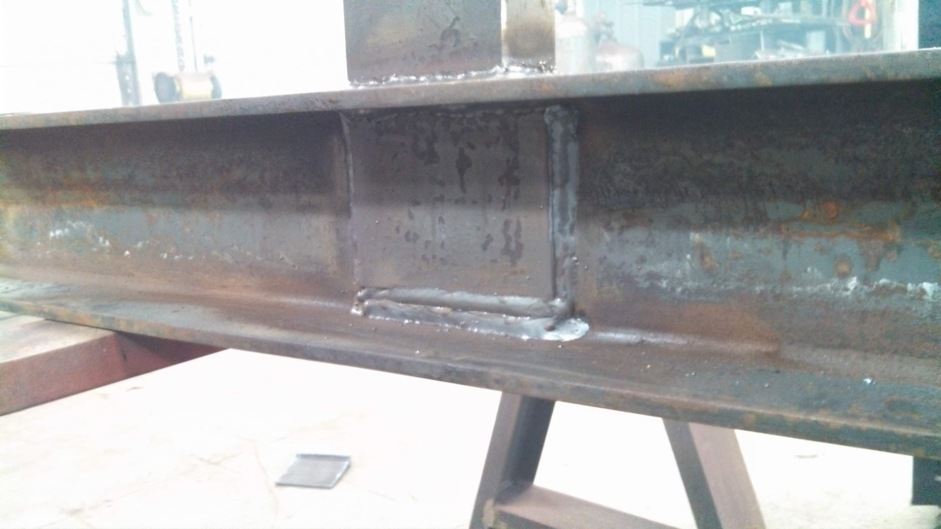

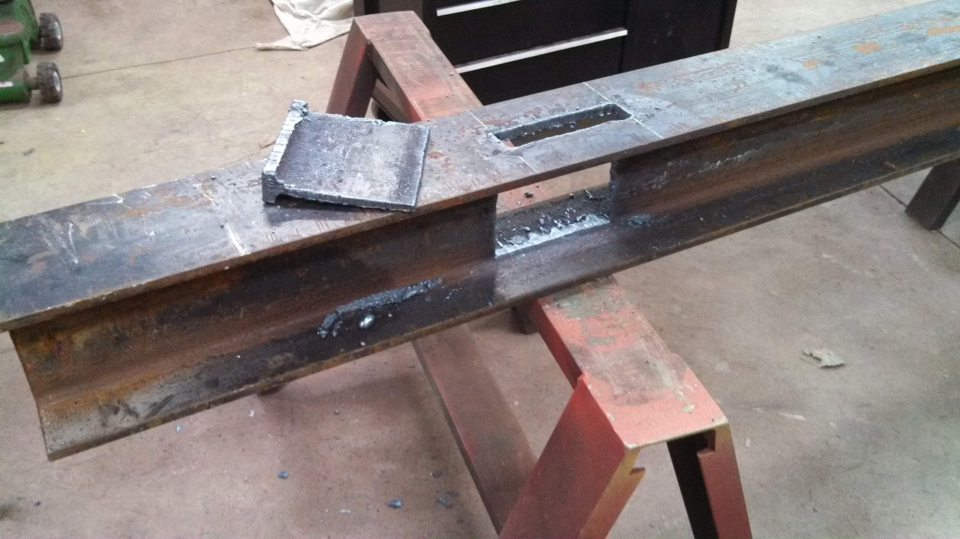

Here is some shots of the wedge and beam. I took shieldarc's idea for how to attach. And I left the beam long for a good secure point for attaching the table.
Here is the wedge and beam.

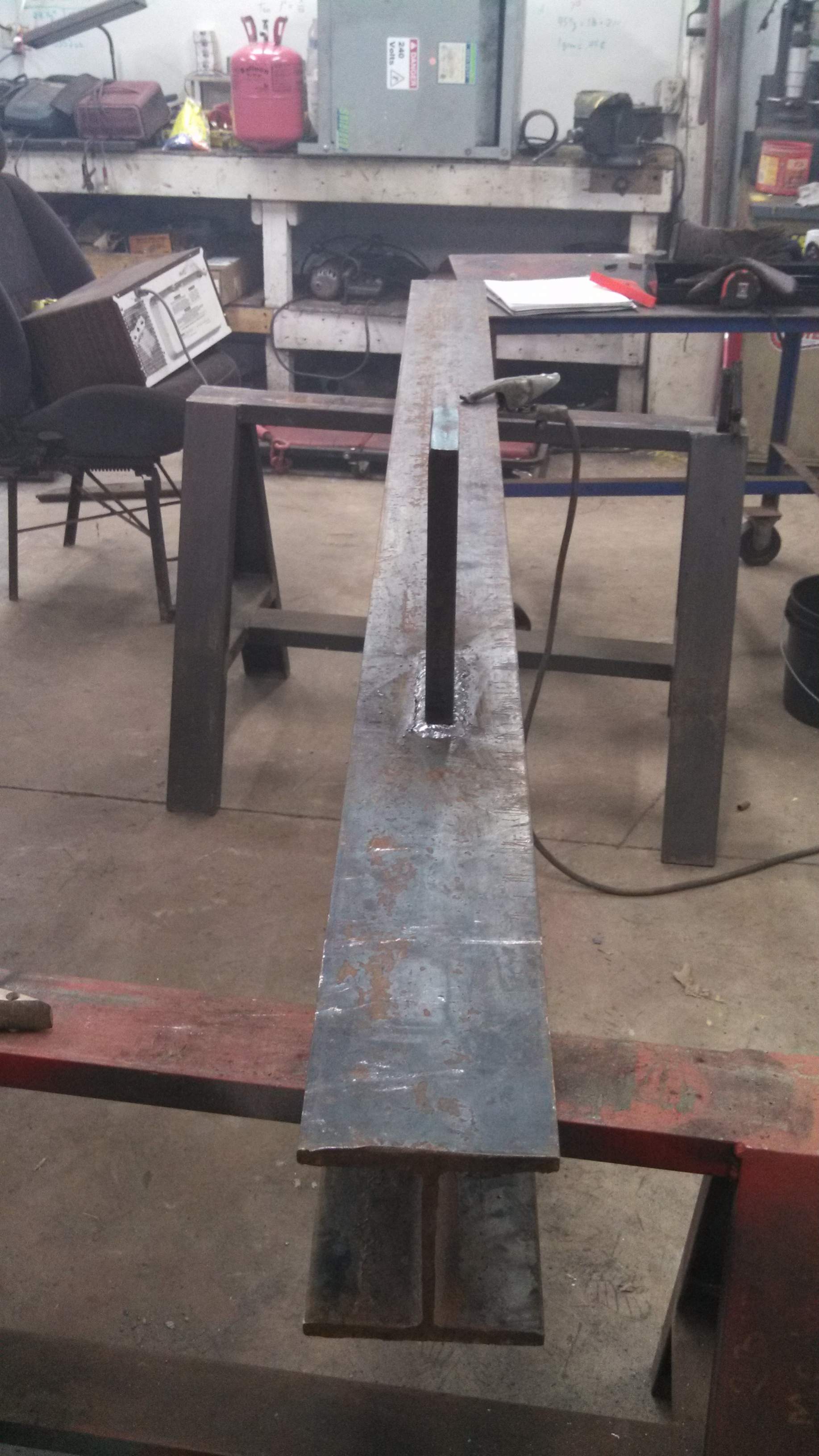

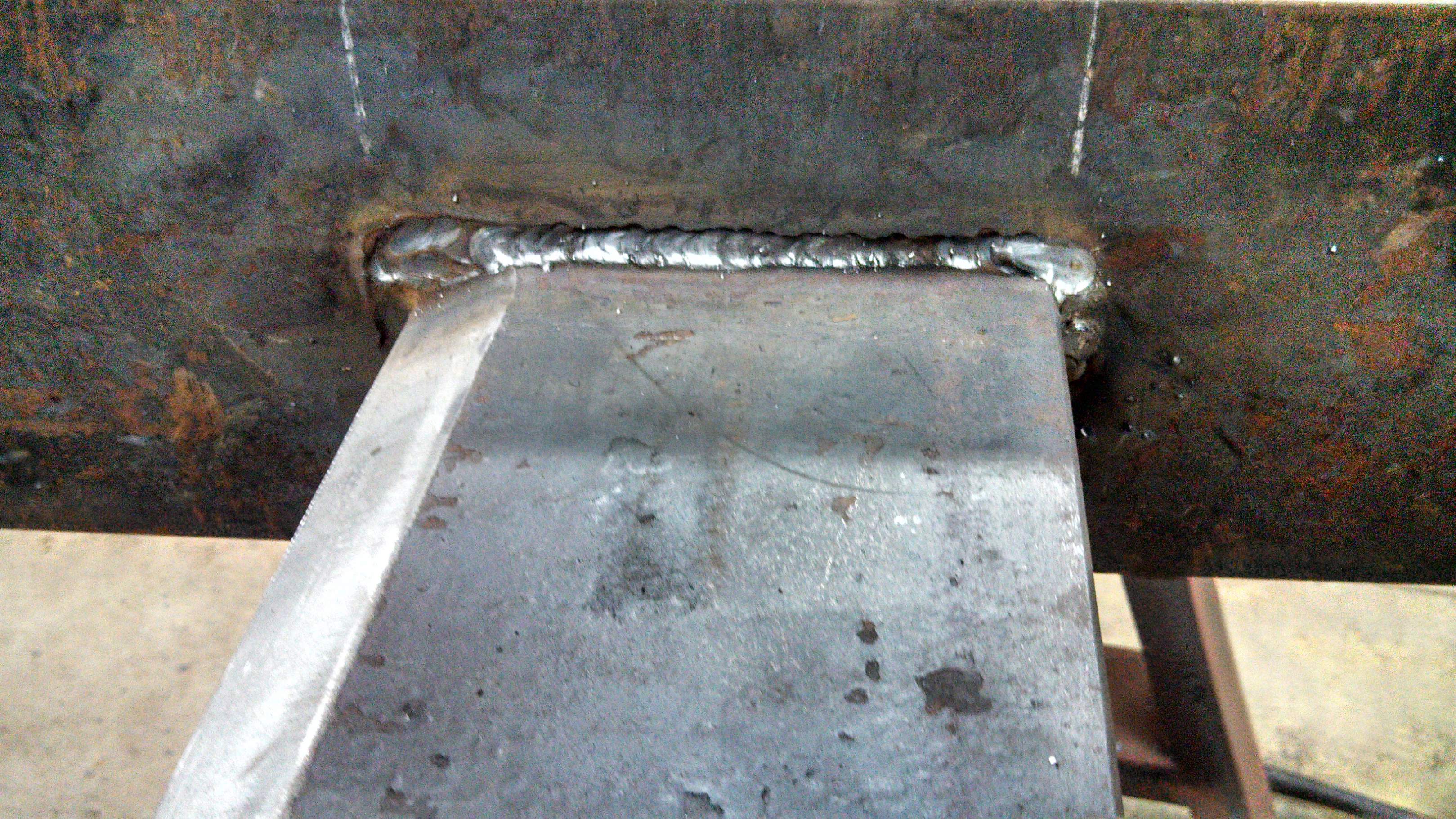

Some root passes to close things up before I switch to spray mode on the welder.
And the beam and wedge being one. I think the lowly piece of 1" x 6" hot roll will rip in two before the welds break.

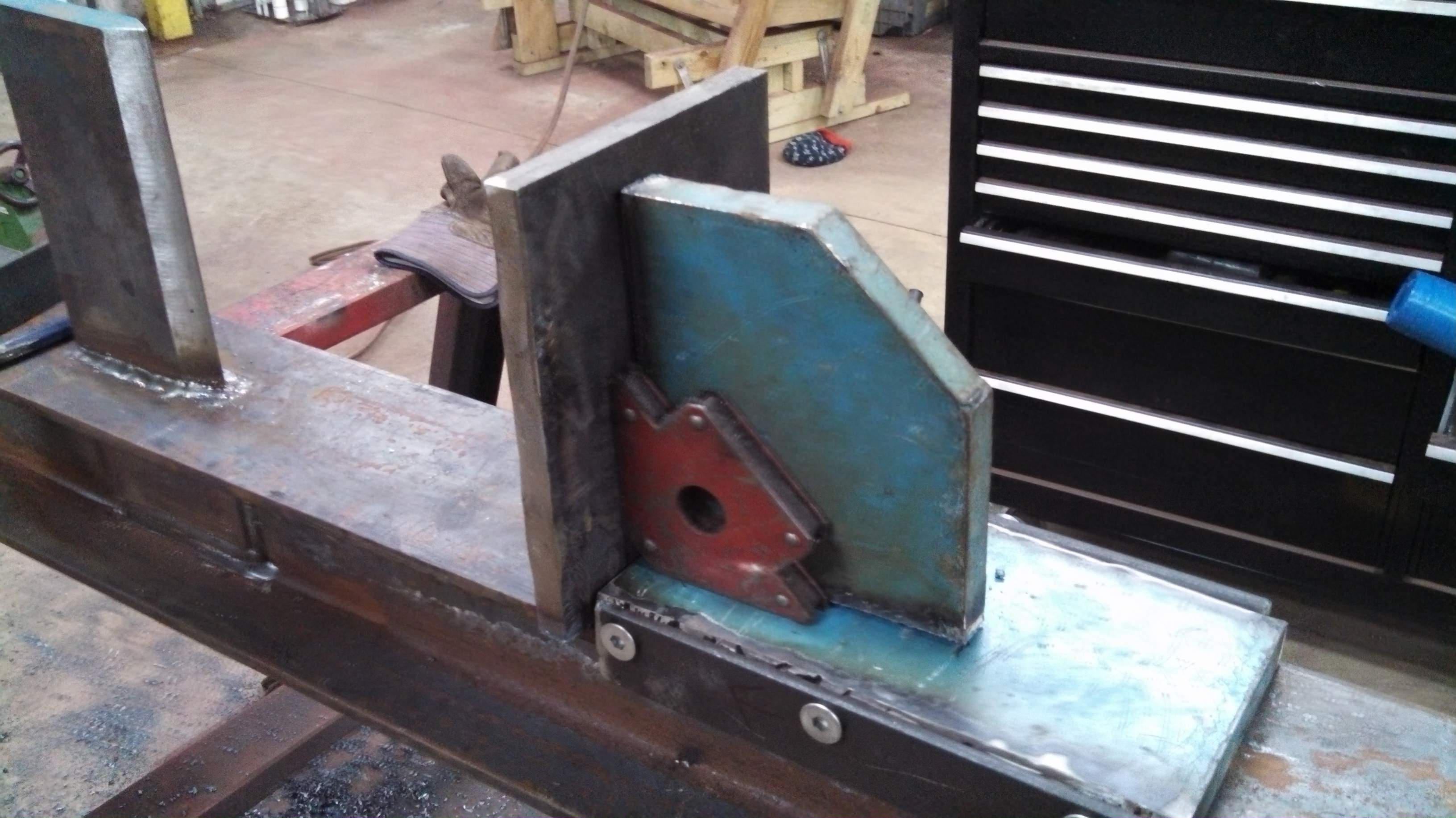

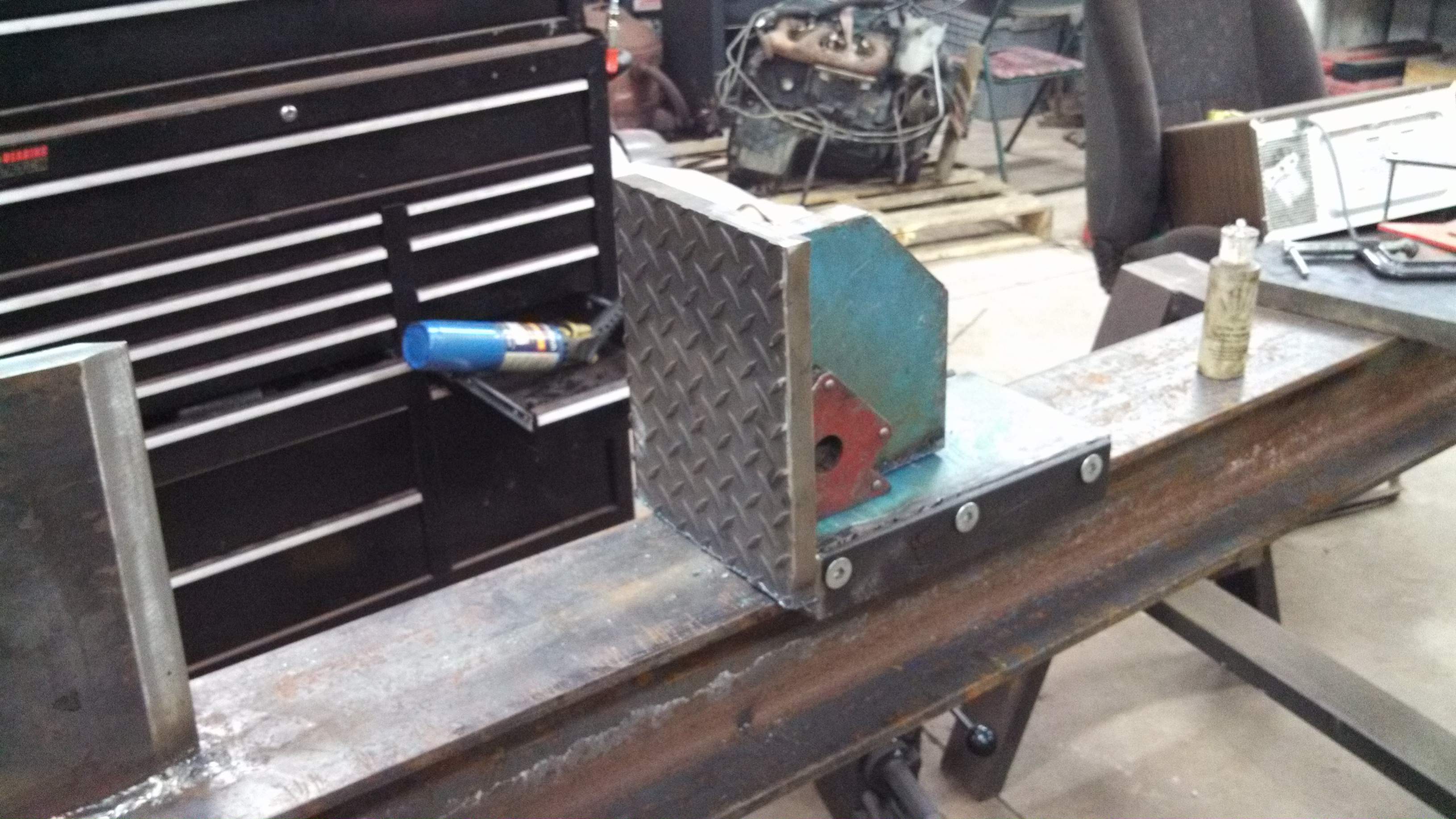

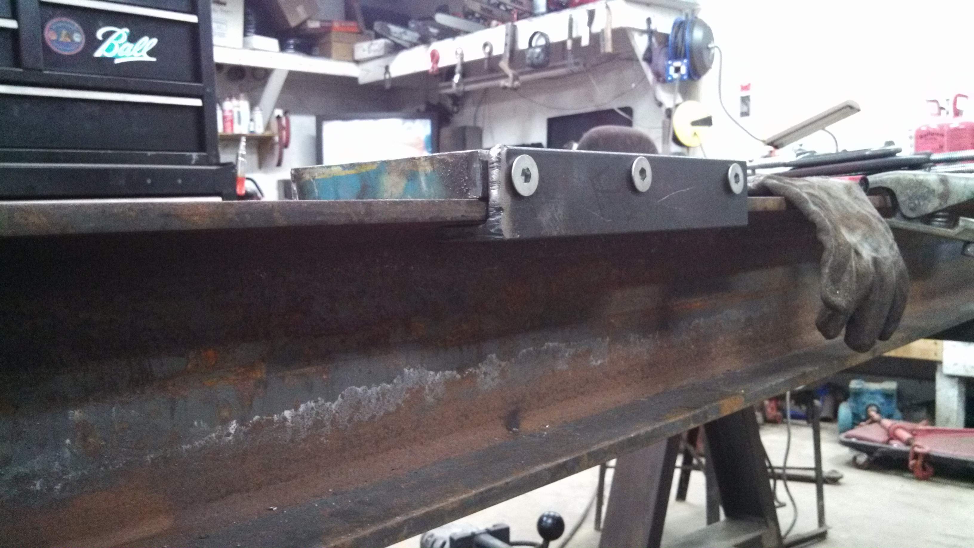

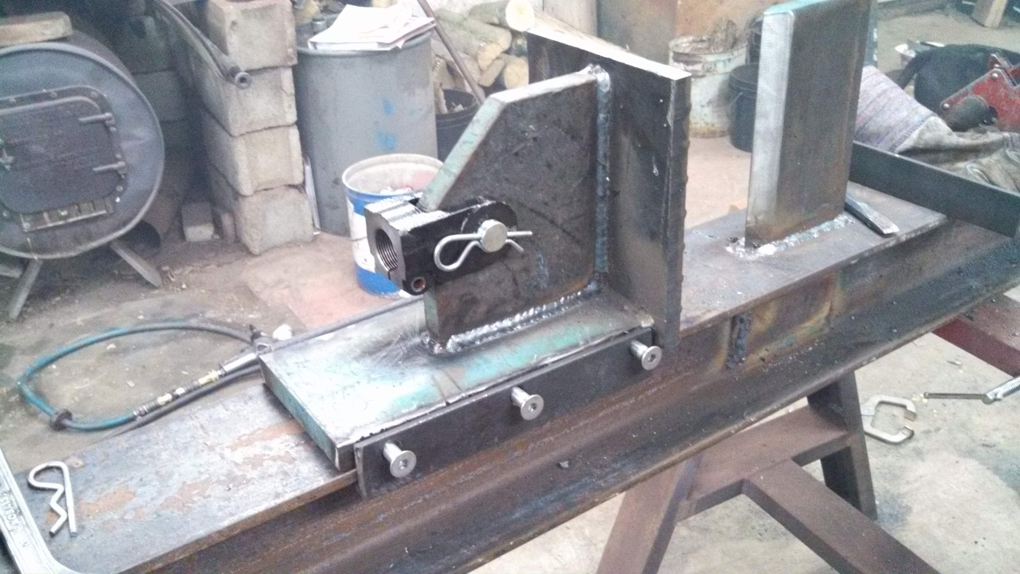

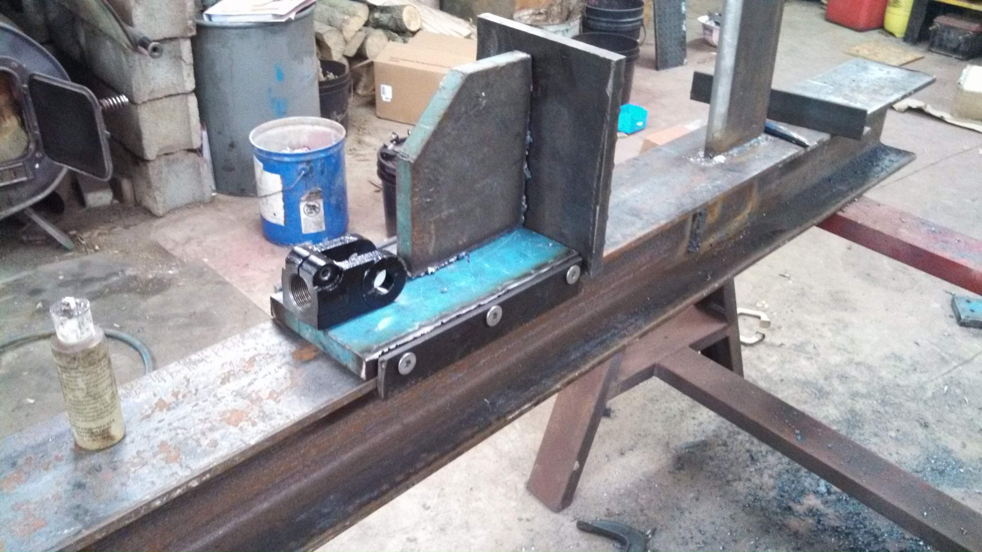

some shots of working on the pusher plate.
originally I wanted to copy speeco's design with their "log cradle" to capture the pusher. But I decided to do it differently cause I am making a table to go aft the wedge. And didnt want that "cradle" being a catch point when sliding a piece around that needs split again.
Still got to drill the 1" hole for the clevis and then some weld time. I am going to make the clevis bottom actually touch the part it is attached to. This will allow it to share some of the load instead of all of it being on the pin.
IMG_20140317_155948_674.jpgIMG_20140317_162127_441.jpgIMG_20140317_162134_604.jpgIMG_20140317_162152_270.jpg
/ My LOGSPLITTER Build
#9
Got the pusher assembly complete.

Nice build and I think your "driven" log splitter idea would be very cool even if you don't use it much. Just to show it off to your buddies would be worth it!
Oh, you're wedge will definitely not ever give you any trouble the way you did it.:thumbsup:

LD1 looks dang fine! what you going to put to hold the pusher plate down against the beam? the one homemade one I used way back when had a triangle plate (bent 90 on bottom) bolted to the pusher plate on each side. there were 6 or 8 1/2" bolts holding that to the welded up pusher plate which had 3/8" x 2" plate bars welded to the upright and the horizontal pusher.
Look close at the first picture of post #8. It is a piece of 2x2x3/8 angle bolted to the side of the 1" thick base of the pusher.

#15
Here is a shot of the cylinder base mount.
Done up the same way as the wedge.
