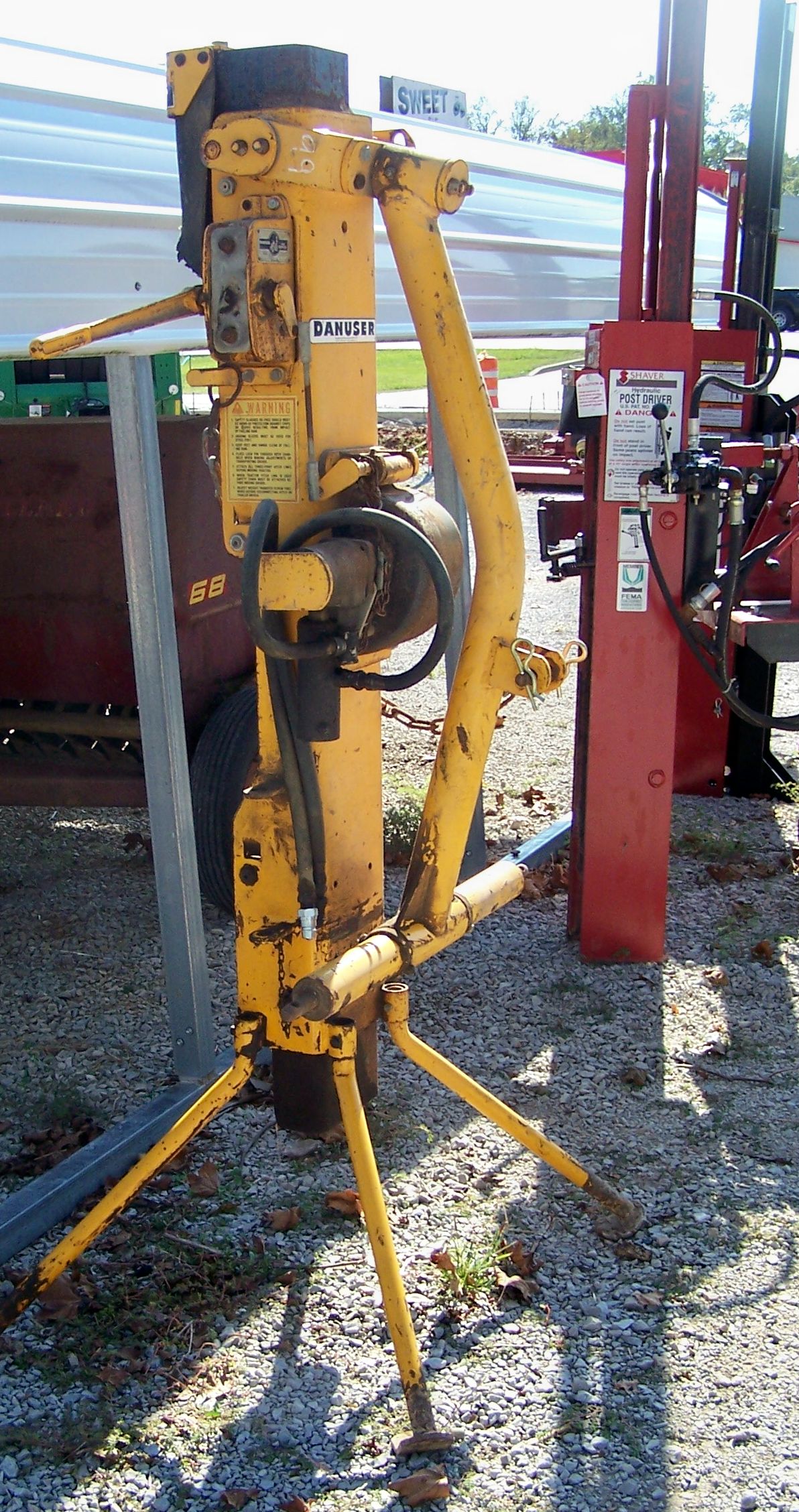

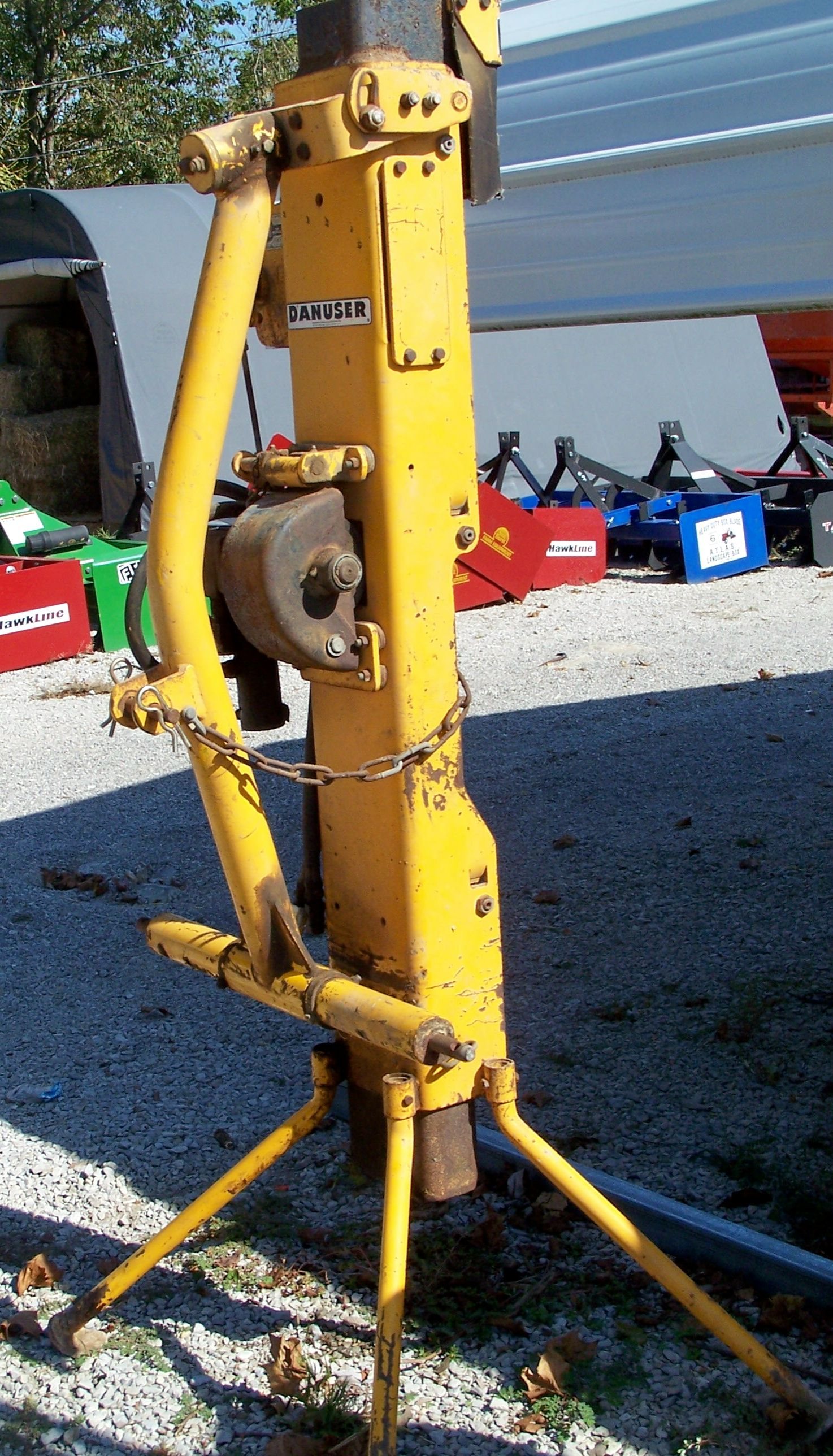

Somewhat related, we just got in a nice used hydraulic driven 3 point post driver made by Danuser. $1495. Ken Sweet
