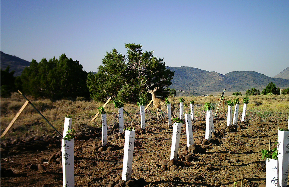

I'll come clean.
My first fence in 2017 was inspired by whatever I found on the internet. And what I found said "deer cannot jump up and out at the same time". So I put together something that was about 8' wide and 4' high.
In these 3 photos in series you can see the complete disregard this muley had for my "fence". From the crouch-and-spring in the 2nd photo to the sailing-over in the 3rd, this doe delivered humble pie.
Anytime I think I'm smart, I just look at photo 3.

I'll come clean.
Yep, been there, done that. I finally called Game & Fish Department to ask them what works. They said to build a solid 8’ high fence. It has worked for me for 8 years now.
