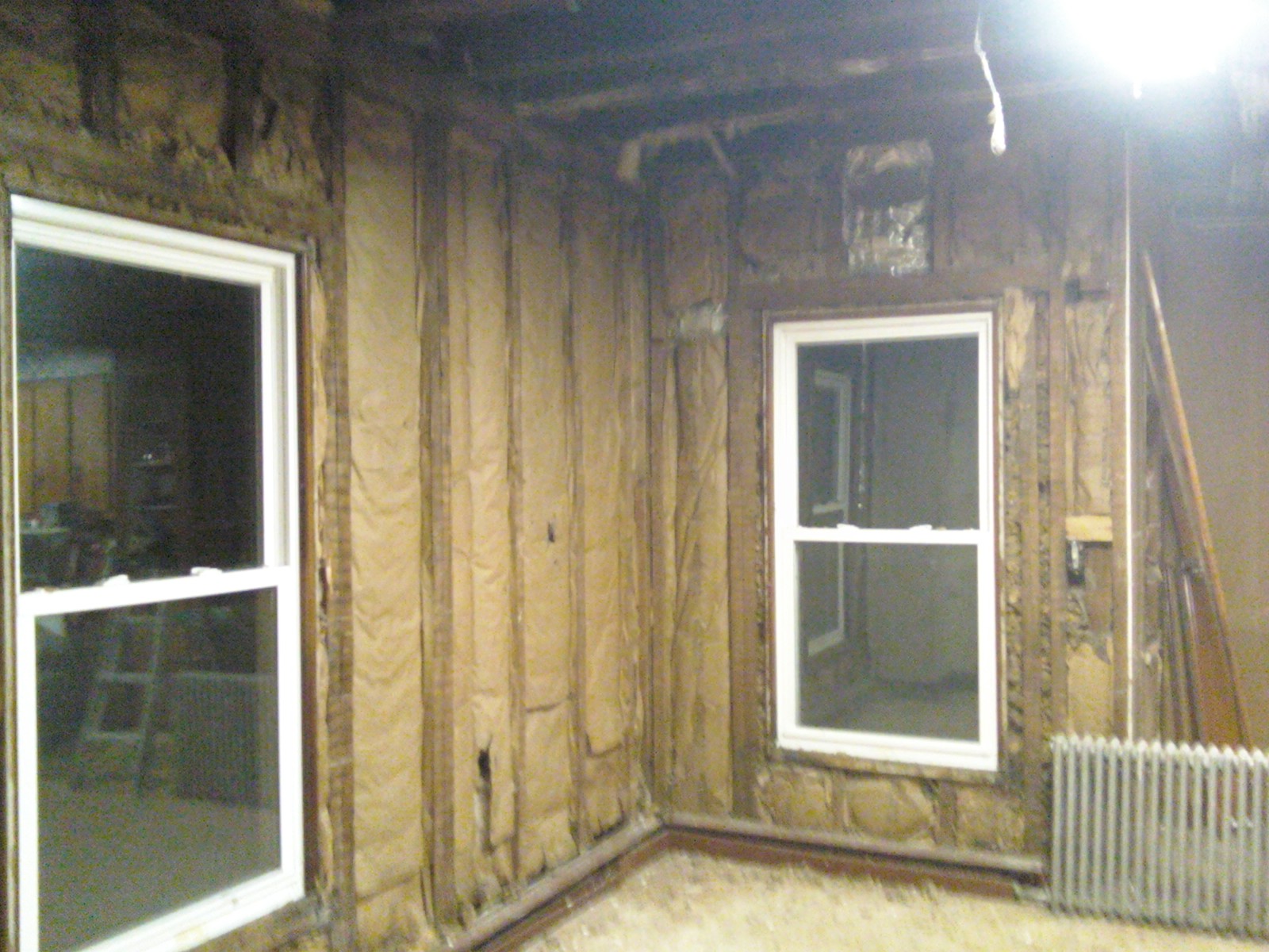

Well now that winter is here and work is slowing down I have been able to work more on my house. The one living room is almost completely stripped of lath and plaster on the ceilings and walls. After that I have three more ceilings to drop down then I can start installing the radiant pex tubing. I did buy the new boiler and boilermate hot water tank.
The boiler is the ECR International 97GB which is a 100k btu unit and 97% efficient. ECR 97gb It is a very slick unit and can be hung on the wall if you want. To me it looks basically like a instant hot water heater but about twice the size. It weighs just over 100 pounds and even with my bad back I was able to unload it from my truck and bring it in the basement by myself. Its amazing how small these things are getting but this one has a cover that when removed opens up most of the boiler parts making it easy to access and maintain/repair in the future.
The hot water tank will run off a seperate zone from the boiler. It is a BoilerMate WH41 by Amtrol Amtrol - BOILERMATE . I had this unit in my house I had in town and it was very nice. No need for two seperate units, just one unit (the boiler) to worry about maintaining.
I need to check but I know the boiler will qualify for the tax rebate and I think the hot water tank will qualify as well. The boiler was just over $4k and the boiler mate was around $900. So they will max out the tax rebate which is good as that helps pay for the radiant system.
I will add pics once I get the system set where I want it. If anyone has any questions feel free to ask and I will do my best to answer them.

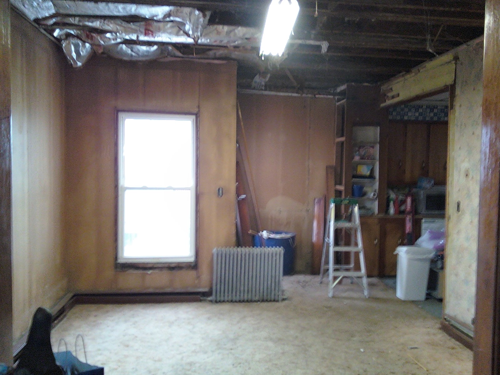

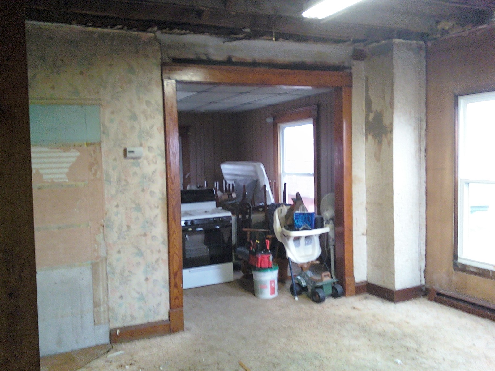

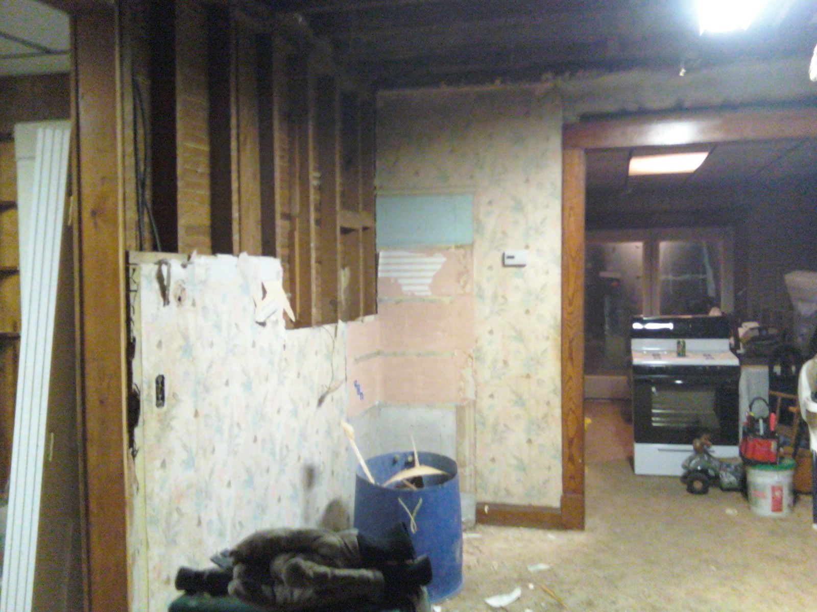

Well its been a long wait as I have been waiting to have enough time and money to work on my house properly. I don't want to do something and not be happy with it so I am lucky in that I have no time table to be done by and can work slowly.
What I am doing now is trying to layout the kitchen. I am trying to attach a floor plan showing the kitchen and dining room areas. The long 20' 10" wall is the back wall of the house overlooking the orchard and barn. I want to have a little nook area at the left of that wall where Ava can do homework or just have a little spot to eat breakfast or what ever. The reason I am showing this to you guys is that I need ideas. I am going to have a dishwasher under the counter as well as a double basin deep sink. I have installed basic kitchens on jobsites and such but never been involved in designing them. The stove is just a basic stove/oven unit I bought at the local appliance store as well as the fridge. So can any of you guys (or gals) help me figure out a good way to lay this out? Anything I should consider or stay away from as far as islands or cabinets or ???
I am not sure the type wood I am going to go with for the cabinets yet but I don't think that matters. The floor will be a tile of some sort but again, I have not got to that stage to really need to worry about it yet. I am just trying to get this figured out so I can do the electrical and plumbing rough in and be ready for the foam installers to do the walls.
I really am at a loss as to designing kitchens and bathrooms. I appreciate any help you guys can give me and hopefully I will be ready to start hanging drywall this spring.
