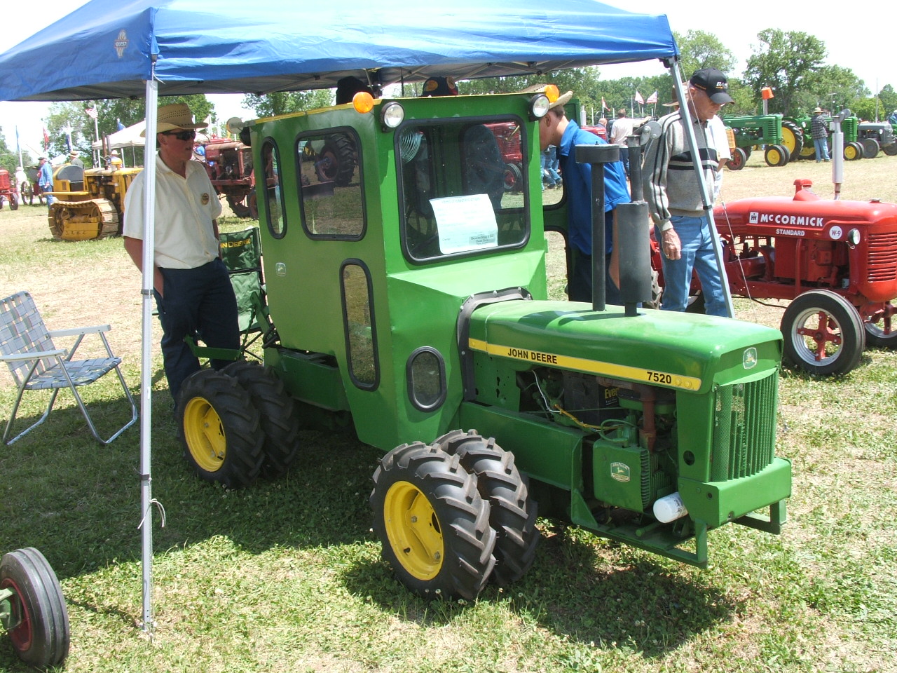

I was perusing YouTube (as I sometimes do) and came accross this video about a homebuilt articulated tractor similar to what you're proposing. I know a lot of your plan is done, but you may be able to poach a few ideas from this guy. His tractor seems very well built and very well designed.

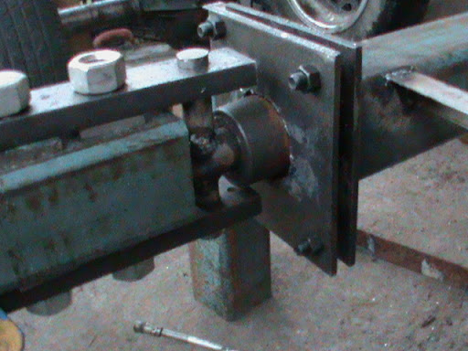

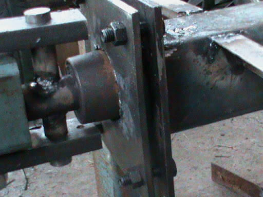

This is a very interesting project. I am wondering, will it be a 2wd or 4wd?
I'm pretty sure it's going to be 2wd. If you look closely at the pic showing the articulating joint, there is no provision for running a drive shaft though it. That's how every articulated 4wd tractor I've ever seen was designed. I suppose that a clever person could manage to drive the front wheels with an entirely separate means such as another gas motor up front, or maybe a hydraulic motor. But, in the case of this homebuild, I don't think that's part of the plan.

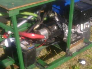

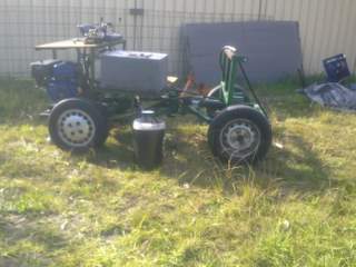

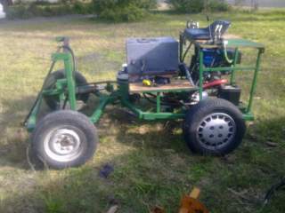

Over the weekend i started her up with the new pump and engine and low and behold it worked. Although it didn't steer i later found that the valve i used for steering didn't work so i connected the steering ram to my drive valve (two spool) it it worked although a little fast. Then the drive motor slipped on the drive coupling that was fixed by filing a key way in it.Then when i when to test it again it just wouldn't work i opened the tank and the oil was just froth so i am going to add a tube to the bottom of the tank and more oil. thanks guy pics up soon.

i did sort of the oil i cleaned all the hoses and resealed the tank stopped the oil contamination. it top speed is about 10 kph. i dont have any news at the moment as it am re building it. as it is just to dam wide i really should have done that when i started but i was only 14 and didnt know to much about that stuff know i have the experience i will narrow the axles and rebuild it.
