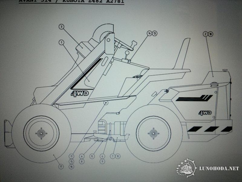

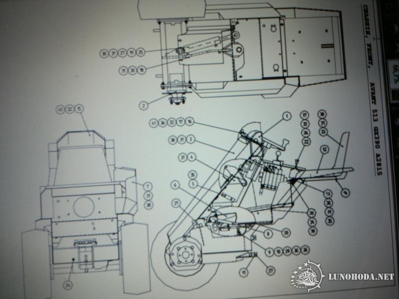

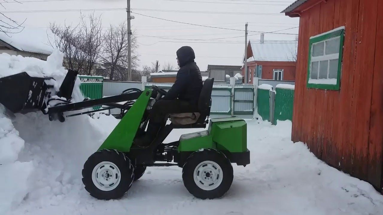

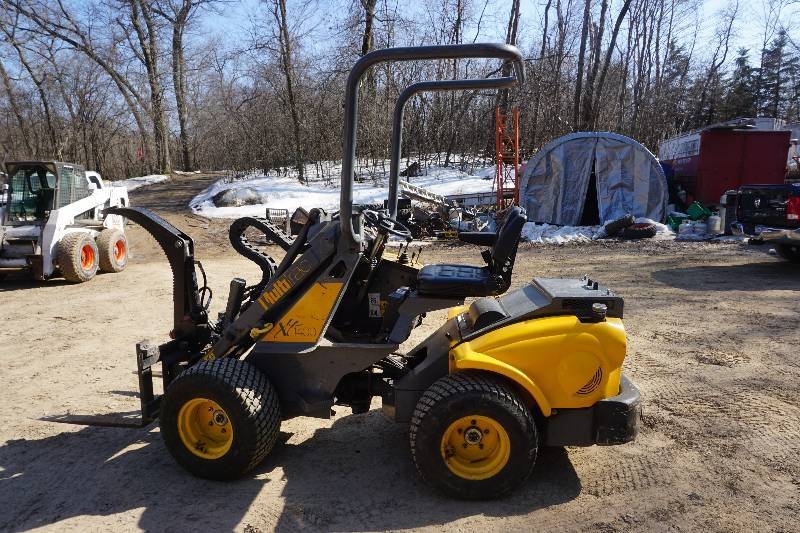

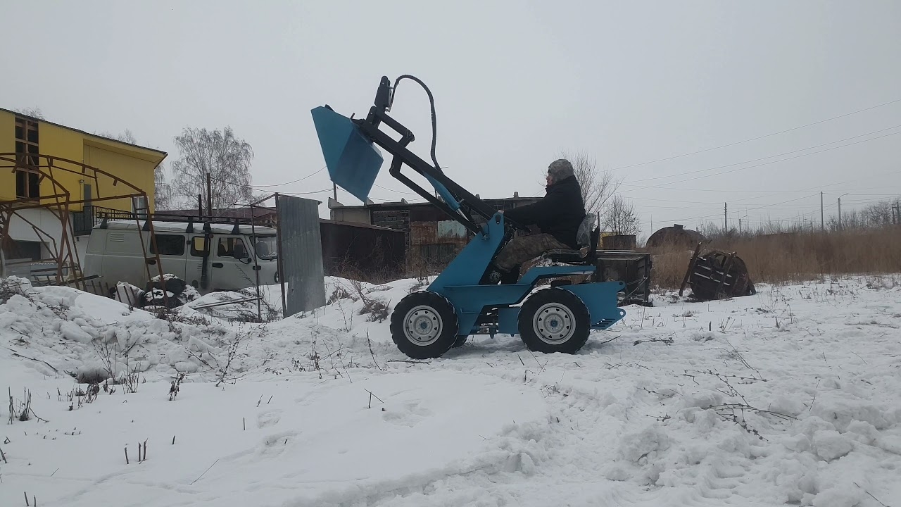

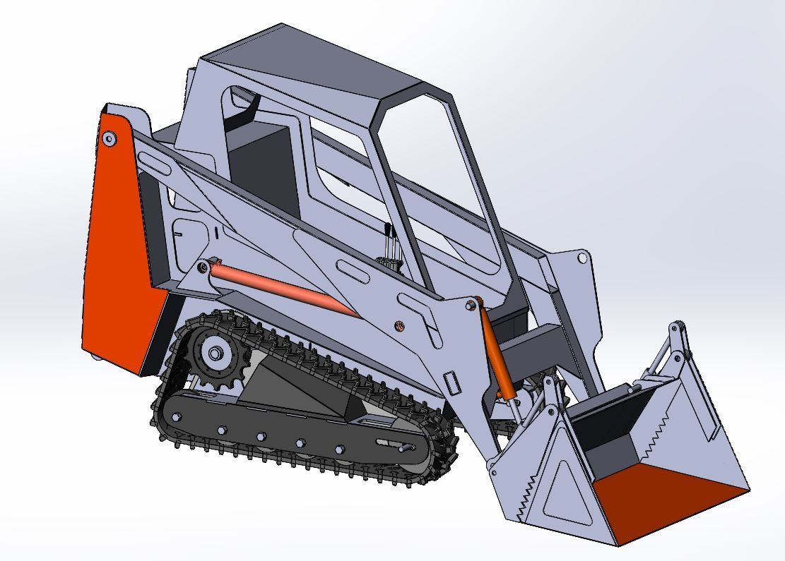

"Here you can see how the idea originated and what it has turned into today. There is such a machine in the family. This is where my loader was born."

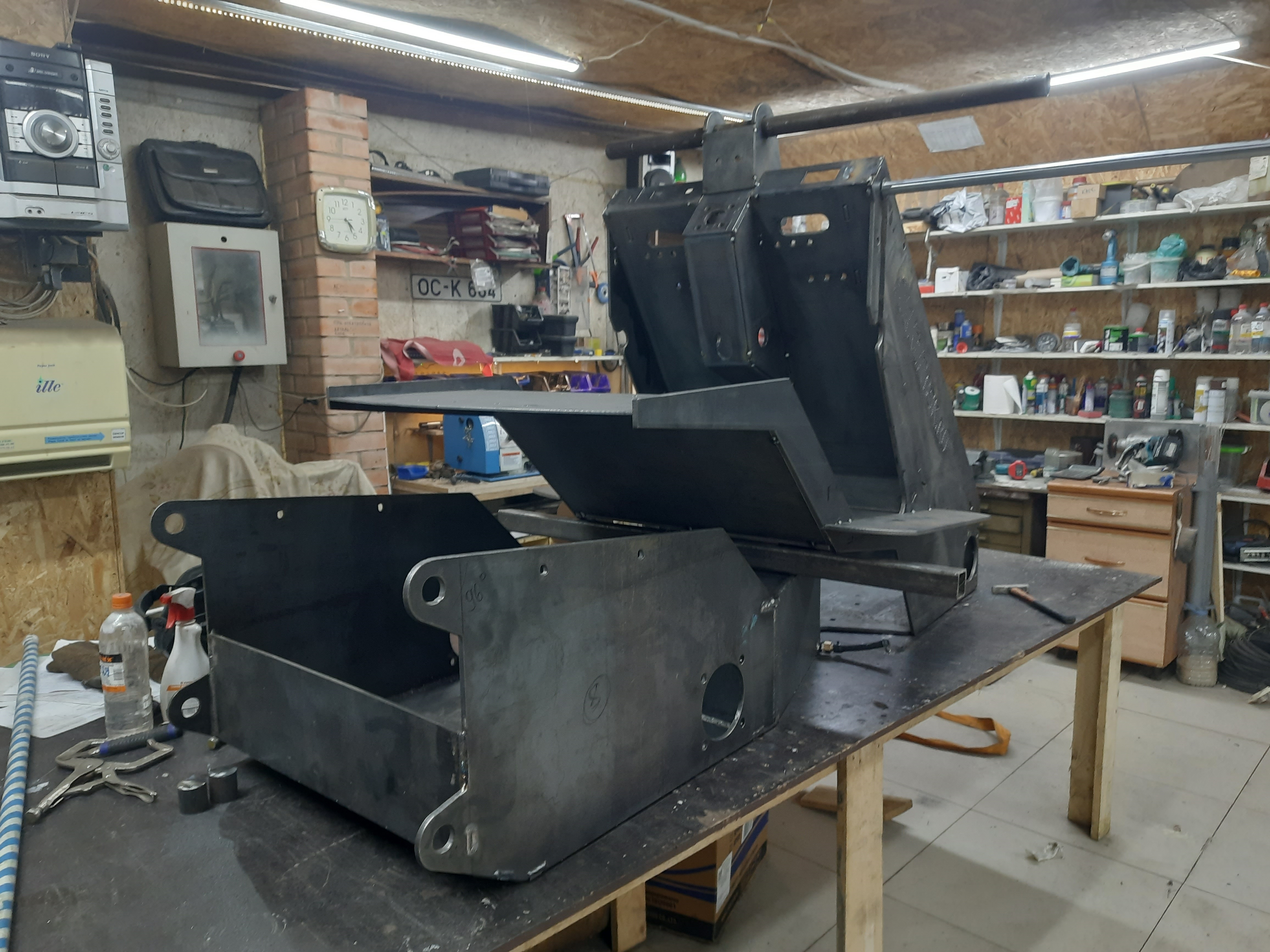

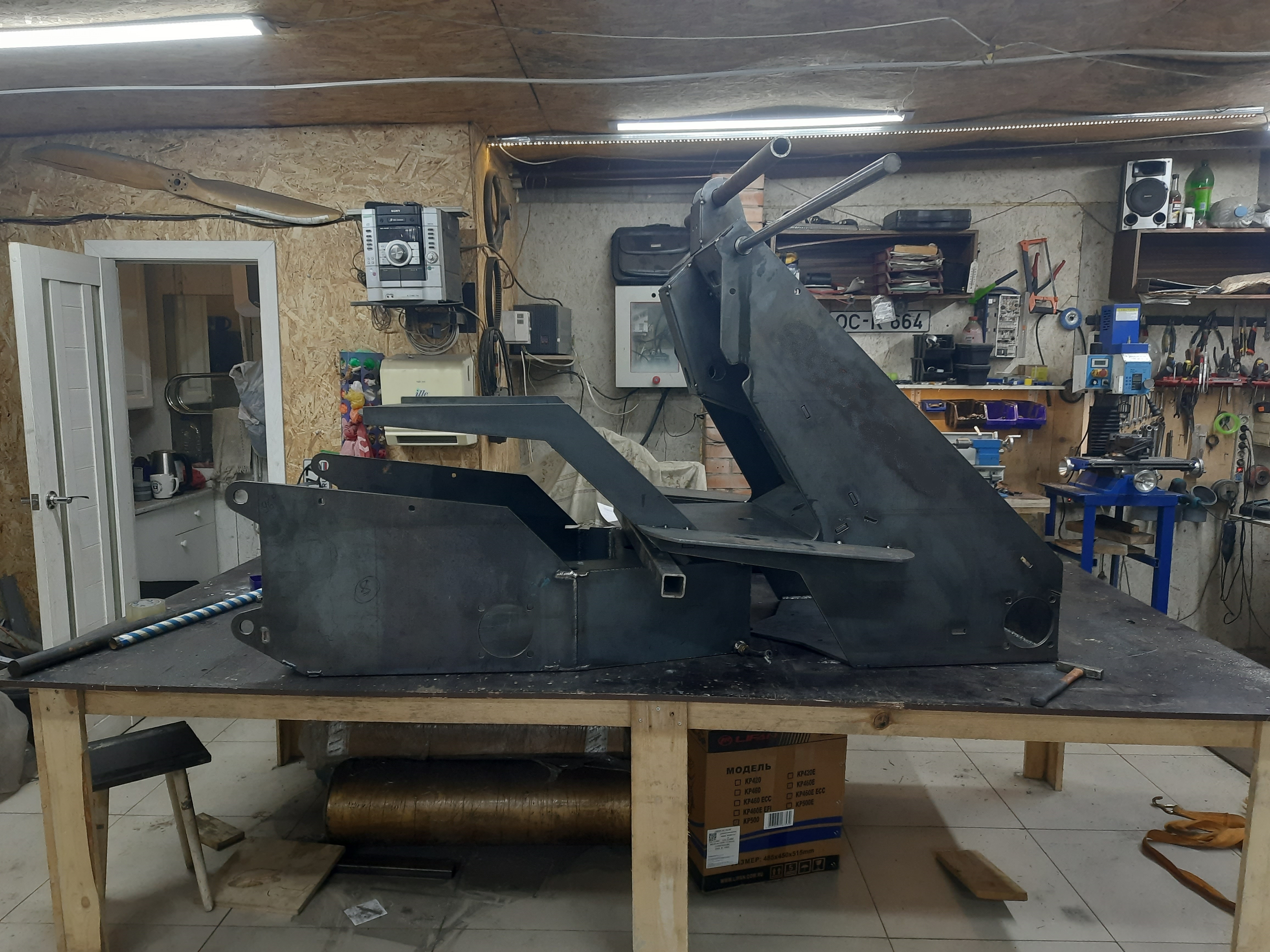

/ My homebuilt Loader 3B

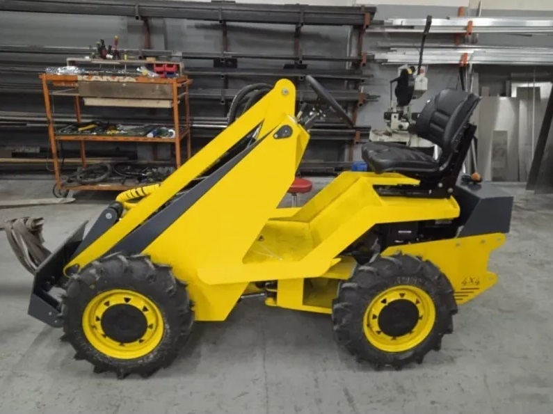

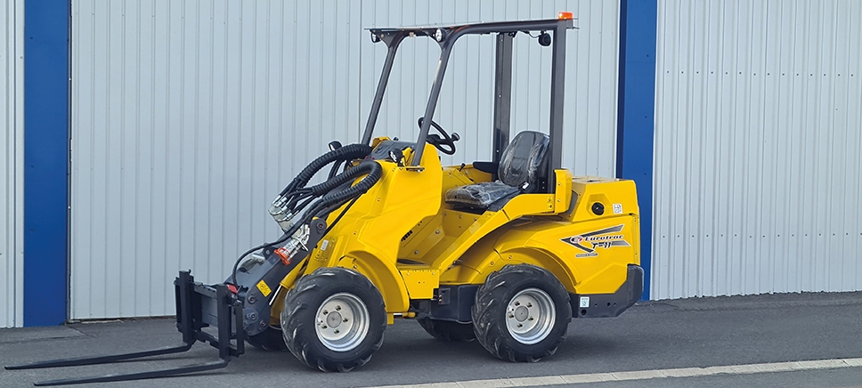

As a result, one of my compatriots assembled an intermediate version that greatly interested me. It is this version that you will see in the photographs below. I bought a DIY KIT set from him. The seller did not limit my responsibility for copyright and still sells kits for free use, without restrictions. I am grateful to him for this, as it provides a basis on which I can realize my personally designed machine. And this is very valuable to me as a designer.

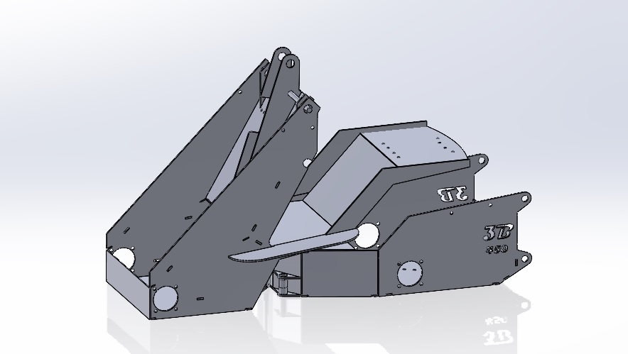

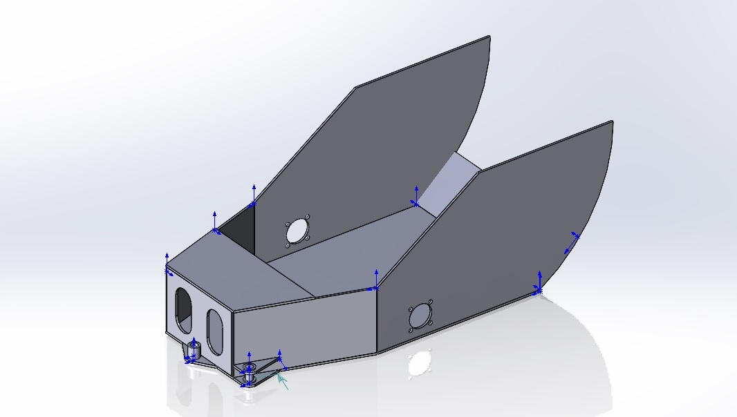

Now that I have the basic data, I can start developing my...

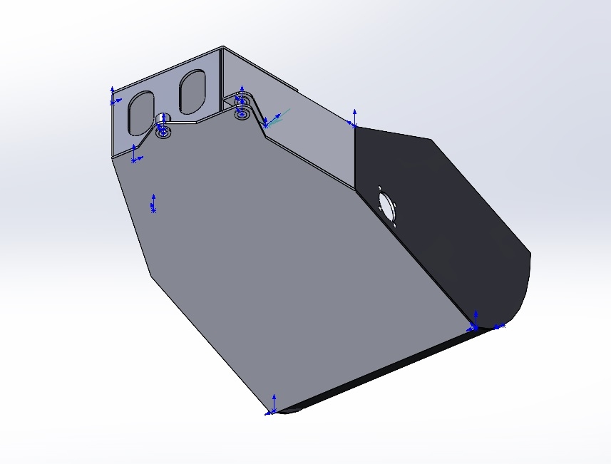

So far, it looks very similar. But I am just learning to work not on paper, as I was taught in the Soviet Union, but on a computer, in SolidWorks. It is a great program that allows you to change the sizes and shapes of parts "on the fly." It's really cool, and I enjoy learning, even though I am almost 50 years old...

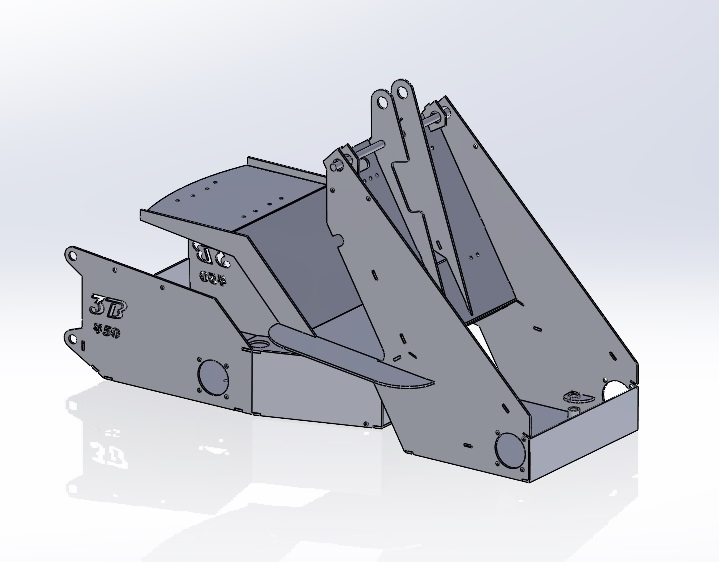

Thank you very much. You have no idea how important your support is to me! I spent 12 hours at the computer)))) And here is what I can show you. I could have limited myself to photos, but I thought you would be more interested to see how the boom and bucket work... There are still few of my developments here. Just the bucket. But, during the drafting process, I saw several important changes that are necessary for this design to improve its quality and simplicity. God, how interesting it is to work on this!

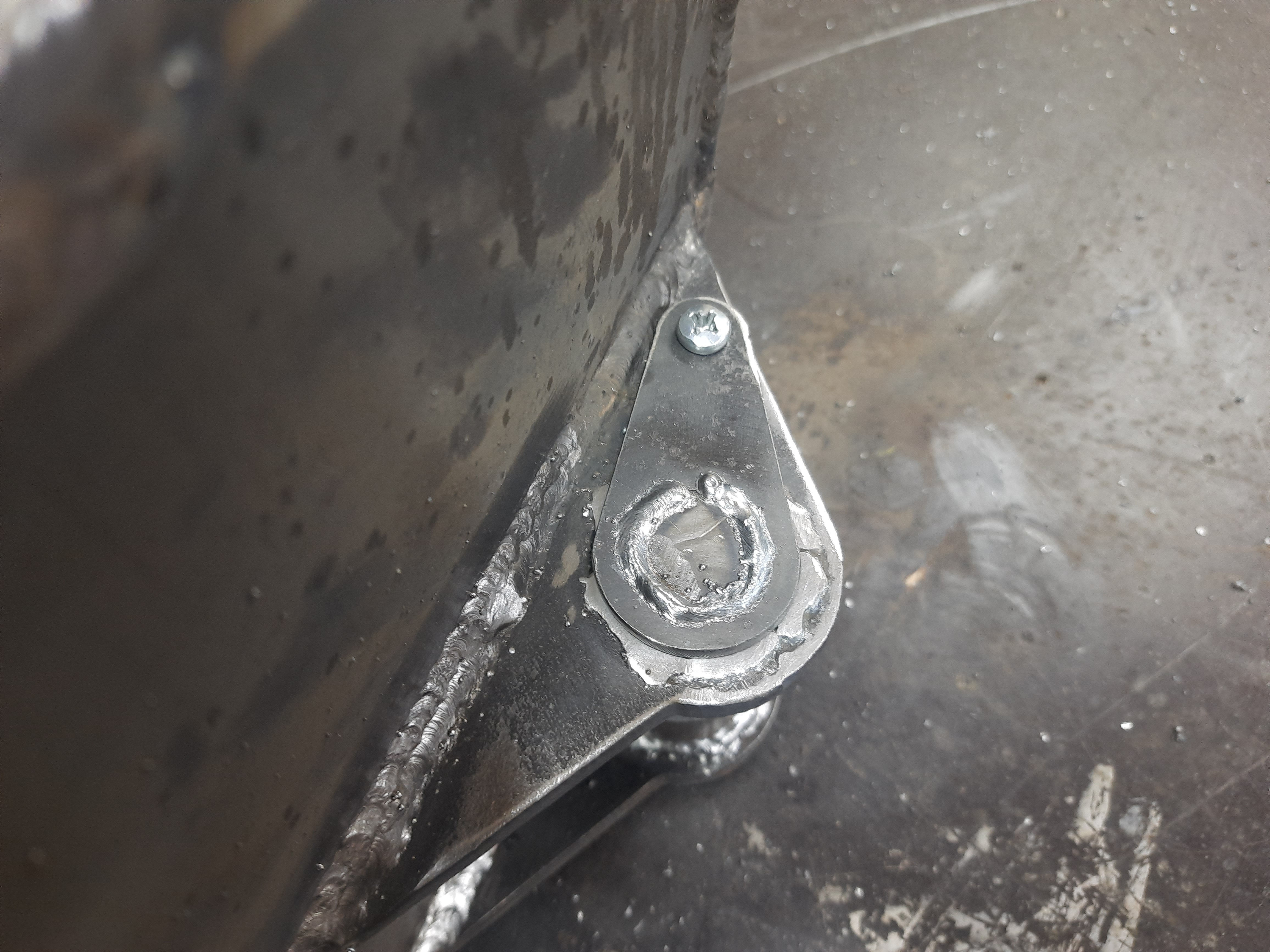

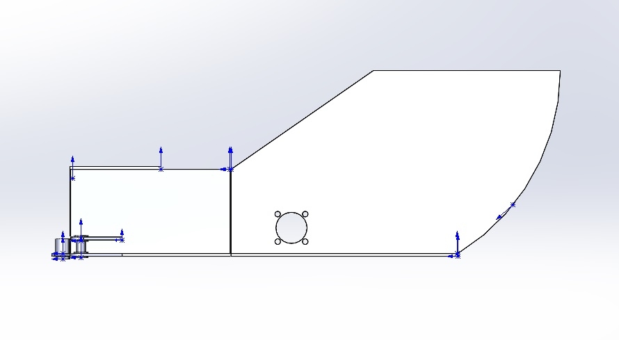

So, while there is an opportunity, I am starting to make changes to the design. I do not like the weak joint node between the rear and front parts of the loader. In the old version, all the load is on the bushing, which is welded with only one weld. This is unacceptable. In the case of diagonal wheel suspension, the node works on a break and deformation is possible. I removed the oil tank inside the rear part, added metal and strength. Now the lower mounting of the loader frame hinge is a solid part and not a weld, as it was before.
#11
I increased the rear side walls. This is not just for show: I need weight and space where I can place the oil tank and fuel tank. Shifting the oil tank back will allow for lifting more cargo. At the same time, the overall width of the loader will remain unchanged, which will allow it to enter narrow gates and doors. Sometimes, even into a house, since the loader will be no wider than 1200mm. These are still just drafts and sketches. It is possible that I will make changes during the design process. Errors in design are not acceptable. The result will be determined by calculations, tests, and loads.

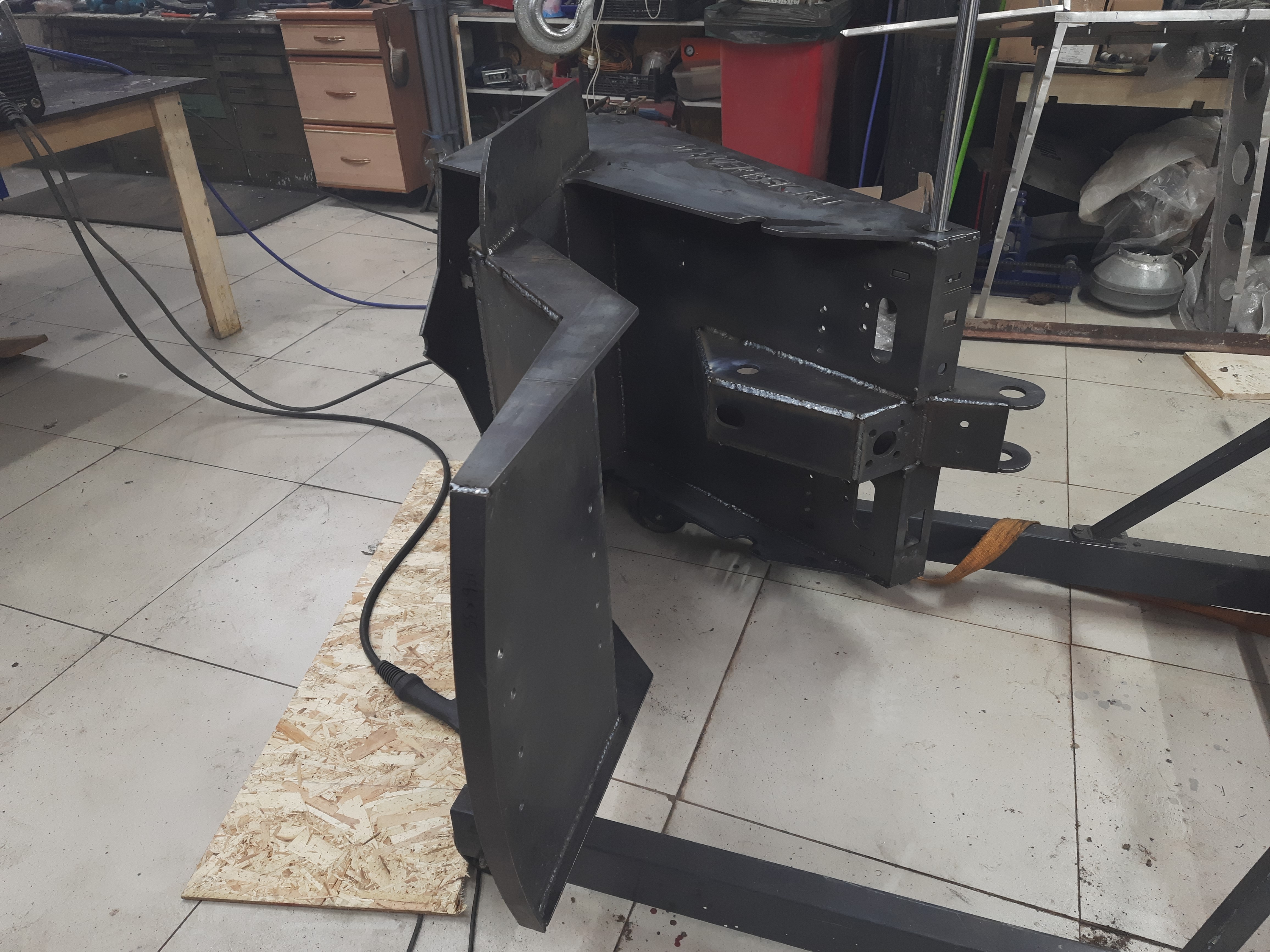

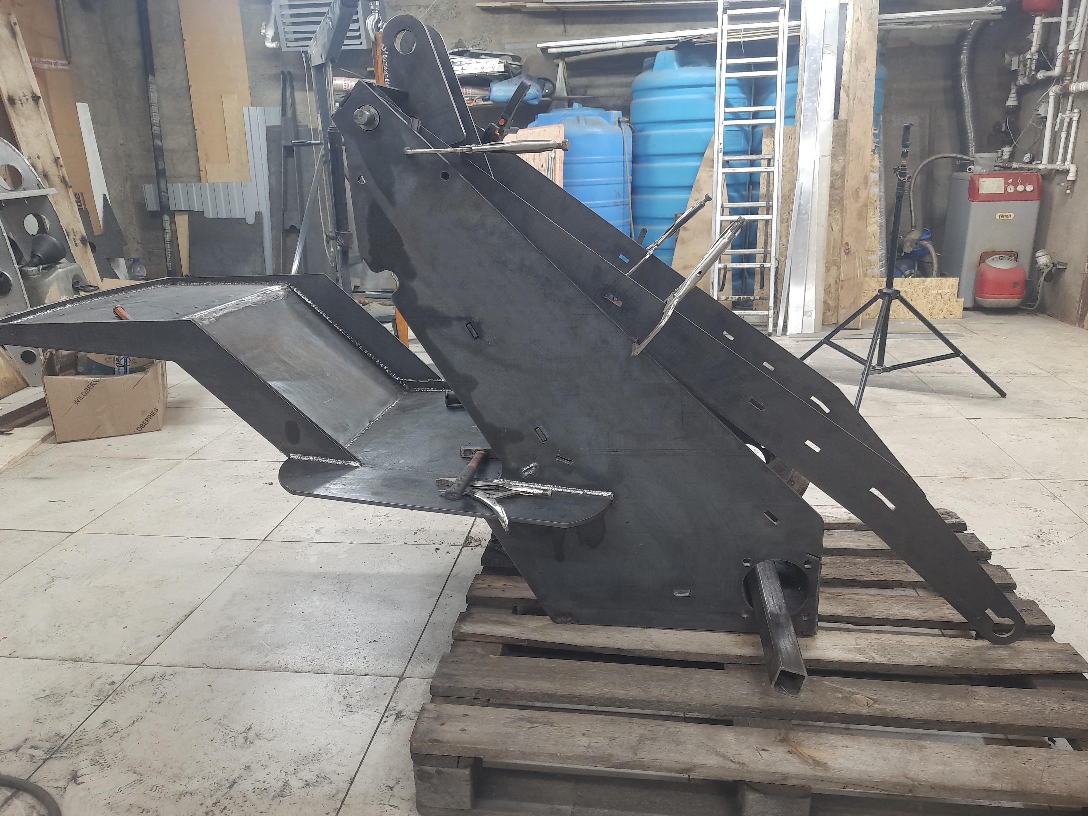

Welding the front part from all sides

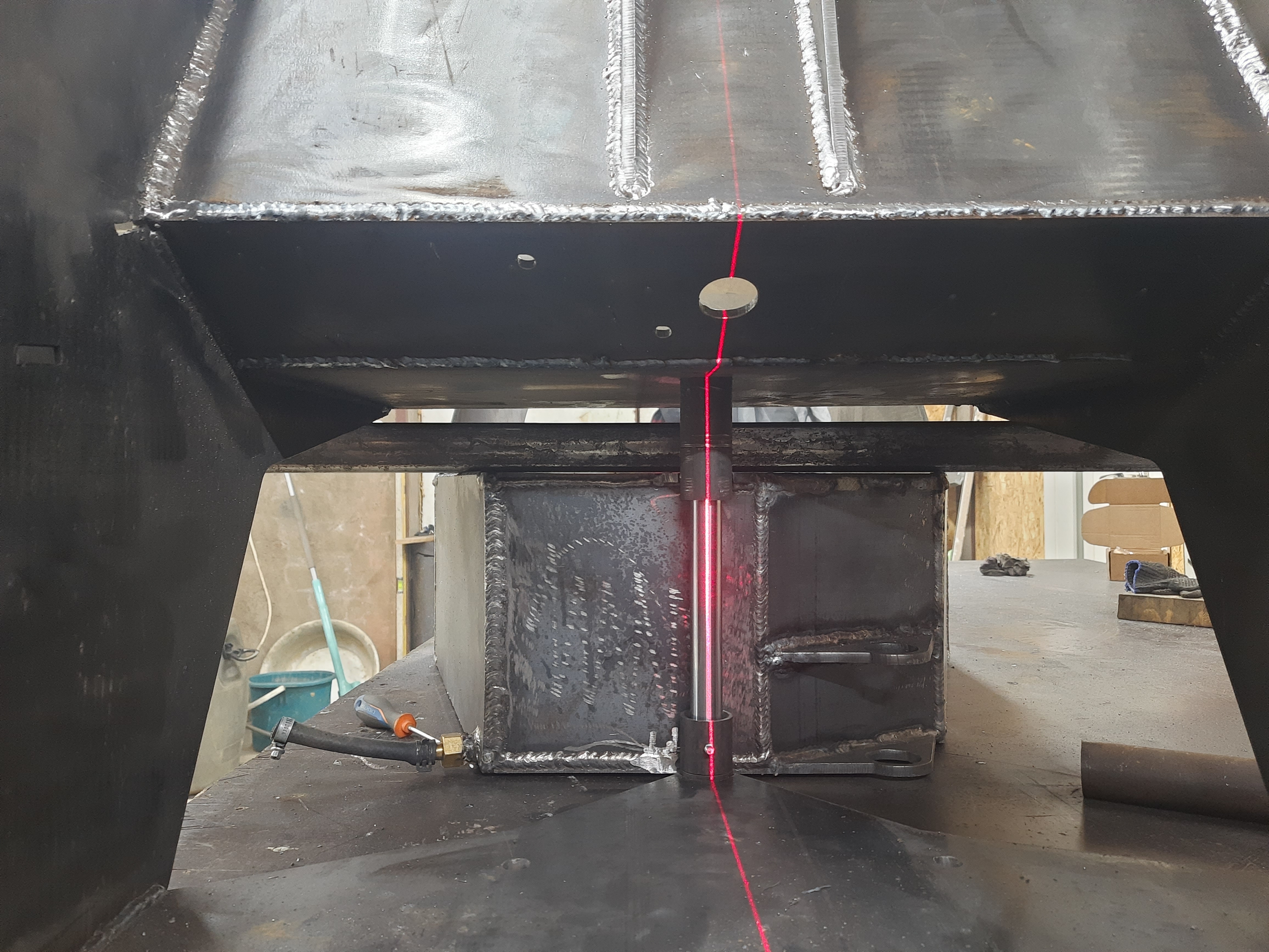

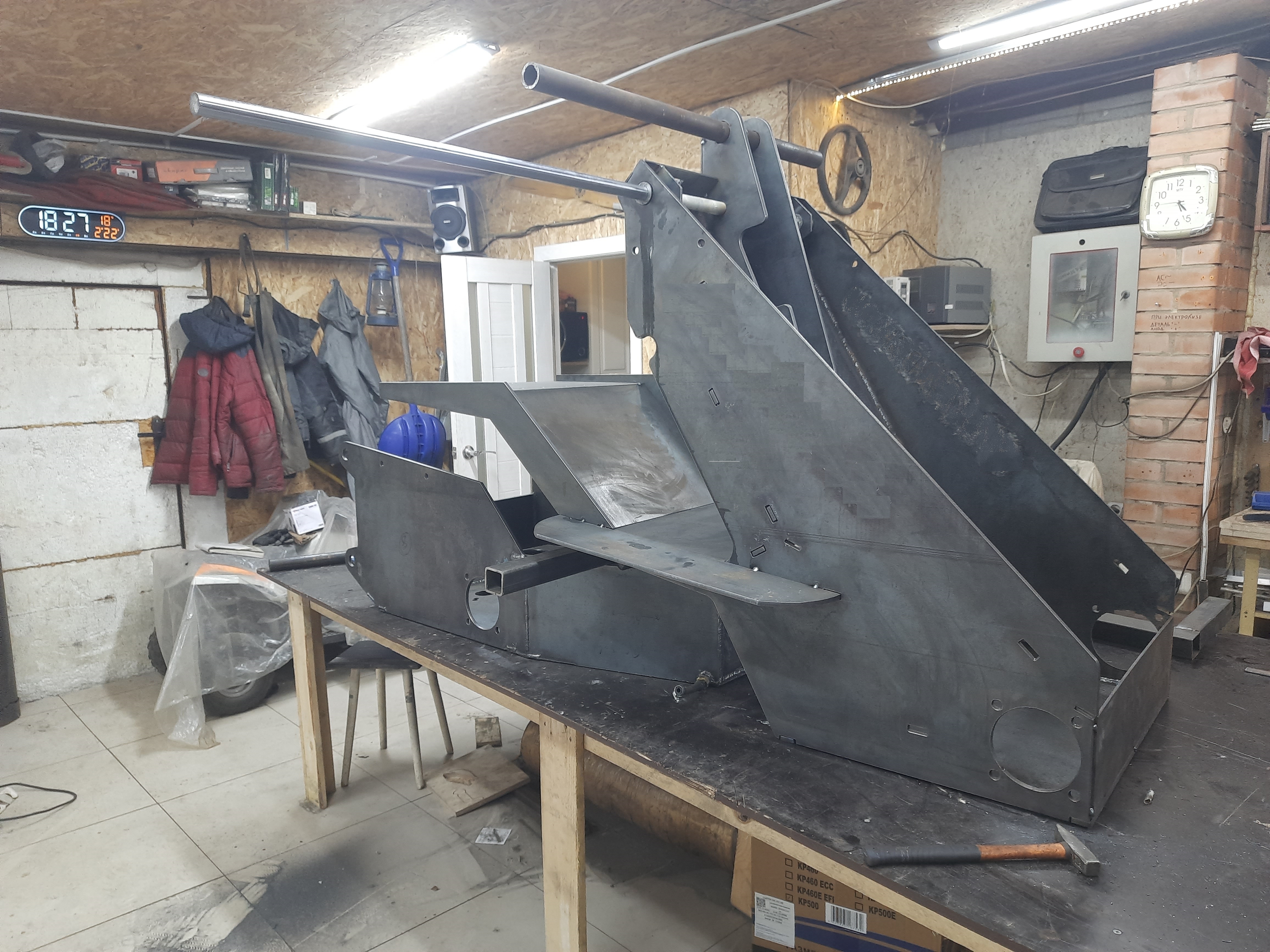

Here you can see how I prepare the joint node of two semi-frames. The front and rear parts.

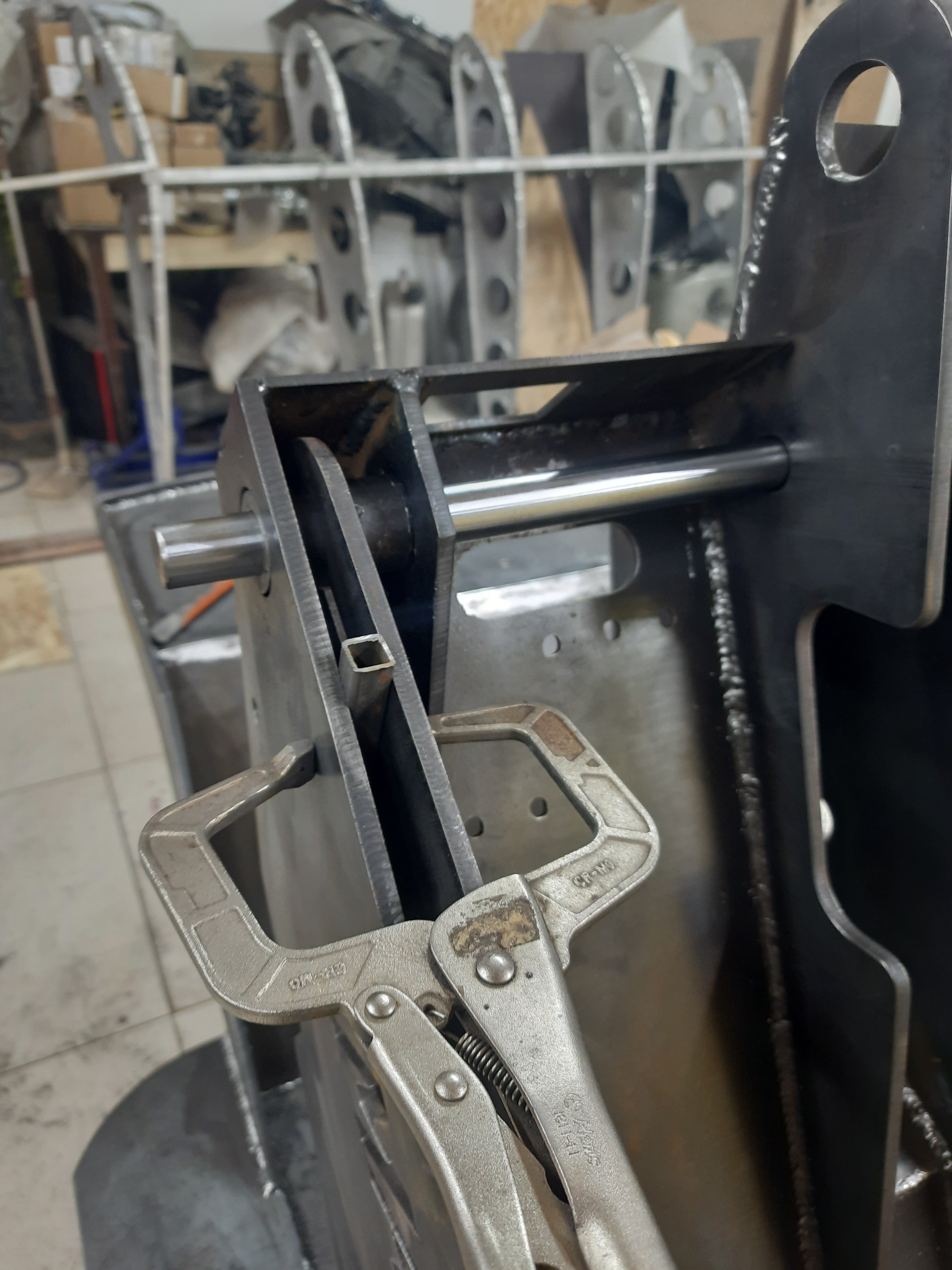

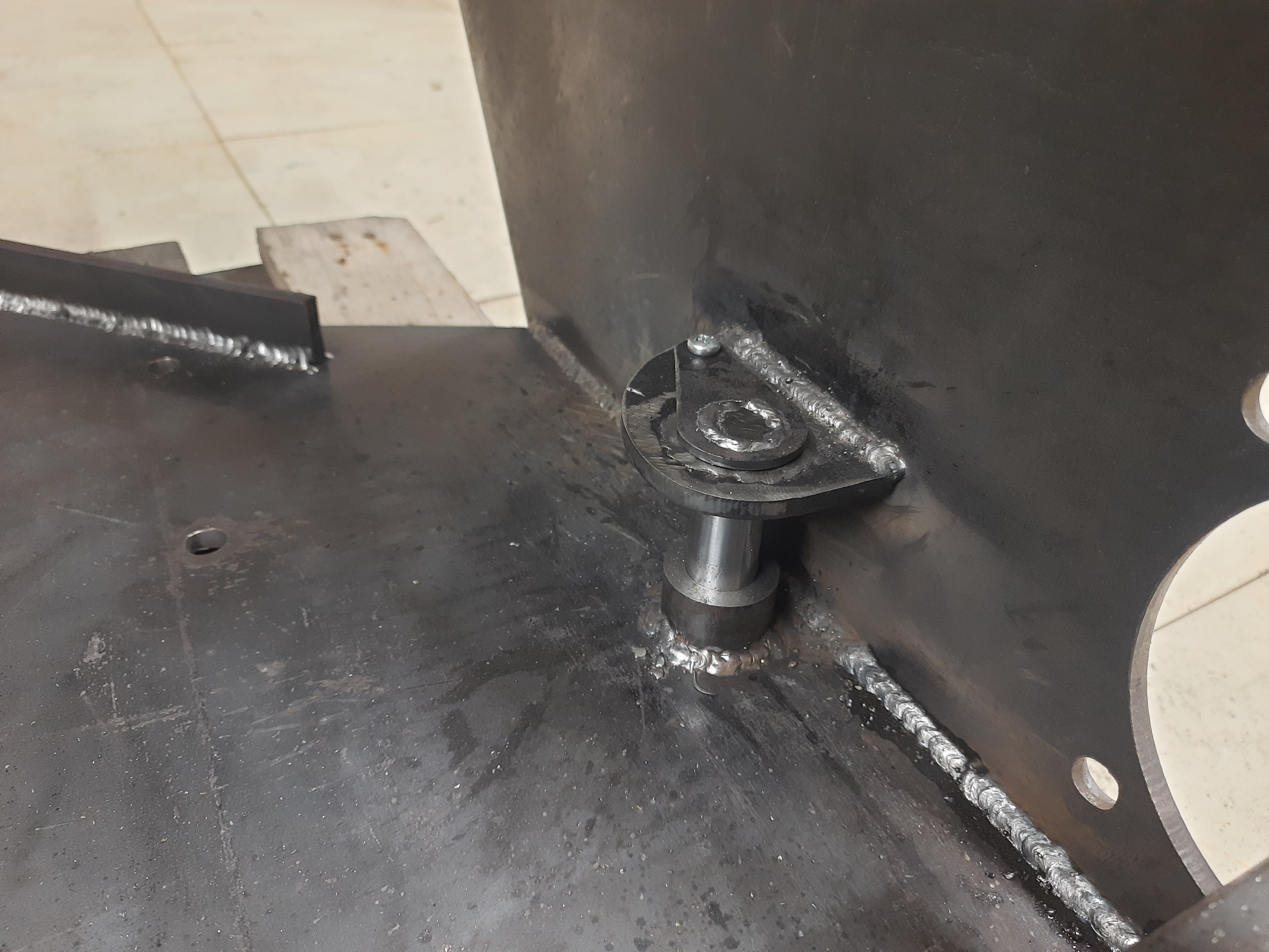

Assembled and welded the front pivot assembly.

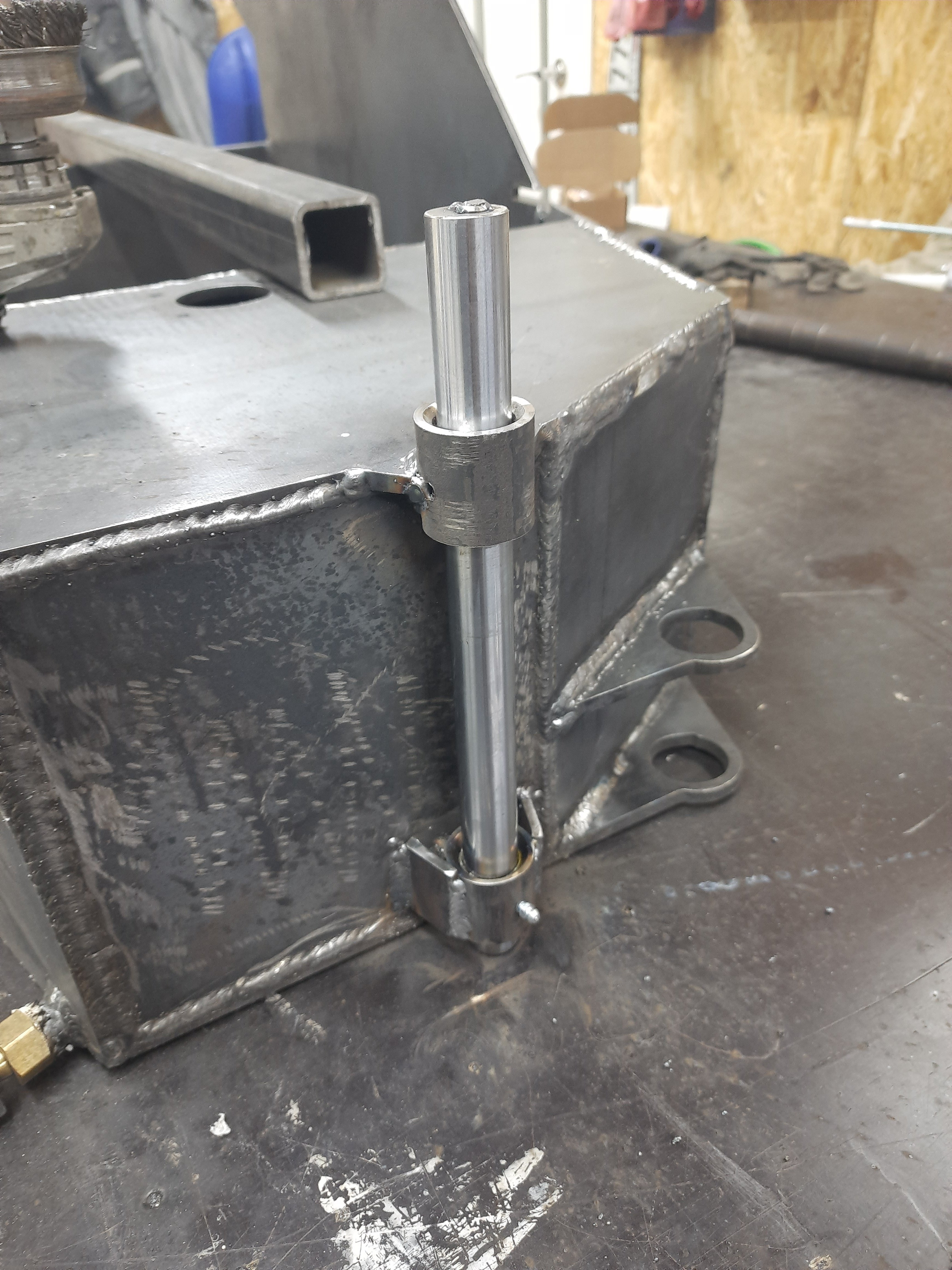

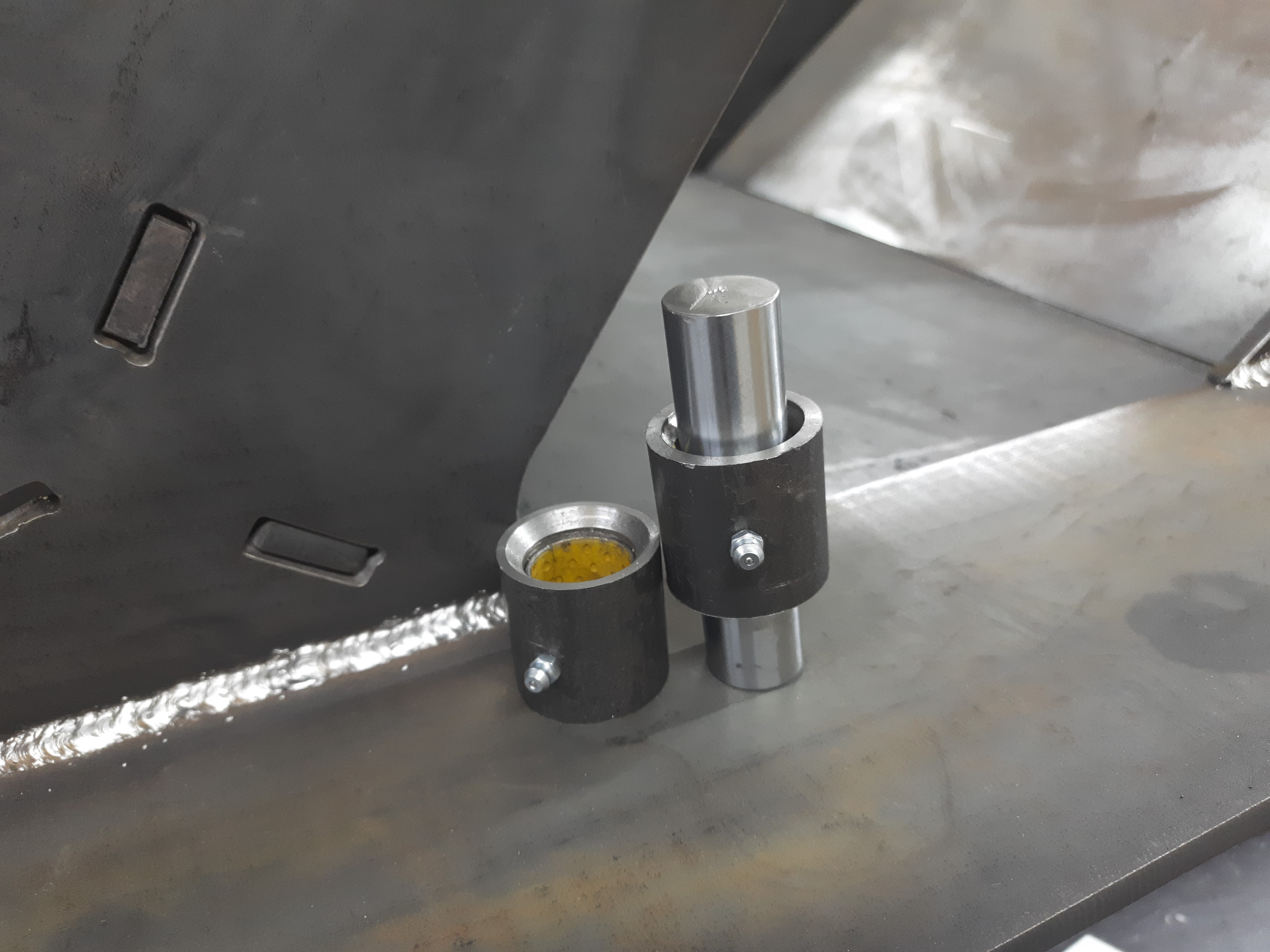

A very important element is the pivot nodes. I take a steel rod. First, I drill a hole, then I enlarge it on a lathe with a cutter, and then I finish it to high precision with a reamer. And into the resulting sleeve, I press in a bronze insert with a Teflon coating. This is a maintenance-free bearing that does not require frequent lubrication. Quite reliable and undemanding. Just what is needed on a remote ranch. the bushing fits very tightly on the rod. Without lubrication, I have to exert effort to move the bushing along the rod

I have moved on to an important step - the lifting boom. I am starting to fit and weld the guide bushings.
