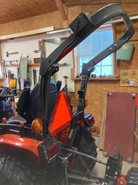

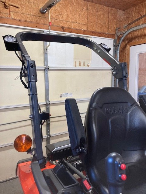

I'm going to build a pole shed for my new Kioti and am waiting for it to get here so I can get an exact measurement on the height off the ground. I was just gonna build it 8 ft off the ground but thinking that might not be high enough. I'm curious if it will fit into the barn, I'd hate to have to fold it down every time I have to drive through the barn...
I am not going to take the listed measurements as fact, I want to see it in person....
I would go a minimum of 6 - 12" higher than the stated measurements. I built a door specifically for a tractor I had. When I purchased a different tractor the door was too low. Since there is no easy way to make the door higher I now store my tractor in a different shed. Not where I had originally planned to store it.
/ Must Tractor ROPS Be So High? #102
One consideration in buying a CUT is where you're going to store it. There are lots of stories where owners ran into the siding over the garage door. A foldable ROPS works until you forget to fold it down.
So my question is, Could CUT manufacturers design a ROPS that is more garage friendly? (Must they be so tall?)
Short answer: No. The ROPS, design is required to protect a normal sized operators extremities in the event of a roll over.
So, sit in your seat with the lap belt on, reachup and see how far above your outstretched hand the bar is. If you have about a foot it’s good. If you don’t have a foot you need to raise it.. there are other solutions, such as a 6-point belt system with wrist tethers, but now you’re looking at such a pain in the toucas to get on and off the tractor that no one would ever use them.

If you have a garage door that requires you to fold down your ROPS, I always wondered about something like police tape that you would install at about 3' high on the inside of the door that would hang down about 3' when the door was open to remind you to lower the ROPS. Or would that become too familiar?
/ Must Tractor ROPS Be So High? #111
You guys just need to buy a Kubota M5111 Low profile and your ROPS height issues will go away. The ROPS on this particular tractor, will actually slide up and down with an assist of a gas spring, instead of folding backwards or forwards. Just set it at whatever height it fits on the garage and it's all good.

As I said, my tractor will squeeze under my door with the ROPS up but tends to catch slightly on the lip of the door going out. The weird thing is that my tractor should not be able to get in the garage at the height Kubota lists for it. That must have been taken with ag tires. I got R14s.
I'm sure some on here know about this aspect, and I haven't bothered to actually measure yet. But for those shopping, an inch or two taller or lower because of the tires might make a difference in your situation.
