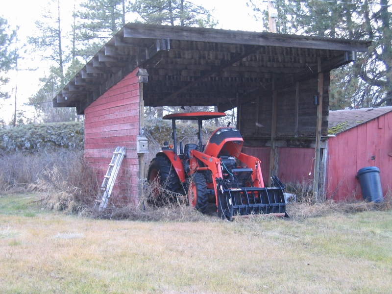

My Kubota barely clears...but that's good enough. However, I can rock it back about 30 degrees, and pin it there. It drops it by nearly a foot.

One consideration in buying a CUT is where you're going to store it. There are lots of stories where owners ran into the siding over the garage door. A foldable ROPS works until you forget to fold it down.
So my question is, Could CUT manufacturers design a ROPS that is more garage friendly? (Must they be so tall?)
The ROPS on my 1025R fits in my shop with no problem. The only time the ROPS on my 3046R is up is when it's in the way of using the back hoe.

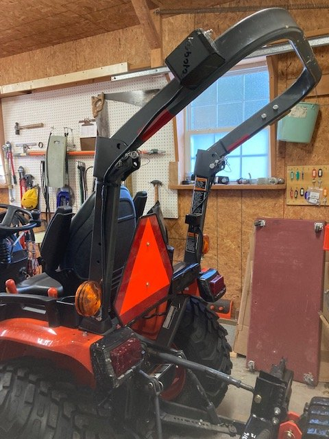

When fully raised, my ROPS will barely squeak under my garage door. But backing out, it will pucker the bottom lip of the door.
These photos show my ROPS in the second position. Does this look safe to you? It doesn't feel nearly safe to me. But if it's not as safe as fully raised, it makes me wonder why Kubota made that setting available.
For doing what you are doing. It’s meant to be fully raised while in use.

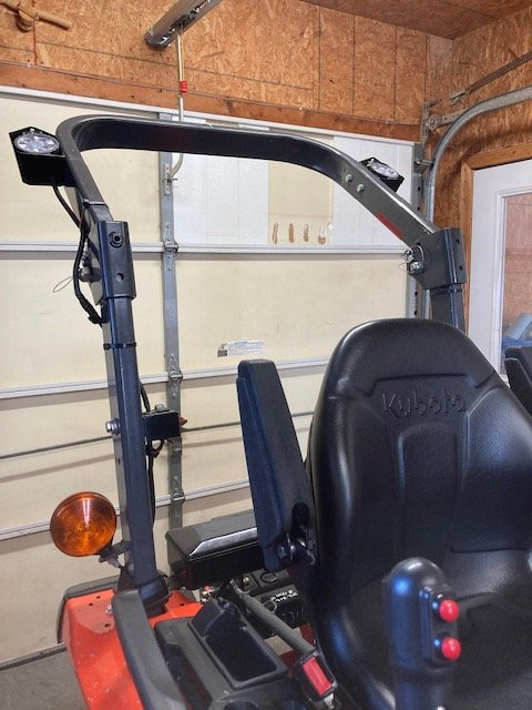

Got mine at the 45 degree position now. Clears door and should be good enough for ROPS.
JDs didn't have this 45 degree position.
Do as you please but for others who want to know, the down position is to clear doors. It isn't an option for some other level of protection.
Not judging you or telling you what to do but rather providing context for those who follow and might think that down is approved by the manufacturer.
/ Must Tractor ROPS Be So High? #69
A folded ROPS is no longer a ROPS.

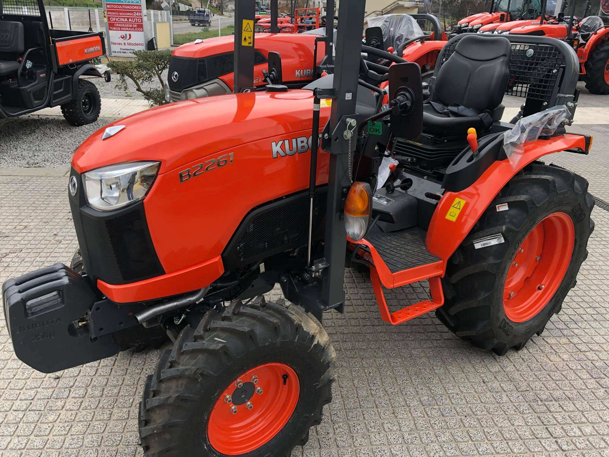

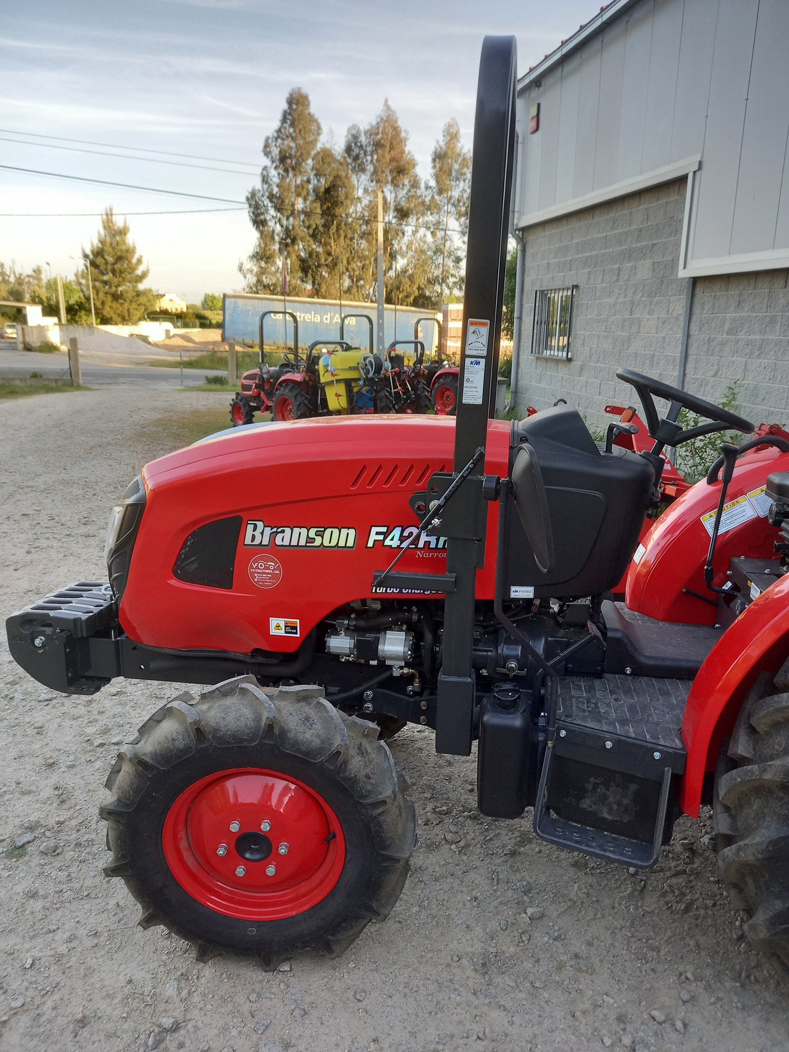

Around 2018 or 2019, I started seeing new tractors being sold with a gas spring assist for the ROPS so I assume it became mandatory for the tractor manufacturers to add a gas spring assist to lift and lower the ROPS here in Europe. I've never really dug much into that. Anyways, the idea was to hopefully make people lifting their ROPS when height is not an issue since there have been so much deathly accidents due to roll overs.
This mostly done on the mid mounted ROPS, since it's a lot more mass to move. I have yet too see the same gas spring assist on rear mounted ROPS though.
In todays world, tractor manufacturers really should just include a gas spring on all types of foldable ROPS. It won't cost them a fortune and I'm sure they have plenty of profit margin.
Here is a picture illustrating what I'm saying. Note the gas spring attached to the ROPS post. From what I've seen, when lifting the ROPS, once it goes over 50-ish degrees, it will pretty much lift itself all the way. Before the 50 degrees, it's still an effortless lift that can easily be done with just one arm.

Psssttt,,,, your ROPS is in the wrong location.... :D
This is truly the first time I've saw a ROPS in that location.
Thanks for posting this Pedro!!!! :cool:

First time seeing that too. Does the ROPS need to be upright to open the hood?
