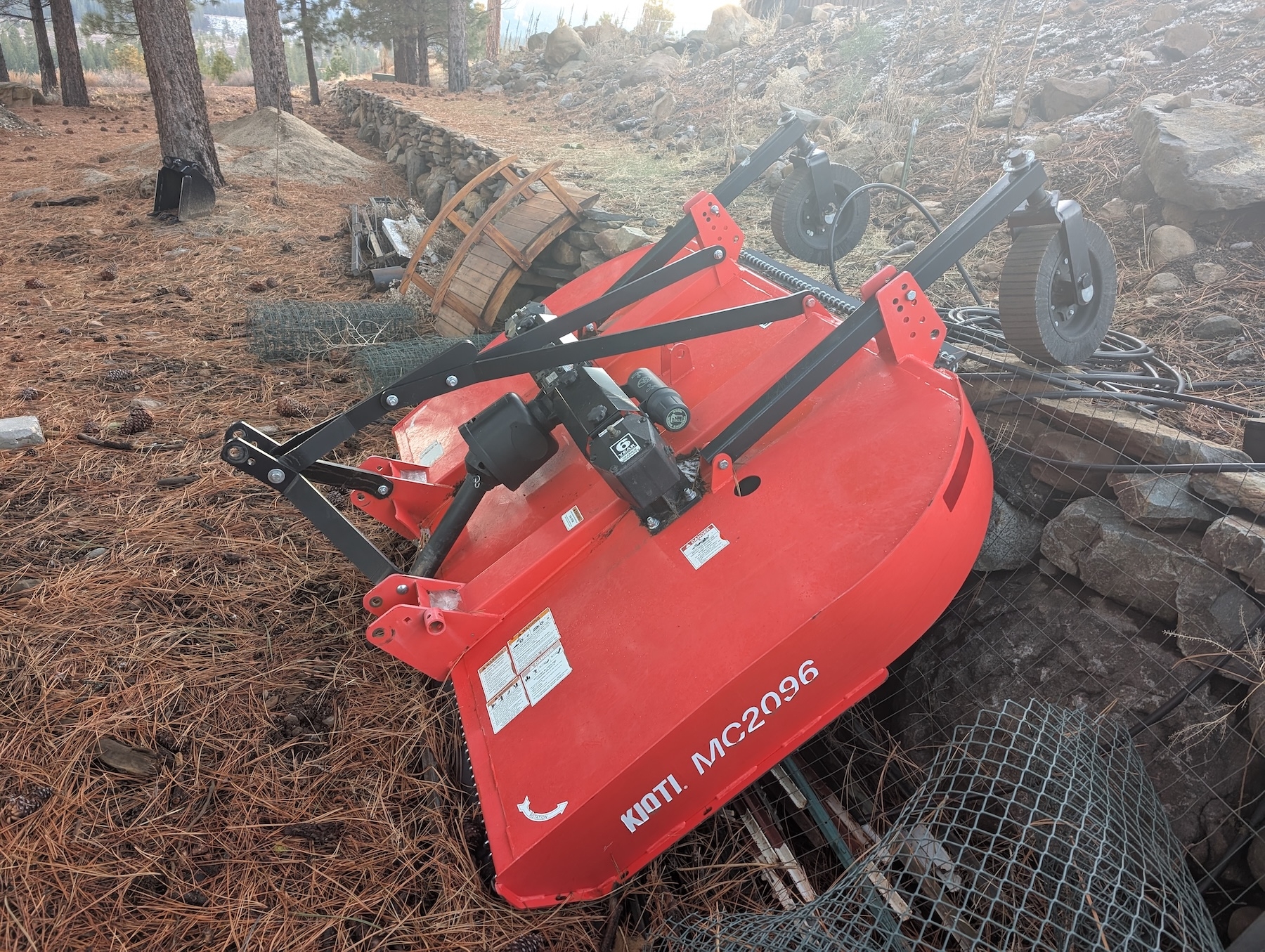

Yeah, my mower is in pretty good condition, is there any chance I would destroy it?
Keep in mind that sagebrush and rock removal is a “one and done” project, so I wouldn’t invest too much in equipment to do this. I still think a few hours work for a small dozer with skilled operator would be the most economical option. Once the initial clearing is done, the site can be maintained with your rotary cutter. Dozer tracks create less ground disturbance than a wheeled machine and there is little ground disturbance if the blade is held above the ground and doesn’t push soil.
You will destroy a set of blades.
Don't let me talk you into something your not comfortable with. We all have different skill and risk taking levels. You could just hire somebody to do it for you and let them wear and tear their stuff. You may have a neighbor looking to make some fuel $.
