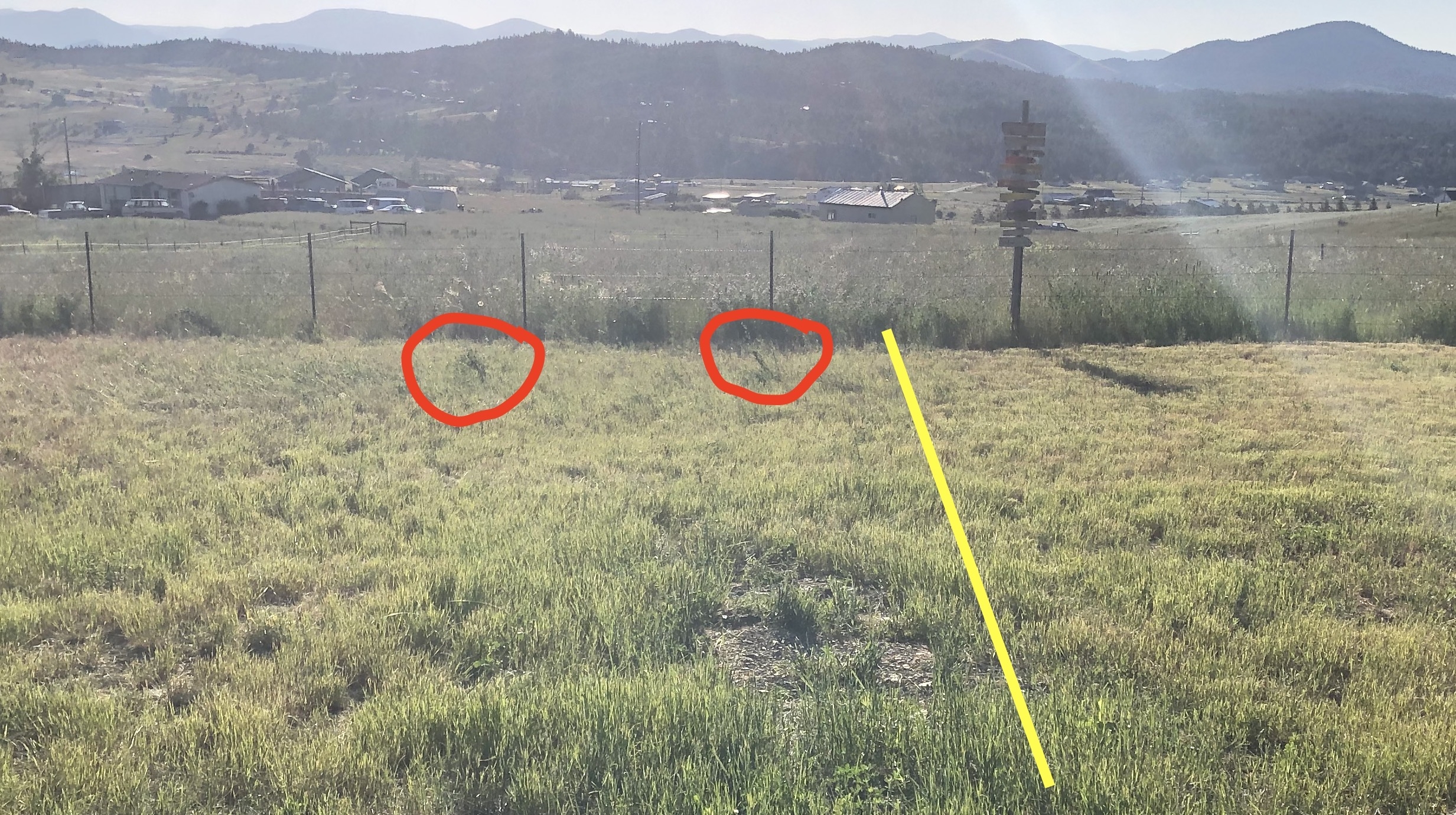

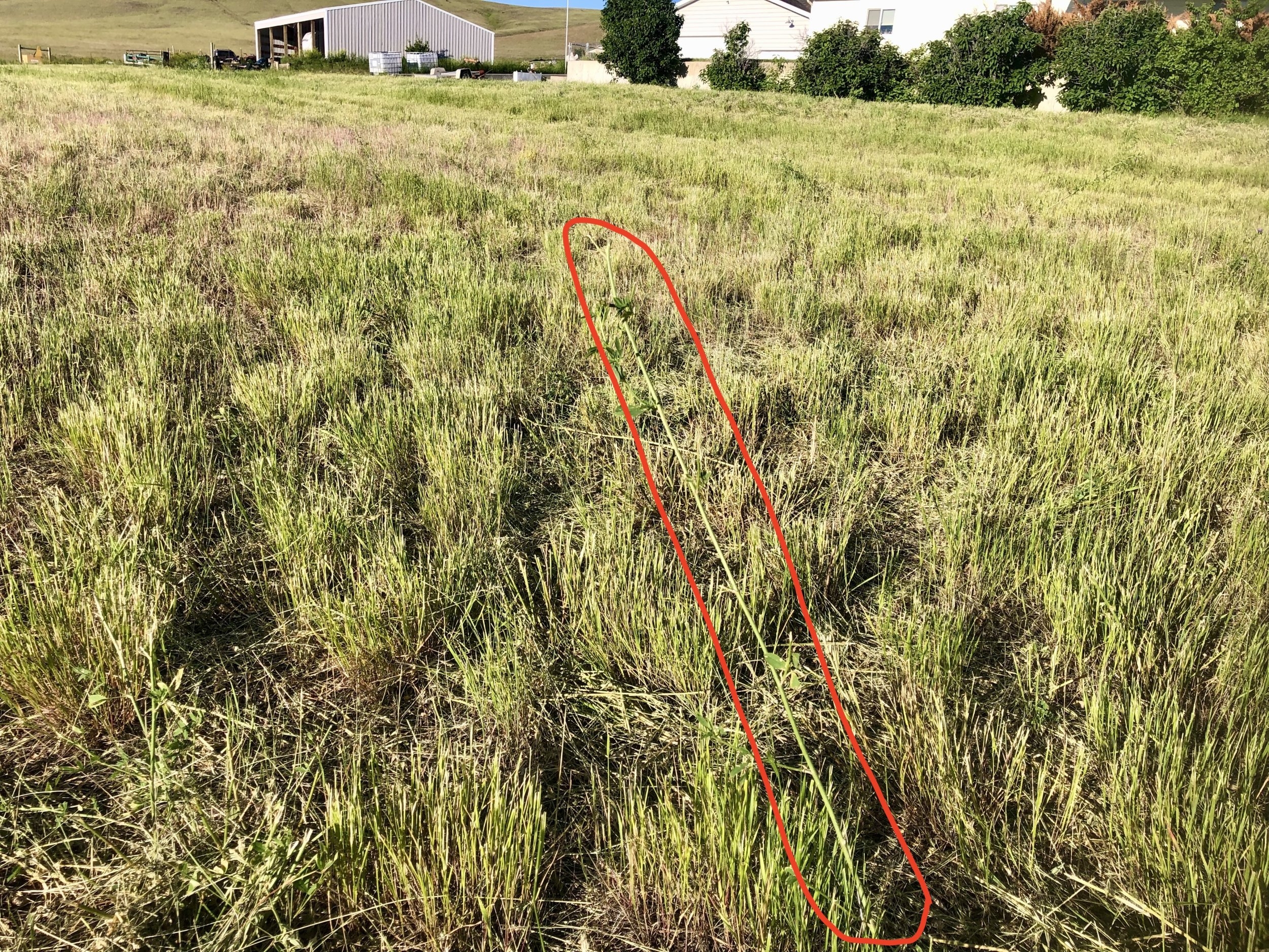

SUCCESS!!!
Well… kinda… I made all the adjustments mentioned earlier, now most of the tall stuff disappears… still have a few stragglers… good enough for me…
thanks for all the advice… I’d still be chasing my tail with all the available adjustments…m

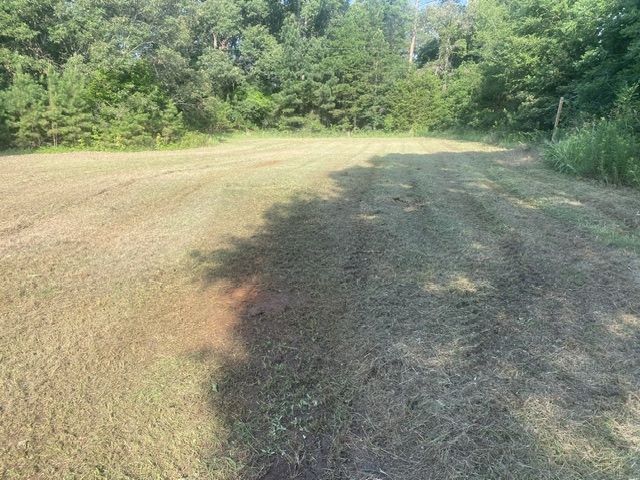

I mow this capped landfill twice a year, and my mower lays it down. I think this looks quite good. Mowing with a Woodmaxx 78" mower.

I have used a flail mower to keep up about 5 acres of grass and found it works best when cutting
grass very short . It will always leaves some behind in tall grass. From your pictures it seems you
are just trying to trim and that would be best to use a rotary cutter. As said before it also depends
on what blades you are using. Our parish uses flail mowers for most highway right of ways because
there is less damage from flying objects and they can scalp the ditches along the roadside.
