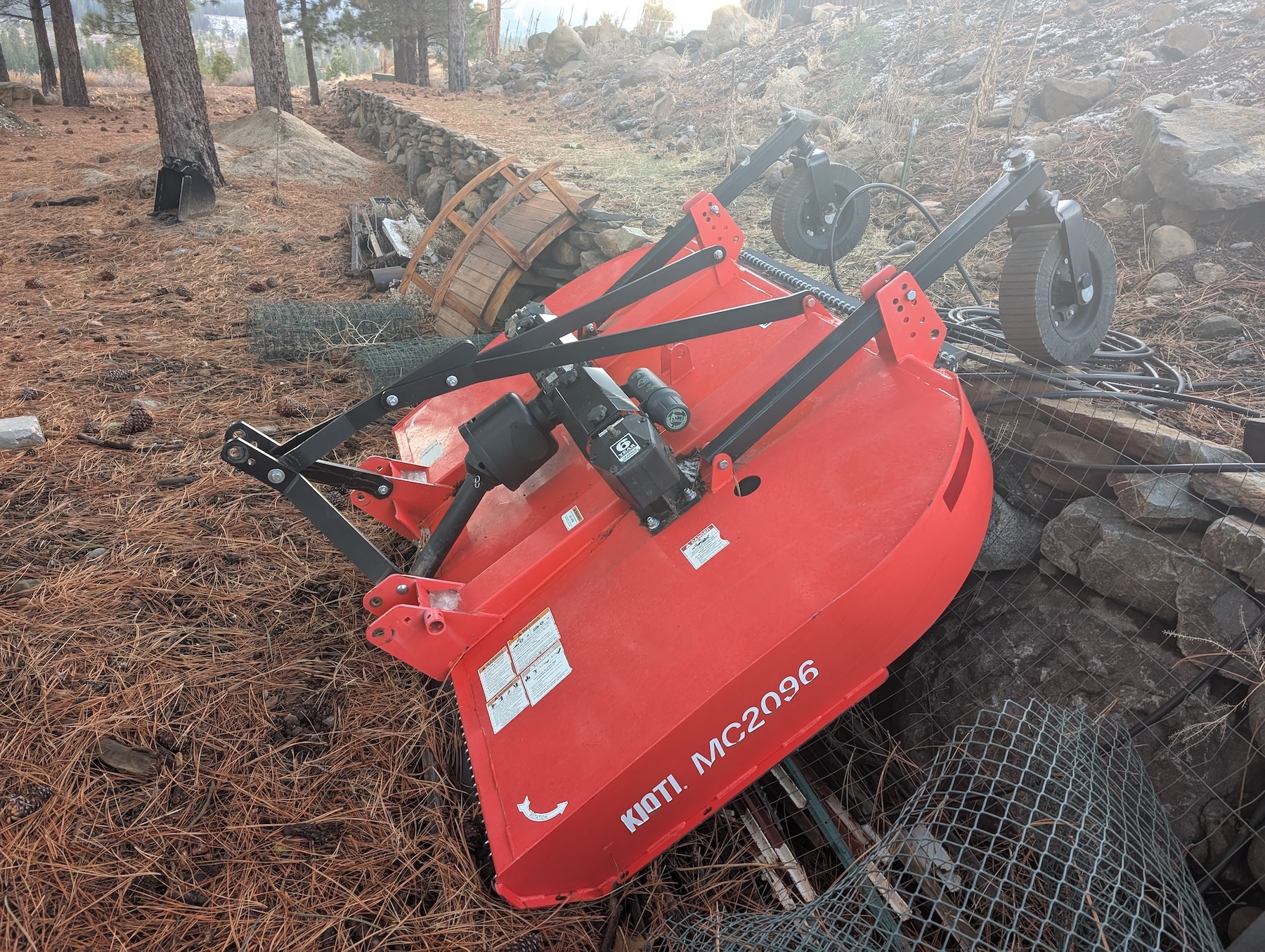

I like that idea. My two head mower is literally brand new, and I hate to mess with it, but if the chain works in it, maybe it would be a good idea. Is the deck deep enough to keep the chain from hitting it in the vertical plane?
I don't hear the chains hitting the deck. I think the speed that they are spinning keeps them straight out
