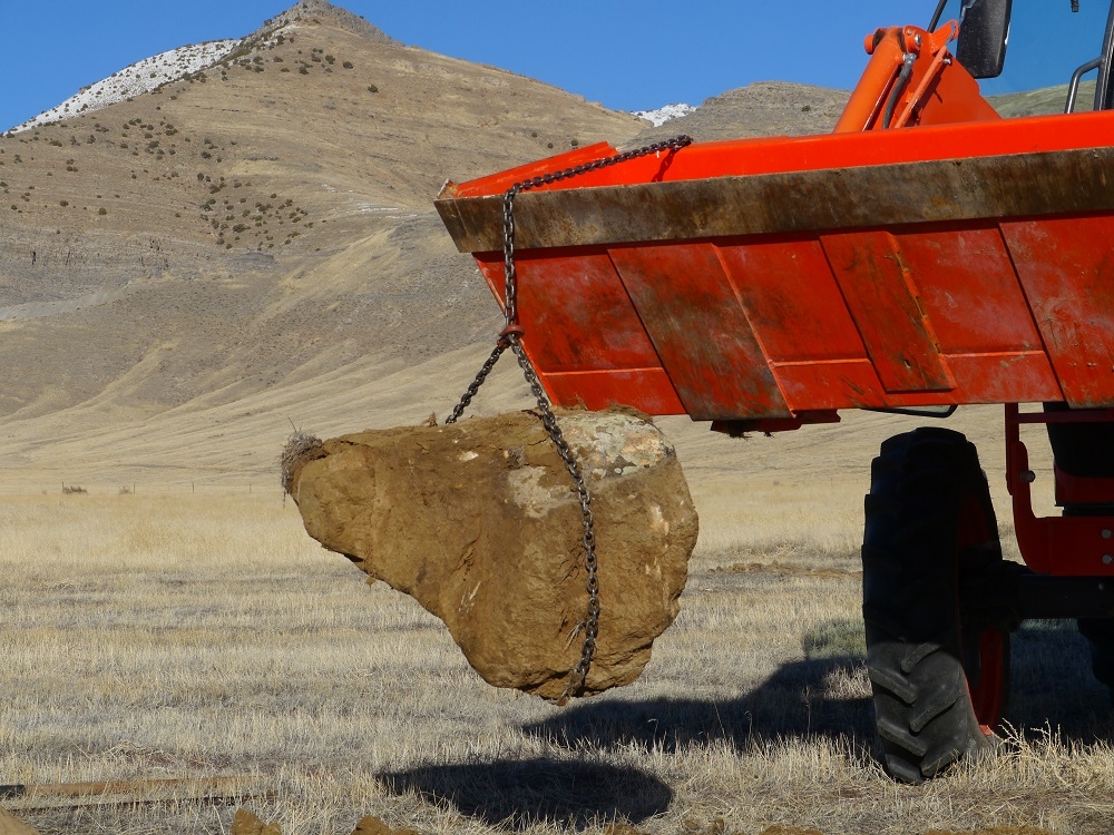

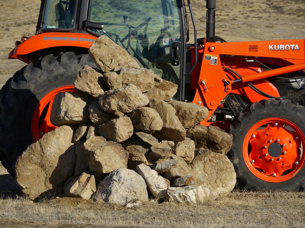

Perhaps a rock bucket can be used to make the first pass to get all the rocks? The sage is shallow and will most likely be pulled up by the bucket (but I will need to sort the sage from the rocks so I can run over the sage with the mower and chop it up)>
How large of an area? I would still seriously consider hiring a small dozer and operator. It could remove both the rocks and sage and the track indents in the soil is great preparation for grass seeding.

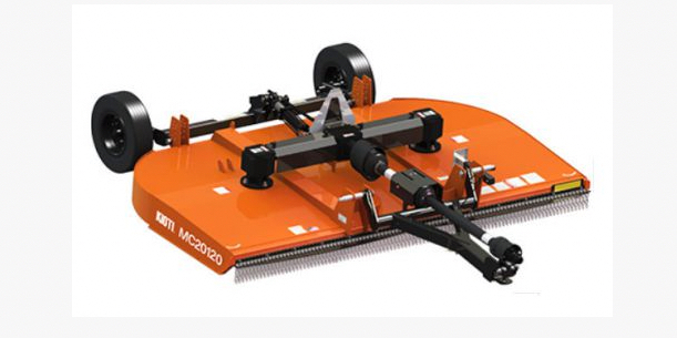

I like that idea. My two head mower is literally brand new, and I hate to mess with it, but if the chain works in it, maybe it would be a good idea. Is the deck deep enough to keep the chain from hitting it in the vertical plane?
I don't hear the chains hitting the deck. I think the speed that they are spinning keeps them straight out

The chain bush hog is the only answer that makes sense to me.
So the next question is what sized chain do I use and how do I attach it to the rotating axles? I was thinking of using a quick link to attach it, but my guess is the quick link probably won't last very long with that kind of abuse. Today I will flip over the mower and see how the blades are attached. I would assume the chain links will wear down and will need to be replaced occasionally. Also how close should I make the two rotating sets of rotating links come to each other?
