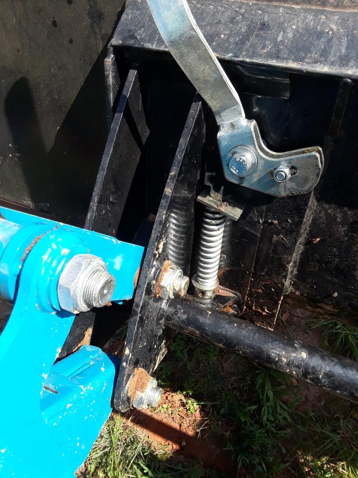

My quick attach handle broke on one side today. I went to take the bucket off to put my forks on and the pin jammed on one side. The handle would not budge no matter what. I flooded it with penetrating oil...nothing.
Took the small hammer to it. Figured I would knock it loose...nope. Just broke the end of the shaft coming through the spring that joins up with the actual handle.

BTW, here is where my QA handle broke off.

Yeah a friend used my tractor and beat it with a hammer once to unlock it. Bent the handle some but luckily did not break the pin. If the pin breaks I’ll be machining a new one. I am half tempted fabricate some stuff mimicking my NH. Those handles are stout and open easy plus they have a grease fitting.
/ MT573cps hydraulic whining question #9
On mine actually I think the hole for the pin that's in the bucket is slightly out. From day one that side was extra stiff when releasing. I figured it would loosen up with use like the other side did. Except it didn't.
Once I get the pin out of the bucket, I'm going to grind that edge back on the hole so the pin fits in a little looser. It wouldn't take much, maybe 3/32.
