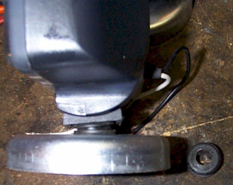

Here are the pics I promised. I bought the flood light from Walmart, Under $10 but I don't remember the exact price. In the picture, you'll see the magnetic grounding block (Harbor Freight on sale $3.99 each, $7.99 reg.) attached. Note how the bolt goes up into the block so that it doesn't hit on what you connect it to. John
