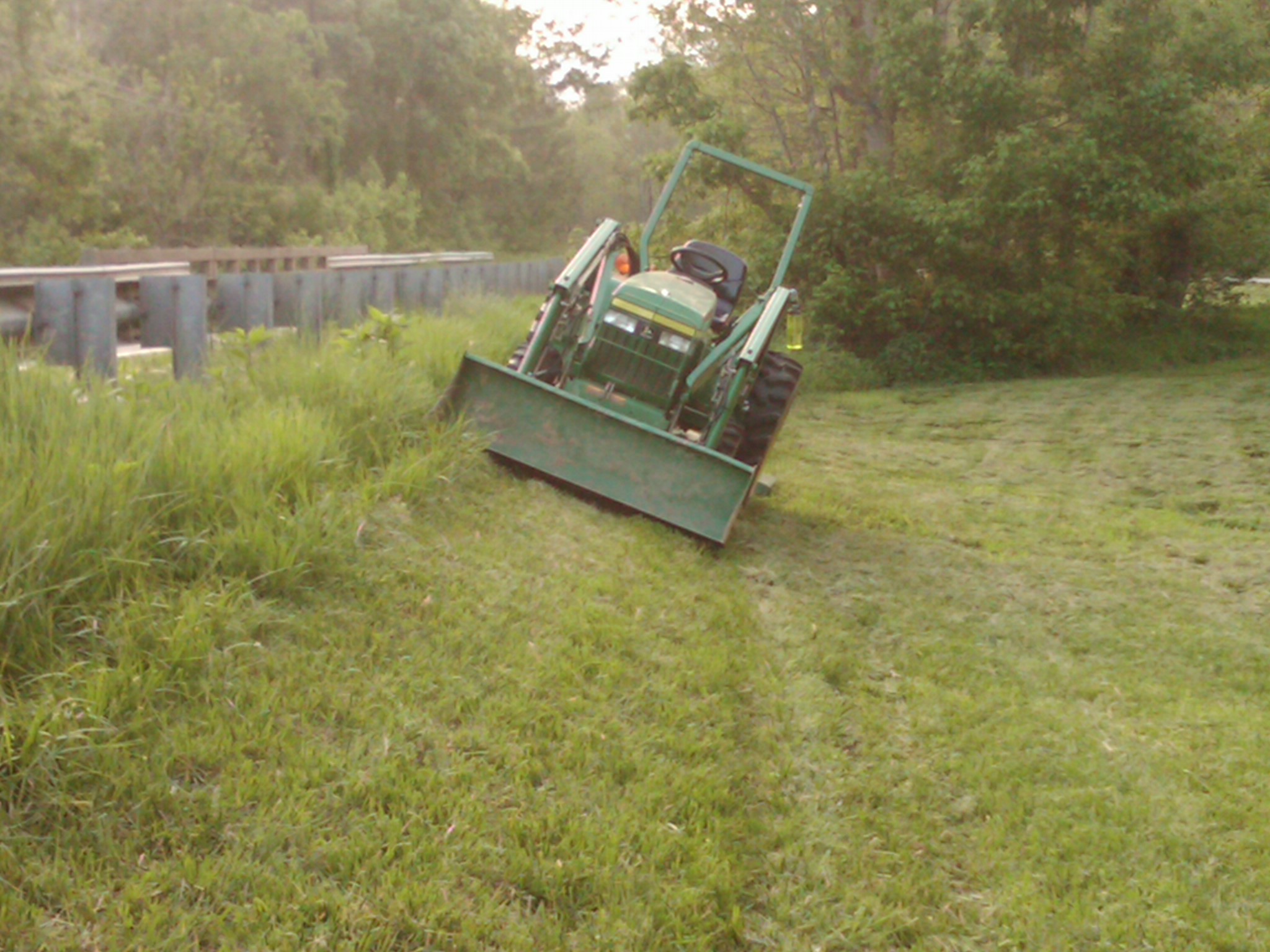

/ More slope questions #20
I managed to stop and get a picture today of my max side slope. In this picture, it was 25 degrees, although this was basically the same spot that I measured 28 last week. One gopher hole can make all the difference! The next pass, higher up, is slightly steeper yet.
At this angle the rear slips sideways, with 4WD engaged. It's a bit of a rodeo pass but I've been doing it for 6-7 years now...and I know I can do it. Otherwise, it'd be scary as **** the first time. I wouldn't go steeper than this.
Flipped rear tires makes all the difference...
