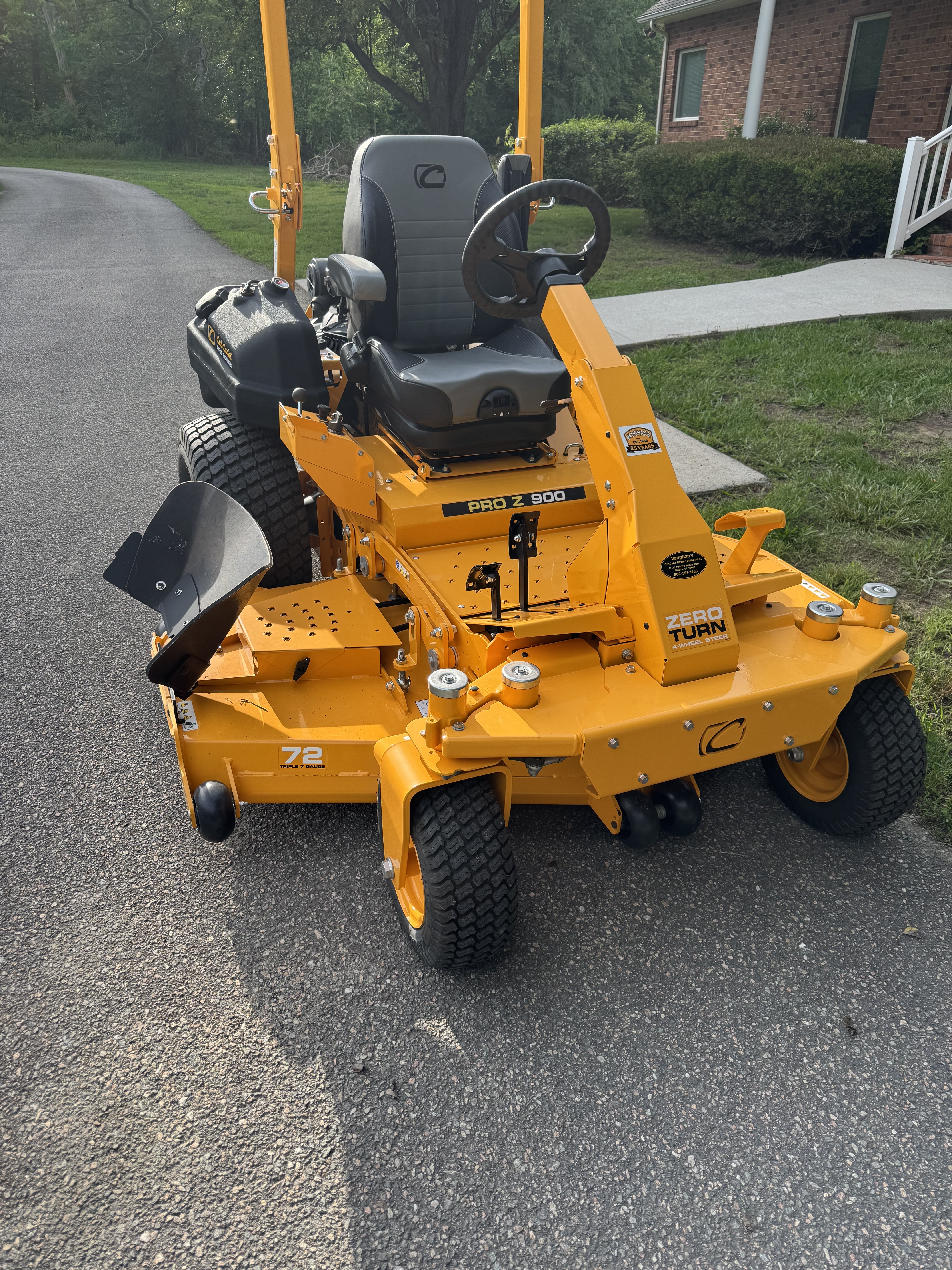

Got the June pricing a little early 🙂
Mowed all the areas along driveway and pastures that I couldn’t get with tractor this evening with no issues, holds slopes great! Didn’t have time to mow around pond yet but don’t expect any issues.

Does this CC 972 have dual rear wheels? 4 wheel steering? If 4 wheel steering, is this "on" all the time? I am using a Ferris IS2000z, 2007 model, with taller seatback and canopy, which is fine going up a moderate hill but does not like coming down. A spindle pulley just broke, even though all were replaced 2 years ago, and the shop said they are backed up at least a month, probably more.
I can't speak to whether this particular unit has dual rear wheels, but as far as 4-wheel steering . . . All of the S models with steering wheel essentially have 4-wheel steering since the steering wheel points the front wheels and also provides the inputs to the pumps in the rear that drive the rear wheels. It is "on" all the time.
Instead of having casters on front that just get pushed around or tend to drift downhill, the front wheels are linked directly to the steering wheel and stay coordinated and controlled.
I believe all the PRO models above the 100 series have power steering as well. Very nice feature.
/ Zero Turn mower for moderate slopes? #32
The OP posted a picture in post 23. Has front wheel steering, rear wheel drive, and single rear wheels.
Cub Cadet makes a Pro Z 972 model with dual rear wheels and front wheel steering. Commercial Zero-Turn Mowers
