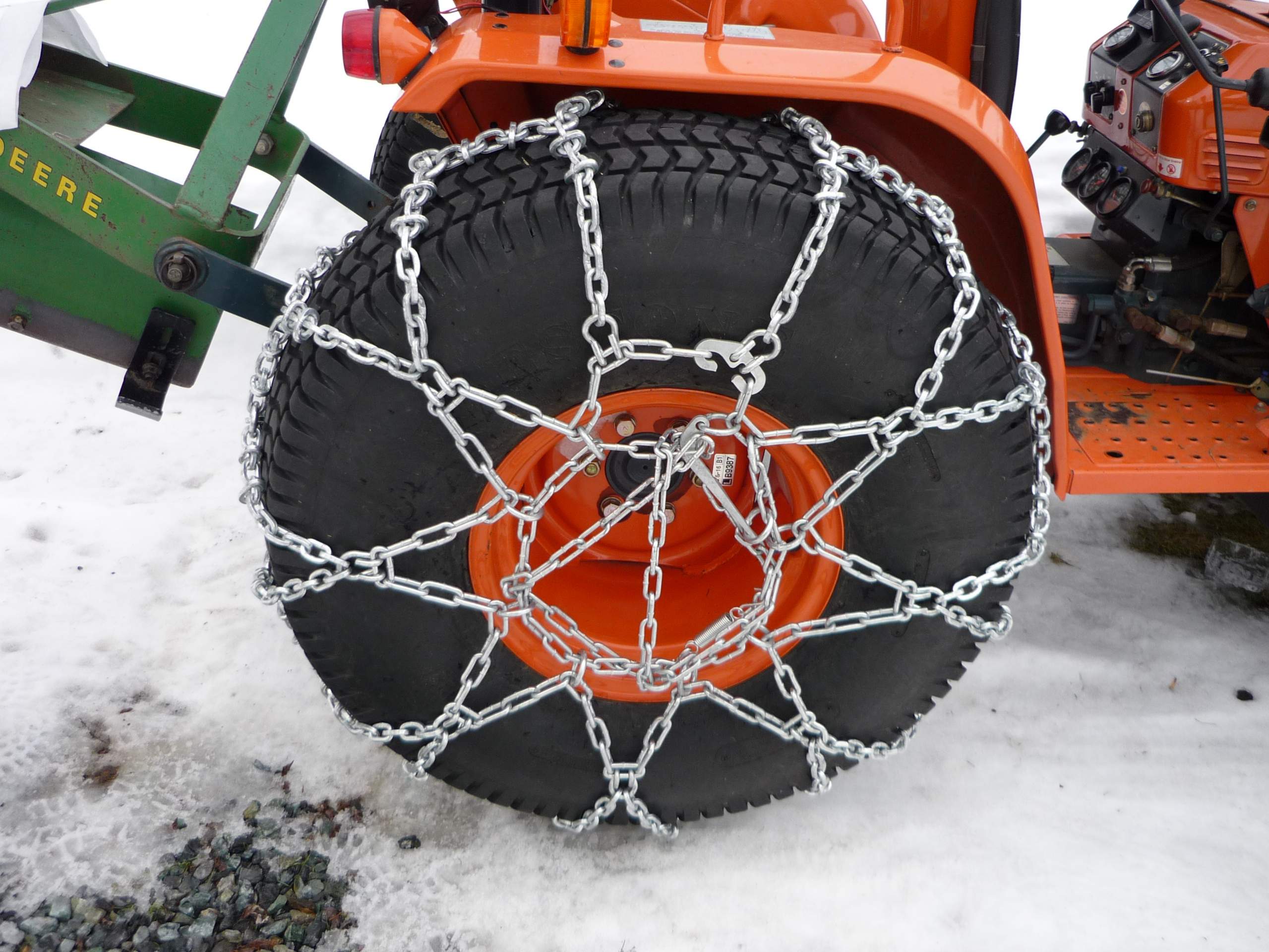

Greetings.
I purchased 2nd hand chains last winter for a very good price, even though they weren't exactly the correct size. They were OK, but had a lot of slop. My goal is to modify before the snow flies in earnest.
The chains are duo-grip style. Visualize the chain that goes around the inside/outside perimeter of the tire with one link horizontal, the next link vertical, next horizontal, etc. Right now all of the cross-chains are attached to horizontal links. What I need to do is remove one link between each cross-chain attachment point. The result will be that one cross-chain will be on a horizontal link, and the next on a vertical link. There will be five links between these two points. The question (you knew there HAD to be a question buried in here somewhere) is - will that put undue pressure on the links, leading to premature failure?
Question two: does anyone have a great way to open the claws on the side chains - other than hammer/chisel/vice combo? With essentially 96 "claws" to open, I'm thinking of a rig involving my wood splitter - but the safety angel on my right shoulder keeps telling me to forget it. I don't have a shop press.

There is a tool for opening and closing links, don't know what it's called, but if you find one, make sure it's well made, I've seen lots of cheap one's that are weak. Aaron
/ Modifying chains #3
I believe www.tirechains.com has such a tool. Their tutorial for installing chains suggests using a cold chisel to spread the link...not sure I'd want to do that for 96 claws.
ADDED: They do have the tool you need...look on the left of the screen for tire chain repair.
/ Modifying chains #4
As mentioned, there is a tool that works great. I borrowed one from a garage that ran trucks.
As to the cross chains being on the just the even links (horizontal), I made mine up with the plan you would like to do, because that worked best. I don't think there is any problem (have been running my tractor chains over 10 years now) having one cross chain on a vertical link and the next one attached to a horizontal. A little bit of twist to the side chain, but the chain just doesn't seem to mind at all. :D
I think you should carry out your plan.

We used bungees last year to take up the slop - but it was a lot of slop. Because the bungees aren't super-tight, they allow the chains to twist up and start catching bolt heads on inside of fender. By my calculations, I'll be removing 12'' of side chain and am trying to look "long term".
I saw the tool on tirechains.com - probably a good way to go. They'll cost about the same as what I paid for the chains... but in the end, I'll still be ahead of the game. Or maybe I'll buy a small shop press and make up a jig - and have a more widely functional tool when I'm finished. Now to convince "She who must be obeyed"...

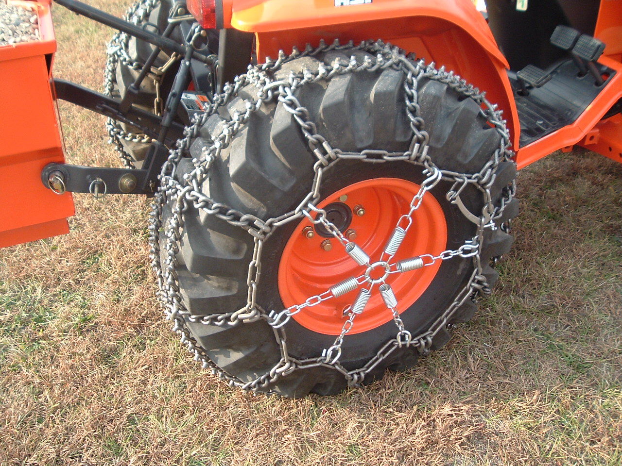

I like the chain tensioners. I installed the tensioners using a ratchet tie down strap hooked through the center ring on one end and the other hooked to the tire chain on top of the tire. I worked around the tire tightening each spring a chain link at a time. These chains have stayed tight for six weeks now. I have done a lot of dirt and gravel work with the loader with these chains on.
Wow - that is one serious set of chains you have there. :drool:

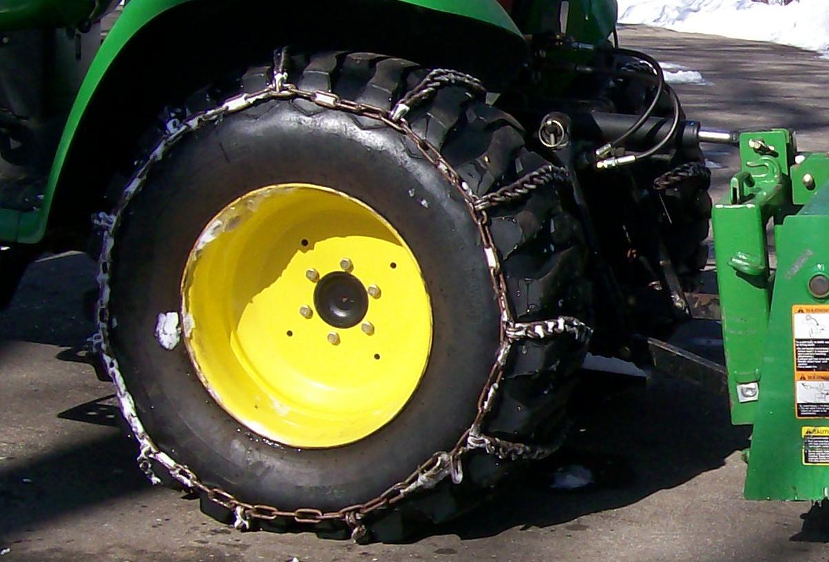

I had to tighten my chains last winter... the photo shows them BEFORE I took out some slop, etc. In my case, the circumferential (if that's the word) chains were not hardened, but the cross chains were. The hardened links will crack when you try to open them/close them, so be sure you know what you are dealing with before you start opening them. I had good luck with a vise and various prying tools. The earlier poster who mentioned getting them tangled is right on. Getting them the right size is good, once you get there.

/ Modifying chains #18
Would bolt cutters work to spread these? They might tend to only open one side but maybe by adding a steel spacer between the two hooks you could force the second side to open.
Could a couple of clevises placed stategically around the side chains take up the slack?
/ Modifying chains #19
varmint
I think they are referred to as "side chains" vs. cross chains.
Do you have a pic of the chains after you made them to fit? That must have been a real challenge. Simple ladder chains can be headache enough keeping the ends from knotting up.
I've found that the cross chain double hooks are pliable and haven't had them crack when opening (just enough to unhook them) and closing. Maybe there are different steel and agree that the side chains are not hardened for surface travel.
