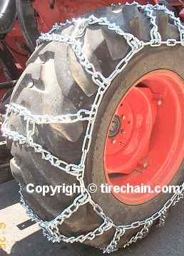

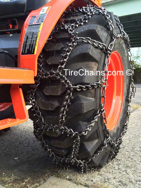

Duo Grip vs Studded Diamond

View attachment 494975 View attachment 494976

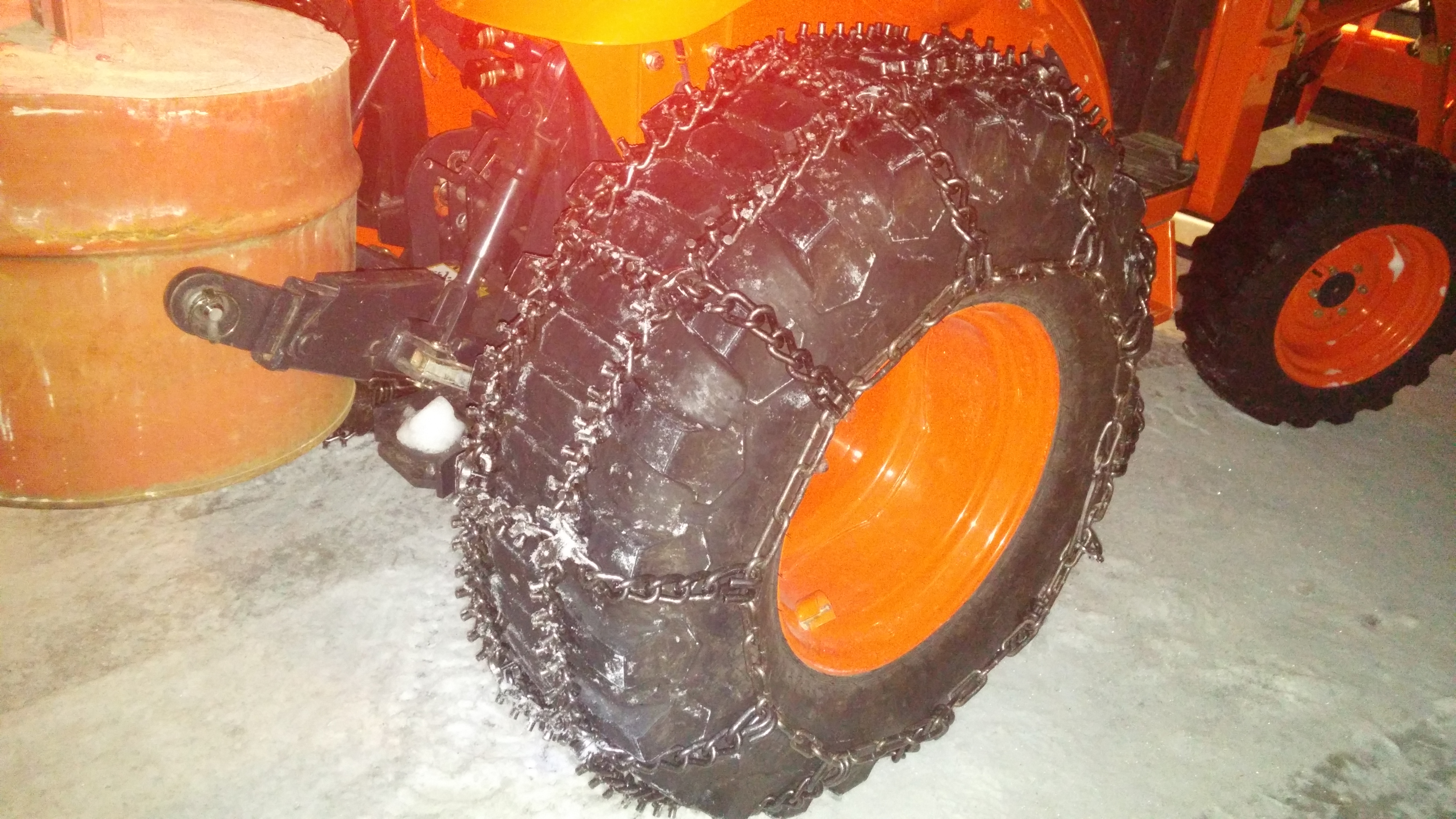

I use Trygg SMT studded chains on the rear R4 tires on my M7040 which are 16.9 x 28.
The chains are advertised as made to fit i.e. no cutting or addling links just put them on and go.
The joint in the chain is where the roughness in ride comes from. See red circle.
