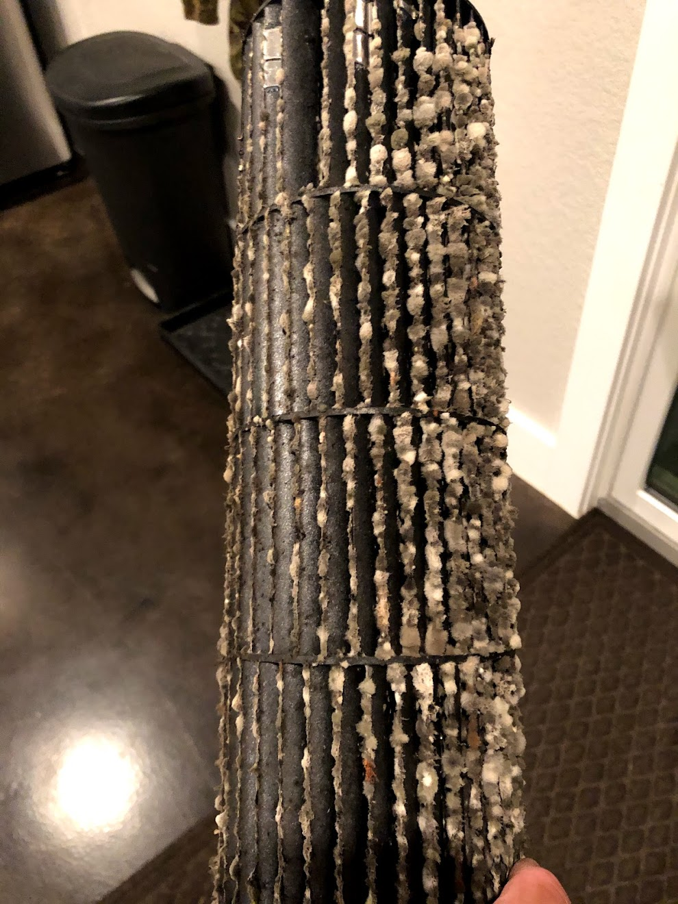

Here is what a clogged up fan looks like.

Seems like you have a humidity scale or growth occurring on the fan - are these running all the time to condition the space, or "as needed when it gets to warm/humid?

What happened in this case is someone was visiting, staying in the guest house, they adjusted the system to extreme settings. We've had our mini-split system for 6 years now. We've had it happen 3 times in those years where a visitor has caused this to happen, despite our warnings.
Two ways I've seen it happen. Someone sets the AC to the lowest temp setting possible. The unit never shuts off, and the coils and fan never get a chance to dry/drain during cooling cycles as normal. Second condition is they set the fan to high and turn the temp up and leave.
Set the temperature and take the remote before guests arrive. Problem solved.
My splits have Wi-Fi connection so I can monitor and set temperatures remotely.
