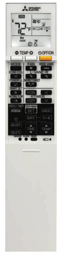

I have a Mitsubishi two unit mini split in our guest house here in Texas, its an OK system, but not a huge fan.
What I like:
  • They are efficient and don't cost a lot to run.
  • They can heat or cool the room fast, so its very easy to move the room in any direction needed for comfort.
What I don't like:
  • The remotes are IR powered. You have to point them at the unit and hear the verbal beep that the unit received the change from pushing the button. There is no thermometer in the remote, the thermometer is in the head unit and is adjusted there based on the air coming into the unit.
  • The units are always on when active, meaning the fan is spinning, the condenser will turn on and off based on the temp setting. There is no way to set these up with a smart thermostat to have them shut off at night or when the rooms are vacant.
  • They are a pain to clean. The filter system is not great and a lot of dirt / dust gets into the coils and squirrel cage fan. The fan is not easy to remove to clean. I spend a few hours a year cleaning mine.
  • I've had some mold issues on mine on the fans when really humid. because the units do not turn off, the fans are always spinning, if you set the unit wrong (IE guest turns the temp all the way down and sets fans to high speed), you can end up with condensation on the fan and mold.
Given a choice, I would probably have the same system installed as I don't really see better options for what I needed to heat/cool this space.
