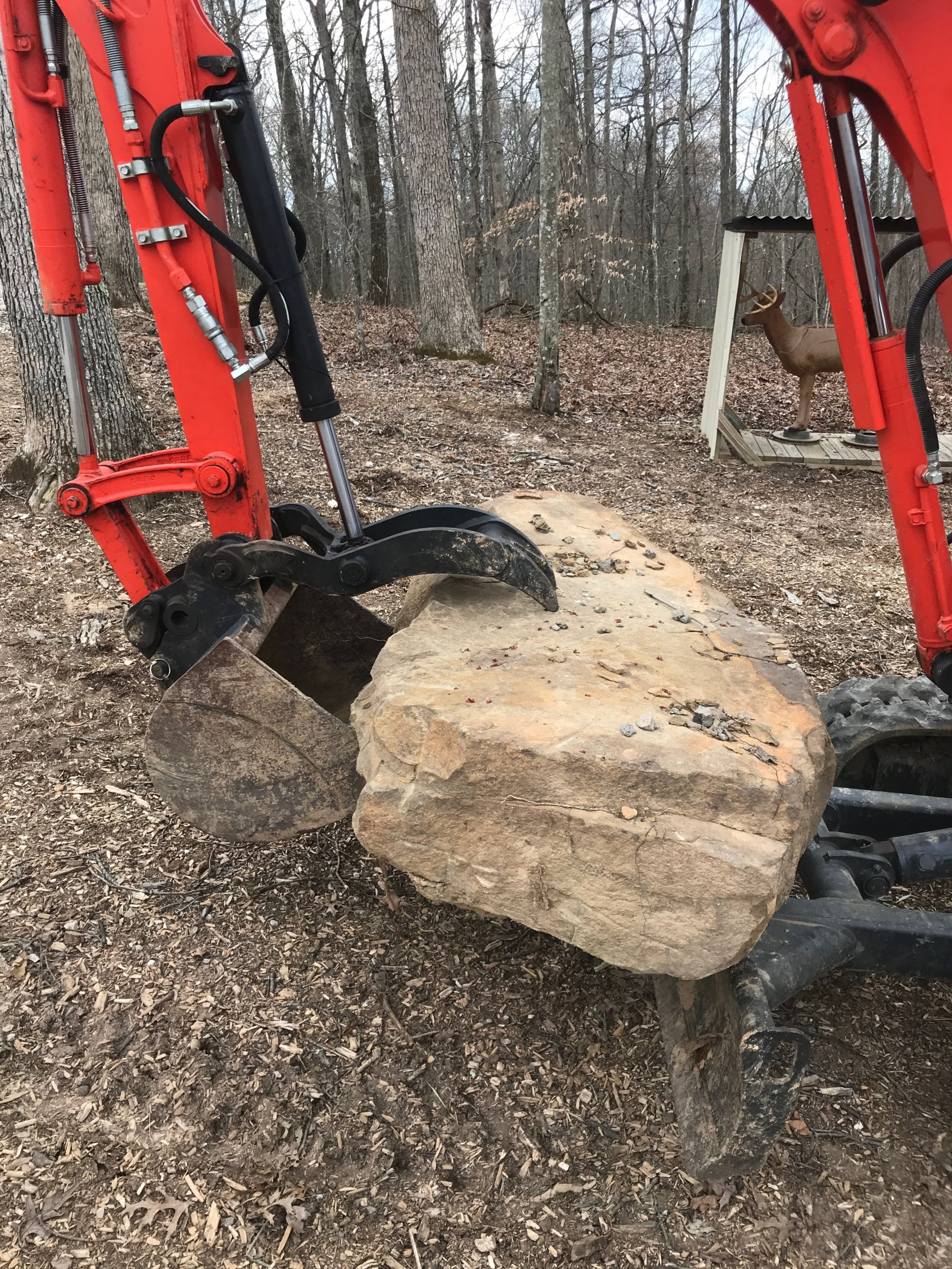

I have a 7000lb [AFFILIATE=1, nofollow=true, newwindow=true, title="Kubota"]Kubota[/AFFILIATE] KX91 and have built a few walls with some rocks over 1500, around 4' -5' high. My machine is not a zero-tail machine so I do have to watch the hangover but it was able to build the walls without any drama. You learn to work with the machine limits - get closer, use your blade to lift the front of the machine to get a bit higher when needed, and things like that.
the attached photo shows one rock I dug out and then moved across the property to be used in a wall. To carry it I set the edge on the blade to take some weight off the boom and tram it around a bit easier. I don't know the weight but it was HEAVY.
Also, are you towing it all the time or just to get it home? If not, have it delivered from the dealer when you buy it, and you avoid all the trailer issues perhaps.

/ Mini Excavator Sizing? #26
Code54 - what's the purpose or use of the buck in the background with the brake rotor feet and shelter?
That is a foam archery target. The foam deer legs have a hole running up them so I welded a smaller piece of rebar to the brake rotors so I can use them as a stand for the deer. If I am not using it for a while I can just lift it up and stick the target in the building out of the weather. The rotors make a nice sturdy base.
