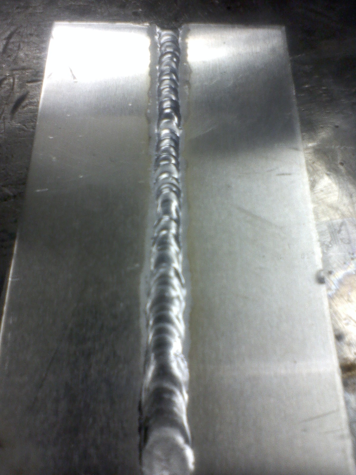

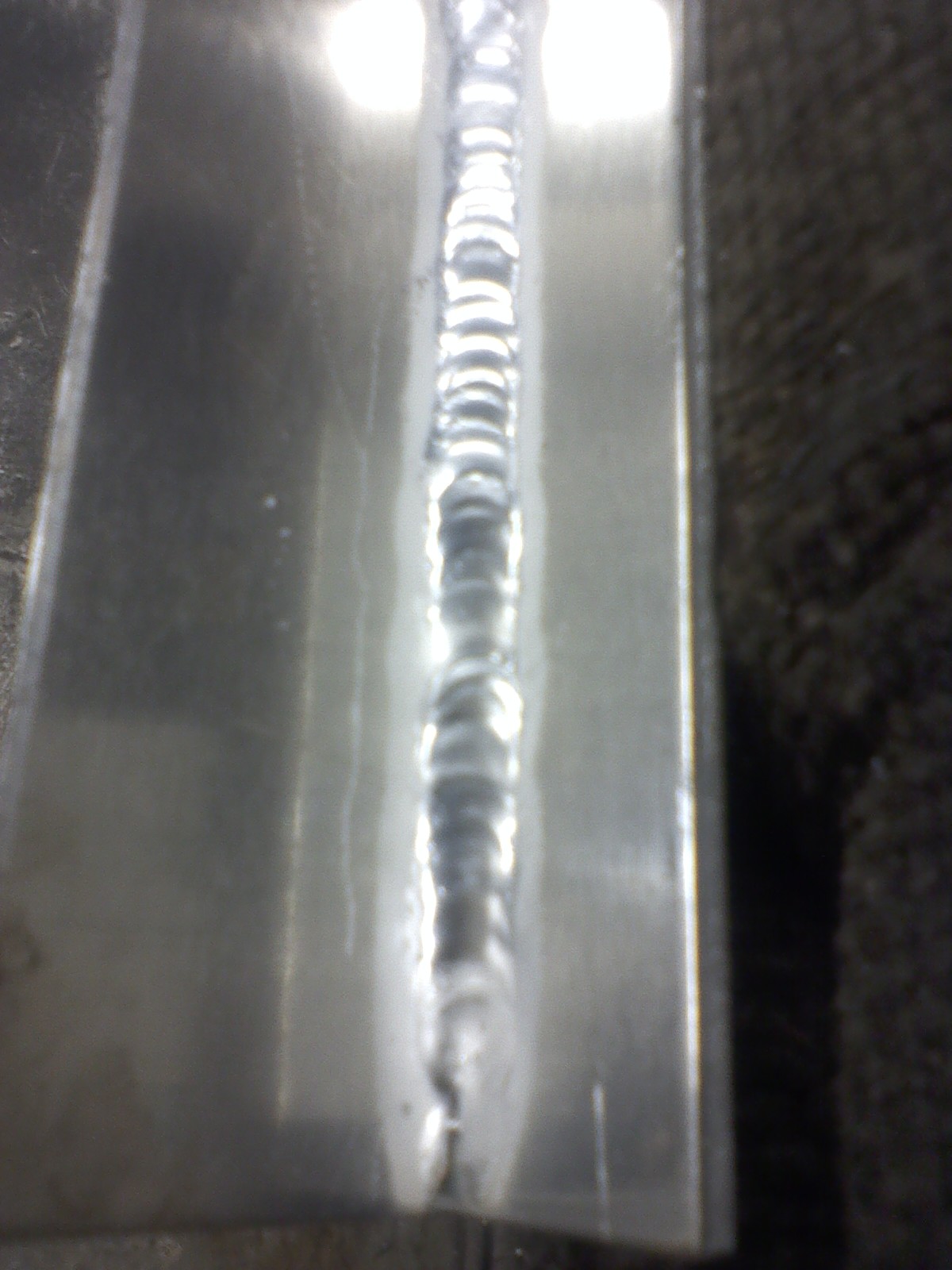

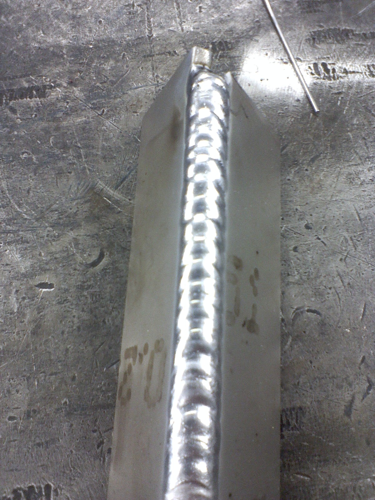

Heres what a dynasty 200 can do with a hack like me.
This is 1/4" 6061 plate, outside corner fillet. Machine settings: 190A, 70% balance, 129Hz with 1/16" tungsten. (I know, but I was too lazy to put a bigger one in).
And these is with 1/8" 3003 plate. One flat weld with no gap and the other Tee joint. Machine set at 100A, 70% bal, and 129 Hz, same tungsten. tig 2.jpgtig 1.jpg
I wasnt real steady with the flat, but I had my thinner gloves on and it was getting a tad hot and I didnt feel like stopping once I started:banghead:
Again, I dont do this everyday. All total I have maybe 10-15 hours of Tig aluminum time. I gotta give all the credit to the machine I think. And my apologizes for the crummy pics. A camera phone is all I got.

Well, just a little update on my end. I put a few more hours on the dynasty today since my last post. Played with ALL the settings. Different pulse settings, hertz anywhere from 60 up to 250 and anywhere inbetween, different wave forms (triangle, soft-square, sine, advance square), etc.
Welding 1/8" plates with a lap joint, and I did throw in the 3/32 tungsten.
I can get about the same results no matter what. All seem to weld about the same, they just sound different. I found that my movement and angle of the gun made more difference than any of the settings I changed. But all were acceptable welds IMO. All look similar to the pics I posted earlier. I can back down a bit and go slower and really focus on timing and moving the exact same every time and get welds that look like weldermikes pics, but in general, about the same.
About the only thing I noticed is it seemed I had a tad more puddle control (almost mroe pin-point) with the higher hertz. Also seemed to puddle up sooner. I typically leave it around 130, and anything from their to 250 I didnt notice much difference other than sound.
