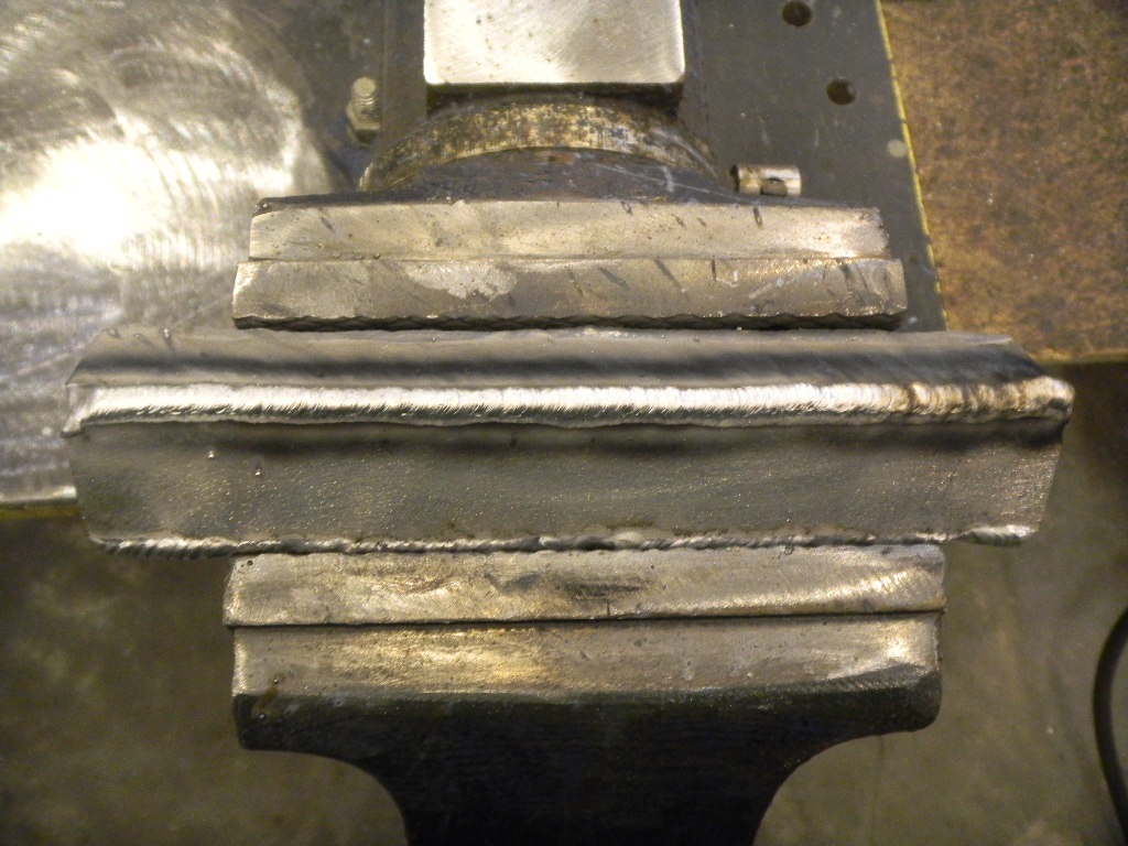

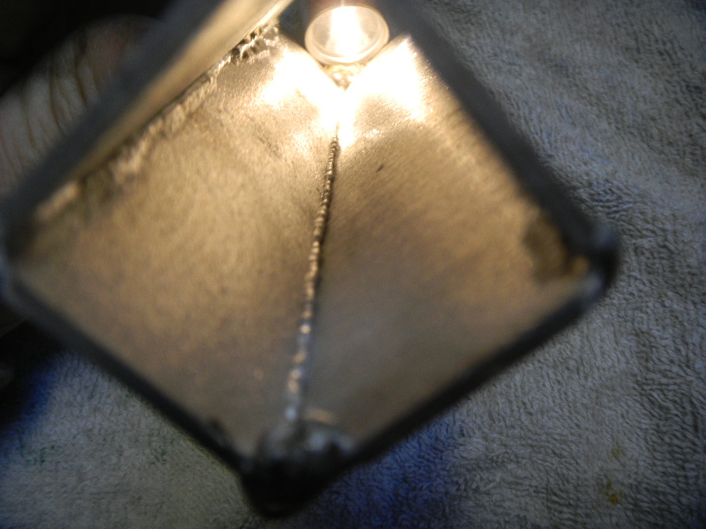

I sort of remember trying to do this years ago, (30) before buying my first Tig welder. I had a Miller S32S remote wire feeder that I ran on my 450-amp diesel drive. I bought the shortest Mig gun I could get, with a nylon liner, U-groove drive rolls for the feeder, and hung the feeder above the work, so gravity could help me. Had to keep the Mig gun as straight as possible at all times, or I'd spend the next 5-minutes cutting the bird's nest out of the drive rolls. It can be done, but what a PITA!
Here is a couple pictures of a 1/16th inch corner joint I did when I first got my spool gun. I'd still rather use Tig! I never have been comfortable welding thin material, even to this day 3/8 inch is about my limit!
Shield,
That's a very good weld for MIG!
I have a spool gun on my Miller and it's a joke if you ask me. It works but for SS and aluminum it just passes. (nothing I want anyone to see!)The trouble is you want to control the heat on those metals and the amps you start with aren't he amps you continue to weld with.
Rob

Yea, our miller 350p has a sp30a (IIRC) spool gun. It aint worth didly. Before we got the tig, we spent more time fiddling with it than actually making the weld.
Anyone serious about aluminum....Tig is the only way to go IMO
Thank you! ;)
But I can't take the credit, if you'll notice my signature I buy top of the line welders, they do all the work. I just turn them on, and point them in the right direction.

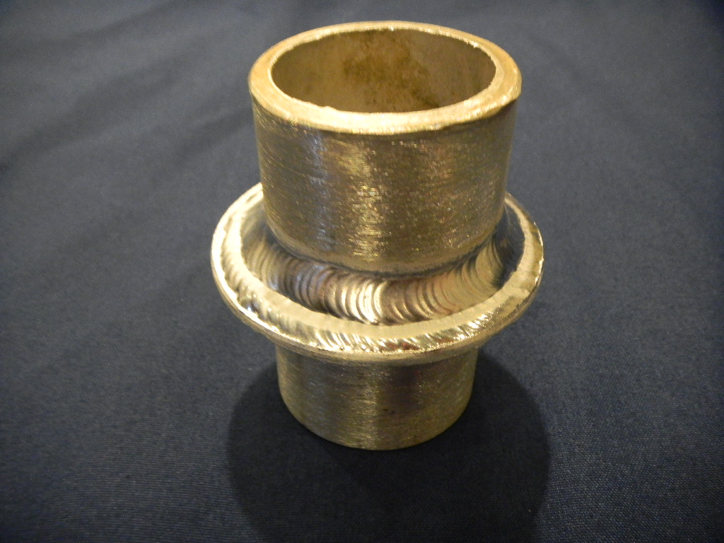

See here is what my Dynasty 300 can do with Tig welding aluminum.

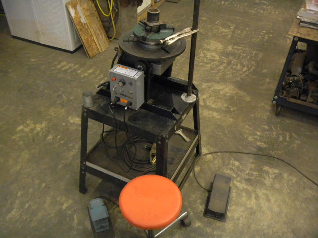

Looks great, have you ever tried a positioner bud? I just got one, and although im still sorting it out, I could definately see the advantages.

I bought one awhile back. If you're anything like me, best get a notebook and start writing down the speeds for which process you're using. Otherwise I forget! :eek:
WP-250 Light Duty, Standard Speed Welding Positioner [AUT-WP-250] - $1,719.00 : Arc-Zone.com, The Welding Accessory Experts
Thats a big YUP! on that. Whooo doggie, you aint kiddin! Im starting to really enjoy it, ive only been using it with tig so far, and still have my moments of brain freeze, but little by little im working that out. One things for sure, I have to build a lower table for it, im short, and its way to high for me on my table, and standing up working two foot pedals is very tricky to say the least! :0
I have mine mounted on one of those cheap Harbor Freight tool stands. The height worked out perfect with my stool. My biggest problem is remembering which pedal to step on!:mad:

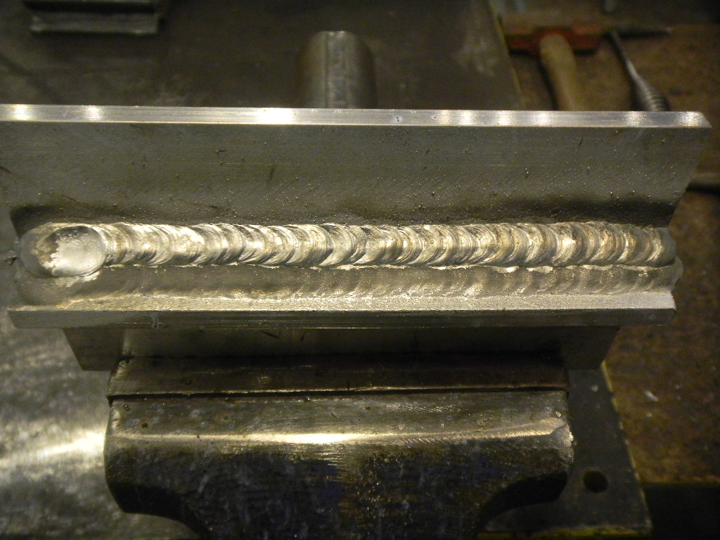

I differ with a couple quotes here, you can make mig look as good as tig.
I've come close to making my Mig welds look like Tig. Guess it's a good thing I can't Tig weld all that well.:eek:
/ Mig welding aluminium #38
Too much spatter and ripples in the puddle. I like tig:D

I thought the ripple / fish scale look is what everybody is after! :confused:
/ Mig welding aluminium #40
Yea, the stack-o-dimes look is what everyone goes for. But in that mig weld, there looks to be tiny "ripples" (for lack of better words) in-between the stack of dimes look.
