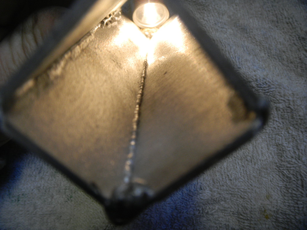

Here is a photo of what I have managed to do so far.
The blobby black bits are the first attempts.
There is one acceptable weld, the upper of the two tube joints. The lower one is cratered and porous.
I can't seem to get a consistent weld as the wire burns back, jams, bunches up and sticks despite careful setting up. Sometimes it doesn't bunch with a good bit of roller pressure, other times, it bunches up even when the rollers have a lot of slip.
Also when the feed is working, and the settings are the same, some welds are so hot that the tube melts away suddenly, other times the weld bead just sits on the surface.
Given it can do a good weld, twice, what do I need to do to try and keep that consistency and not get wire jams and too hot/cold welds?

By looking at your pic's..You are not that far off. Like stated above, You need to learn on thicker material 1/8 or so. Keep the gun straight, tension only as tight as needed and practice. Your welds look like most 1st attempts. You will likely never be able to do a perfect job and that's why they make Tig units, Spool Guns, Push Pull and Twin Pulse Synergic options..

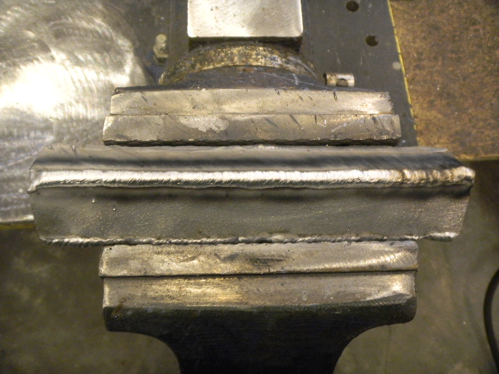

I didn't read every word in this thread, so forgive me if this has already been mentioned!
I sort of remember trying to do this years ago, (30) before buying my first Tig welder. I had a Miller S32S remote wire feeder that I ran on my 450-amp diesel drive. I bought the shortest Mig gun I could get, with a nylon liner, U-groove drive rolls for the feeder, and hung the feeder above the work, so gravity could help me. Had to keep the Mig gun as straight as possible at all times, or I'd spend the next 5-minutes cutting the bird's nest out of the drive rolls. It can be done, but what a PITA!
Here is a couple pictures of a 1/16th inch corner joint I did when I first got my spool gun. I'd still rather use Tig! I never have been comfortable welding thin material, even to this day 3/8 inch is about my limit!
