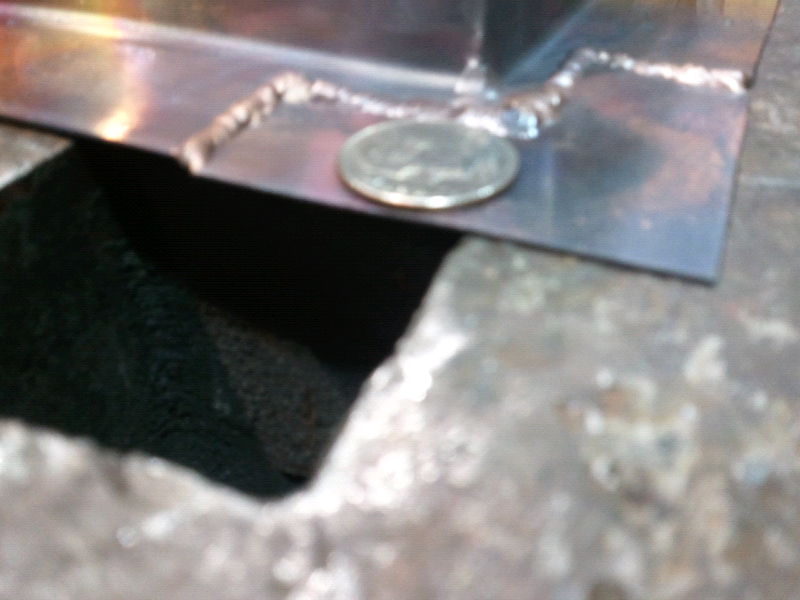

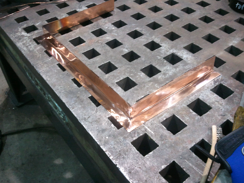

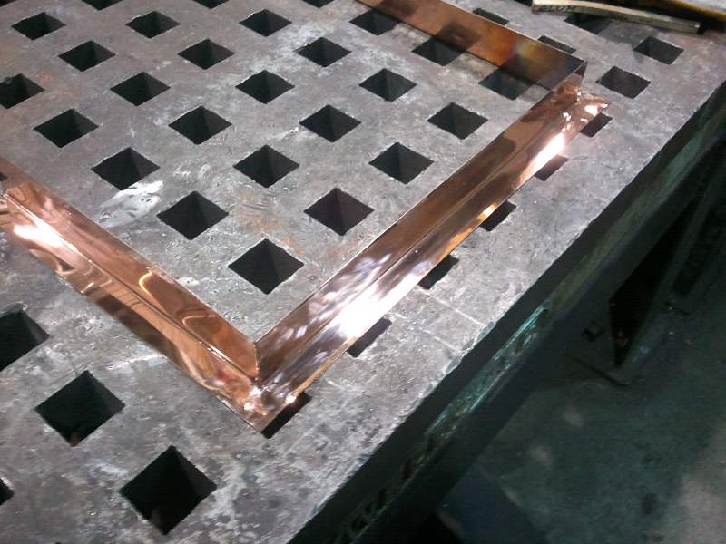

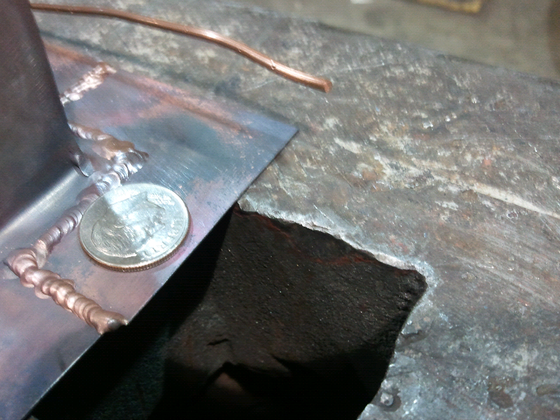

LD, if you really want a brain focus, finger burner give this a shot, 28ga copper sheet. Ugh this project is killing me. Doesnt help that im using #6 solid house wire, probably around 3/32.
/ Mig welding aluminium #63
I don't know your application but I simply solder sweat copper sheets. I built a crook for my chimney 20 years ago and it is still in good shape with this method. If the seam is stressed I use mechanical bending to add strength.
Rob
/ Mig welding aluminium #64
Rob
Strictly ornamental Rob, didnt want any discoloration in the blend work. Just finished the blending and polishing about 2 minutes ago! LOL

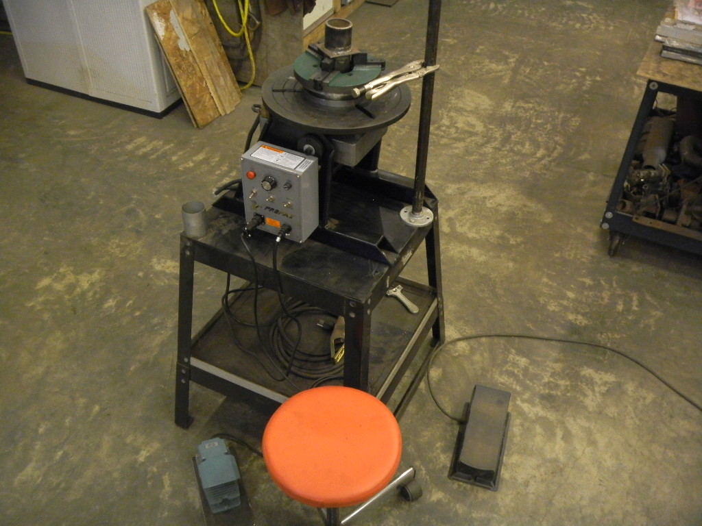

I bought one awhile back. If you're anything like me, best get a notebook and start writing down the speeds for which process you're using. Otherwise I forget! :eek:
WP-250 Light Duty, Standard Speed Welding Positioner [AUT-WP-250] - $1,719.00 : Arc-Zone.com, The Welding Accessory Experts
Cool. You got one. Man I wouldn't be without mine. If its something round needed welding I use the positioner but I did mount it on a dedicated adjustable table and added a few arm supports. Getting the speeds set up right comes easy with practice.
I read that someone didn't like using the MM350P with the spool gun. Something's set up wrong if your having trouble. I use mine for thickness' over 1/4" and it welds fantastic.
