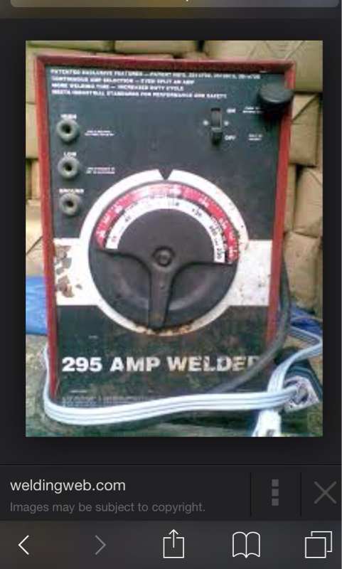

Terry you wanted a picture of my John Deere welder.
/ Mig Welders #42
Terry you wanted a picture of my John Deere welder. <img src="http://www.tractorbynet.com/forums/files/welding/407621-mig-welders-forumrunner_20150120_092655-png"/>
Nice! Thanks. Any idea who made it for JD? Bilingual label for Canada... Terry

Terry i just had a good look at the welder and the operators manual and there is no info in there as to who made the welder. I've had it apart once to replace a spring inside so that the amps wouldn't change while i was welding.
/ Mig Welders #50
Terry i just had a good look at the welder and the operators manual and there is no info in there as to who made the welder. I've had it apart once to replace a spring inside so that the amps wouldn't change while i was welding. <img src="http://www.tractorbynet.com/forums/files/welding/407679-mig-welders-forumrunner_20150120_152924-png"/>
Ernie according to Welding Web it is probably made by Century.
Don't ever sell it :)

I entered 295 into jdparts and two models showed up. Mine is the first model in the parts book. Thanks for the picture and info Terry.
I enjoy welding with mine. I weld with mostly 1/8th 7018AC. They aren't the easiest rod to weld with but if I use them every time then when I need to make a critical weld at least I don't have to learn to weld with a new rod first. Over the years I've come to exclusively use Lincoln rods because they weld so nice. Hilbilly that might have been your problem as not all rods weld the same. Plain 7018 (no ac) rods are just about impossible to weld with
I also have an ArcAir model K2000 that I use with this welder. I needed to buy ac carbon rods but it works. It a pain to keep the arc going but it works. For a few years I couldn't afford to buy an acetylene contract so that's what I did all my cutting with, that I couldn't do with a chop saw. The ArcAir uses the full 295 amps. I tried it with a Miller 225 but the juice just wasn't there.
