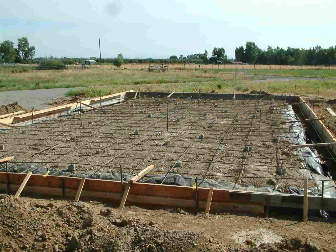

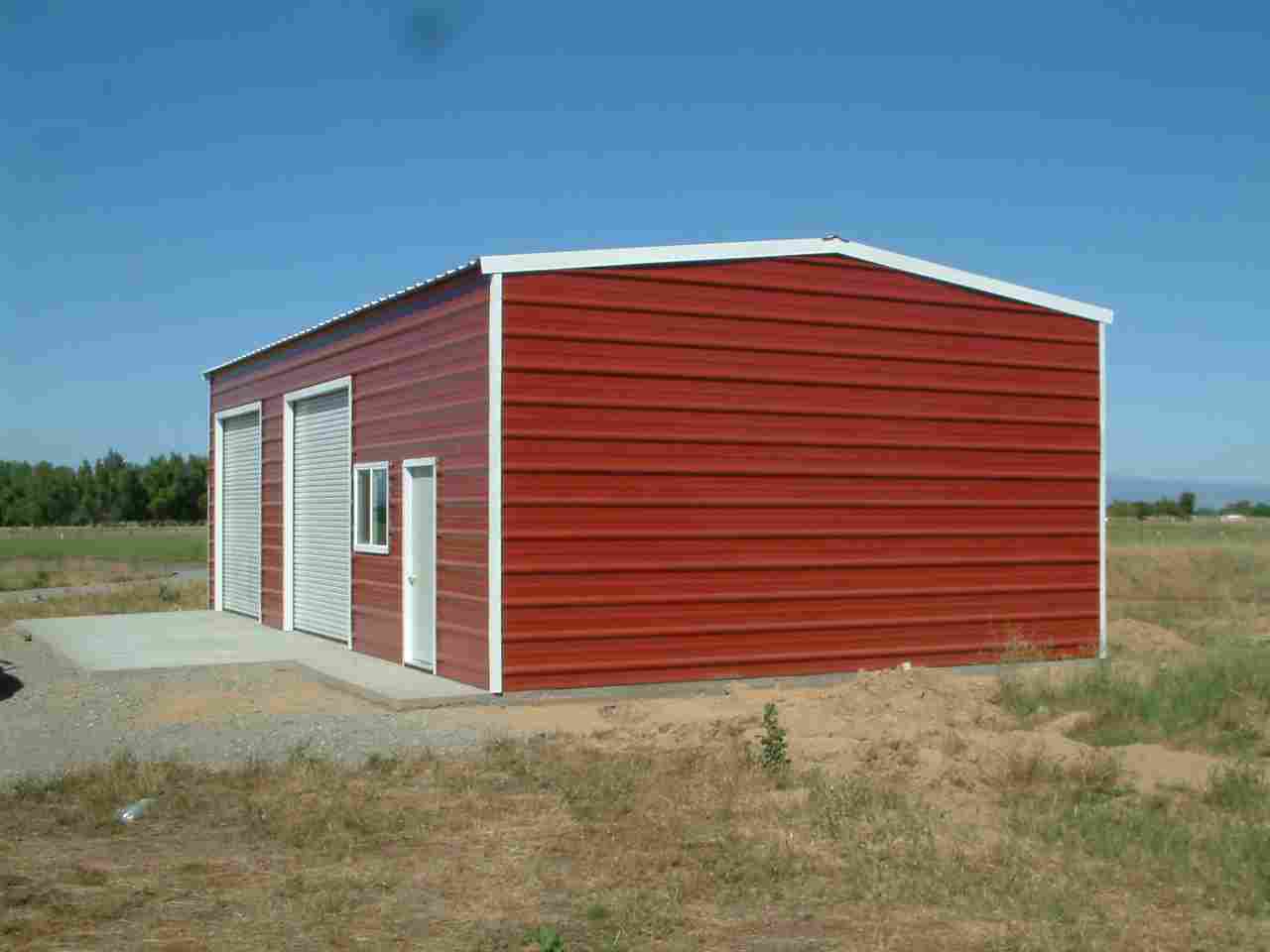

My shop is a 24x42 ft metal building with 12 ft walls, two 10x10 ft rollup doors, one window, one man door. Cost: $16K installed (in Jun05). Floor is 6" thick 4000 psi concrete, #4 rebar on 24" centers with 10x25 ft concrete apron in front of the two big doors. Cost: $7K.

Thanks for the pictures
