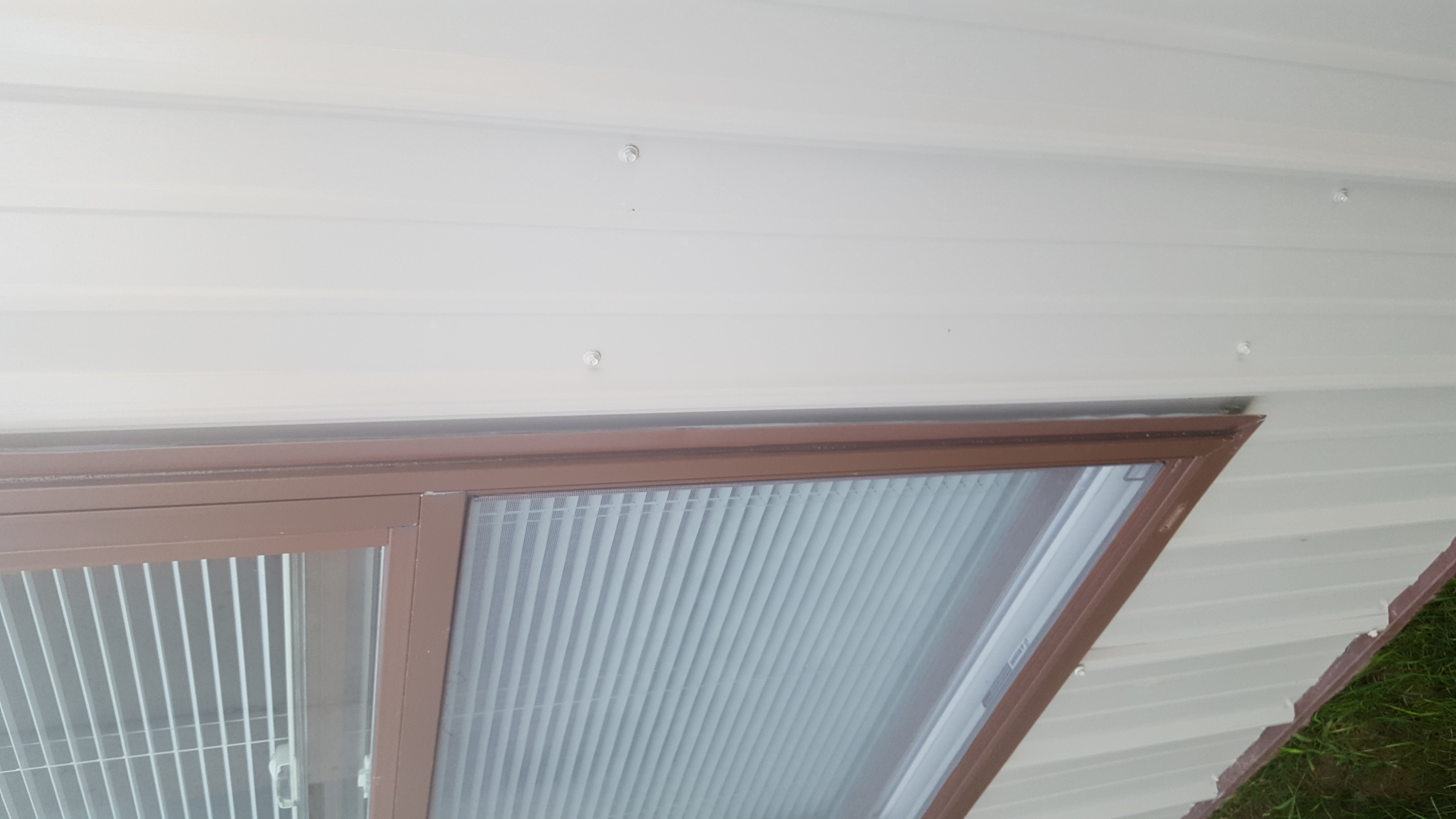

Thanks for all the responses. View attachment 486845View attachment 486846View attachment 486847View attachment 486848View attachment 486849View attachment 486850 Tried to attach photos, will see if it works. Gutter overhang is not the issue.

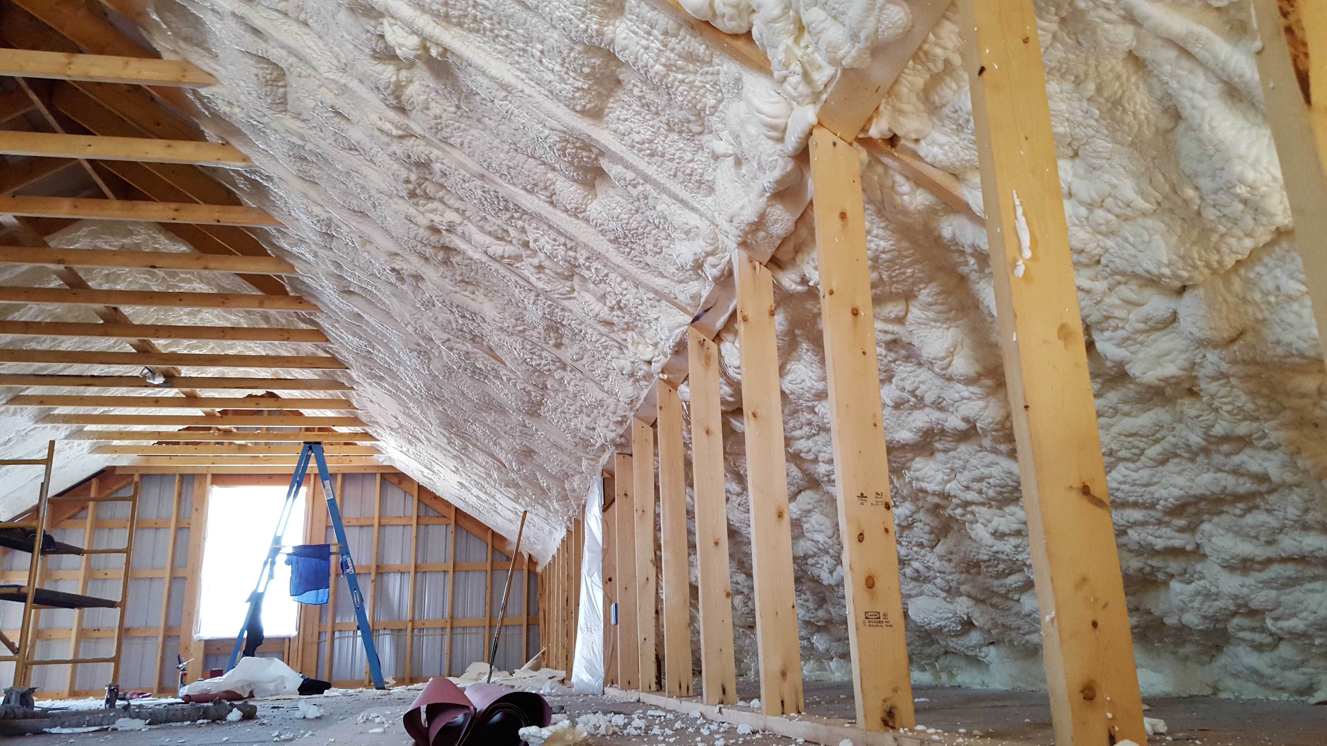

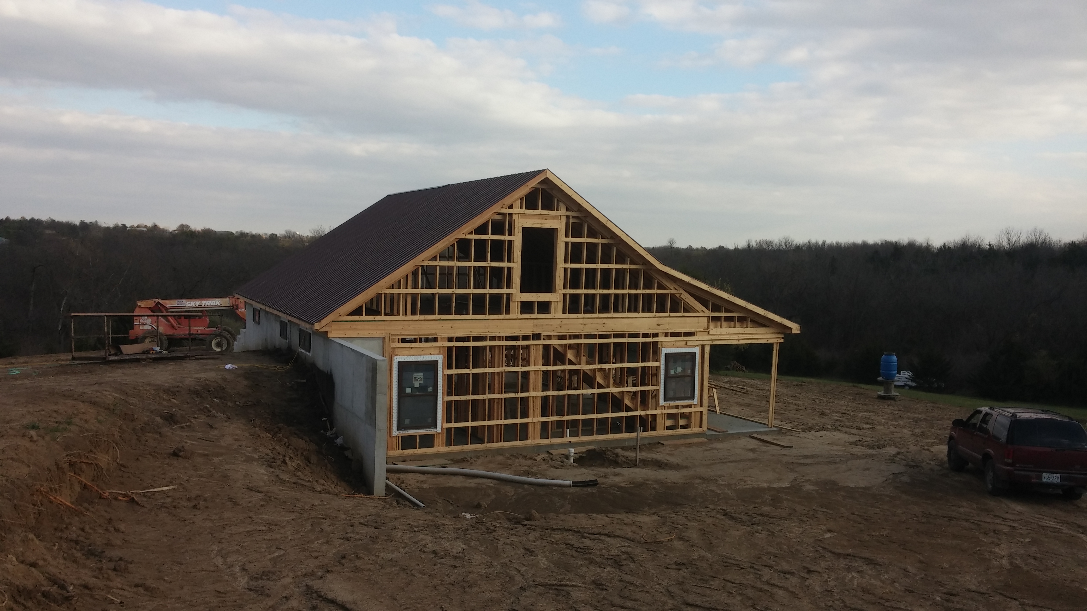

After looking at these pictures I'm conflicted. Your builder did a really nice job of framing your building. Exceptional. So I kind of feel bad calling him an idiot. But then he did use open cell foam, and that's really, REALLY bad. Was that his idea or did the spray foam company talk you into using that stuff on a metal building? Maybe your builder was outside the loop on that part of it because he really seems to know what he's doing on the framing.

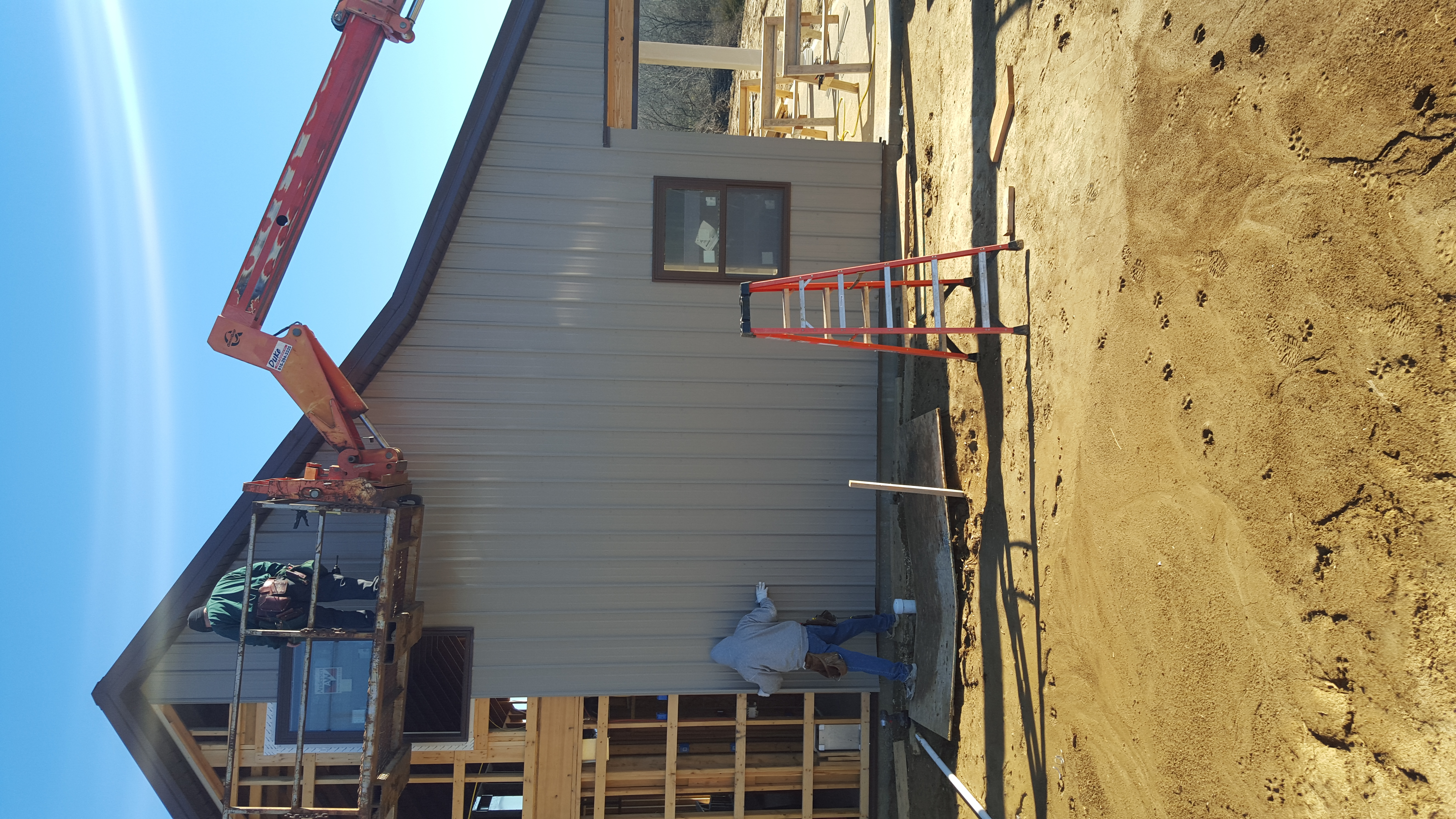

I like that tape was used on the windows. I don't think they are leaking. While this is just splitting hairs, if all the windows are taped like that, the leak is not from the windows. Even if the water is on the windows or around the windows, they are not the problem.
Your issue is in your J channel around the windows and the metal siding. From your pictures, it kind of looks to me like he cut the top channel at a 45 degree in the corners instead of keeping it straight so water will go out past the window. J channel should catch the water coming down the wall and act like a miniature gutter by carrying the water off to the sides, away from the window.
Was the J channel installed properly behind the siding with fasteners at the top of it and away from the lower area that would allow water to get through it?
Piling on caulking is not the answer. He needs to remove the metal siding and redo the channel around your windows. My guess is that somebody new on the job did this wrong and either didn't know any better. This is not a slop job, so it leads me to believe it was a beginners mistake that just got overlooked and your builder is hoping for a quick fix instead of losing money redoing every window.

I'd have him pull the siding around the window, then remove and redo the window with properly installed j channel. Bottom piece first, then sides that extend a little past the bottom, then top that goes over the sides. Reinstall siding and refoam inside w closed cell.

I've never heard of open cell foam pushing anything. It's pretty soft, which is why it holds water so badly. I don't see any reason to remove the windows at this stage, but the metal does have to come off to fix the problem.

So looks like the advice is to have contractor redo the J channels around the windows. Open cell was stated in the contract, spec recommended/provided by builder, I asked for sprayed insulation. I asked when it was being installed if it acted as the vapor barrier. The contractor said yes. Insulation guy said with thickness of installation condensation on inside of metal would not be a problem. Inside is done, so I don't see how to go back and retrofit with closed cell.
/ Metal building leaking windows #30
Commercial foam (closed or open cell) should not be applied to window or door frames. Due to its high expansion rate, it will distort the frames locking windows and pushing doors out of square. These areas are filled with can foam.
It's hard for me believe that an experienced spray foam company would make this mistake. If the windows open and close as they should, I doubt this is your problem.

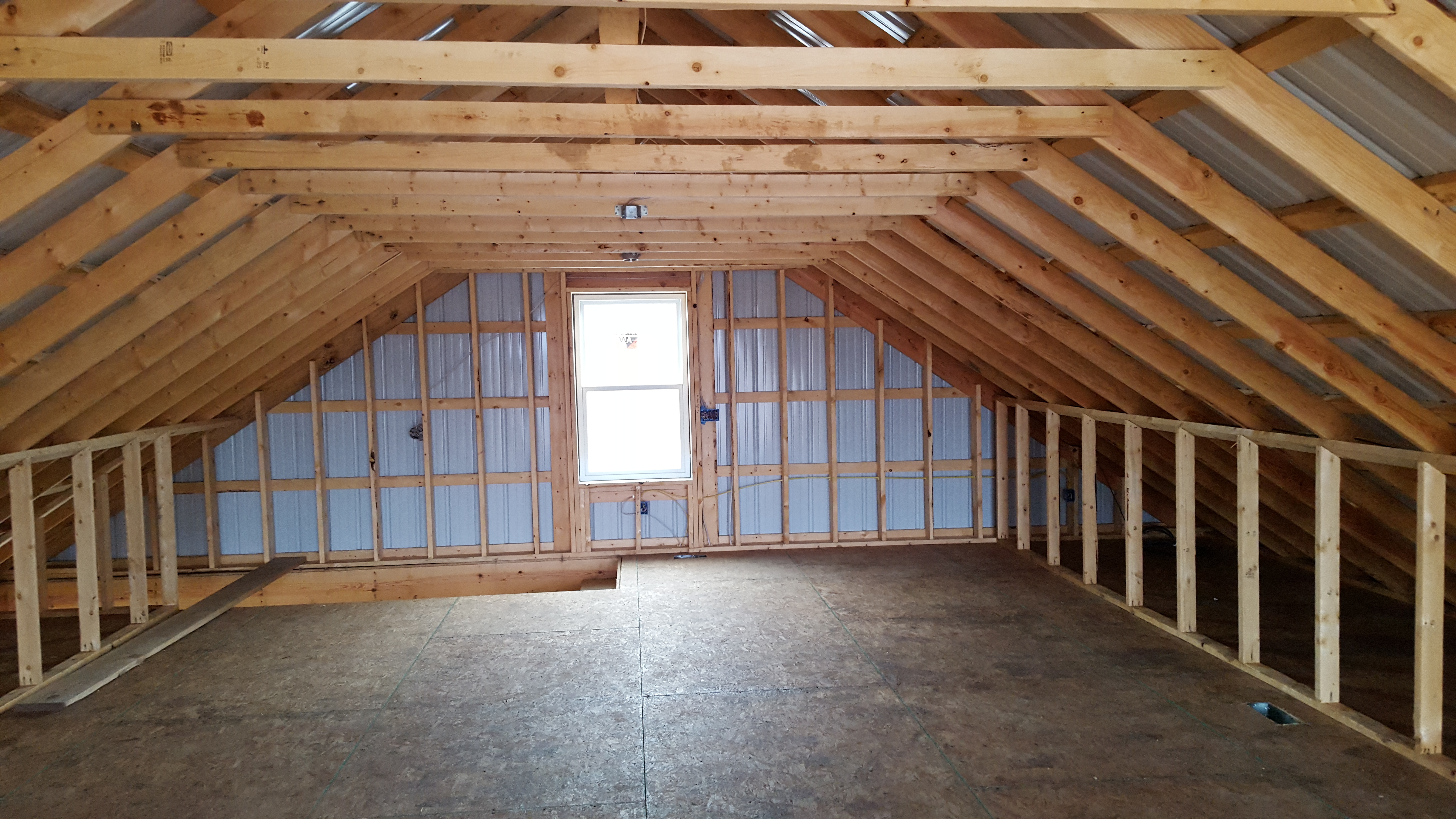

Looks like they used can foam around the windows, you can see a can on the floor by the window in the photo.
Overall it looks like a very well built building and the fact that your contractor has been back so many times already says good things about him.
Careful of all the internet experts here trying to dump on him, so far they are batting 100% wrong.:laughing:
/ Metal building leaking windows #32
I somehow missed that picture to first time. That's a standard can foam gun so I would say they done it correctly.
