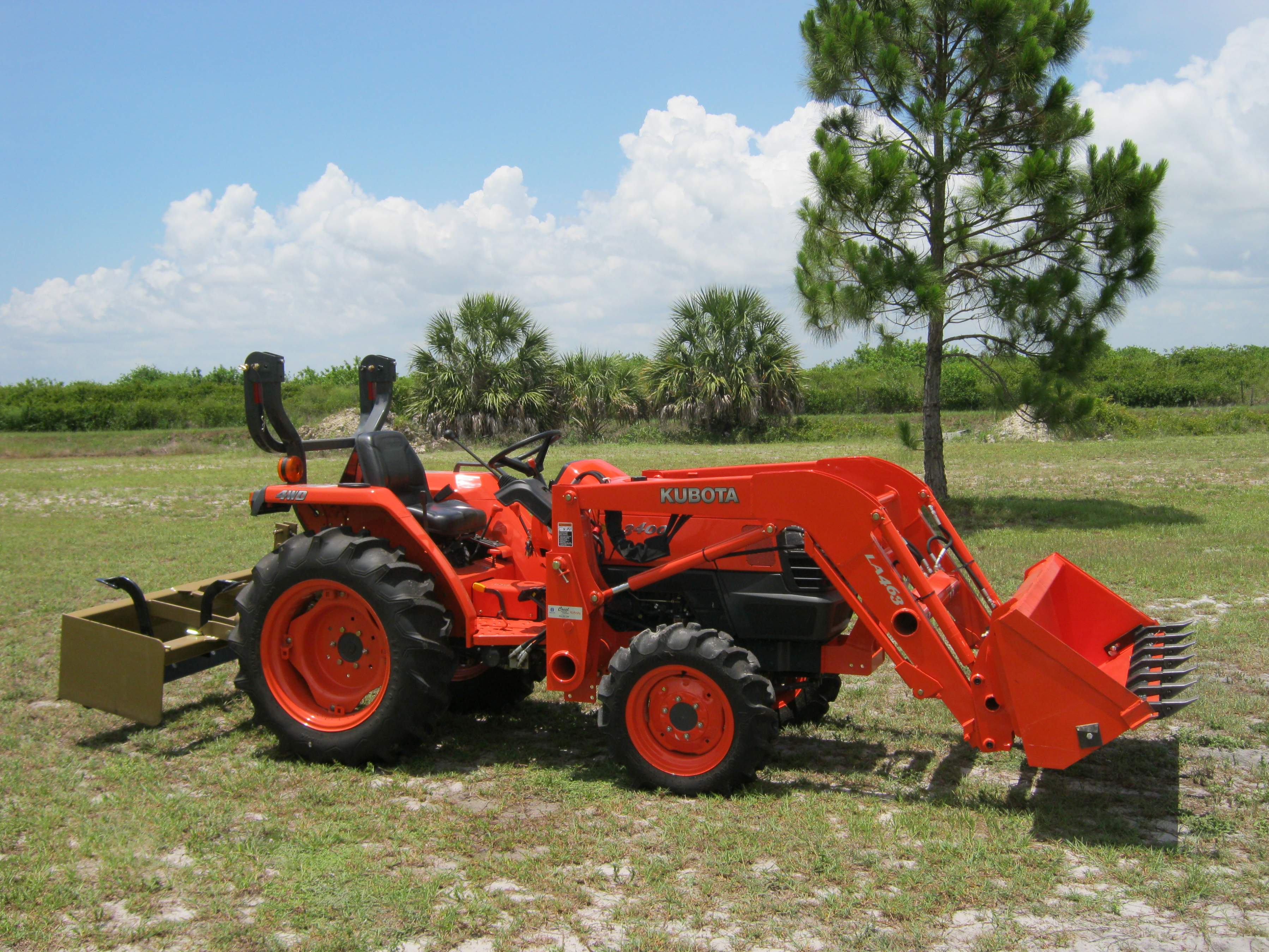

Hello there Sawtooth
Thanks for posting your review on that MF 461.Hope you get your issue resolved with your loader.Maybe look under search here on TBN and find solution.
If I may ask you a question :Which disposable Kubota type compacts are you refering to?Because I own a Kubota and I was hoping its not on your list. :)

Now as for Kubota its probably one of the best quality fit and finish tractors I've seen. Haven't tried the 60 plus hp units but the smaller ones are good light tractors for easy transportation. However that benefit has a negative side by not being as structurally strong. Kubota also uses high revving engines which I don't personally care for but they are well made. I come from the old school of thought that likes low revving high torque motors with tons of lugging power. Anyway it depends on what you need and like. Besides all manufactures now make the lighter compact style tractor and Kubota may just make the best of those style of tractors. By the way my PTO speed is 1800 but my friends are 2800 on the Deere 990 and Kubota MX5100 I believe. Either way both work its just what you like.
