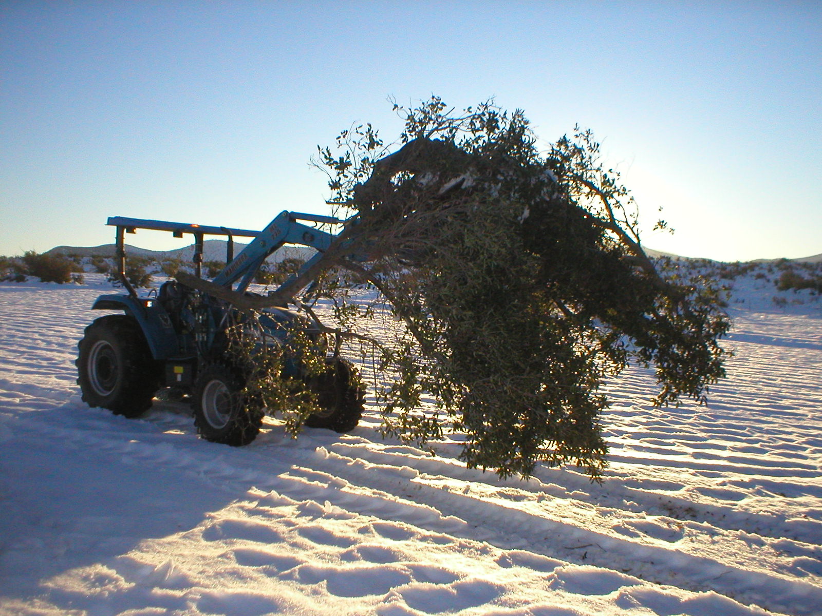

Been comparing the 6530 and other Mahindras with JD5065E & greater, NH T4000/4020 4wd. The one thing I would really like to have is a clutchless power shuttle. It costs more so in ballance, one might expect less tractor in the same price range. Tuff call. :confused2:
/ Mahindra 5530 & 6530 ? #19
To get a power shuttle in a Mahindra you will have to go with the 35 series tractor and even though the 5035 is a very nice machine, it is not the size of the 30 series and not even close to the 60 series machines. You may have to go with one of the other brands if a power shuttle is high on the list unless of course the 5035 is actually big enough for you. :confused3:
Root grapples work great for moving trees and other stuff around. :cool:

Brian, that grapple pic depicts exactly the kind of stuff I have to pick up and move.:thumbsup: What tractor & grapple is that in your photo? Nice!
BTW, there is a part of me that is thinking: "buy a used bobcat to finish the clean up and a basic tractor to maintain farm". Added together, those would undoubtedly cost more than just buying an upgraded tractor.
