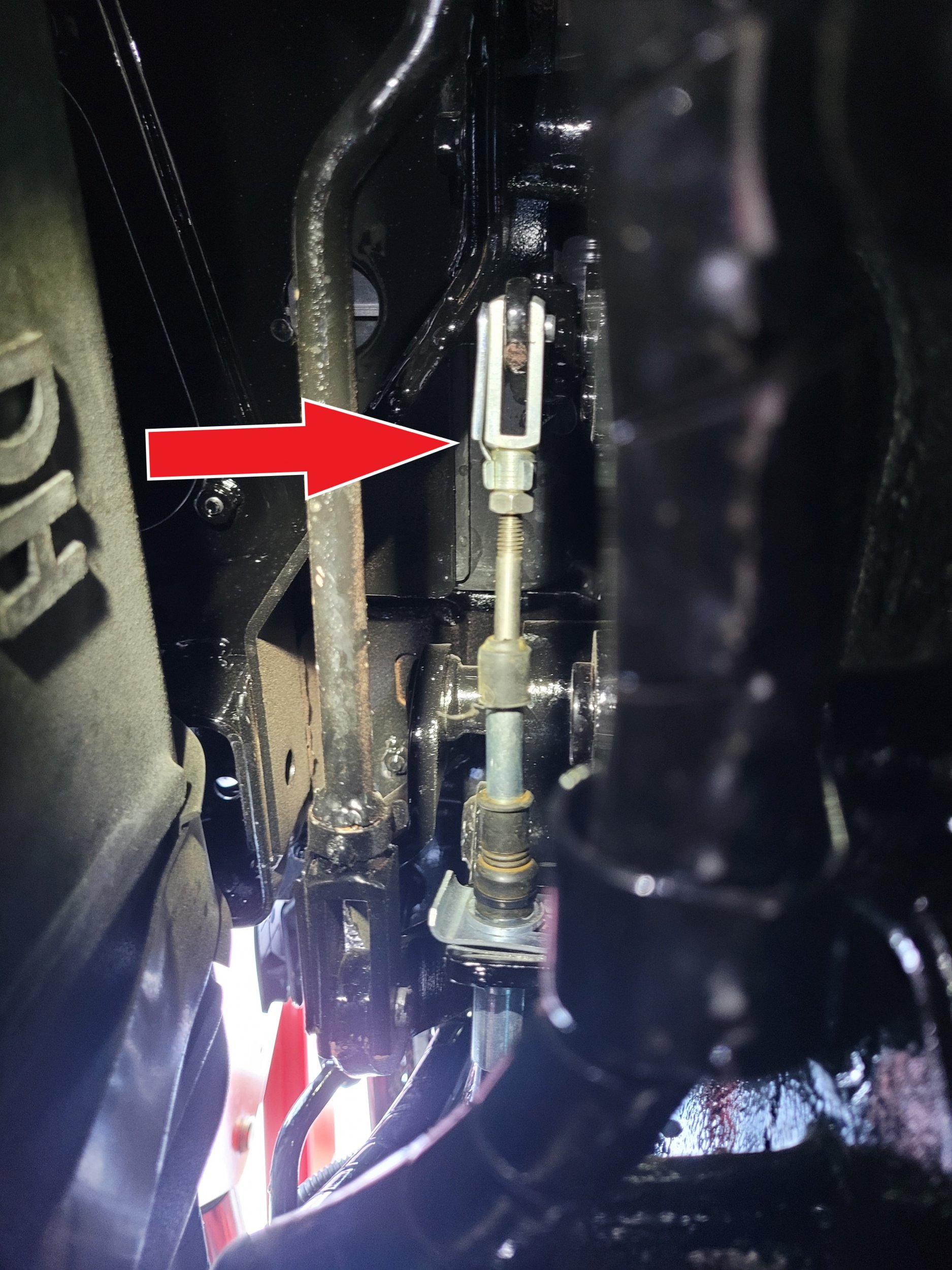

Update:
Couldn't sleep anyways, so I got up early this morning and started researching. I bought the pdf 5155 service manual from Bill's Tractor. Got it downloaded, turns out I was sent the manual for the 4500 series by accident, I am hoping. Regardless, nothing useful regarding shift linkage for the 5100 series.
So, I went outside and started to really inspect the linkage, which I should have done sooner. The shuttle shift cable connects to the shift lever on the side of the transmission. It is located beneath the floor boards between the fuel tank and the transmission as shown below. The cable shifts the lever towards the rear of the tractor for reverse, or towards the front for forward. There is a small range of adjustment in the clevis at the end of the shift cable.
I suspected the shifter was not shifting the transmission completely into reverse, causing it to pop out and grind under load. I backed off the retaining nut and removed the connecting pin, which is held in place with an attached tab that snaps around the shaft of the clevis. I rotated the clevis on the threaded rod two full turns to lengthen the throw of the linkage, thus shifting the transmission "further" into reverse. This adjustment was small enough to not affect the Forward shifting throw.
Replaced the connecting pin and tightened the retaining nut, then did some testing. Made around 100 forward/reverse shifts in the yard without it popping out of gear. Tried every gear with different amounts of throttle to simulate different loads. I put it in 4wd and stopped the tractor facing downhill on a slope. Then I backed up the slope using a variety of gears and throttle, including some quick clutch releases in high-range/1st to really put the shifting mechanism under load. Never popped out.
I'll be posting if it happens again, but knock on wood adjusting the shift linkage seems to have cured the problem.

Update:

I wonder if this is a 55 only issue? I have no problem with this on my 5145.
Eh, I dunno. Andy has a 5155 and he hasn't any issues at all with his.
I tend to believe that it is a recently occurring assembly problem, since the other fellow that posted about the issue had just recently bought his tractor as well.
Parts wise, the shift linkage design of the 5145 and 5155 should be identical, which would lead me to believe that both models would have the issue. Unless they are assembled on different lines, which would prove that it is in fact an assembly issue.

Meant to reply the other day but just wanted to let you know that I adjusted the linkage as you explained and it seemed to have fixed it perfectly. I noticed in the photo yours has more threads exposed than mine did initially and I backed mine up 2 complete turns as you posted. So far so good. Thanks again. Saved me a dealership trip and warranty work!
Awesome! I'm glad to hear that it worked for you as well, good deal.
As for the 3 pt. lowering adjustment knob, it definitely doesn't seem right in my opinion. I mean, everything else on the 5100 series seems to be so well designed and thought out, if makes so sense to have something as dysfunctional as that by design.
I definitely recall that when I went to fiddle with mine for the first time the other day, it seemed to make one smooth rotation, then became loose and "kinked" is probably the best word to describe it. The more that I mess with it the worse it seems to become.
Think I'm gonna call my dealer tomorrow as well, see if they know anything about the issue. If I don't get anywhere with that maybe I'll dig into it this weekend.
