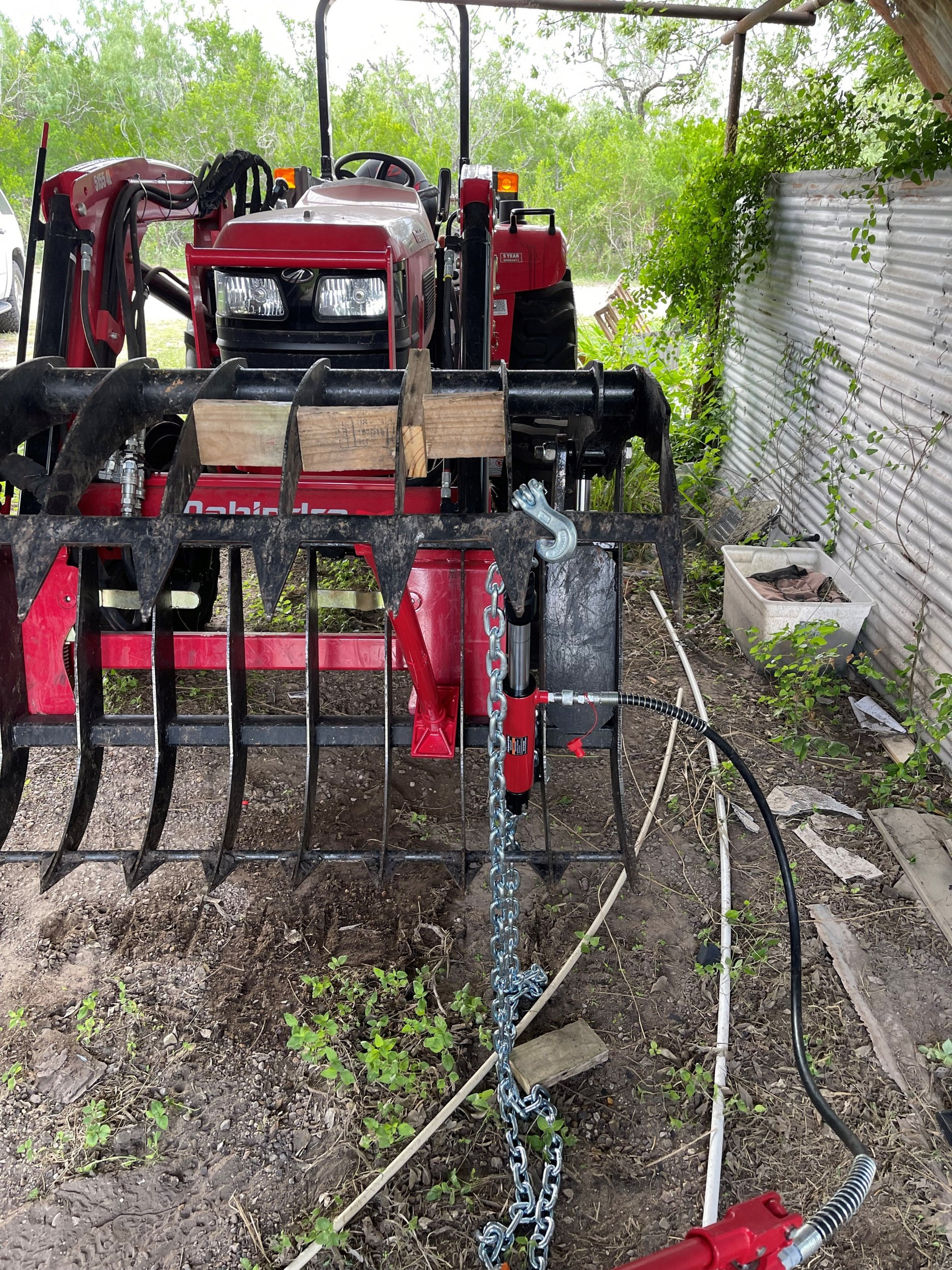

I hope this photo helps also, what not to do lol
8" huesach and too much force, But there is a method to my madness. I purchased a light duty grapple expressly for the purpose of it being the weak link until I gain some experience with the FEL/Grapple, this is the second time I have pushed too hard and each time it is the grapple that has bent not the FEL. in this case i forgot to roll the fel down before pulling back so instead of putting force on the hinge part i put it on the end of the cover, which is the weakest point on the grapple.

I fixed the grapple, 10 ton porta power a pull back ram, 1 smashed finger, not perfect but chicks dig scars right.View attachment 748325
Lol. Yeah the chicks dig it. Grapples are awesome tools. Glad you’re using the tractor. The more hours I put on mine the more I like it. Over the past two weekends I placed and graded about 46 tons of limestone gravel in my driveway. Tractor and loader working good.
