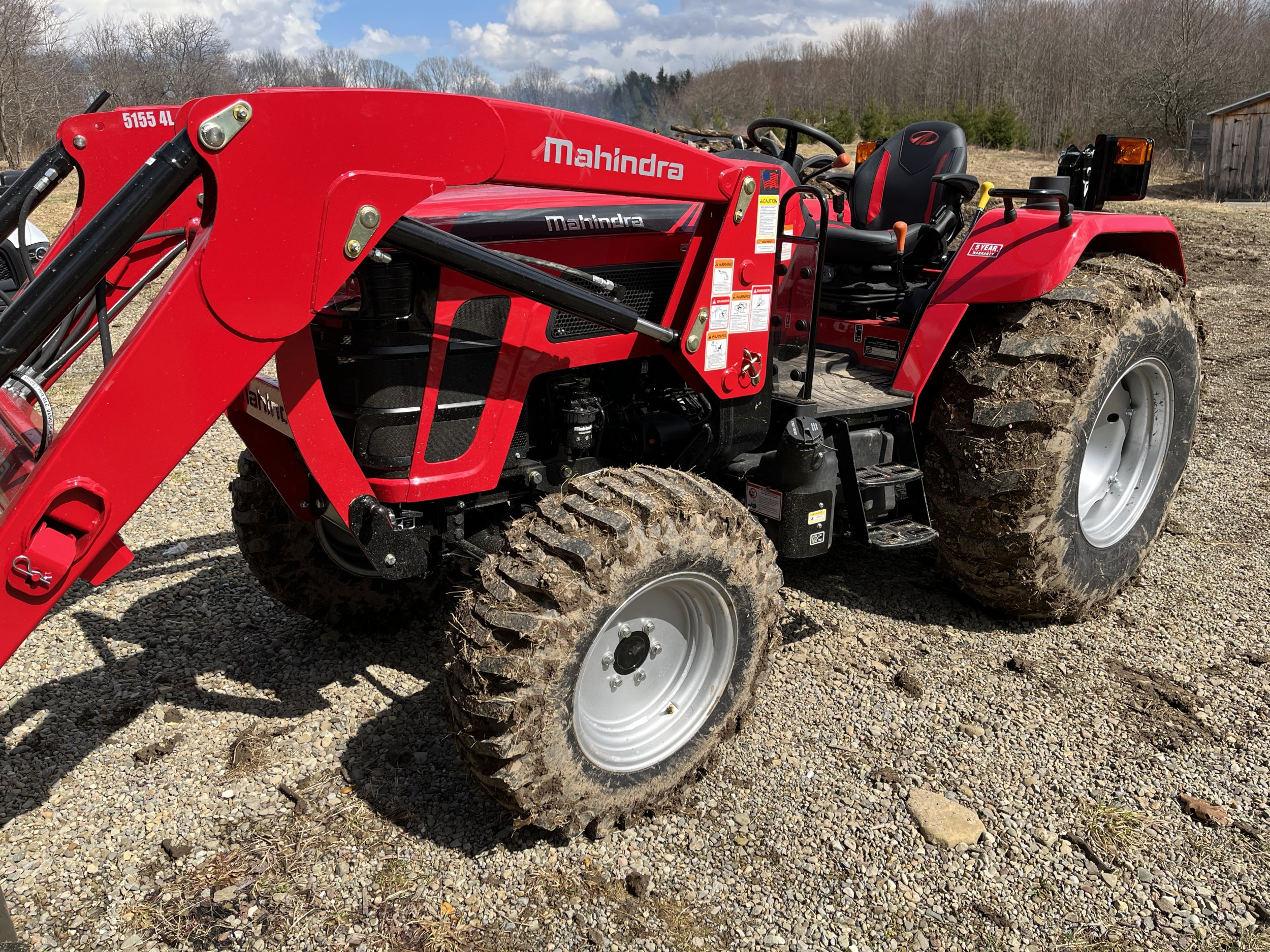

Today has been a good day. I loaded up our 4540 last night and we left at 4:00 AM this morning to make the three hour drive down to Knoxland Equipment in Warren, NH. We purchased our 4540 from Knoxland exactly two years ago on this day. They were hosting an Open House today and requested we arrive early before the crowd arrived, which is preferable for me anyways.
We traded our 4540 with 311 hrs. towards a new 5155. I had it set up with loaded rear tires, dual remotes and the narrower 16.9x24 R4's. Operating weight should be almost exactly 8000 lbs. Next time I haul it north to our camp I'll swing into a truck stop and run the combo over some scales (I already know the weight of the truck/trailer). Then we'll know the exact weight.
Anyways, once we got it home and unloaded, me and my S/O (pictured) only had to operate it for about 1 minute each before we agreed that it is far superior to the 4540 in literally every way. I love everything about it.
What a stout machine. Once we finished playing with it I hooked up our 3 pt. wood box and hauled a couple loads of firewood up the hill to be stacked. Where the 4540 would run out of power and bog down, the turbo on the 5155 spools up and the tractor chugs up the hill without a hitch. While it only makes 15 more horsepower at rated RPM, the turbo produces almost twice the amount of torque at lower rpm's (~1500 rpm) and I can tell you that it makes a substantial difference.
I'll be posting more about the machine the more that I use it. First impression though, I love the 5155 and can't wait to try it out on all the chores we used the 4540 for.
