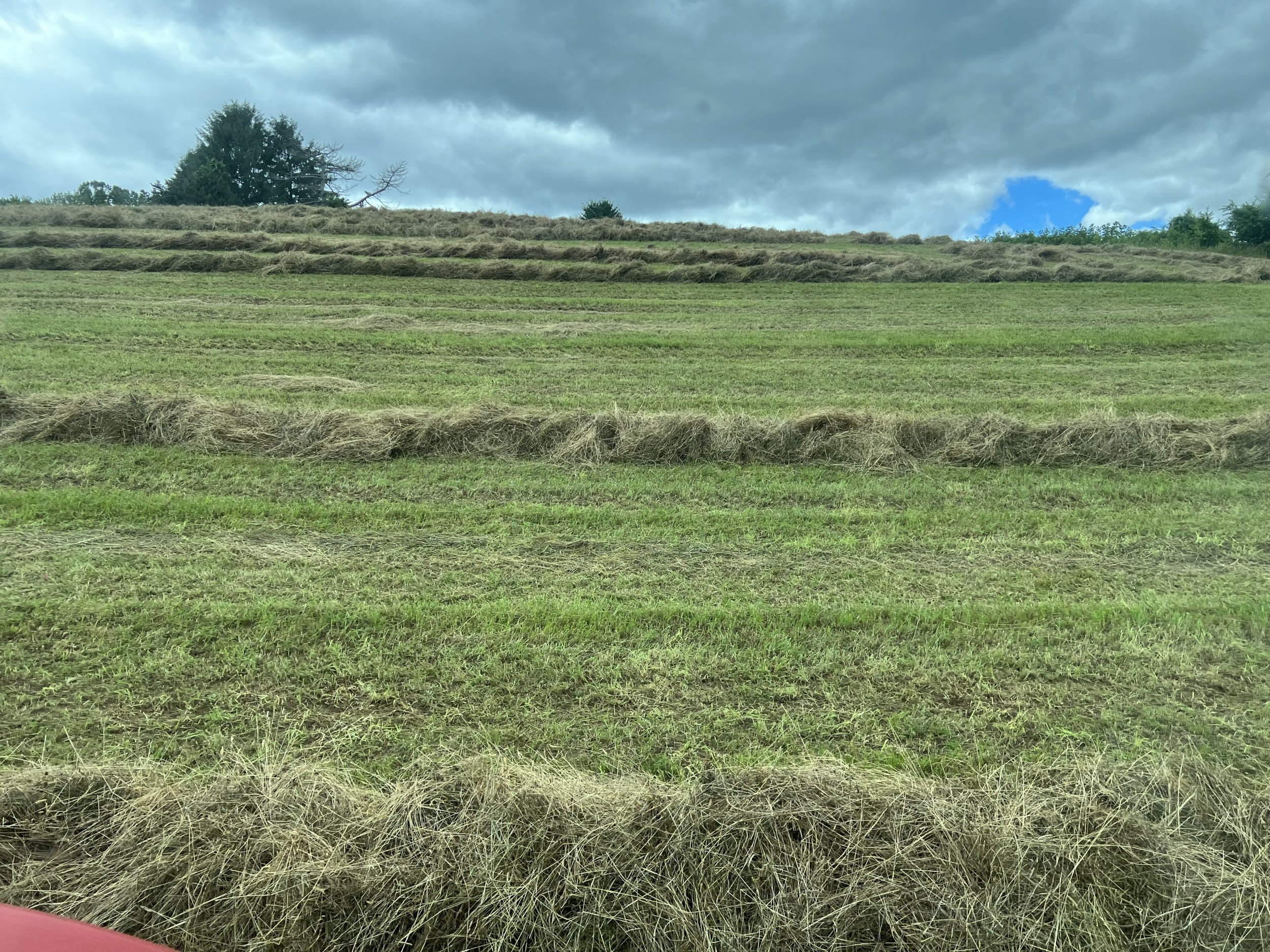

HAY DUDE - That looks like a lot of hay in the raked rows in post #18. Very nice pictures. Thanks

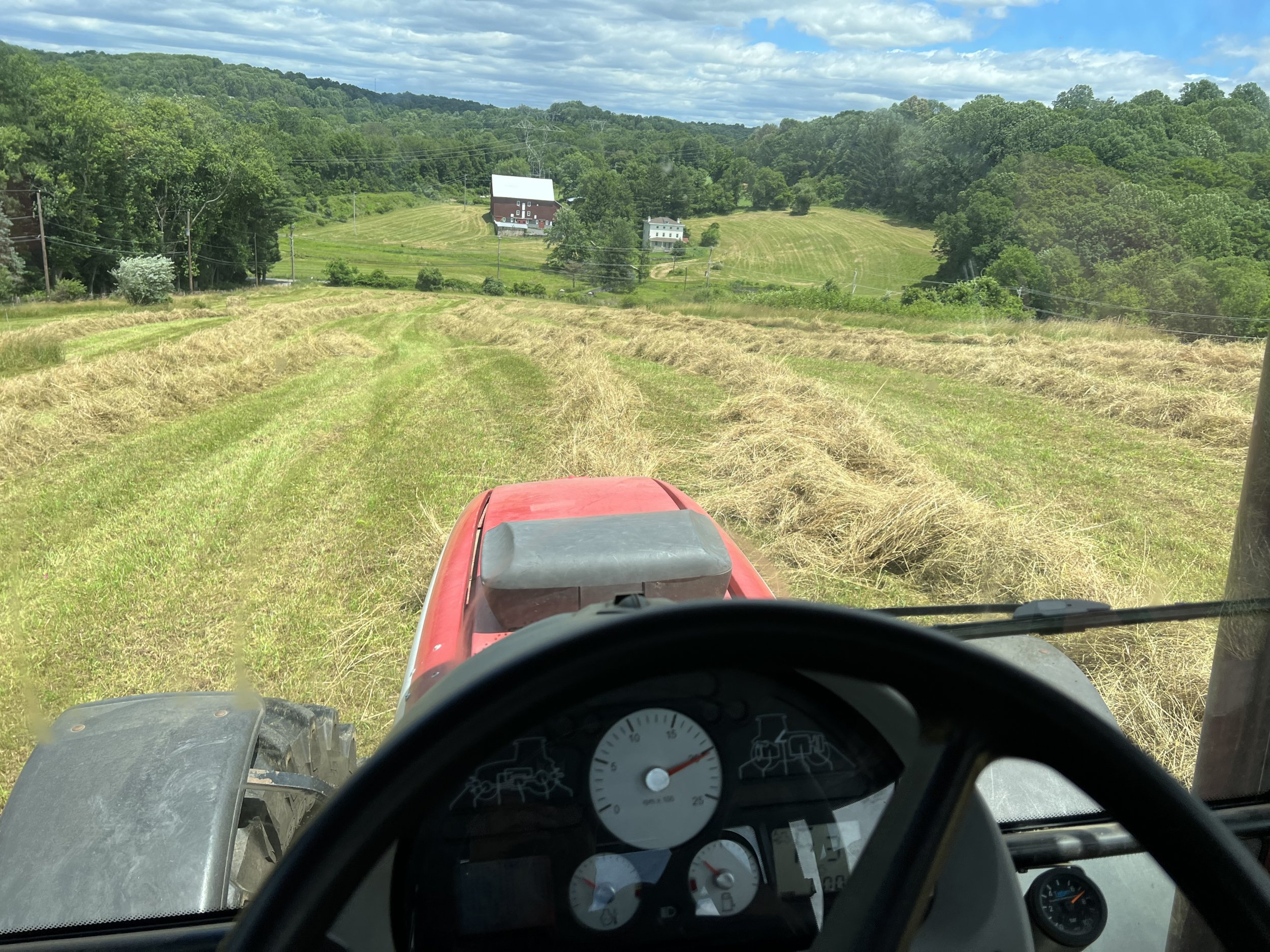

Here you can tell it is haying time. Many round bales in the fields and an occasional one beside the highway on a turn.

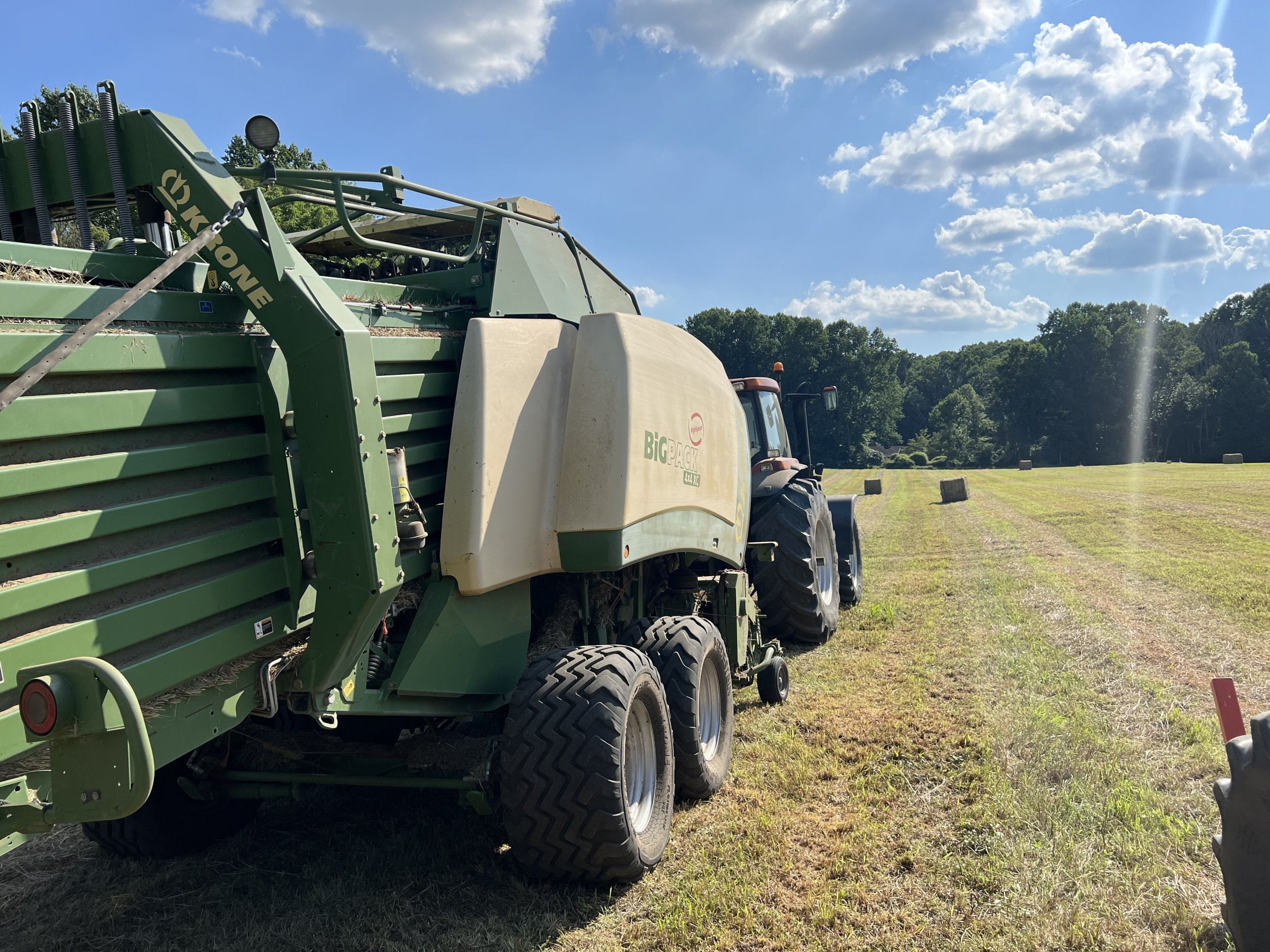

On a YouTube video, the guy was saying that there are only two designs for hay bailers, the Krone and the Massey. Everyone else copies one of those two designs. He was using a Massy round bailer when he was saying this. Do you think he's correct?
I have heard same. Krone’s design looks very similar, but there’s a few subtle differences.
Very complex machines. You get nervous every baling day that the baler will pull through and get the job done.

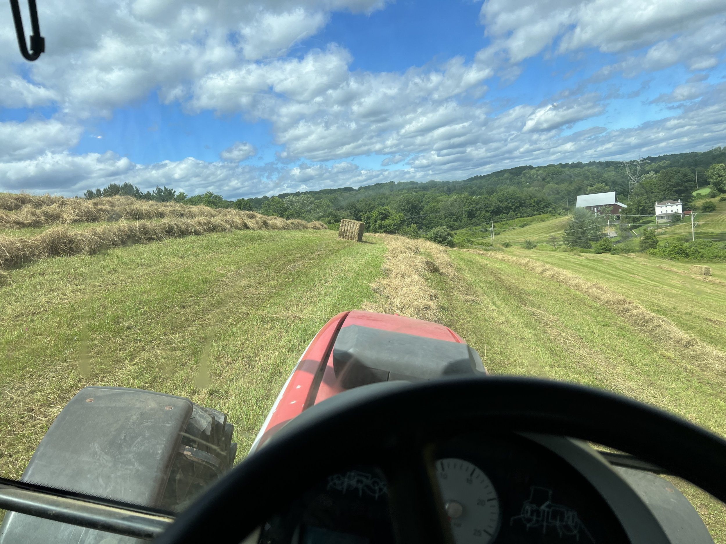

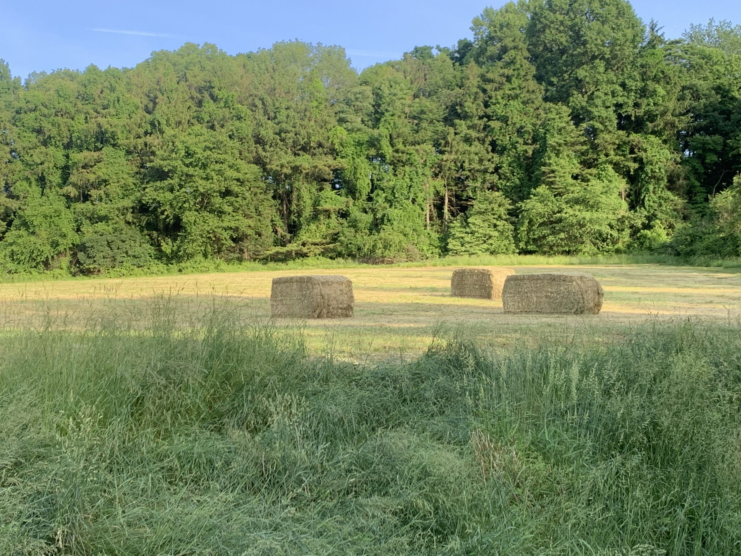

Raked & baled a smaller field today.
First time I ever dropped a bale on the corner of another bale. All 6 strings popped.
Big mess and lost a lot of time in cleanup.

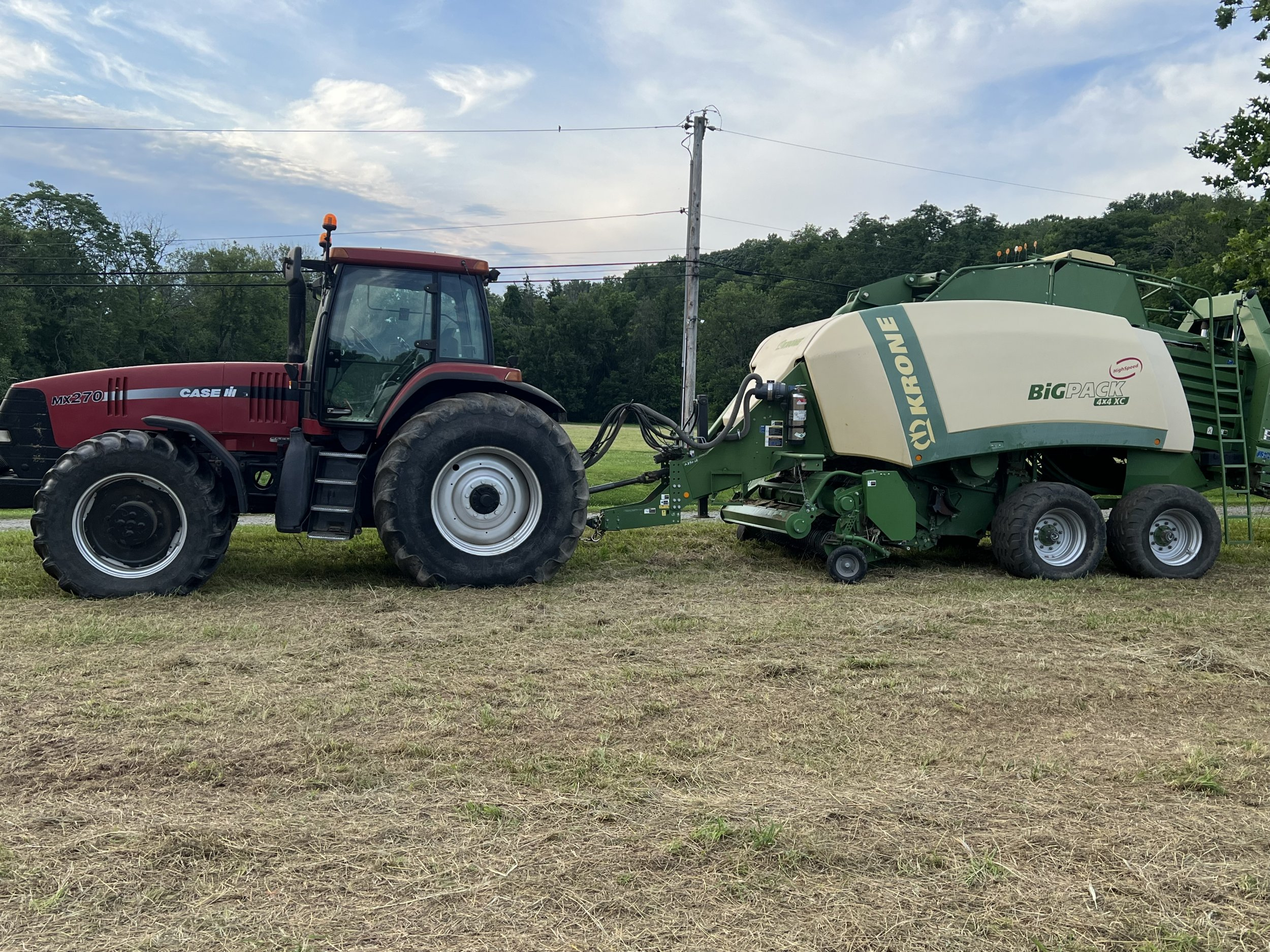

Do you haul all that equipment around on a trailer or do you drive it there?
I drive it from farm to farm.

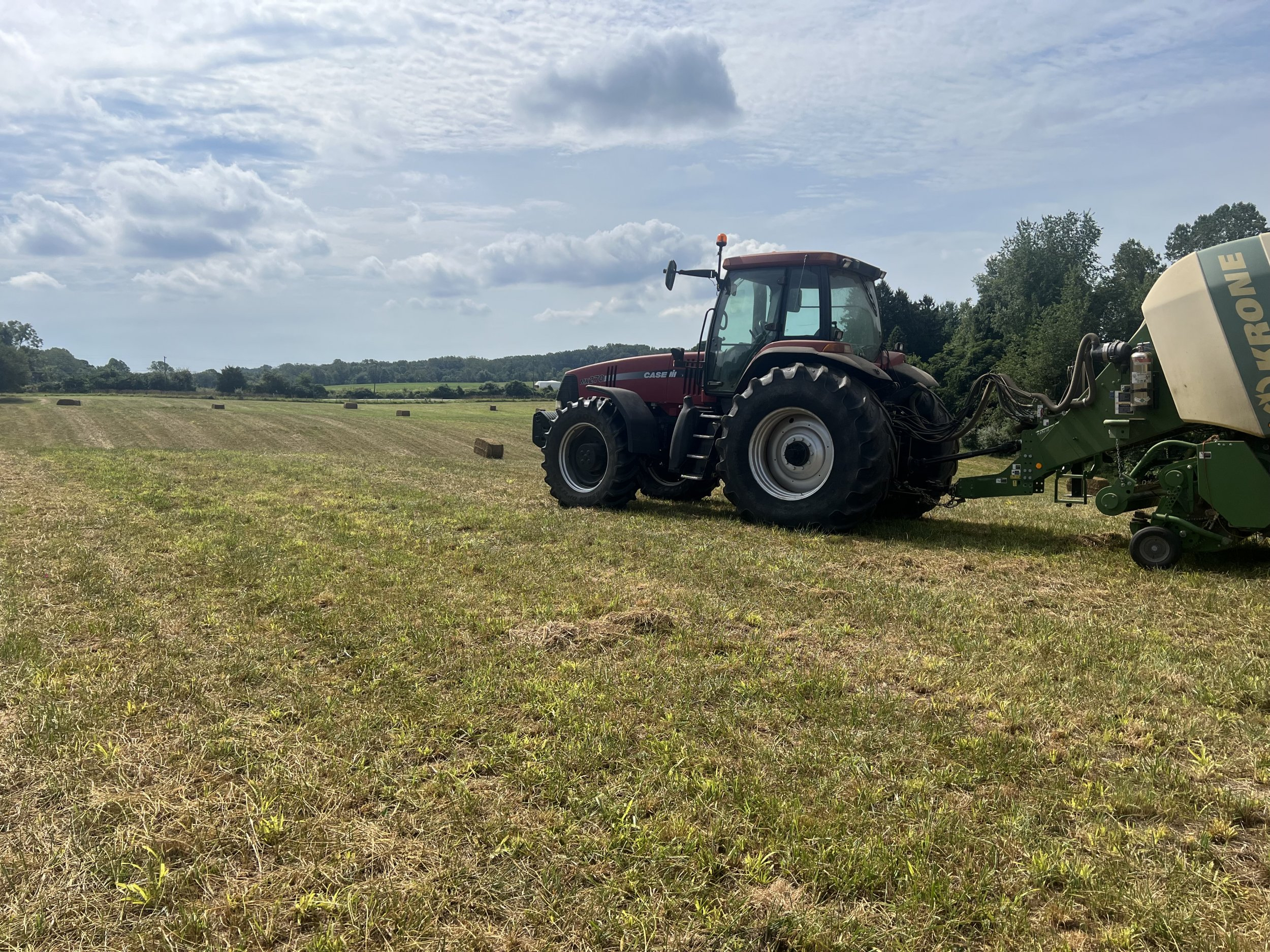

The Case-IH MX-270 and the Krone Baler weigh about 64,000lbs combined.

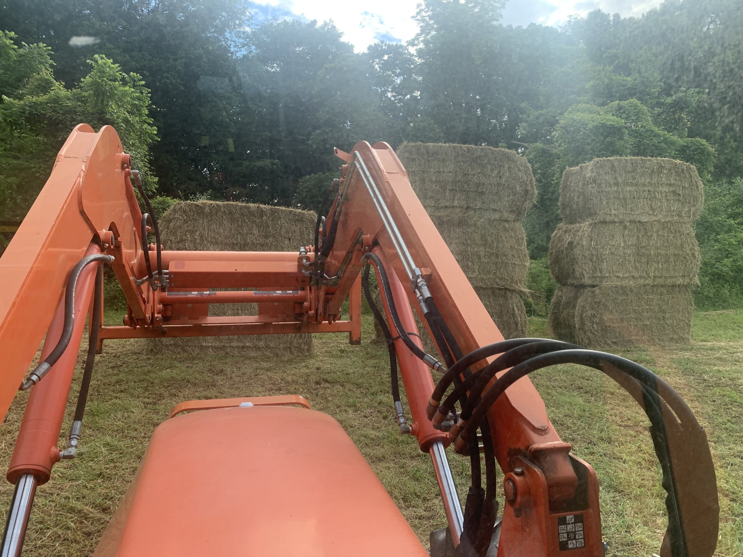

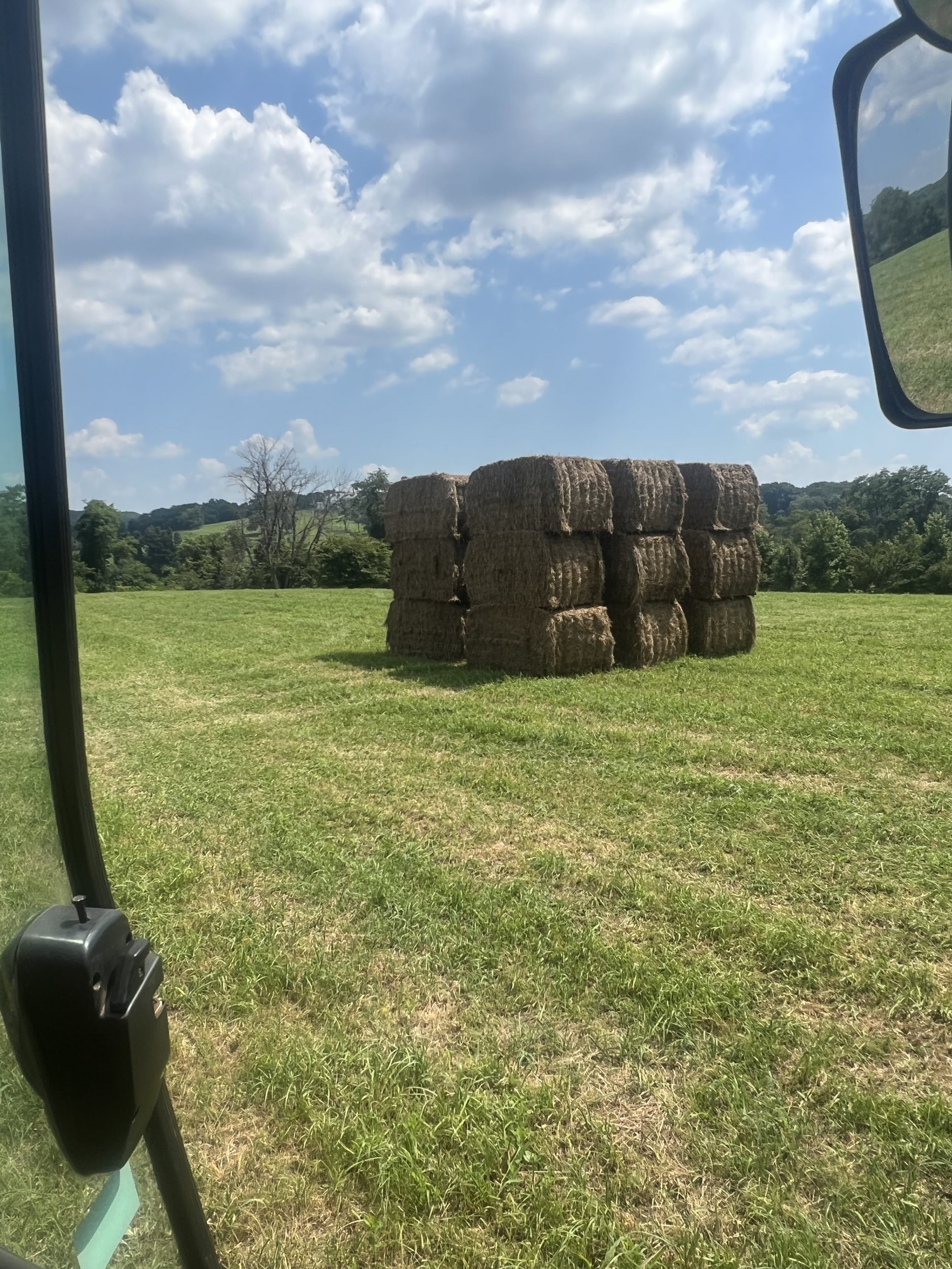

Little bale stacking today.
Bales were about 1700lbs/ea.

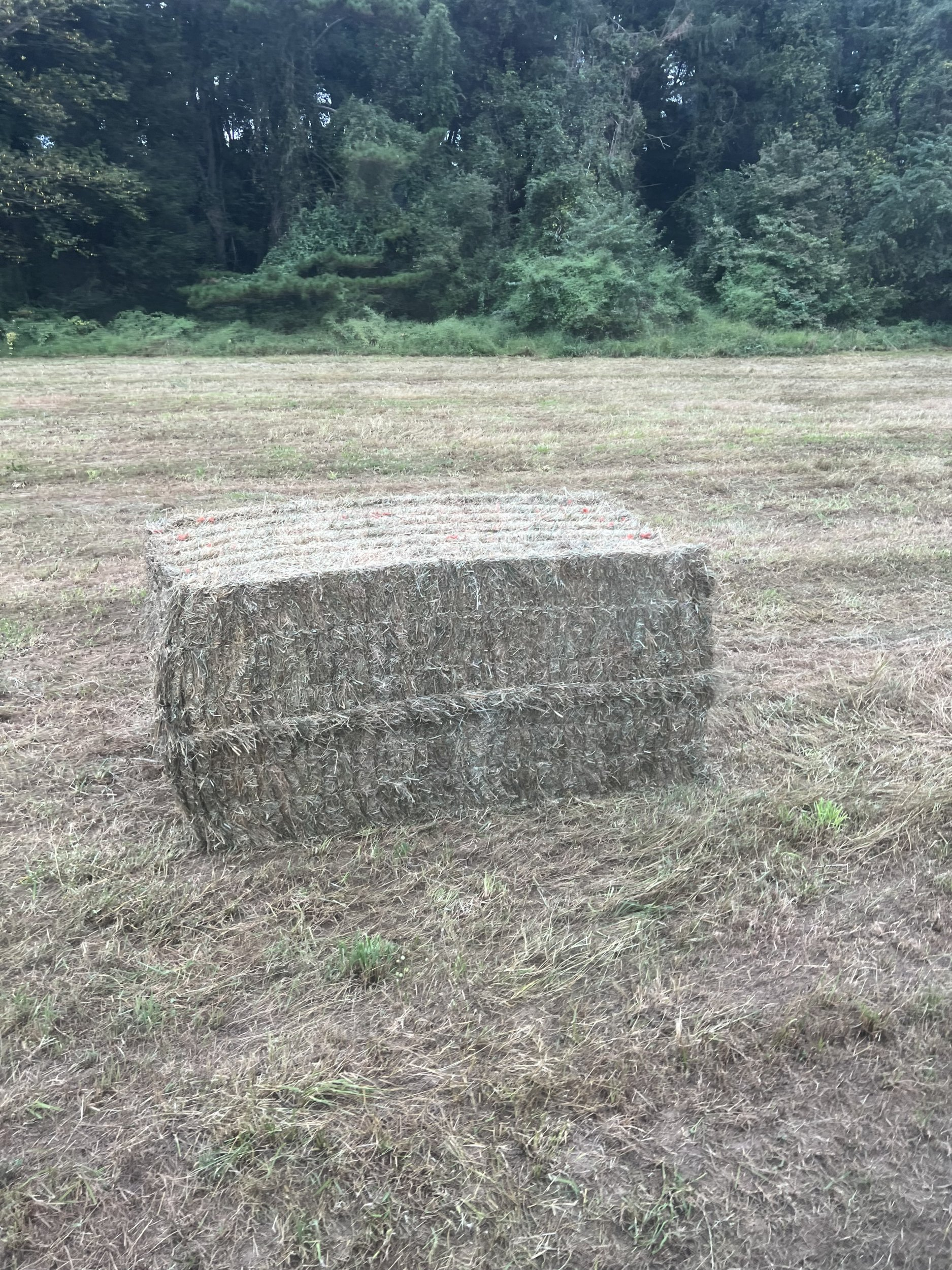

The larger (4x4x8) ones can also be for livestock. I just verbally sold some to a buyer who raises beef. She will be taking delivery soon.

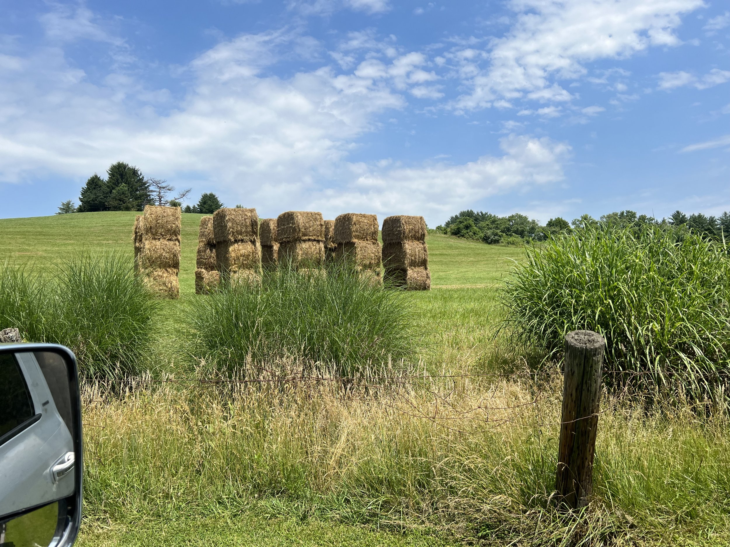

The 4x4x8’s you see in the pictures above can also become mushroom hay. Still has to be good hay, under 20% moisture (it’s checked before unloading) and free of noxious weeds, but they want that hay to lay out a little longer and turn tan/brown. They don’t want to handle green/hot hay.
Some clowns think mushroom hay moldy or junky. If it is, the mushroom hay buyers will reject it. It‘s actually just feed hay left down a few extra days to lose it’s color. They dont want hay with chlorophyll or moisture in it.
What we attempt to do is make feed hay on every field, but if it gets rained on or sits too long, it becomes mushroom hay. That way we aren’t trying to sell rained on hay to feed customers.
The smaller bales (4x4x5) you ask of are specifically made for my smaller feed hay buyers that have hay huts or smaller feeders.

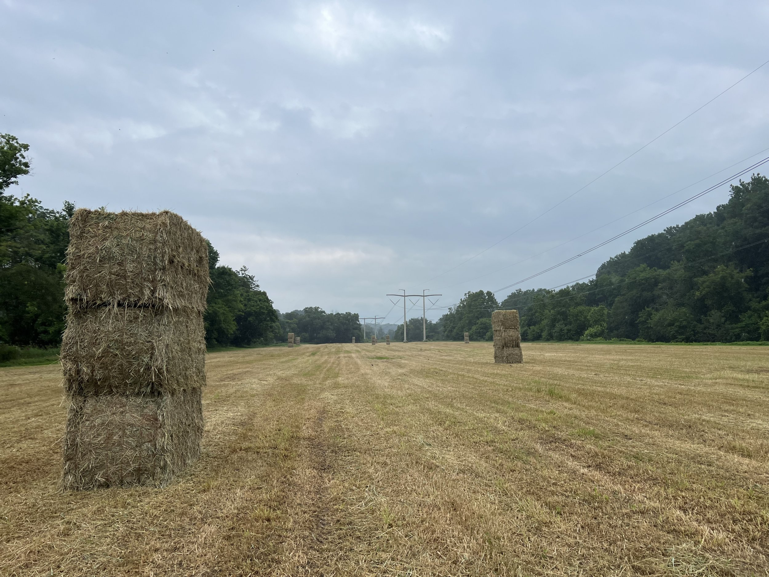

Still baling LOTS of hay. Stopped briefly from late July to mid August to take a vacation and right back at it when we returned.
Organic fertilizer paying big dividends for tonnage (y)
Below: These are my first bales weighing over 2,000lbs each. Just made these blocks today.
Below: 2000lbs
Below: Unfertilized field. Yields not that great. Sparse on clump grasses.
