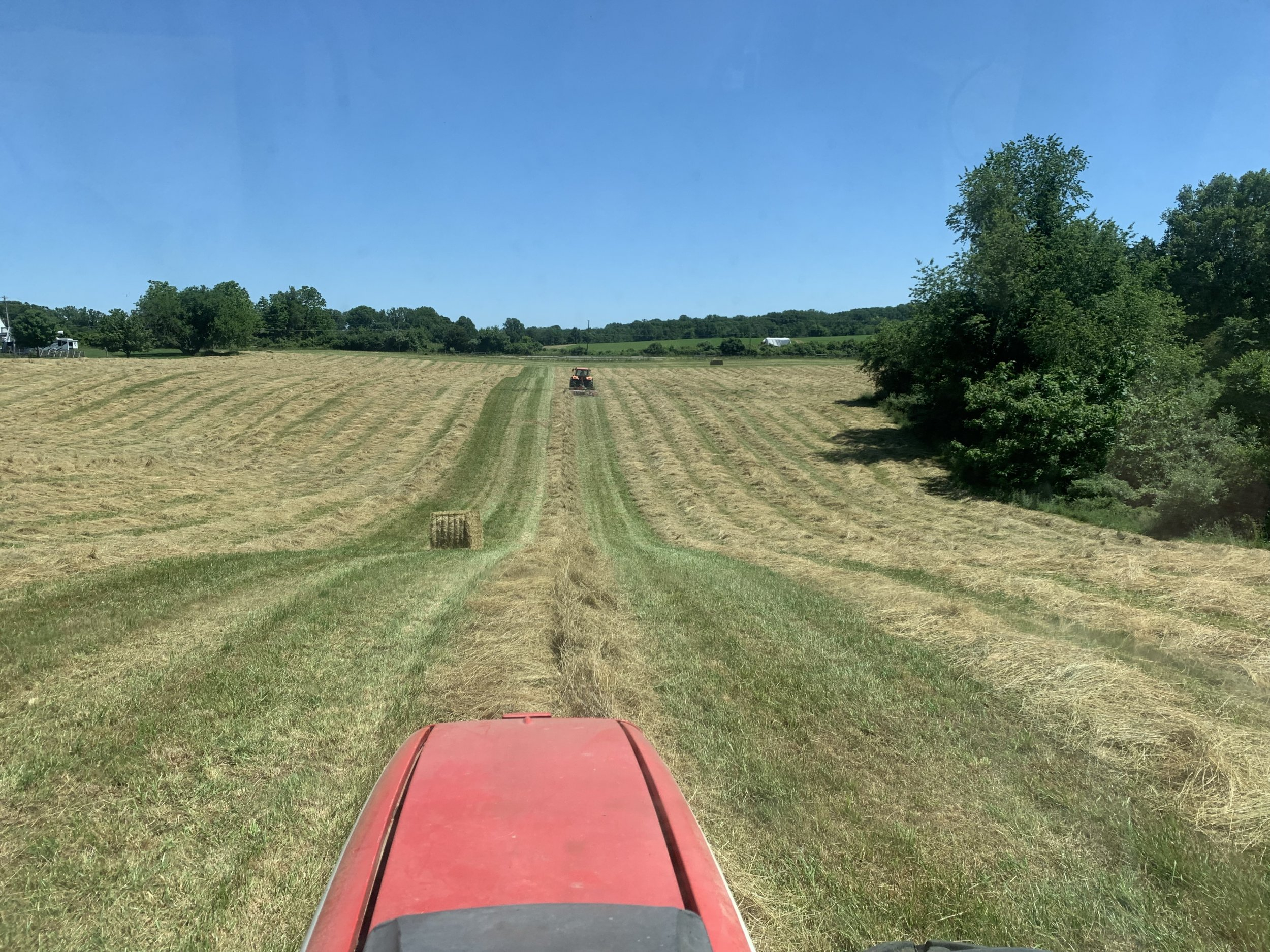

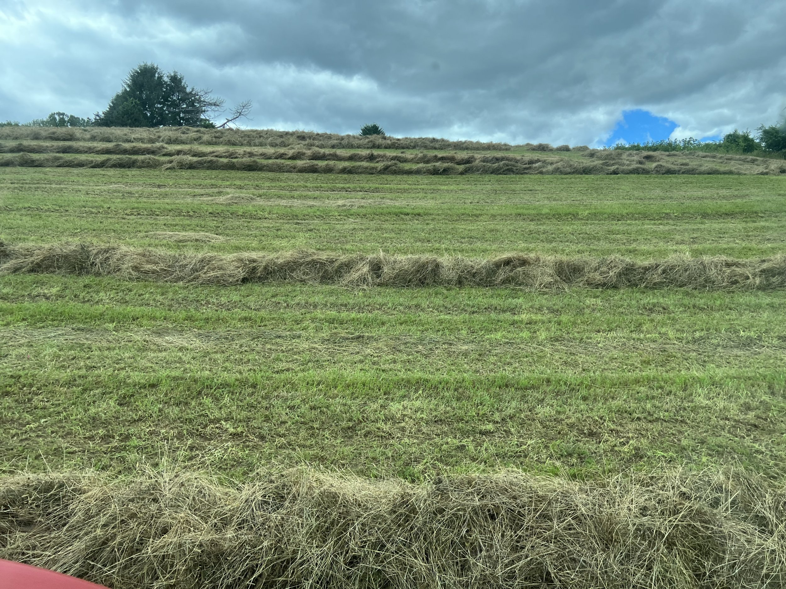

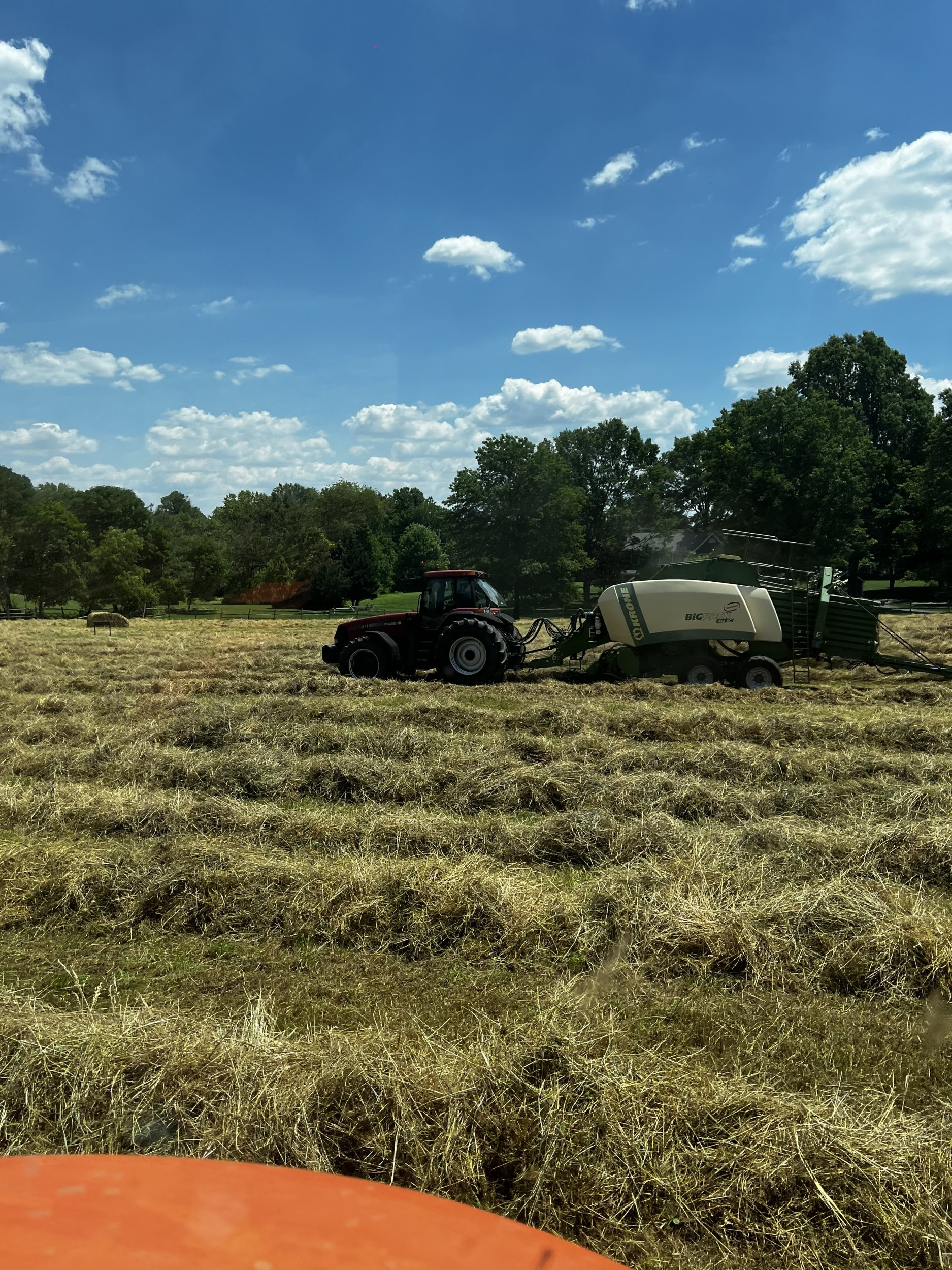

Heres a few pics from this weekend. Fabulous baling conditions. Dry, Sunny & breezy.

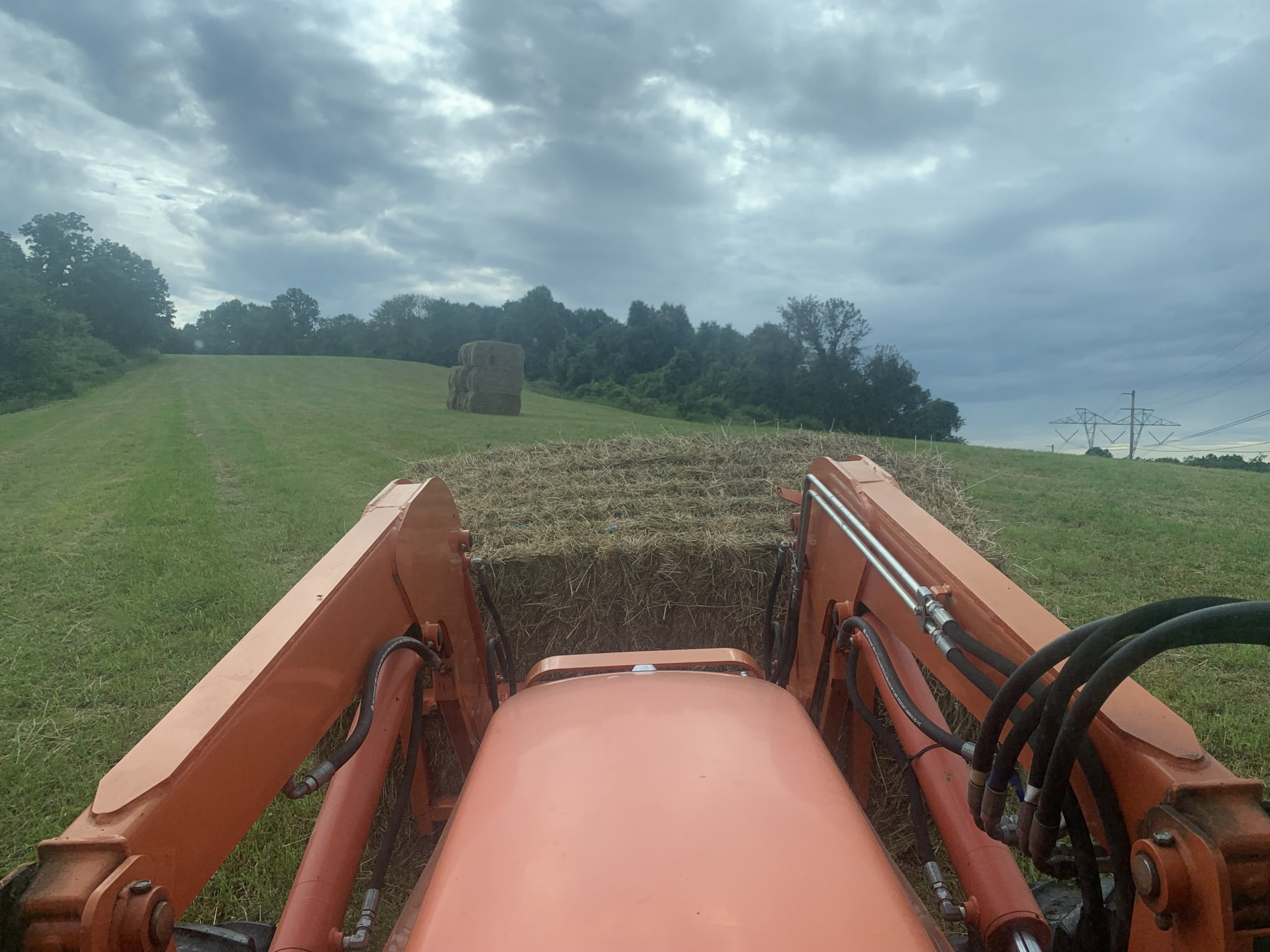

Just getting this field started. My son in the raking tractor up ahead.

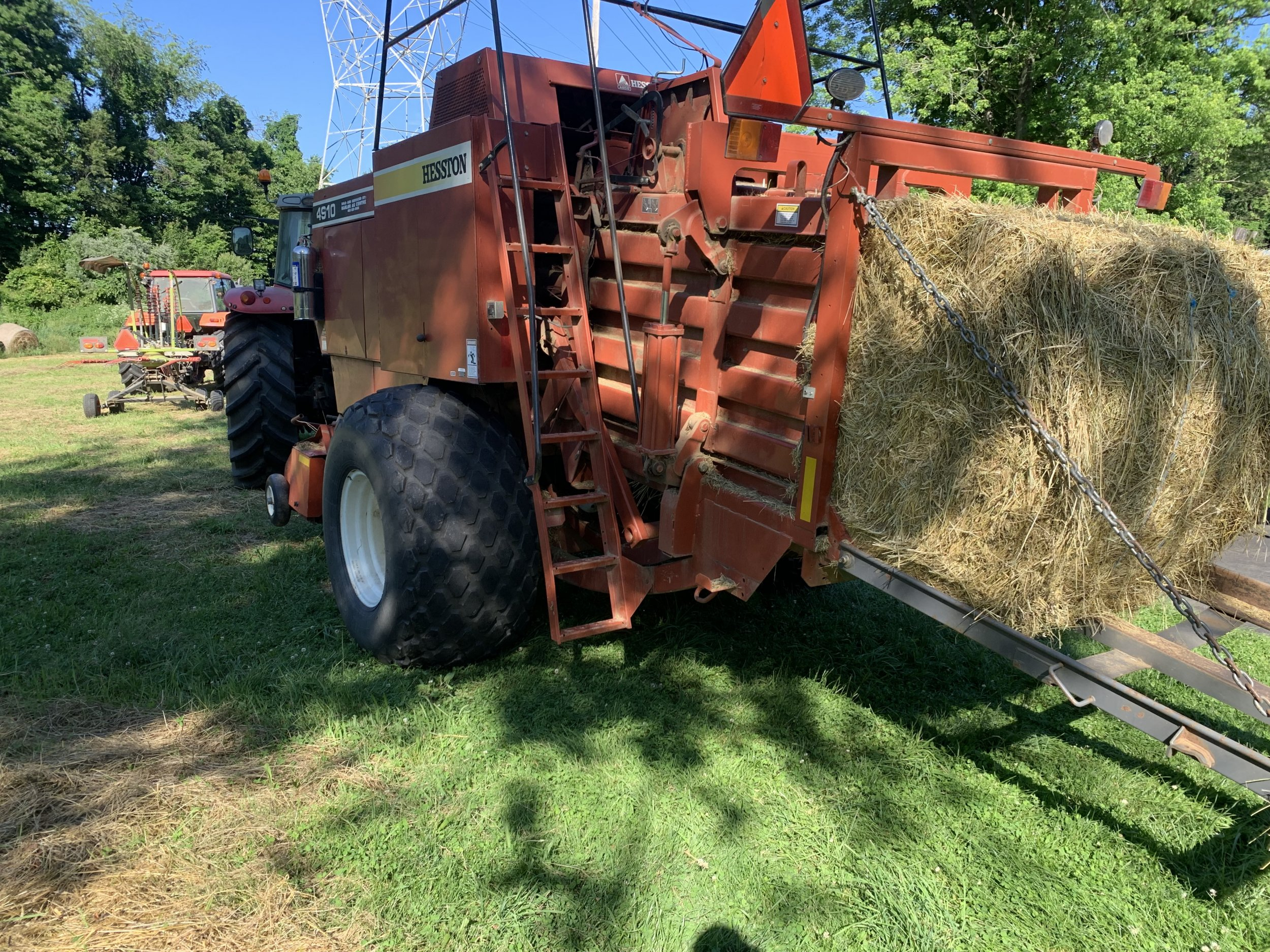

Finishing up with the Hesston 4910

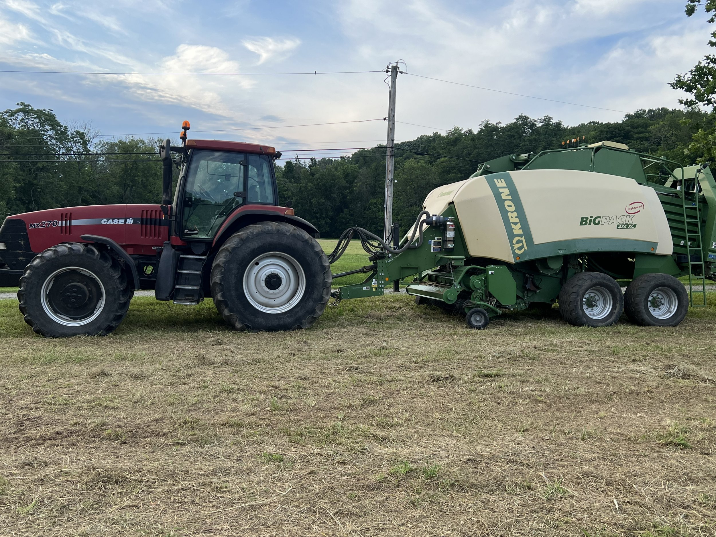

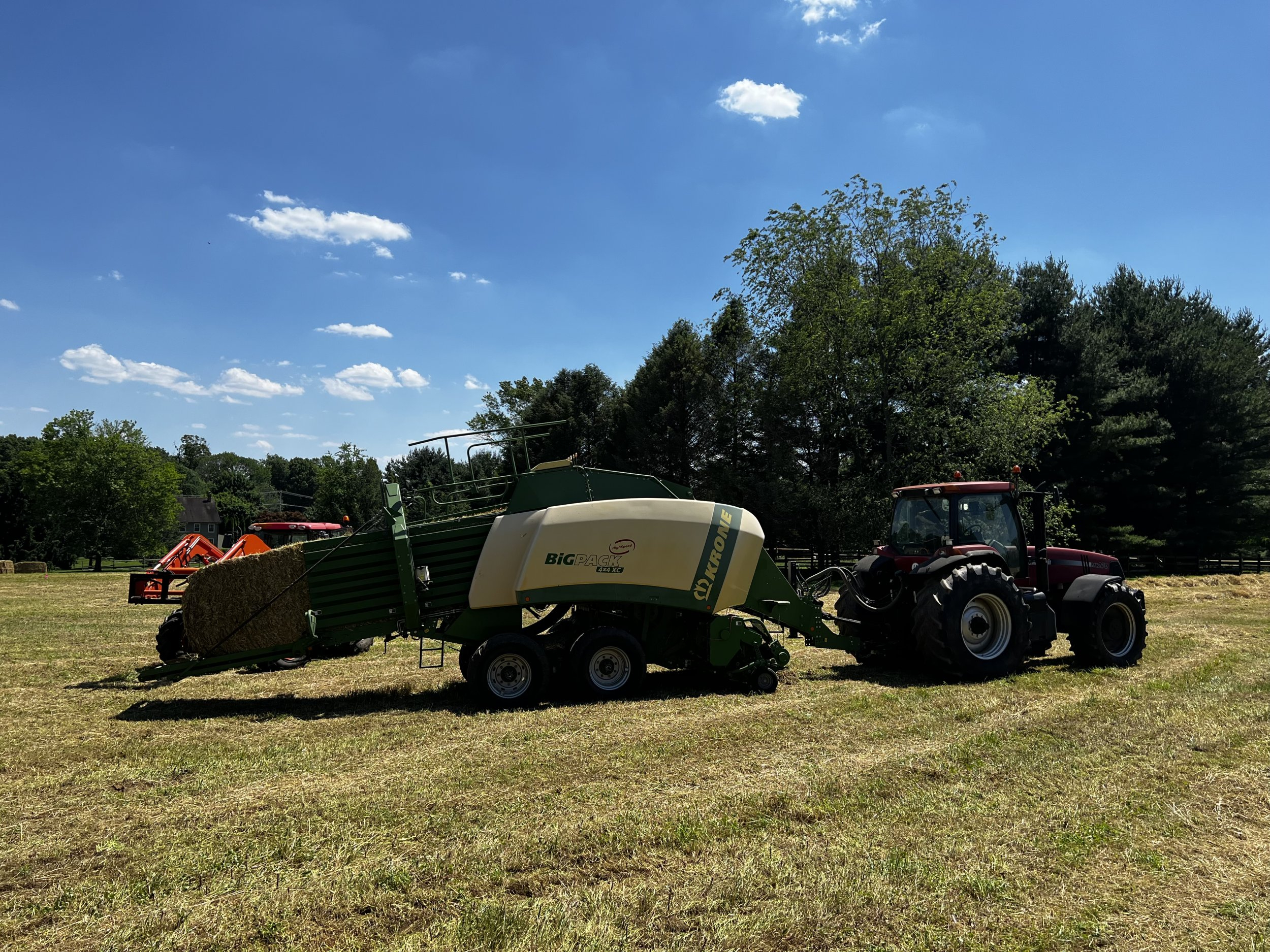

Meanwhile, on the other side of town, the Krone Big Pack 4x4 XC got to make a few bales.

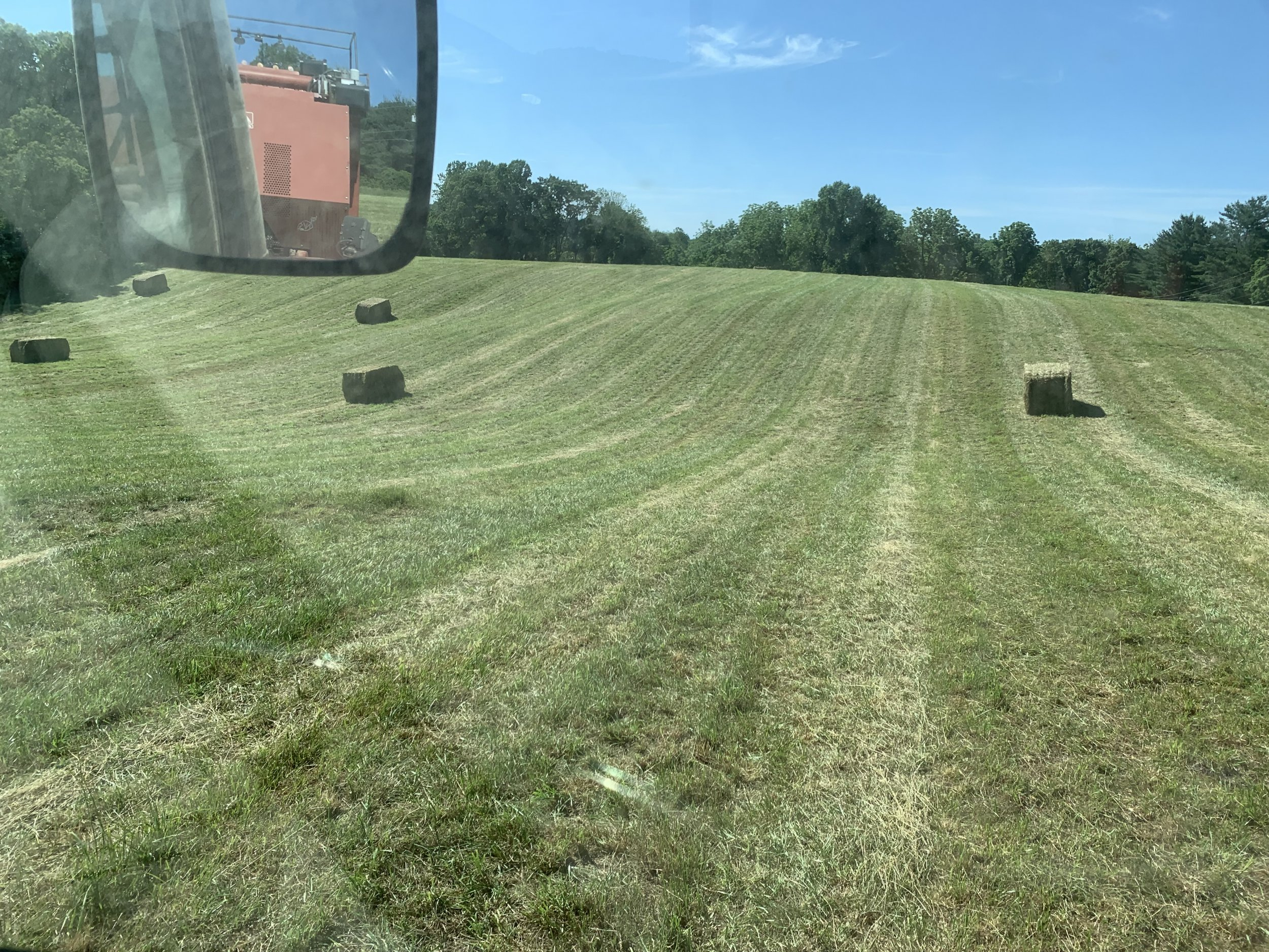

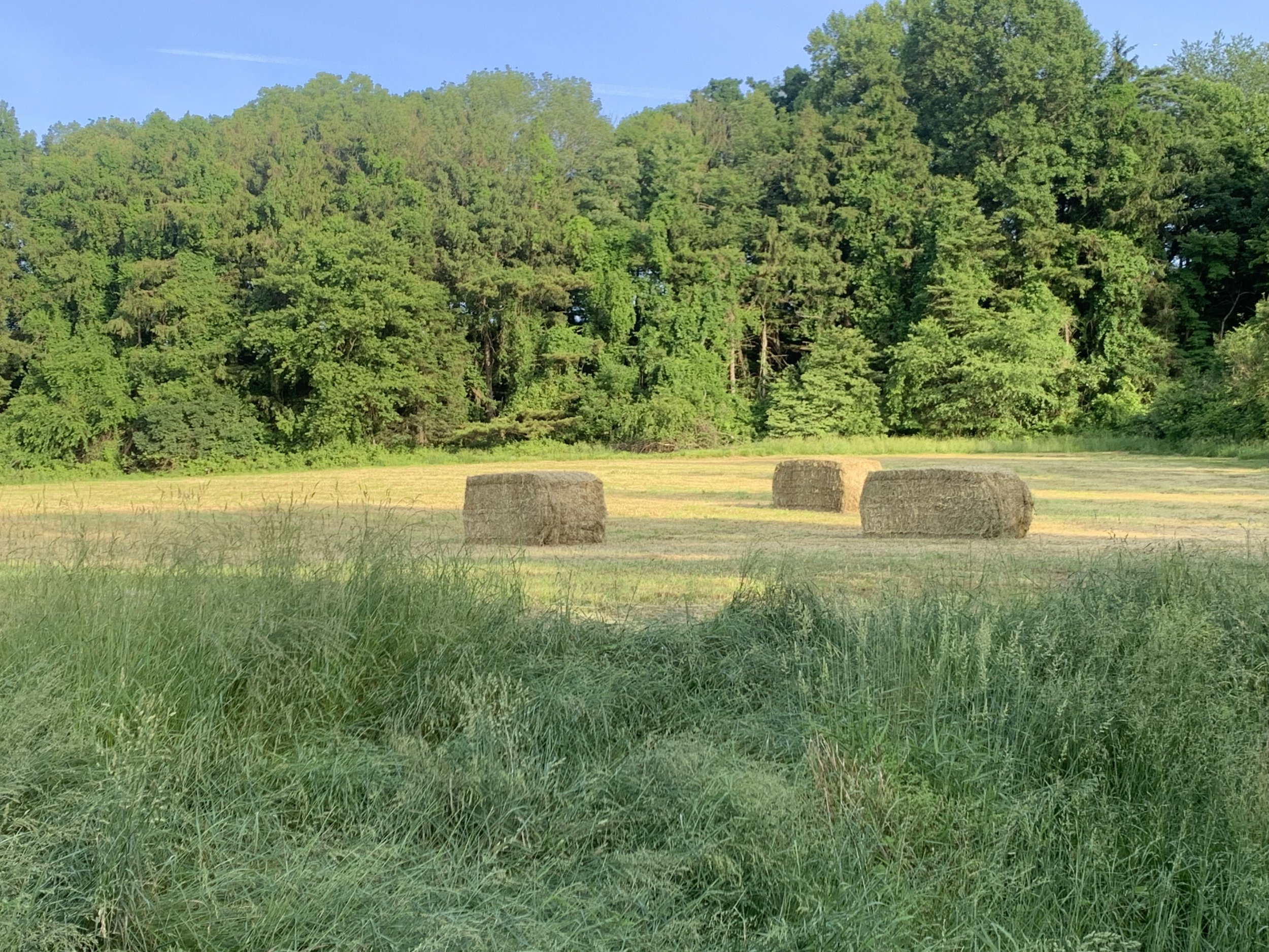

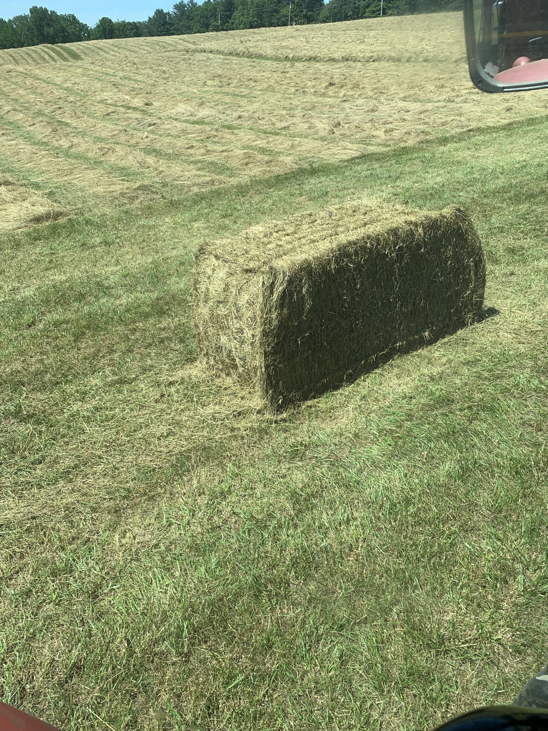

Heres a starter 4x4x8. Not as tight as I’d like it to be. I dont like to crank the pressure on the baler early.
Sorry the pictures suck. I take them trough dirty cab glass.

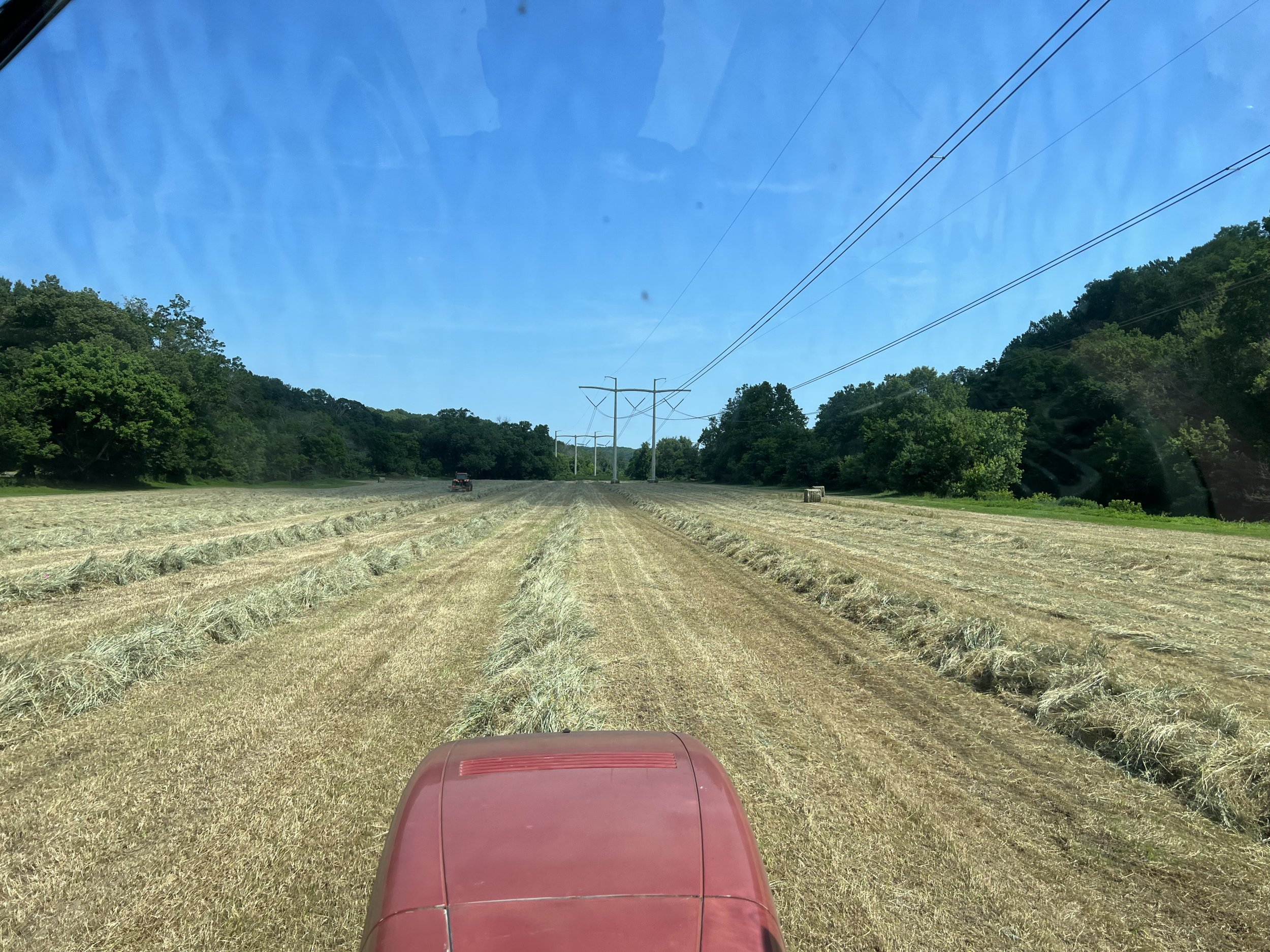

Made 15 more today working by myself (tedder, rake, bale).
Looks like our wave of nice weather ends tomorrow

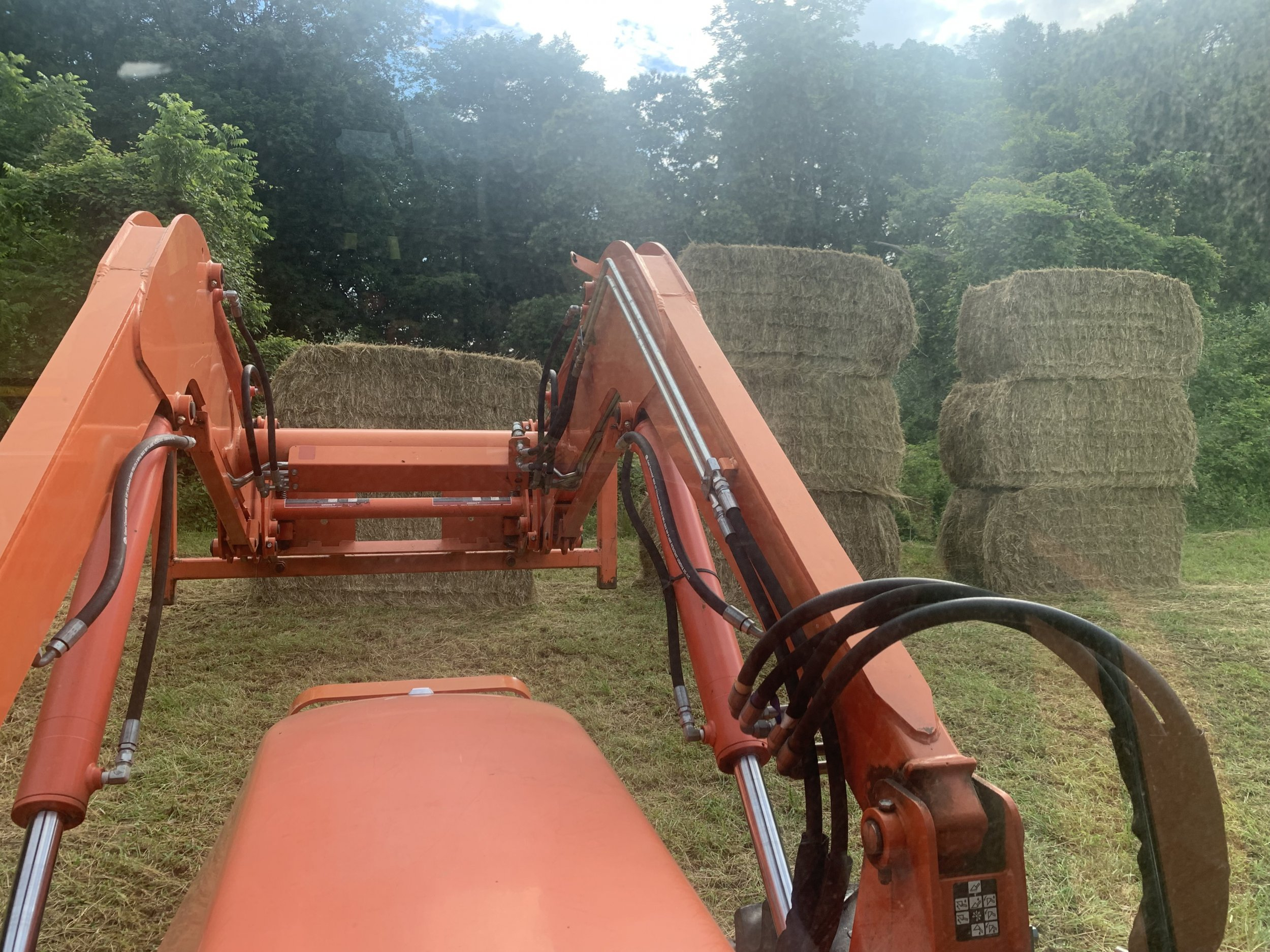

Did some stacking while listening to Phillies game.

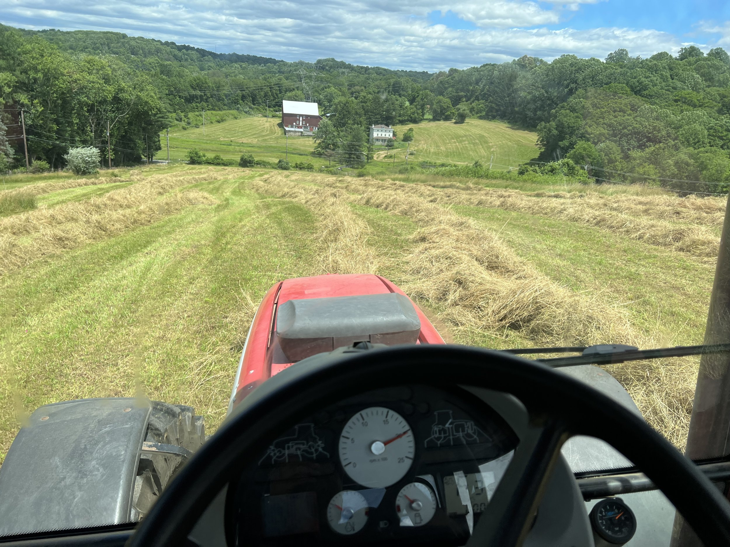

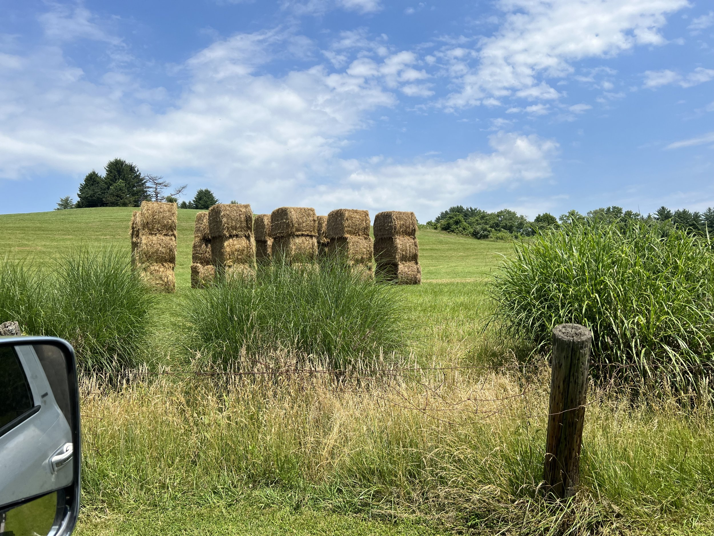

Here’s some pics from todays baling. Baled about 40 large squares under partly sunny skies and cool temps. Had to deal with some steep ground today. Tilt gauge said 16-19 degrees.
Made some pretty bales I can sell to my beef customers

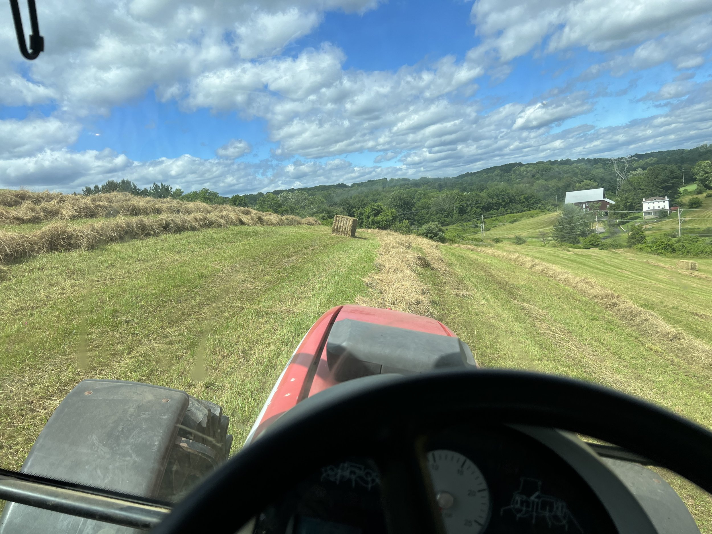

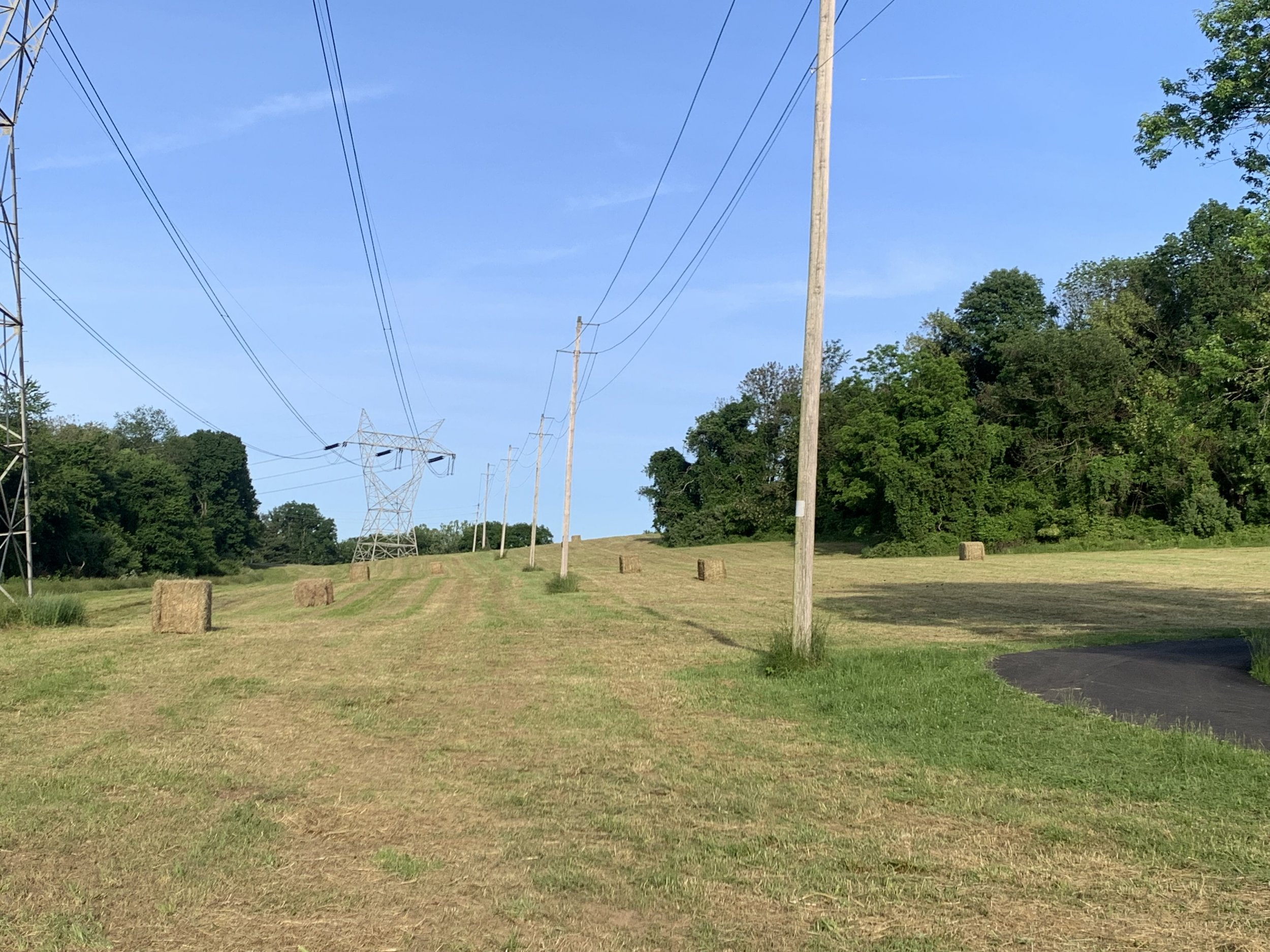

Under partly sunny skies and 86* temps, we made 72) 4x4x8’s @ 1500lbs/each today on 26 acres.
Used the Krone on this property.
